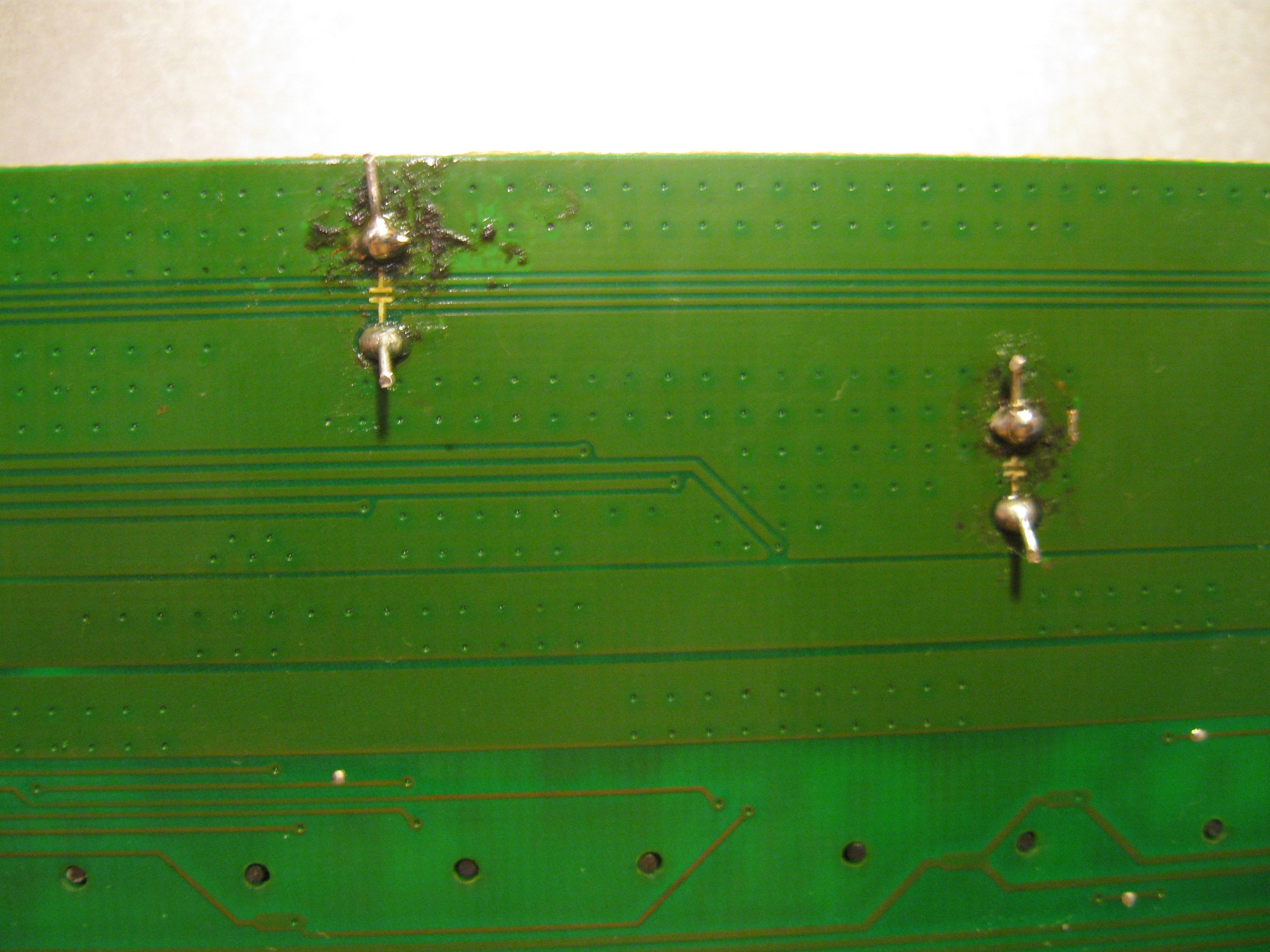

            Fuses arrived today, however I could tell right away that they weren't the correct size or specs. Far too small to be the same one, I guess I probably should've measured the dimensions first before ordering. I don't have a micrometer or anything but I measured roughly 6mm x 2.5mm x 2.5mm for the fuse's package size using a standard measuring tape. The part I ordered was roughly half that length at ~3mm.
            Here's the parts I've narrowed it down to as most likely candidates, both fast-acting:
            Littelfuse Nano2 448 series
            http://search.digikey.com/scripts/Dk...ame=F1641CT-ND
            https://cdn.badcaps-static.com/pdfs/...c98b1552f8.pdf
            Littelfuse Nano2 451 series
            http://search.digikey.com/scripts/Dk...ame=F2587CT-ND
            https://cdn.badcaps-static.com/pdfs/...6ccc940b6e.pdf
            Biggest differences I can tell is that the 448 series is Pb-free with higher soldering temp thresholds. Would one be better than the other?
            Also, do I want Fast-acting or Slo-Blo? There's a few series in the same package size with the main difference being Slo-Blo.
            Thanks again for any advice/confirmations, I'd like to order these ASAP in hopes of getting them this week.

              I hate it when that happens. If you are skilled, you should be able to extend the pad and use the shorter fuse.
              I'd use the higher temperature one. It's always embarrassing when the replacement fuse gets overheated and goes open as you are soldering it in. I'd also avoid the slo-blow fuse unless a legend on the board specifically mentions 'time delay'.

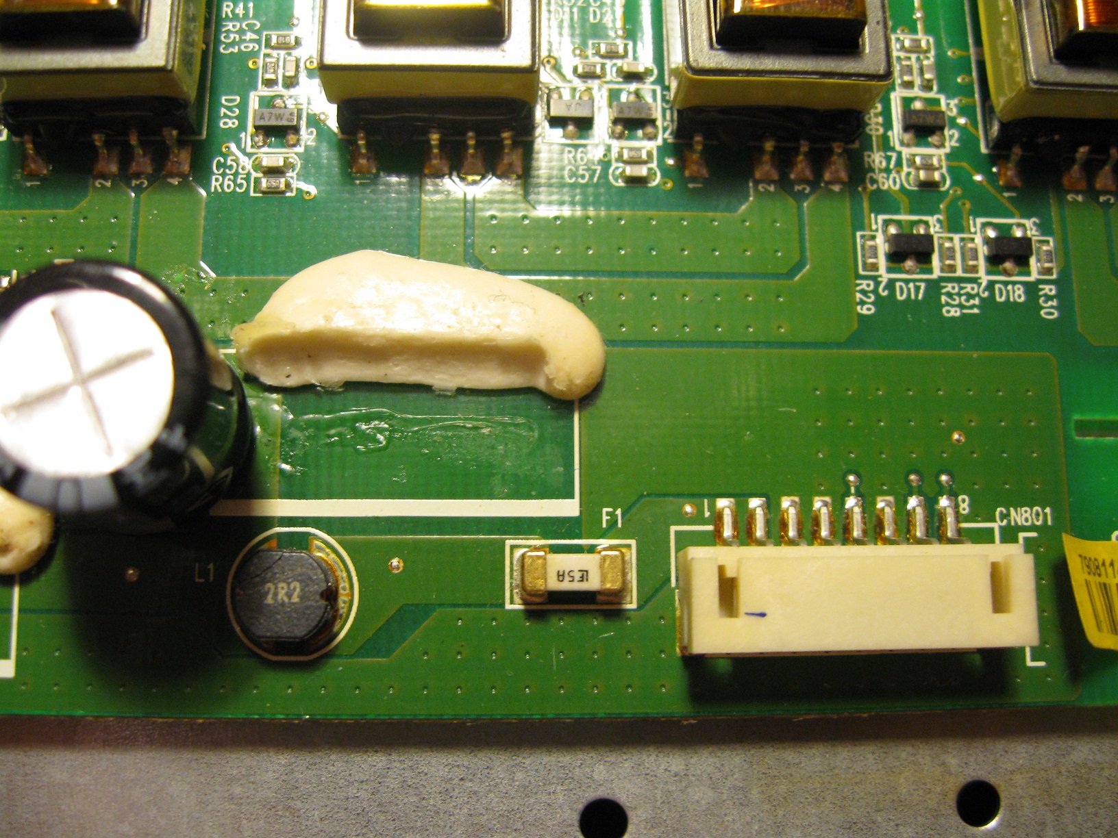

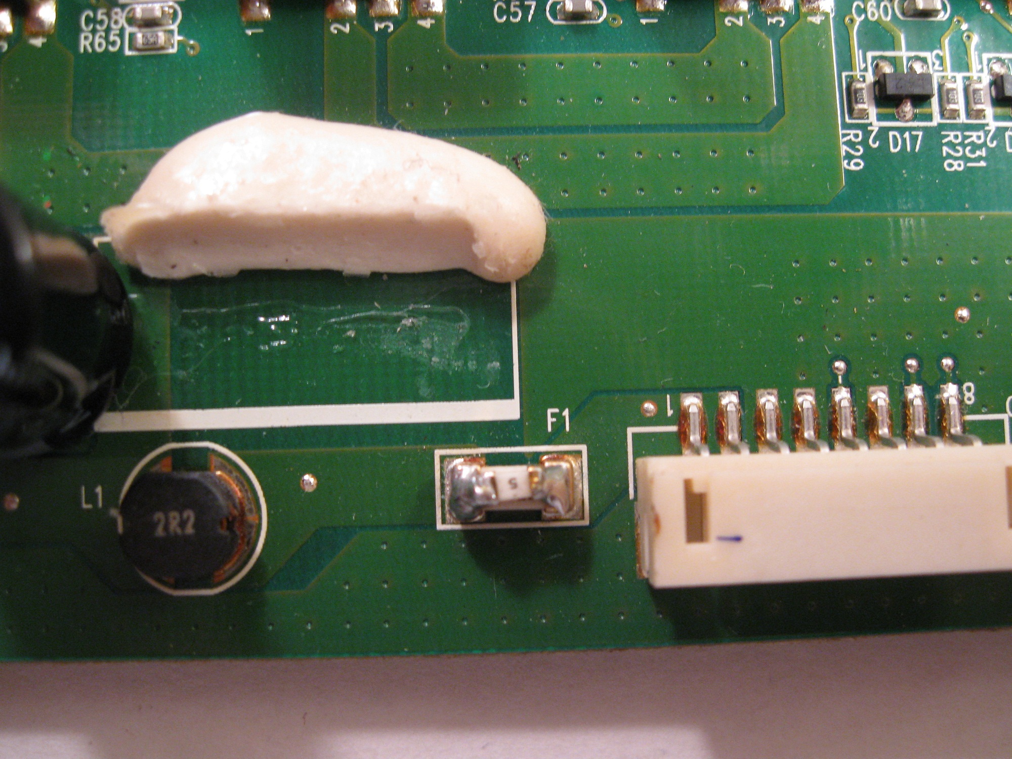

                  • chizow
                    • Apr 2010
                    • 14
                    #129
                    Re: Gateway FPD2485W - capacitor related?
                    I haven't reread the entire thread, but believe the fuse in question is for the inverter supply. In that case, using a fuse rated for 63 volts is acceptable; the inverter supply is probably 24 volts (or maybe only 12 volts).
                    PlainBill
                    Ok limited success here. I went ahead and piggy-backed the new fuse on the old fuse. The new contacts fit within the old almost perfectly so all I had to do was solder them together. I used jsog's tip about holding the fuse in place with an exacto knife while I applied a bit of solder from a tinned iron and had an acceptable solder joint pretty quickly. Pic below.
                    I tested the new fuse for continuity and got a chime, checked ohms and got 0.3. Checked contacts on both the old fuse and on the new one and both gave me chime/0.3, so I was confident the joint and fuse were good.
                    I went ahead and reassembled everything. Plugged in the power cable and nothing. No chime, no picture, no LEDs on front. Unplugged again, then plugged in. Chime but no LEDs, no picture. Slight regression here as I at least had the front LEDs before.
                    Unplugged the power cord again. Checked the fuse for continuity. Nothing, looks like the fuse blew again. Plugged the power cord back in. Set DMM to V, measured from the fuse and saw roughly ~26V as PlainBill suspected for the inverter board.
                    What do you guys think the problem is now? Looks like the power supplied from the power board is OK? Just a bad inverter board at this point? Maybe time to give up? Not sure what else it could be.

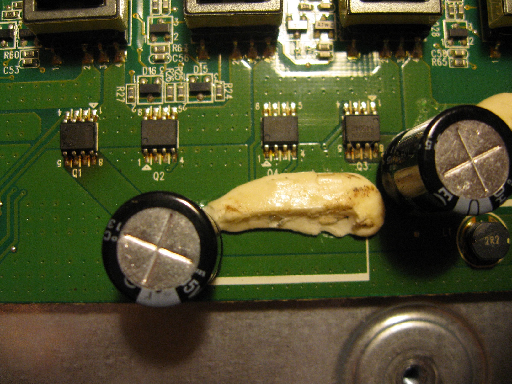

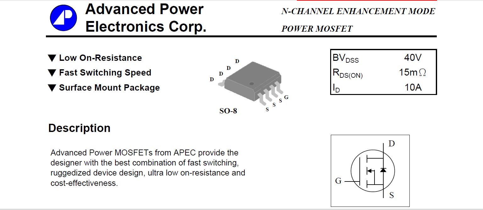

                      • chizow
                        • Apr 2010
                        • 14
                        #131
                        Originally posted by jetadm123
                        1) The two new caps you installed on the inverter, did you verify correct polarity during installation? Also, did you check your soldering to make sure there are no solder bridges?
                        2) I would consider checking again the 4 mosfets for shorts.
                        Hi, thanks for the suggestions.
                        1) Polarity should be OK, double-checked with my older reference photos and others in this thread and negative is toward the bottom of the board with the power connector. Soldering should be OK too, the inverter pads weren't as easy to work with as the power board and the caps were a lot harder to remove but I eventually got everything worked out. Pic attached at bottom, a bit heavy on the flux residue because I had a little bit of trouble getting all the old solder off.
                        I checked to make sure the solder joint was OK and in contact with the pad/trace by checking for continuity from the measuring points to the left and right of L1 in the 2nd pic below to the capacitor leads. Not sure if that is a sufficient test or not.
                        2) I'm not sure how to test a mosfet but used post #64 in this thread as a reference: https://www.badcaps.net/forum/showpo...6&postcount=64
                        I gathered from retiredcaps' post to test Source-Ground, Ground-Drain, Source-Drain. I'm just not sure which pin is Ground, according to this data sheet only Pin 4 or Pin 8 can be ground: http://html.alldatasheet.com/html-pd.../AP9985GM.html
                        In any case, I measured assuming Pin 4 is ground. See 3rd pic below for mosfet pins. For S-G Q1=2 ohms, Q2=10 ohms. Q4 I had to change to M or K bands to get any kind of reading. Q3I measured 140 ohms. Not sure what this means, based on retiredcaps' post Q1, Q2 and Q4 may all be bad with readings under 20 ohms? For G-D and S-D tests I measured (again assuming Pin4 is ground), pretty sure everything was 0.2-0.3 ohms.
                        Again, not sure if I'm measuring correctly and not exactly sure what I'm supposed to be looking for in determining if a mosfet is good or bad. Also, could something else be the source of the problem? Perhaps a cracked or bad CCFL causing the short?
                        Thanks for any further tips/troubleshooting advice.

                          Let me clear up something. A mosfet has three pins: Drain (D), Source (S) and Gate (G). So, what you're describing as "Ground" is actually the Gate. However, your testing was correct. Hard to believe that all the mosfets are shorted out. Was your meter set to 20 ohms when you made the S-G measurements? What resistance range was your meter set to when you measured the G-D and S-D?

                                0-400 ohms is the low range on that meter. The clamp isn't used for resistance readings. Touch the probes together to figure out the lead resistance first, then subtract that from the actual reading.
                                  This is trying to explain why all the mosfets show shorted
                                  If you removed all the GM9985 mosfets from the inverter, With the Inverter capacitors discharged.
                                  Touch one lead of the ohmmeter to either positive lead of the inverter capacitors and the other ohmmeter lead to source pins 1-2-3 of the pads on the inverter you will read 0 ohms.
                                  Now touch the negative lead to the negative lead of one of the inverter capacitors, and the other lead to the drain pins 4-5-6 you will also read 0 ohms.
                                  When these Mosfets short it's usually source to gate, so one shorted Mosfet will affect the reading on all of them.
                                  I would bet if one mosfet fails they should be replaced in pairs.
