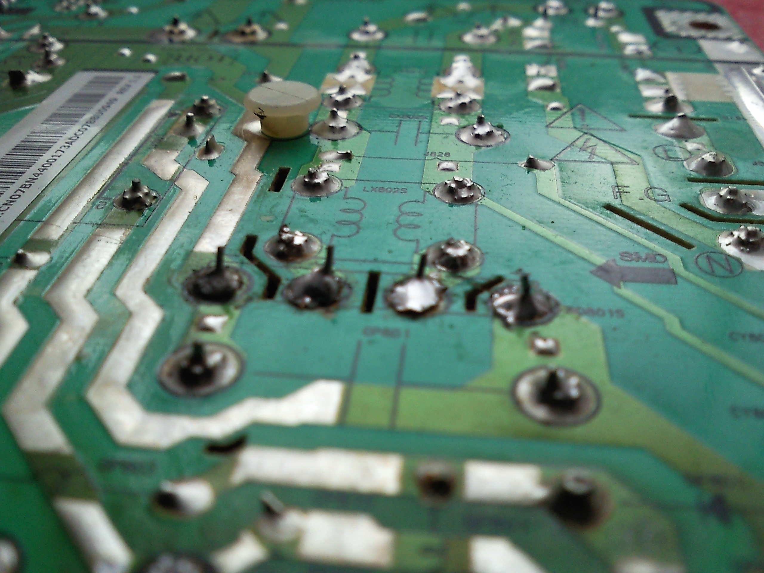

        Re: Samsung Syncmaster 245BW
        You really cant understand? How else should I explain? I dont know what to do with it and I am looking for advice.
        Anyway I see that you can't help me with it so I did it on my own. Took some photos of the result.

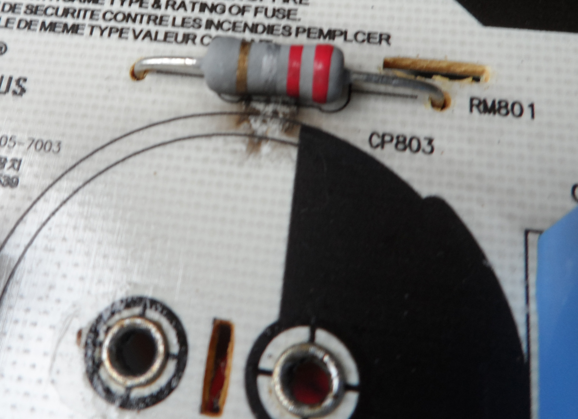

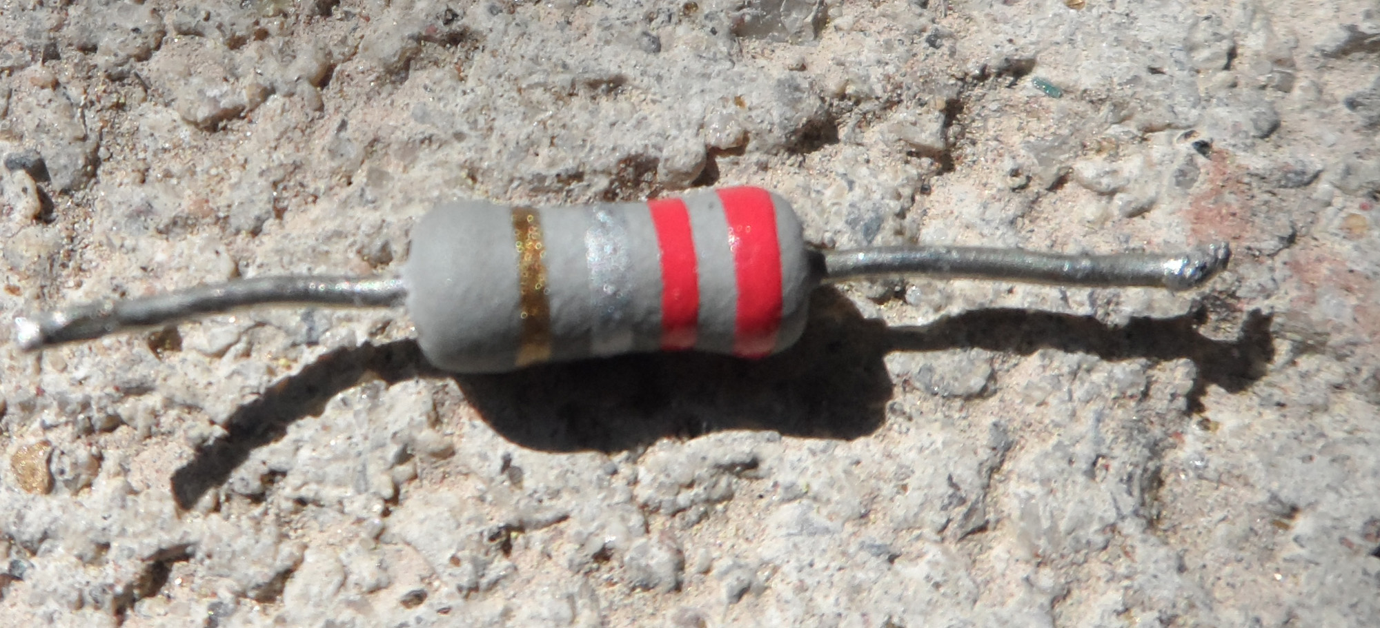

            First of all thank you all for posting and thank you operators of this site... marvelous job everyone... I have 3 of these 245BWs with 173A PS, one stopped working with same symptoms as OP described... I changed all the caps, except the big one, and the 3 resistors as described by some of you and no success.... so I took it apart again removed all the caps, except the big one, LOL and measured the values, they all checked fine on the plus side (slightly over posted values)... then I checked the big cahuna CP803 82uP 450V and it read low so I removed it and measured again, showed 71uF so I figured that could be it...
            ordered new one and while waiting I looked closely on the PCB around the area of the CP803 an noticed some gray traces coming from under the RM801... measured it and it is blown open... had I not removed the big CP803 I could not see the damage so I got lucky by being persistent... that area between the resistor and big cap is impossible to see without removing the resistor or the cap... attaching photos of the area... and the hidden damage... the resistor looked fine from the top, only after removing it you can see the blowout... LOL
            I do have a questions however, this .22 ohm resistor is fusible? meaning it will blow to prevent more damage to surrounding components? function sort of like a fuse with assigned resistance? what should I replace it with if I can't find exact replacement, since I do not know the wattage? and what other components could have been damaged by the blowout if anyone knows? thank you
            so as they say, you never know which little 50c part will fail, best to look real good all around and test as much as possible all the components, may save you a bit of time and headache in long run... good luck all...

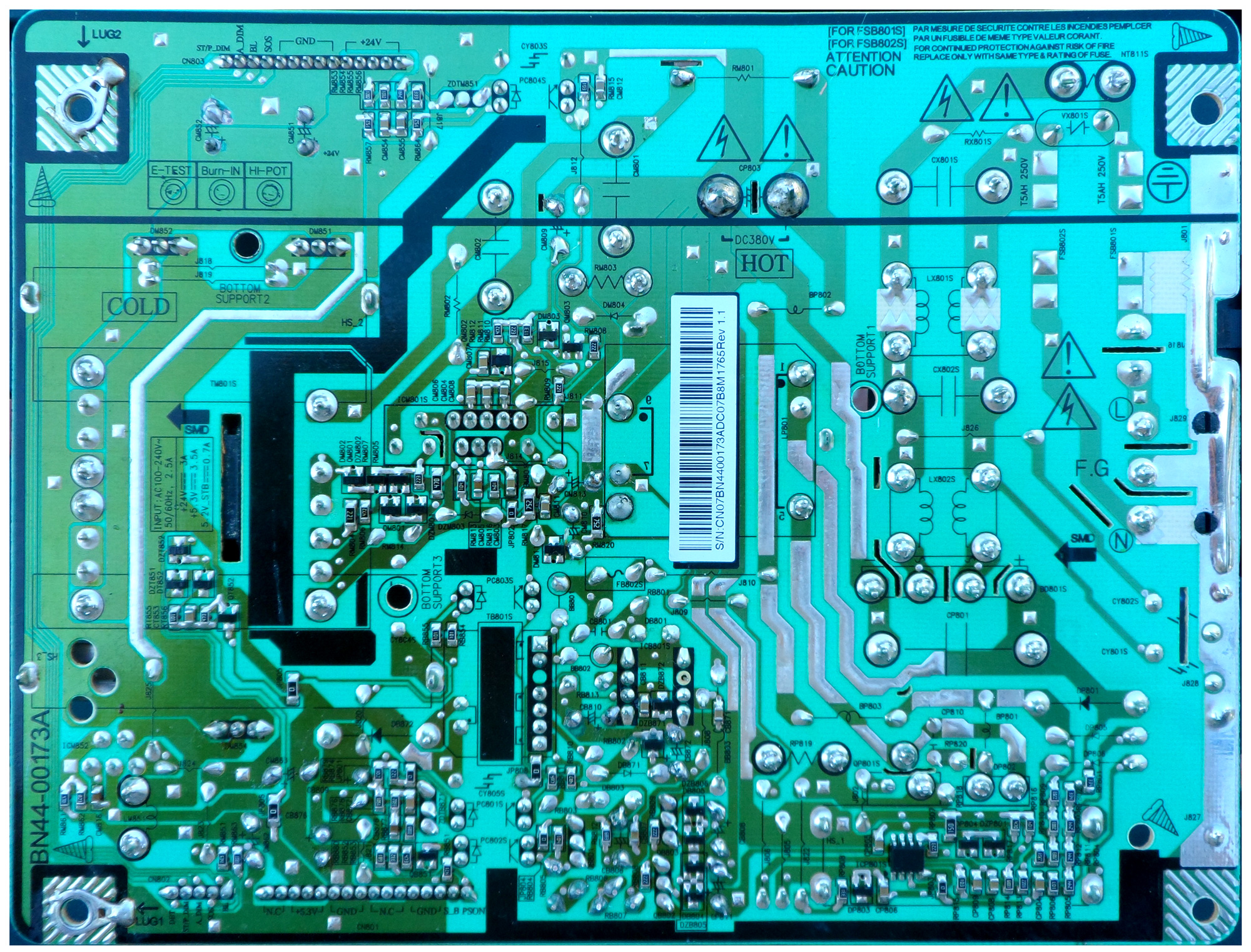

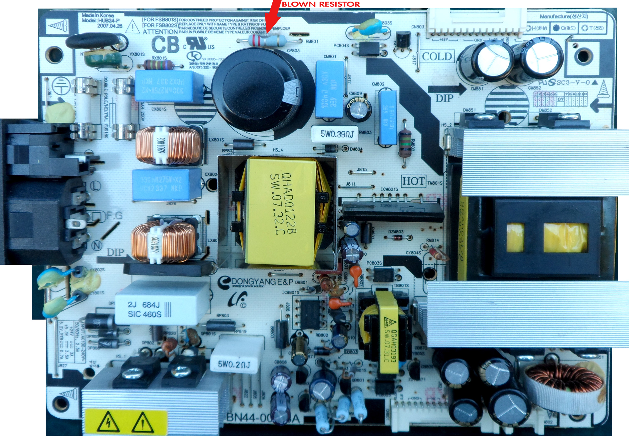

              Greeting everyone, seems I was a bit too optimistic while replacing damaged parts...
              My monitor is 245BW, PS boars BN44-00173A is bad… replaced the 3 resistors and all caps including 82uF CP803 and the blown fusible resistor RM801 but when I plugged the monitor into outlet I heard a big pop and few small pops... RM801 .22ohm 1w resistor blew again.... what I need help with is - what other parts should I check to find the short thats causing the RM801 to blow...
              I am not good at all reading the schematic diagrams... so if anyone has experience with how to trace the components and finding what parts are in line that need checking please let me know... I am good at some testing if guided properly and in replacing parts, just don't want to replace all parts, only the part(s) that is(are) shorted... or should I just buy a new(repaired) PS?... BTW, I read this thread and many others but could not find just the right answers...
              I am attaching pictures, really could use help with this one
              thanks
                #607
                Look for shorted out MOSFET inside ICM801.

                    You do resistance testing without power applied or plugged in, we are looking for really low resistance reading in both direction of the probes.
                    Shorted ICM801 will be the most likely component that shorted out. If you remove the IC, the resistor will not be blowing up any more.
                    pin 19 & 23
                    pin 19 & 4
                    The pin out of this IC is little difficult to count since some of the pins are trimmed off.
                    RM803 (0.39 Ohms) connected to the pin 4 may be damaged also.
