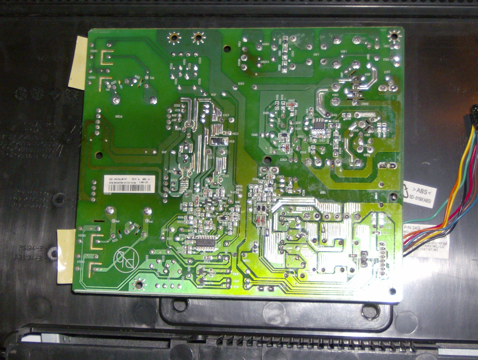

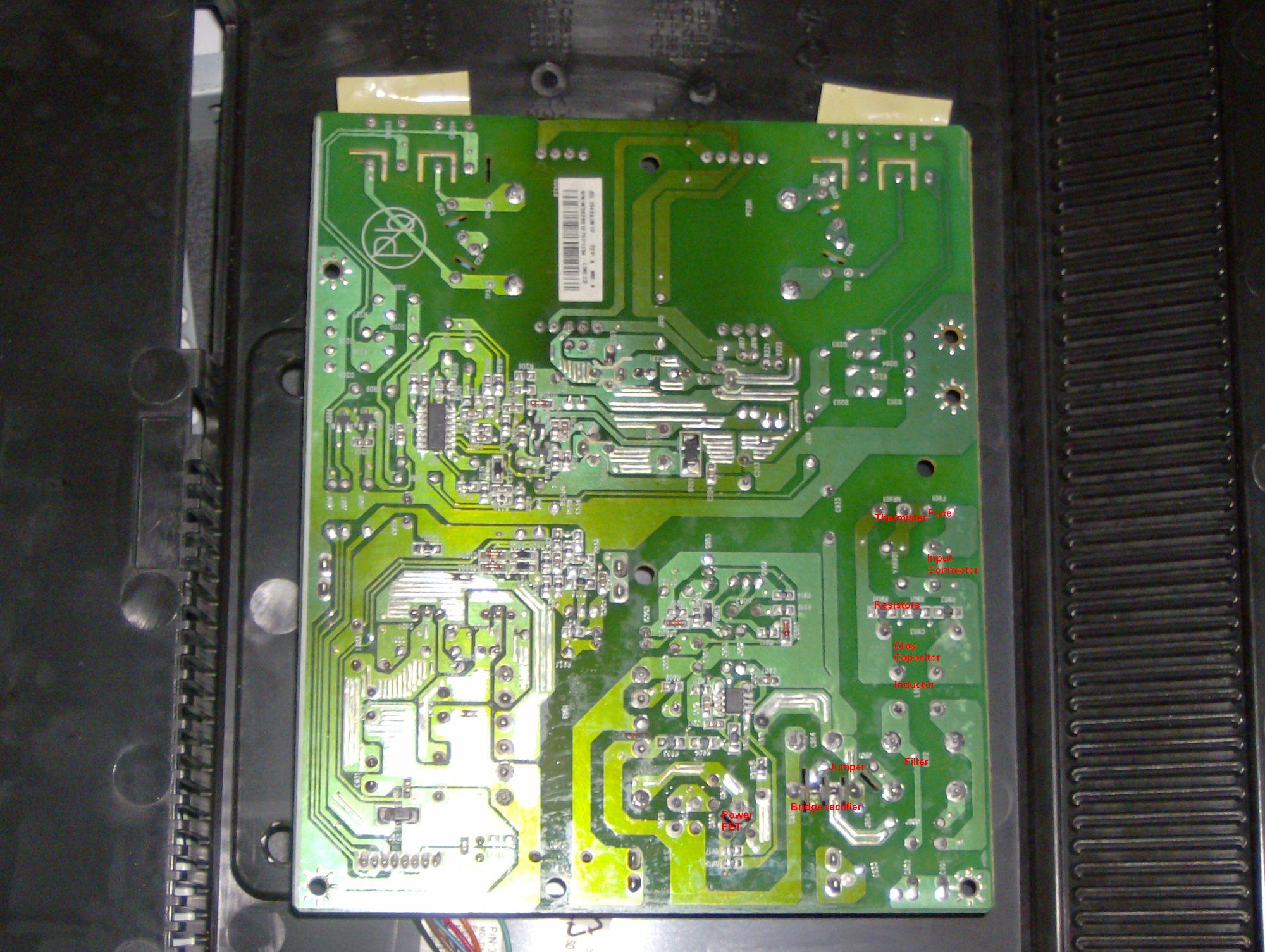

    I have a ViewSonic Model VG920 - No Display/No Power Light.
    Looking at the only other VG920 thread on these forums I did the first troubleshooting step, measuring the voltage on the large capacitor. No voltage.
    "In the case of a totally dead power supply, one quick test is to measure the DC voltage across the large capacitor. Note Toasty's comments on safety; those are minimum precautions. The voltage across the cap should be roughly 1.4 times line voltage. For the US you should read about 165 volts DC." by PlainBill
    I then unplugged the monitor, remove the PSU and tested the fuse. It is blown. I now know I will have to replace the fuse, but is there anything else I can look for before I order the fuses?
    I live in the middle of nowhere Kansas. I am aware more often then not a bad fuse is caused by other bad parts. Nothing really pops out at me looking at the board, but I'll include pictures, maybe you will see something I missed. I would like to order everything I might need at once. Any advice would be appreciated.

    I've identified the components in the power flow path. The most likely cause of the fuse blowing is the bridge rectifier. Other possible suspects include the power FET, and the main filter cap (the large black one lying on it's side.)
    Check the bridge by measuring resistance from each lead to each of the other three leads. If you use the 200 ohm scale on a DMM it should read open between all leads with the possible exception of the two end leads.

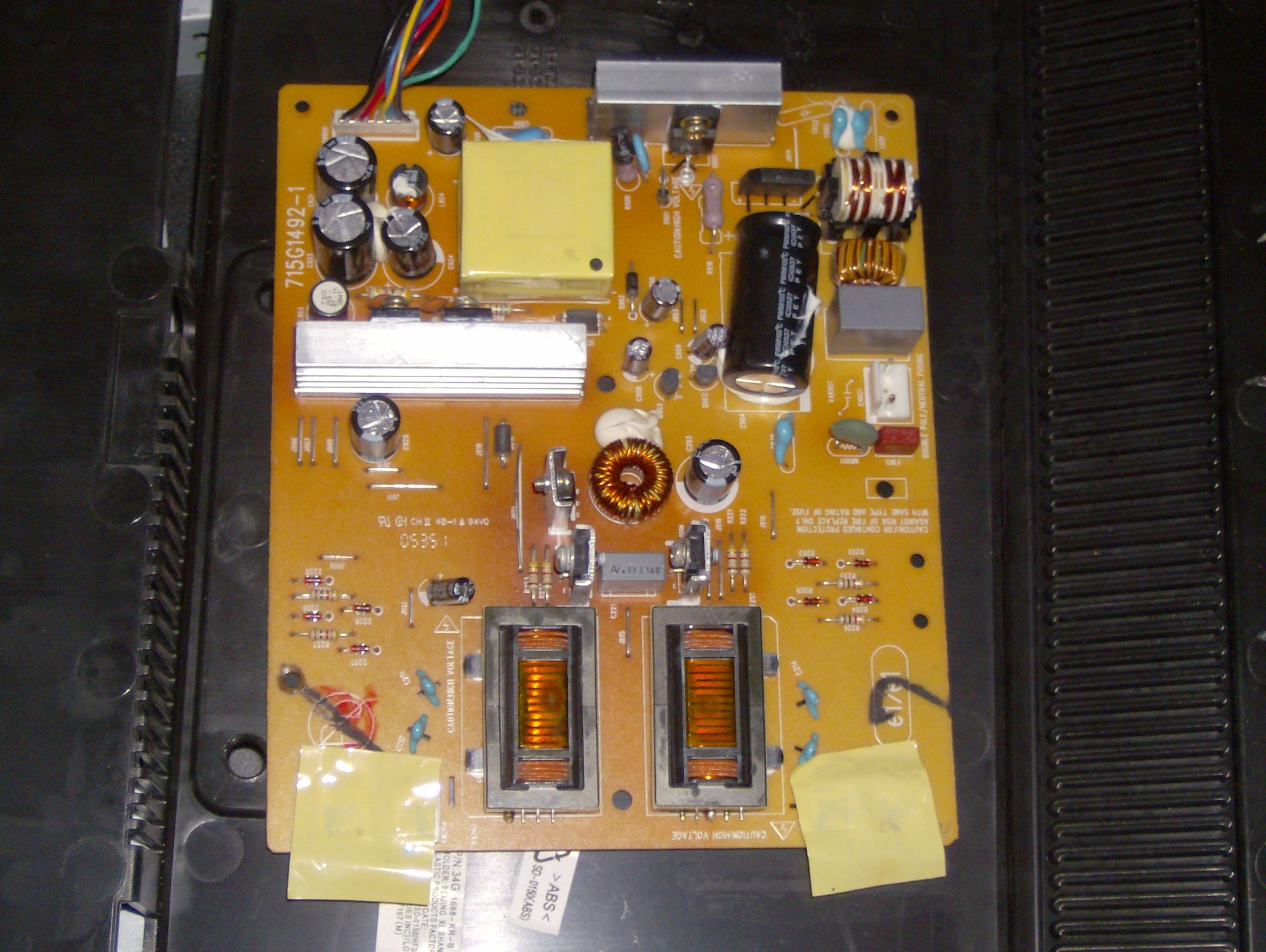

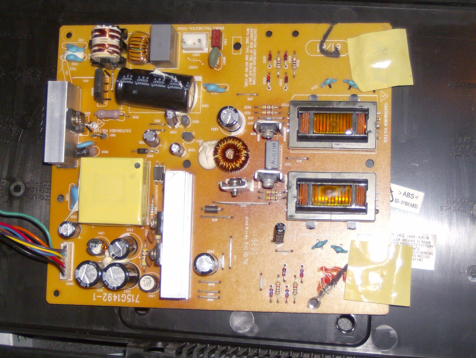

      Thank you for your response.
      I tested the bridge rectifier with my DMM and all leads read open. I assume this means it is good?
      If I remember my basic electronics class from more then a decade ago FETs are tested with an Analog MM, all I have is a DMM. I am not sure why I remember that, and I may be totally in left field because I cannot think for the life of me why it should matter. Either way I do not remember how to test the FET. Do you suggest that I just replace it? Or is there more troubleshooting you wish me to preform first?
      Also will badcaps.net have all the parts I will need?
      Thanks again for your help.

                Well, sorta. The idea of the bulb is to limit current. If the bulb glows at full brightness, there is a problem that we have not identified yet. If the bulb varies in brightness; or if it starts off very bright, then dims, there may not be a short.
                One thing I forgot - measure the resistance of the thermistor. It's in there to limit surge current when the monitor is plugged in. If that shorted, the initial surge could blow the fuse.

                                      Odd part is that it is a 250v fuse, so that is one huge power serge to take it out and nothing else. Of course more then 2A would take it out too, so who knows.
                                      A few words on fuse ratings. The voltage rating is the voltage that they will interrupt without arcing. Actually, I believe it is a fraction of the voltage they are tested at. IIRC, the standard test for a household 15 Amp fuse was hitting it with 2000 Volts at 500 amps. It had to 'blow' without exploding. That 2A 250 volt fuse wouldn't have any problems operating at 500 or even 5000 VAC as long as the current didn't exceed 2 amps.
                                      PlainBill
                                        Re: ViewSonic Model VG920 - No Display/No Power Light
                                        Thanks for the info and the help. New Fuse arrived last week. The monitor has been running great for 5 days now with no additional issues. It appears to have just been a bad fuse.
