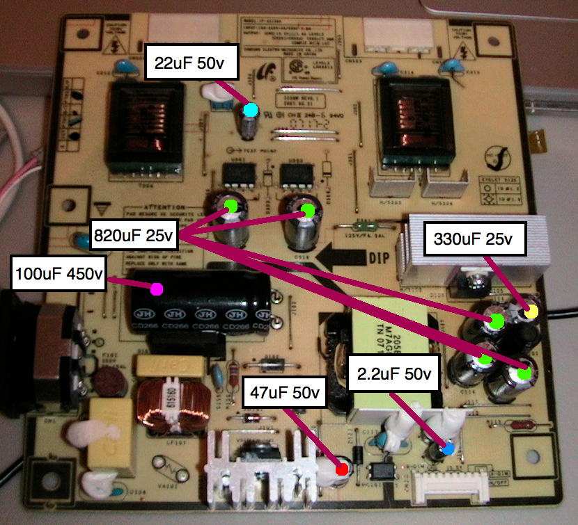

    Hello. I'm going to try and attack several question in a single post. For starters I am somewhat new, yet not at the same time...

    So now the repair steps. I have disassembled the monitor and gotten myself into some trouble, sort of. For one the power board has caps that are not perfectly flat. Not brown fluid, but bulging CapXon caps. A few of these caps are flat, the very little ones from what I'm seeing, and Big Bertha laying on her side glued down. From what I can identify is as follows:
    CapXon:
    5 - 820uF 25v (Green)
    1 - 100uF 450v (Purple)
    1 - 22uF 50v (Baby Blue)
    1- 47uF 50v (Red)
    1 - 2.2uF 50v (Blue)
    1 - 330uF 25v (Yello)
    By disassemble I mean literally everything taken apart. I was wondering if anyone know of a schematic manual to a general LCD setup… or this specific monitor (Samsung SyncMaster 216BW)… I'm just worried that I've messed up the order of the plastic polarized sheets that lay over the plastic panel below the actual LCD panel. Although guess and check should solve the problem.

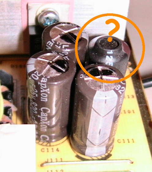

    I also have a question of this rogue black cylinder-ish cap sitting in the cluster of 820's. What is it? Should I replace it? Image is attached with a big orange question mark.

    1. Do I replace each cap, including the behemoth 100uF one? The 2.2uF and the 330uF were very hard to read, do they seem correct? I'm 99.9% sure of the 2.2 but not of the 330, an experts reassurance would be awesome. I'm assuming each cap is ceramic? What brand should I use?
    2. Mystery cylinder, what is it? Replace?

    0. Read this in the FAQ section.
    1. These are electrolytic caps. I suggest replacing all except the 100uF, 450 volt one. Others say replace the 100 uF one too; they may be right.
    2. It's an inductor. Don't bother replacing.
