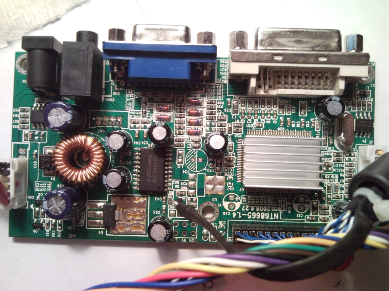

    This monitor was knocked over by the household kitty (another reason to have a dog). It caused the connection where the external power supply connects to be a little loose. The owner tried to fix it himself, and it worked for awhile, but eventually it must have shorted something out.
    The power supply tests at 12.5v. I found bad caps at EC1 and C58, both 470uf, 16v, on the power board. I had replaced these and powered it up.
    When turned on, the power board/inverter connection shows proper voltages, but the on/off wire is not on and the red power led flashes. I then found another bad cap at C5, 220uf, 25v, on the inverter.

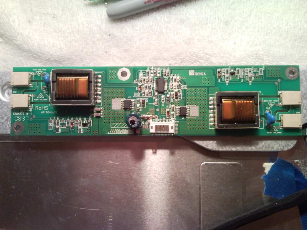

    The inverter also has a blown fuse at F1, not sure what size.
    There are two 8 pin smd's on the inverter board labeled U1 and U2. When I test them with the ohm meter two legs across from each other on U1 show a closed circuit, which is different from U2. B3942, C8501, T0820 is what is printed on each of them, and appears to be a mosfet?
    I am learning electronics and have only gotten to this problem a couple of times and am in over my head. Can someone help me with what steps to try next to figure out if this can be repaired within reason before trying to replace one or two parts at a time and hoping it will work? I realize something shorted to blow the fuse, but is it the mosfet, or does something else short that causes the mosfet to short also, could there be a dozen components that also got shorted?

    Just for kicks I tested for shorts in the transformers at T1 and T2 on the inverter bd. Both showed .8 ohms with the meter at 2k, across the secondary.
    T1 on the primary side showed the bottom 4 leads all closed (with each other), and the top 3 open.
    T2 showed all of the primary leads closed with each other except the 3rd leg from the top.
    Don't have a flyback tester...

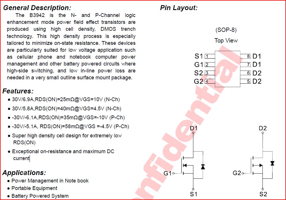

        I am having trouble finding the replacement mosfets. The number is B3942, and I have attached some info from a datasheet (the complete pdf was too large to attach), but I don't know how to find a suitable alternative.

              Something is shorted out on the inverter board. I don't have the best tools for working on a board like this. Does anyone have a spare they would like to sell? The part number on the back of the board is Honja, HI04AO-7A3. A pic is in the first post. Thanks.

                        Sceva only supplied a partial datasheet, and I haven't had any luck identifying the original part. The part doesn't seem to list the design voltage and current, and I'm not smart enough to figure out what they are from the data given.
                        What you are looking for is a dual N and P channel MOS FET an SOP-8 (or 8-SOP) package. A POSSIBLE replacement part is the Rohm SH8M24TB1

                          I don't have the datasheet any longer, but here is some info I found that might help in your search:
                          B3942
                          30V/6.9A,
                          RDS(ON)=25m&@VGS=10V (N-Ch)
                          30V/5.8A,
                          RDS(ON)=40m&@VGS=4.5V (N-Ch)
                          -30V/-6.1A,
                          RDS(ON)=35m&@VGS=-10V (P-Ch)
                          -30V/-5.1A,
                          RDS(ON)=58m&@VGS=-4.5V
                          Super High Density Cell Design for
                          Extremely Low RDS(ON)
                          Exceptional On-Resistance and
                          Maximum DC Current
                          SOP-8 Package

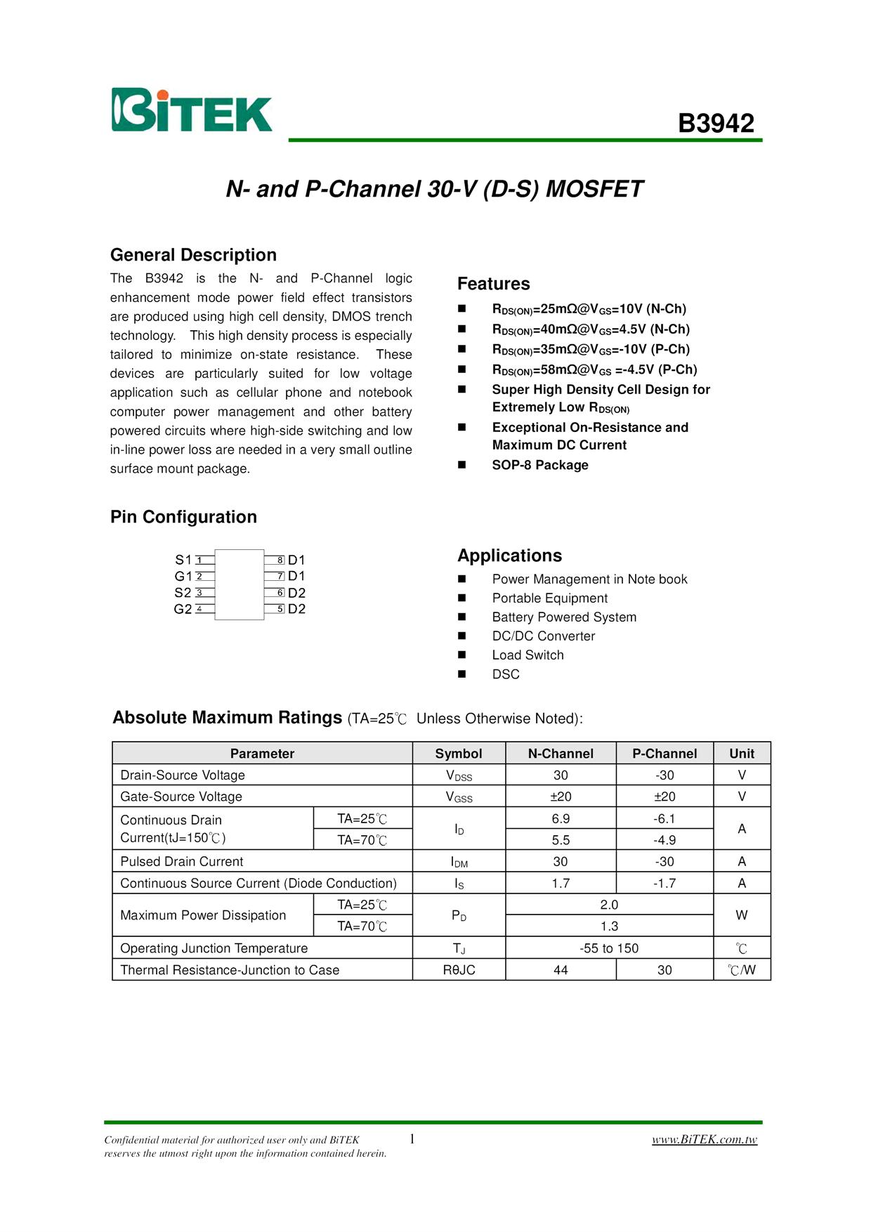

                            Original datasheet at
                            page 41 at (long URL at google docs, hopefully it cut and pastes properly)

                              Will this help
                                Re: Westinghouse TW-80001-S024A Flashing red power led
                                Originally posted by bonney View Post
                                Will this help
                                Yes, it does. We're looking for a dual N-channel P-Channel mosfet in a SOT-8 package rated at 30V and 6.9A (N-ch) and 6.1A (P-ch). The Rohm SH8M2TB1 might work, but the maximum current is rather low. Mouser doesn't seem to have anything at all that meets the description.

                                  Have a look at Fairchild Semiconductor FDS8958A

                                    Those have enough current capacity. I have two reservations about them. The package appears to be different 8-SOT vs 8-SOIC and this has logic level inputs. I'm not sure what kind of inputs the original parts have.

                                      I use an fsd8958a on the place off b3942 and work fine to me.
