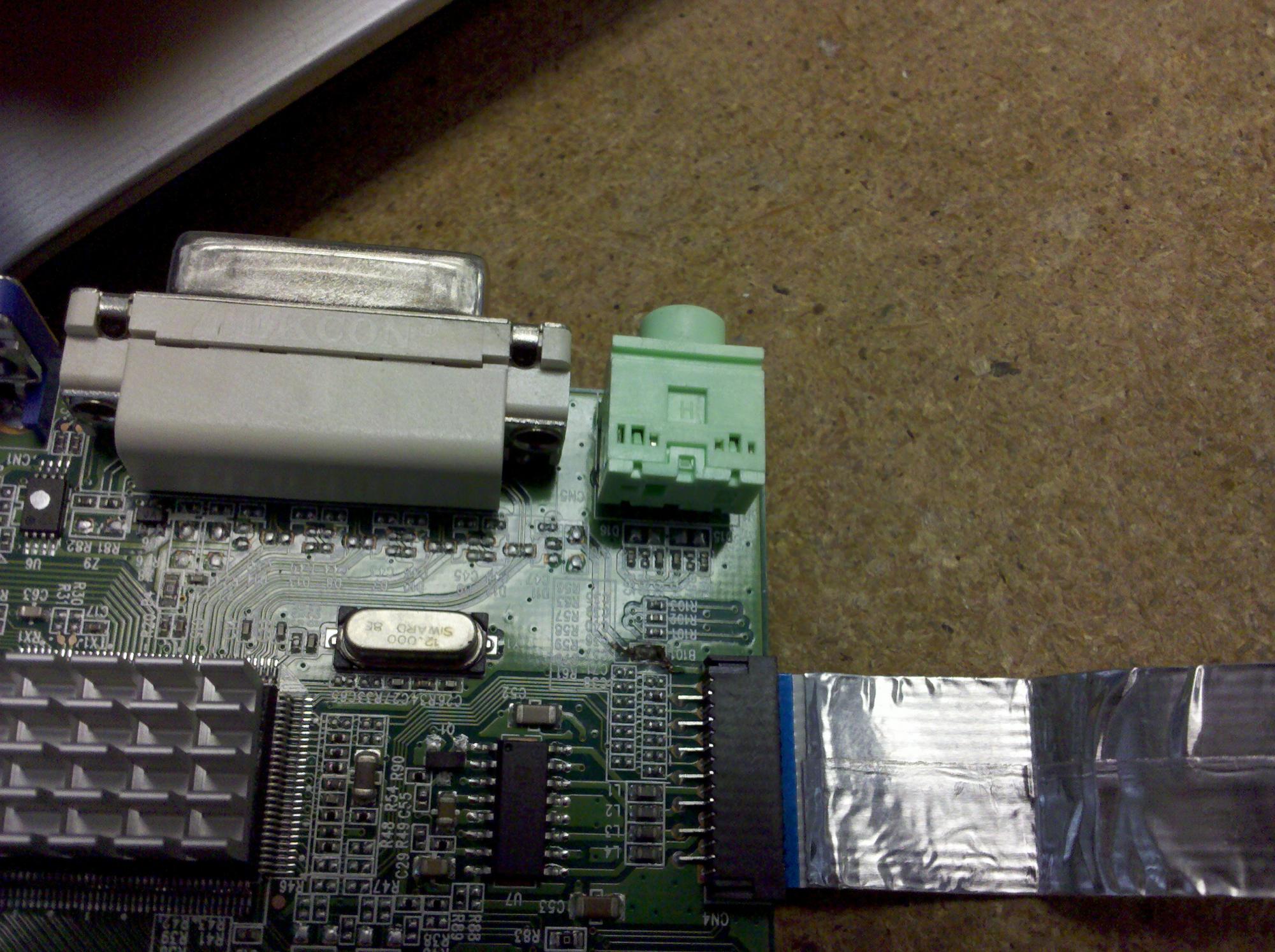

    here is a pic of the burn
    • testas86
      • May 2010

      Re: WestingHouse L2210NW Will not power.
      thats at b101
        Originally posted by testas86
        thats at b101
        Pic is out of focus. Take your board to a window on a sunny day. Turn off flash and enable macro mode.
        Again, you don't have to put the pic inline.

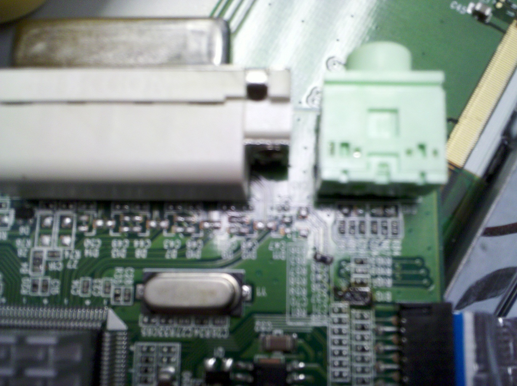

            Here is a better pic of the burn on the logic board sorry for the delay
