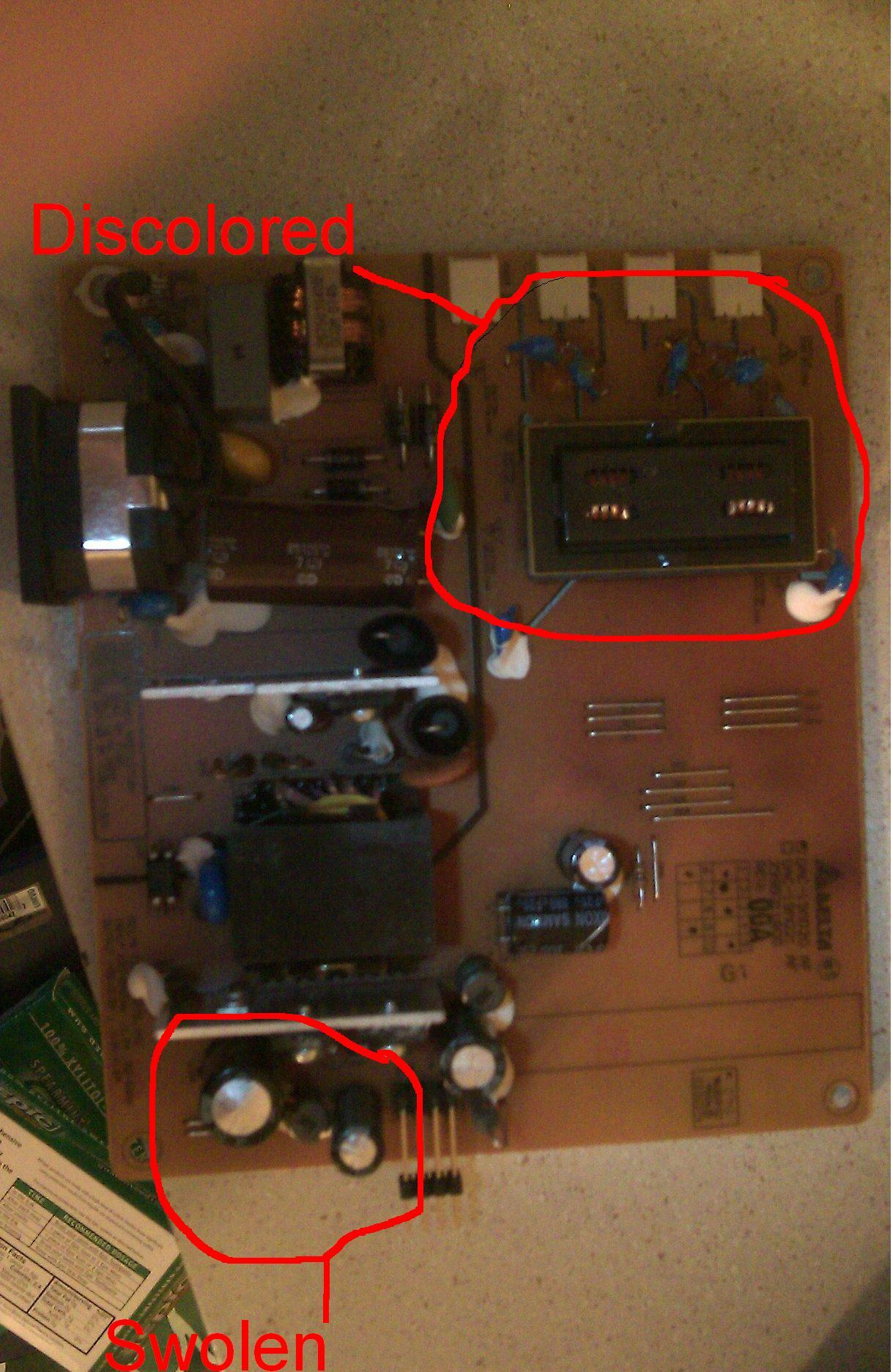

    So, there I have a Westinghouse L2210NW 22" Monitor that will not power on. It has the "Touch control" buttons, so all of the monitors controls (including power) are of a capacitive touch nature, so I'm hoping this didn't go out on me.
    When plugging in the monitor, I can hear a high pitched noise emitting from it (had a similar symptom with a Gateway 22" monitor, turned out to be a bad cap).
    I dissembled the unit and saw that the power board had 2 or 3 capacitors that were slightly swolen (the vent had not broken, they were just bowed out a millimeter or two). But the PCB was also discolored near the AC power jack (Not dark brown burned level discolored, just a little browned.) However, all of the solder points and traces on the board appear to be undamaged.
    I don't have pictures to post right now, but I will be able to post them later today. I was just wondering if anyone had experience with a discolored power board, and if it was a cause of failure. And also to ask if a capacitor is silghtly swolen, and the vents are not broken, do you think that they have been struck by the plague? Or should they still function at that point.
    Just seeing if it's worth throwing $10 in caps into it, or if I should buy a new power board entirely.

    I'd say it's worth throwing $10 in caps into it. Anyone with an ESR meter has checked caps that look perfect but have an ESR ten times spec. And I've seen a few with a bulging top (even vented) that still meet spec. The only exception would be if you had a source that would sell you a guaranteed power board for less than $15.
    One point; sometimes the problem with the power jack isn't the solder joint to the circuit board. The standard assembly technique is to rivet the center post through the plastic housing and into the tab that gets soldered to the circuit board. If the plastic gets hot or shrinks the center post no longer makes good contact to the tab and you have an erratic connection.

      Yeah, I'll pick up some caps and give that a shot. They are CapXon caps, so even if that wasn't the issue, since I already busted the monitor open I should probably replace all of those regardless.
      I'm mostly just hoping that it isn't the "Touch Controls" that went out.
      I'm probably not going to get much farther without pics, and I'll post those in about 4 hours. Just wanted to see if the thread could get a little attention =).

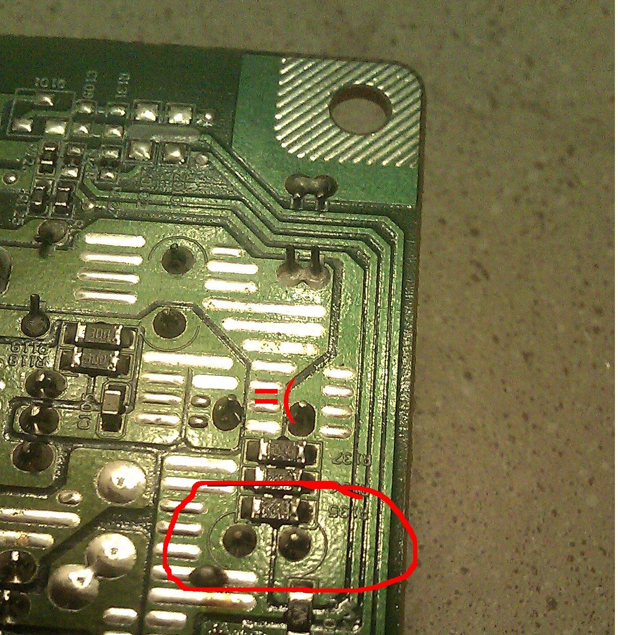

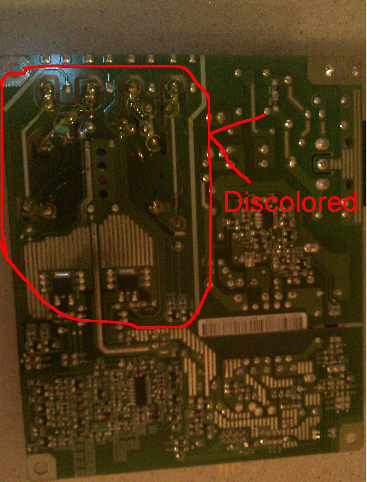

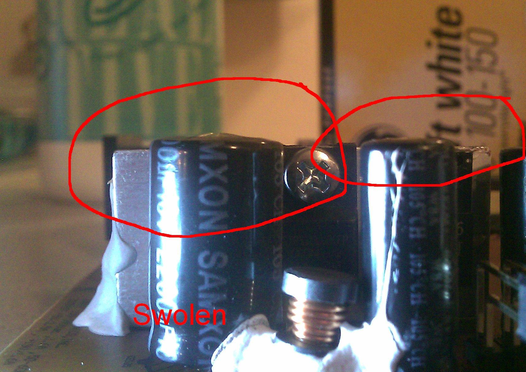

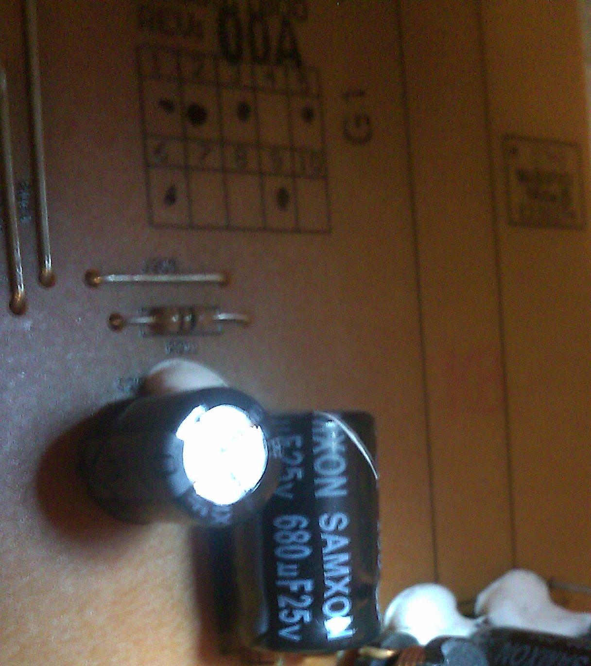

        Okay, here are some pictures. The discoloration appears to be minor, but that is just my opinion. you can see that there are two capacitors that are slightly swolen, and I was mistaken about the brand, it is Samxon.
        Also, one of the capacitors solder points is about 1mm away from another trace, I'm worried I might mess that up with a solder job.
        Let me know what you think.

          That whole board looks kind of unhealthy. I'm going to suggest a series of tests. At this point you haven't really specified what you have tested.
          It's late, I'm going to be lazy and just describe what I want tested. If I'm not clear, let me know and I'll mark up some pictures. I'd prefer you didn't electrocute yourself.
          1. CAREFULLY measure the voltage across the very large cap with the AC connected. It should be about 1.4 x the AC voltage.
          2. At the connector to the logic card, measure the voltage from each pin to ground.

            I'm going to recap the board (because I have new Rubycon caps of the same microfarad rating and greater then or equal voltage just hanging out in my closet, Might as well.)
            So, I have a multimeter, but I have no idea what settings to put it on to test the big cap (because I'm a noobie, I've just fixed some easy to solder components in the past). I also don't know what setting to use for the logic card connector pins.
            As far as what I have tested: My patience in opening up this monitor (held together by tape instead of screws, I'm totally not joking) and that's about it =(
            Sorry for my lack of knowledge, but thanks for the help =)

                So, upon looking at the power board, it's just pretty much totally screwed. There are a couple of parts that are physically broken (snapped) and I'm just going to get a new power board off of eBay for $50.
                Does anyone maybe have a better recommendation for where to get this power board?
                It's a DAC-19M020 AF.

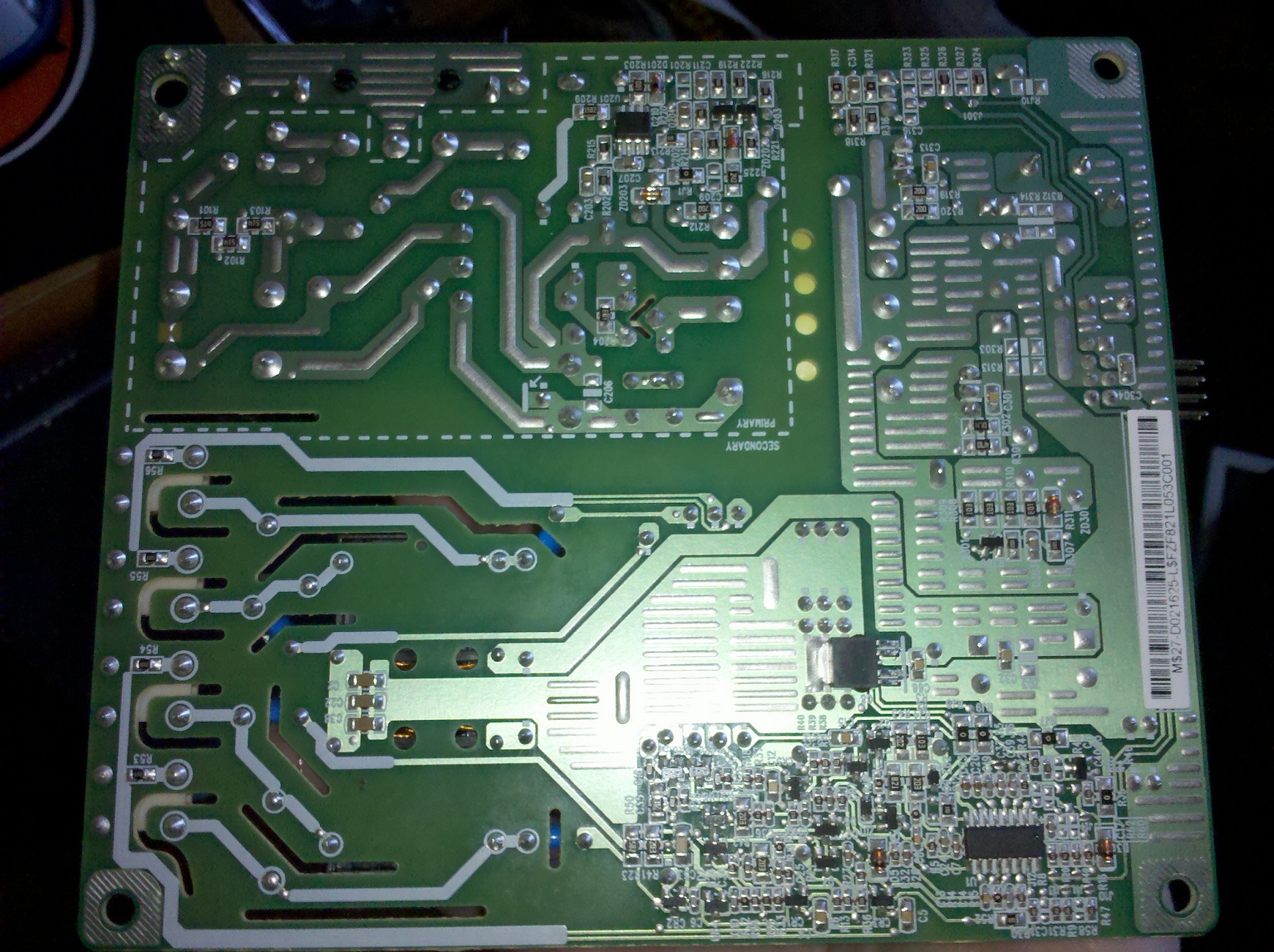

                        Re: WestingHouse L2210NW Will not power.
                        Thank you so much for the link to the tutorial on how to test the board a little more then i knew how. So while i was doing the tests it looks like two of the transistors are shorted out. I have the part numbers and ive been looking on the internet now how to find them but so far im at a loss the information on these transistors is:
                        nec k3113 82ks13
                        lt 8217 sbf1060ct
                        lt 8216 stpf1020ct
                        ill provide pics of the logic board in a few mins

                            also is that line supposed to be one that black box?

                                    i was talking about on the first picture top left the rectangle thats black and has yellow trim
                                      nec k3113 82ks13
                                      lt 8217 sbf1060ct
                                      lt 8216 stpf1020ct
                                      Because of the small size and limited area, manufacturers use codes to label their chips. The first one is found at
                                      http://pdf1.alldatasheet.com/datashe.../2SK3113B.html
                                      For the last 2, I'll need a close up picture to id them.
                                      If you measured them in circuit and found them shorted, remove them and retest them out of circuit to confirm they are shorted. You will have to remove them anyways for the replacements. Just take a picture or mark up the board so you remember which way they are installed.
                                        Unsure. It could be like that or it could be heat related. It is called a transformer by the way.
