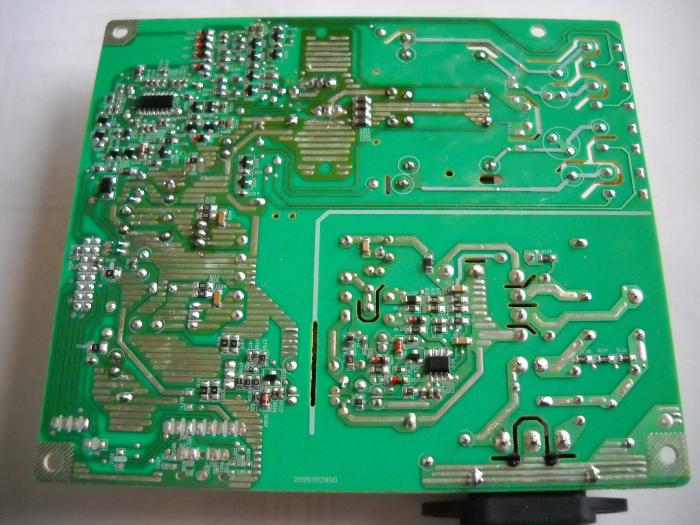

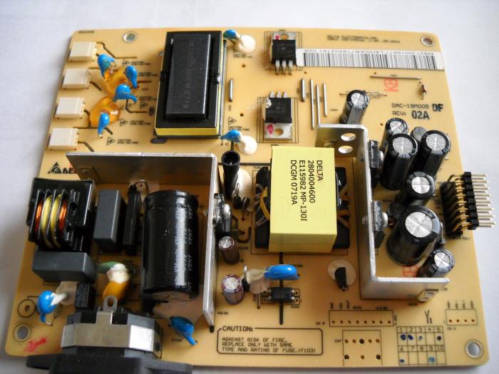

      Here are the pictures of the boadr and yes I know that F200 is not on the board, I took it off during testing.

        Hello "Frank"! After looking at your photo, it looks like your monitor uses the same power supply/inverter as the Westinghouse L1975NW. There's quite a long thread concerning this monitor at:
        https://www.badcaps.net/forum/showth...hlight=l1975nw
        Hopefully, you can get some good info from it. Please keep in mind that this thread covers the "AF" version versus your "DF" version and I'm not sure what the differences are.
