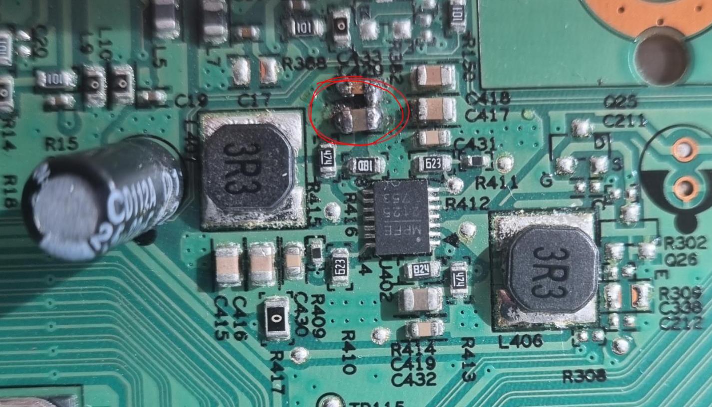

    Originally posted by lotas
    What is the voltage across these chokes?
    And what is the resistance between gnd. If the capacitor is short-circuited, the dc-dc converter U402 could burn out.
    0.91v between the chokes. Right ones resistance is 144 ohm and left one 0.4 ohm.

      Re: Asus vg248qe purple light problem
      0.4 Ohm is a short circuit, unsolder these two capacitors, which I soldered to the board and re-measure the resistance on the left choke
        And you need to measure the voltage at each choke relative to gnd, and not between them
            Which caps do you mean?
            these
              Voltage between GND
              L406 has 1.23v and 1.21v
              L407 has 0.21v and 0.29v
              Resistance
              L406 has 300ohm and 300ohm
              L407 has 1ohm and 1ohm
              Removed the two caps and measured
              L406 has 137ohm and 137ohm
              L406 has 0.94v and 1.2v
              L407 has 0.08v and 0.2v
                On the L407 - 1 Om, this is very small (short circuit) on this bus, there are two options, either the U402 MP2125 microcircuit itself burned out or something that sits on this bus ceramic capacitors ...
                It is necessary to unsolder the choke L407 and check the resistance at both points relative to ground.
                  Took off L407 and resistance relative to ground from upper choke 0.3 ohm and bottom choke has 220 ohm

                    #29
                    Not easy to get the MP2125 ( https://www.monolithicpower.com/en/mp2125.html )
                    Any alternative which would fit?
