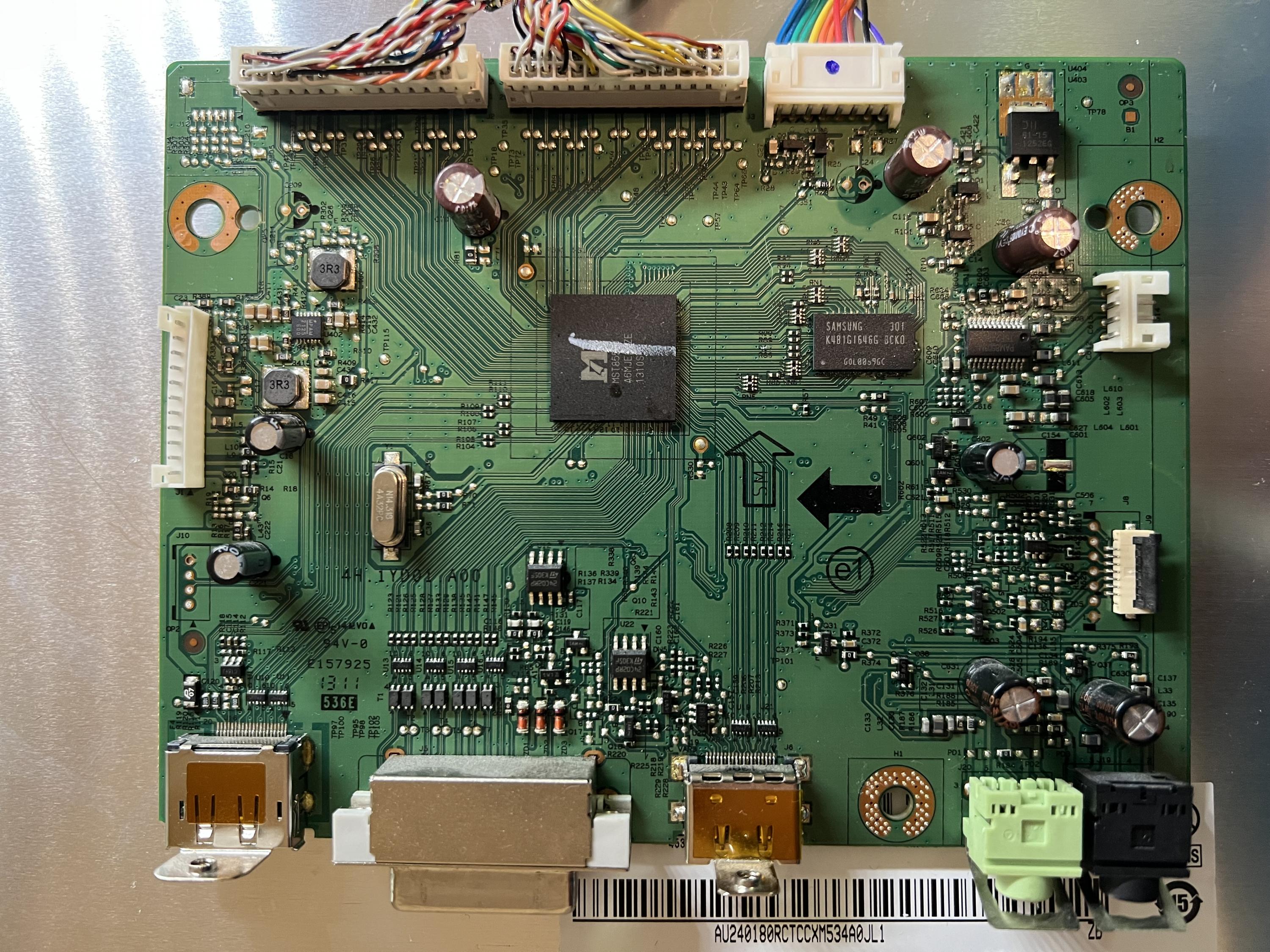

    I have an Asus VG248QE that all suddenly stopped working. Everything was fine, I had my PC connected to the HDMI port and never had any issues. Then I decided to plug a laptop in the DisplayPort (USB-C to DP cable). It worked fine for a few hours, I left, at some point the monitor went to sleep mode and when I came back and moved the mouse monitor didn't wake up. The power button lights up in blue when the signal is good and amber when in sleep mode / no signal turned purple (first time I saw that). Did some research but couldn't find a way to bring my monitor back to life. So far, I tried some basic steps:
    Replaced power cord, replaced DisplayPort cable, tried to connect a couple more PCs / laptops to different ports in the monitor using different cables, kept all cables and power cord unplugged for a couple of days but no luck. Before this issue, every time I plugged in the power cord the screen would show the ASUS logo, this isn't happening. Also, none of the buttons do anything (like I can't bring up the monitor menu as instance)
    Now, there's something interesting. If I unplug all cables but keep the power cord plugged in, the power light doesn't turn on. If I REMOVE the power cord and plug in DisplayPort cable, the power button lights up purple, even though power cord is unplugged.
    I read that a purple light could indicate some "safe mode / locked state" in the VG248 series but not sure if that's the case. I contacted Asus and they told me to send the monitor in so they can take a look.
    Anyway, I decided to open the monitor and look inside. I'm not a pro but I do have some (very) basic electronic / soldering skills, just enough to see if there's a broken solder or a "fat" capacitor, burned circuit, etc.
    I don't see any capacitor that's evidently bad, but I see some white dried out leakage maybe or some white powder, I'm not sure exactly what that is but I was hoping maybe someone could help me try to point what could be the issue.
    I'm attaching front and bottom picture of the monitor's mainboard.
    Thank you all in advance!
