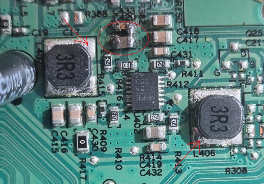

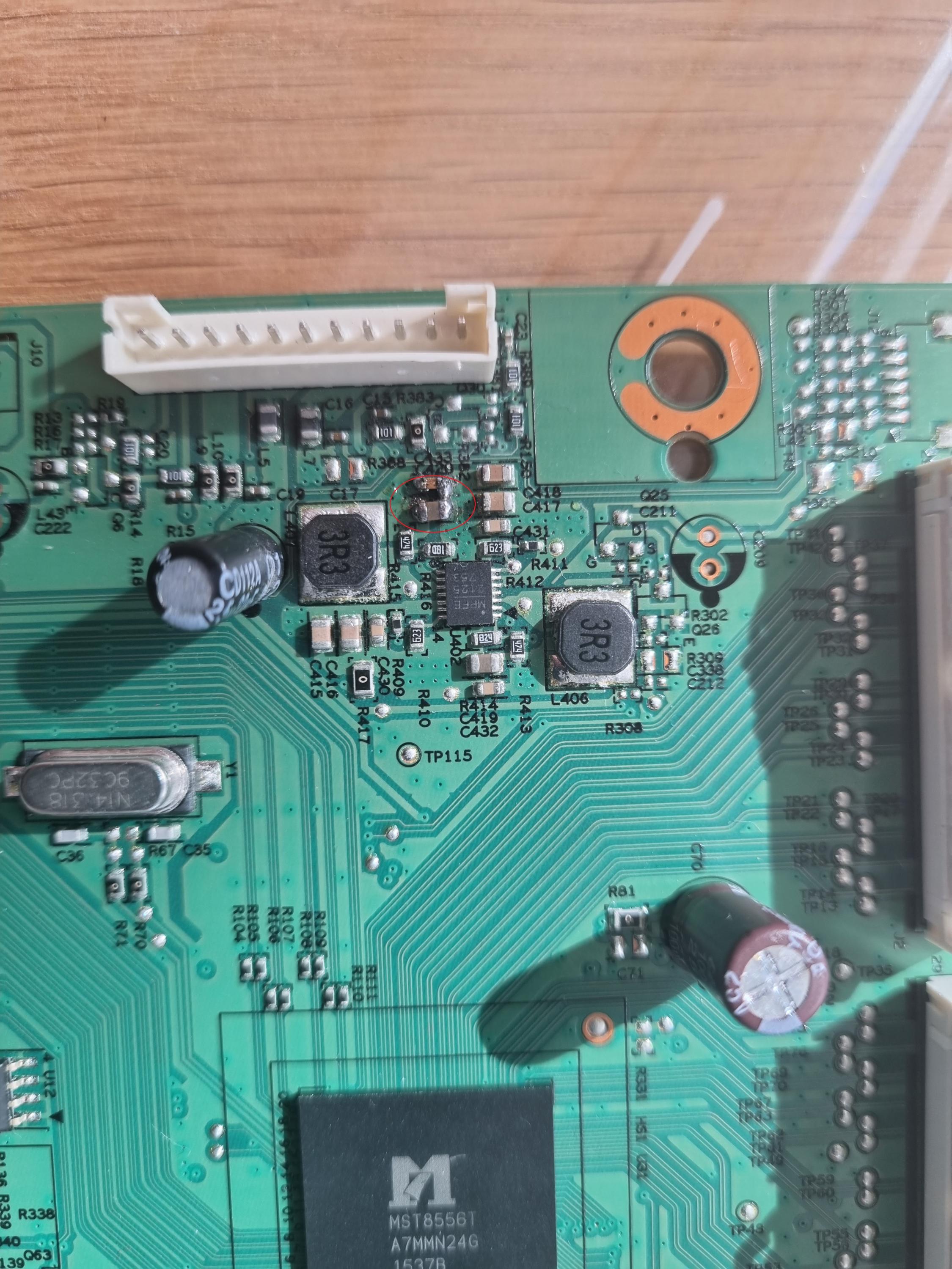

            Of course, first you need to check the compliance of the voltages 5/3, 3/1, 8. Well, show a photo of the damage site
            • Rennokas
              • Apr 2013
              • 20
              • Estonia
              Re: Asus vg248qe purple light problem
              Added some pics, the C420 and C433 (red circle around) were the ones that were short circuit / missing.

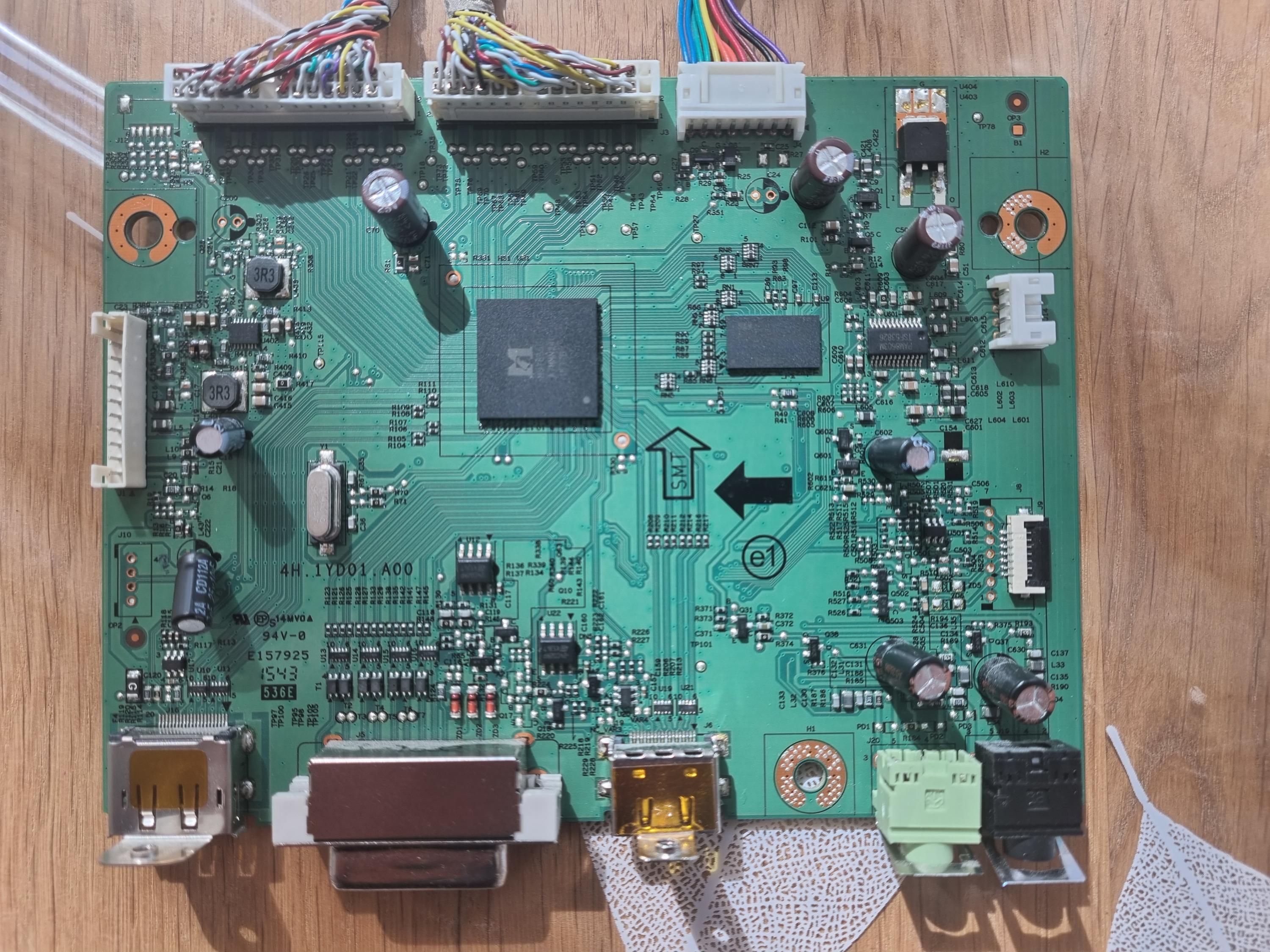

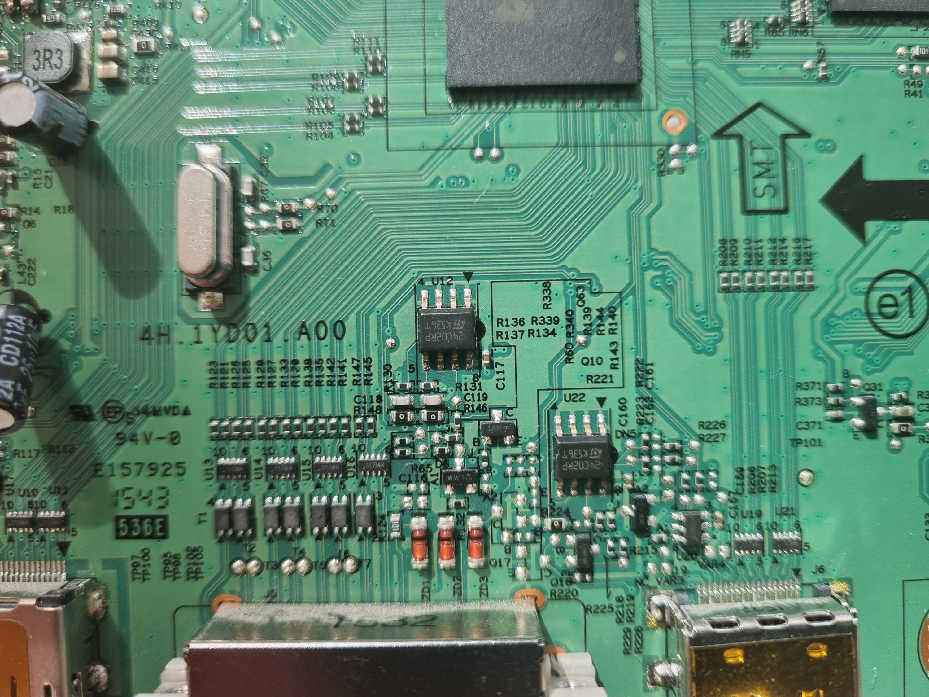

                I suppose the EPROM ones are the 2x 24C02RP chips on the last pic?
                • lotas
                  • Jan 2016
                  • 4459
                  • Russia
                  This is the eeprom EDID, most likely the spi and eeprom are on the back side.

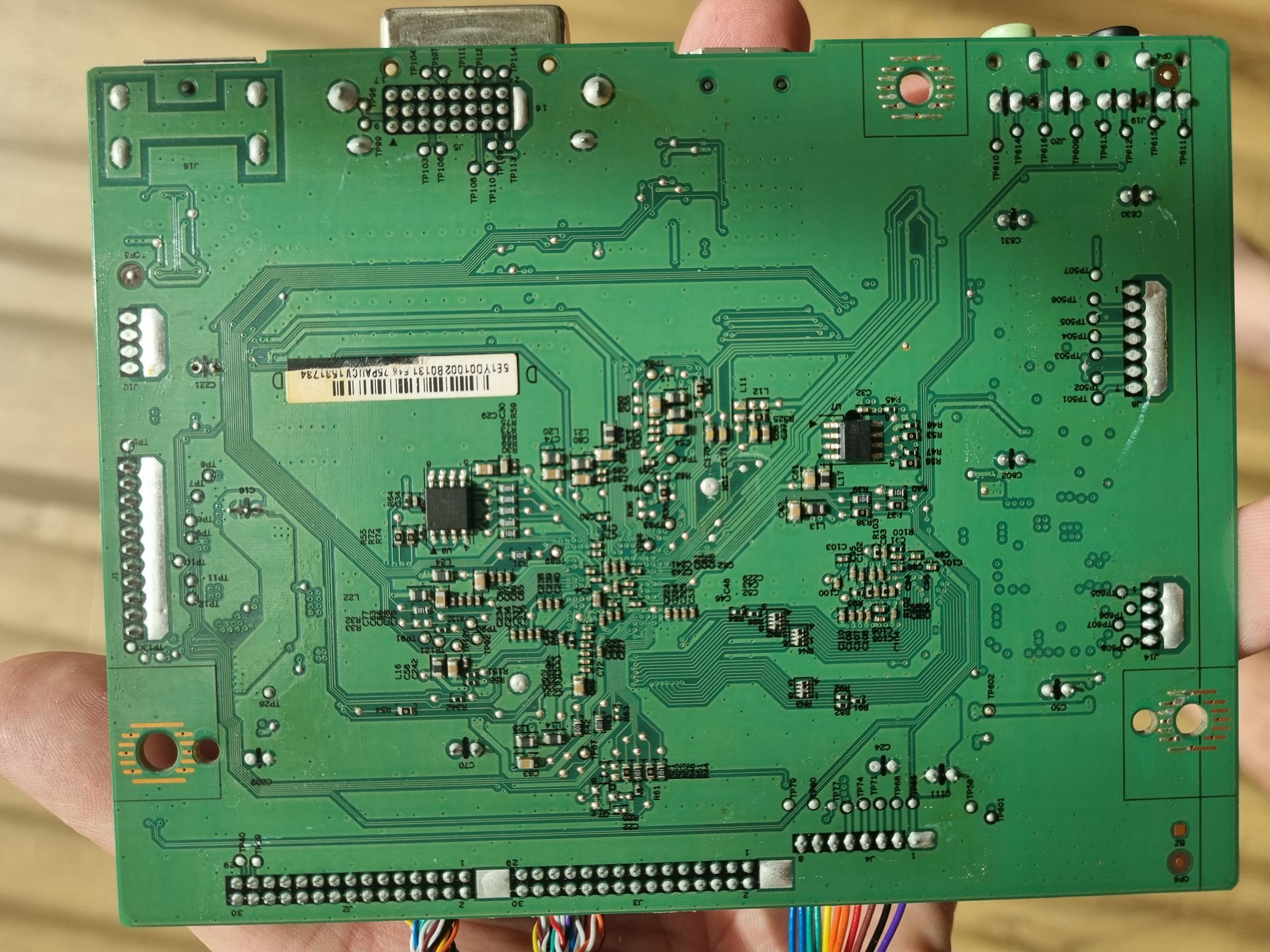

                    On the back side there is one 24C16RP
                    Added pics of the other side aswell.
                        U8 marking ?
                          24C16RP is an eeprom, there is 25L1606 next to it, this is an SPI flash in it and the monitor's firmware is located.
                            Originally posted by kasfamily
                            U8 marking ?
                            U7 is 24C16RP
                            U8 is 25L1606E (or smth, last letter is somewhat faded)

                                        What is the voltage across these chokes?
                                        And what is the resistance between gnd. If the capacitor is short-circuited, the dc-dc converter U402 could burn out.
