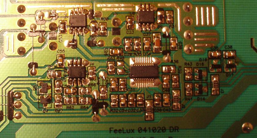

Those results indicate that your FETs are good. No need to replace them or test them out of circuit.
If this were me, I can see 2 approaches.
1) Since I have 5 identical monitors, I can take them all apart and try to make one good one by swapping boards, cables, lcds, panels, etc until I make a working one.
With this good one, I can then use this as a baseline for voltage measurements and something to compare to. I also have a known good working configuration.
This would make troubleshooting the other bad ones much easier.
2) Randomly pick 1 of the 5. Troubleshoot the 1 logically and methodically.
If you choose 2, post clear focused pictures AFTER reading
https://www.badcaps.net/forum/showthread.php?t=1868
Please do not post pictures inline.
Take your boards to a window on a sunny day, turn flash off, and use macro mode. Take a top down view of all your boards (front and back). Make sure the photo is legible so that we can read the PCB printing clearly. A shutter speed of 1/125 or faster will produce nice clear focus pictures. Try to get a photo that is 2000x2000 resolution or as close as possible.
Here is an example of the pictures we want.
https://www.badcaps.net/forum/showpo...94&postcount=1
