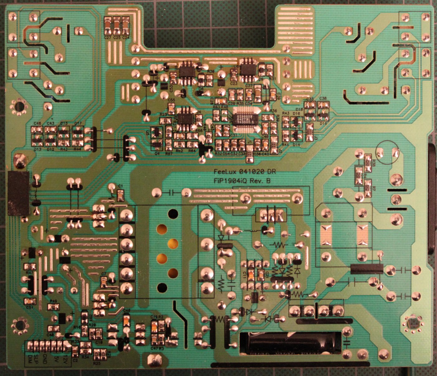

    I recently found a dead 19" Hyundai L90D+ that I really would like to fix and I think I'm getting closer to this.
    Here is what's the problem : just after plug in the power cord, the blue power led turns on. About 5 seconds later, this same led quickly turns to orange and everything shutdown like if a short has come (I can also hear a tick at this time). So, this process restart and loop forever. No Backlight at all.
    Looking to the power/inverter board doesn't show me bulged caps, and anyway it looks like more a MOSFET issue.
    I disconnected it from the logic board, the ticking stop and I get a good 12V and 5V at pins header without shutdown.
    Then, I hooked SLP to 5V and the backlight starting to flash.
    This drive me to the solder side of the board where I can find two dual NP mosfet (U4 and U5) named APM9932 (datasheet here ). Looking closer, I can also see a damaged smd capacitor just nearby U5 (C23). So I suspect something in that area to be the failure.
    Since I cannot find service manual for this monitor, I don't really know what value is C23 nor what kind of mosfet can substitute these APM9932 (can't find them on Digikey or Mouser). And anyway, I'm not an hardcore mosfet calculator.... :p So I need your help on this point !
    Am I right on what I have done ? Any advices else ?

    to solve one of your problem C53 and C23 should have the same value. The circuit is symmetrical. As for the AP9932 try FairChild website cross reference

      Test the driver FETs with a DMM are either of them shorted?

          Just try this, and it seems that U4 is shorted on P channel. I've got 0v from D to S and S to D, that's it ?
          Thanks to ecking767 and dondrusco for your tips guys ! I do not know this ability on Fairchild website ! Unfortunately, it doesn't return me anything with APM9932.
          So, a 0.1 uF capacitor for C23 will be good ?

                    I got 7 of the L91D in with one mosfet shorted. APM9932. SMD caps are all OK. judging fromm ESR readings I guess they are 1 uF or close.
                    Not easy to find these FETs. However, I just finished a batch of 40 IBM 9417-hb7 made by Samsung with fried mosfets and some shorted zeners.
                    They use SI4532DY (mouser 512-SI4532DY; $0.37 in hundred) Current rating is lower than the APM9932 but they do the same job. Customer was in a hurry so I used these in the Hyundai's. Temps are normal, all 7 have been in burn-in all day. Unless one fails day 2 burn-in I will return them to the customer day after tomorrow. This customer requests the "cheapest fix" so it is either trash them or take a chance the sub will hold up.

                      Well, I went ahead and ordered the APM9332's from eBay. Installed them this evening, and the monitor is working great! The caps weren't even bad, just the FET's.

                              In post #1, it is picture 3. U5 to the right of the circled component. U4 is to the left of it. Both are 6 pins.
