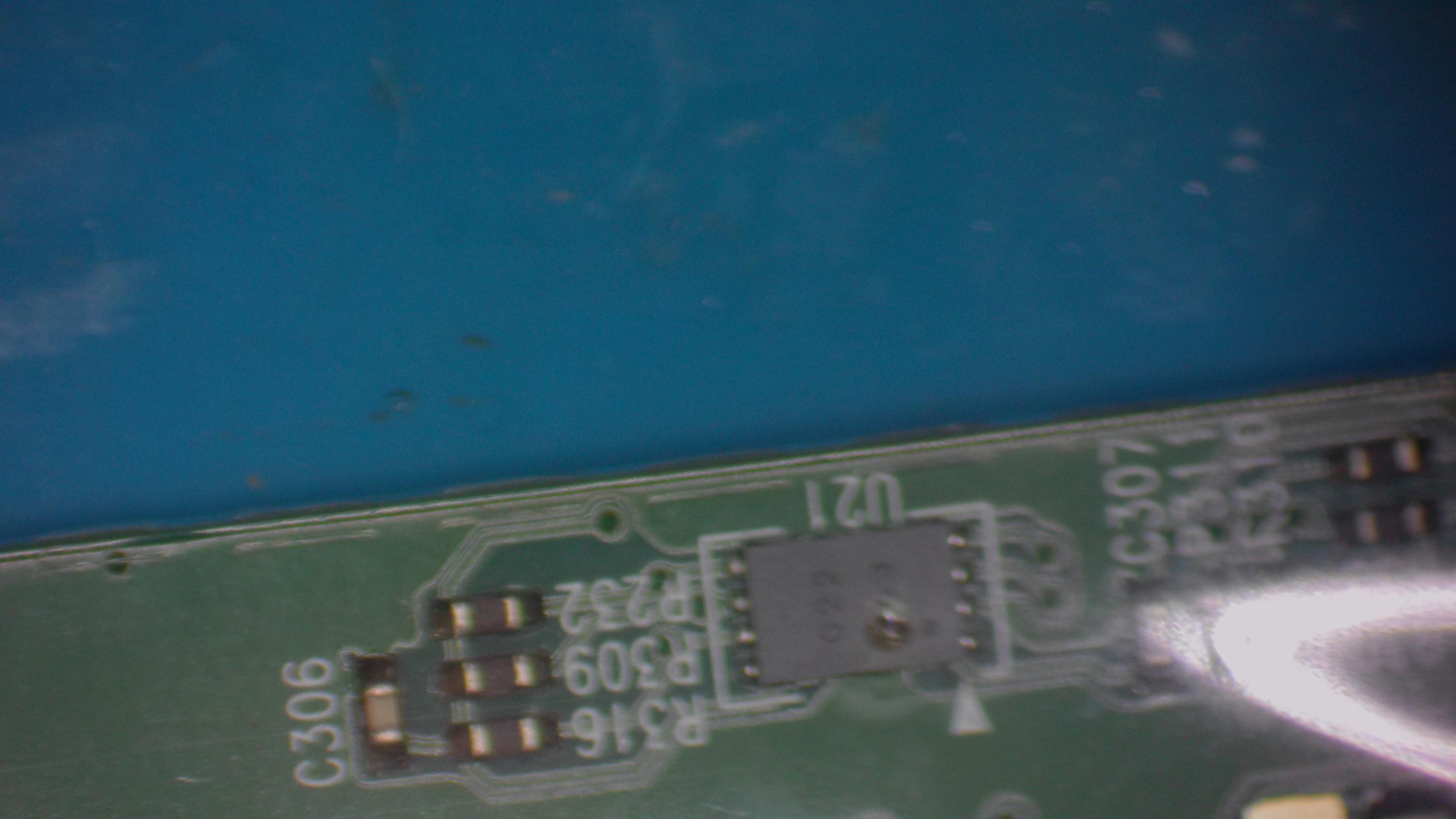

    I have this LCD panel with U21 burned at Tcon.
    I can't seem to find what it is to look for a replacement.
    Can someone help me identify it?

    This is eeprom edid (24c02), but its pinout is not standard.

      Thanks! I'll try to find a replacement and check if I can find EDID dump too.

        It could be close to a M24C16-WMB6TG in a UFDFPN8(MLP8) package. I also see similar ic's marked 464F 8420

          Here is the dump edid.
