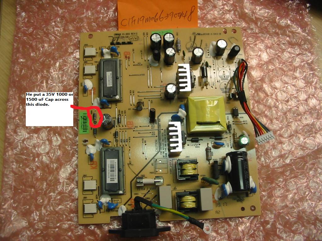

the board is shuting down after 2 sec. i have full drawing of inverter. can anyone help? had 3 bad caps on c847a, c845, c930. and replaced u920 and u950. t901 and t902 are arcing when put finger near and very hot. to much volts i guss dont know how to test. Drawing for board

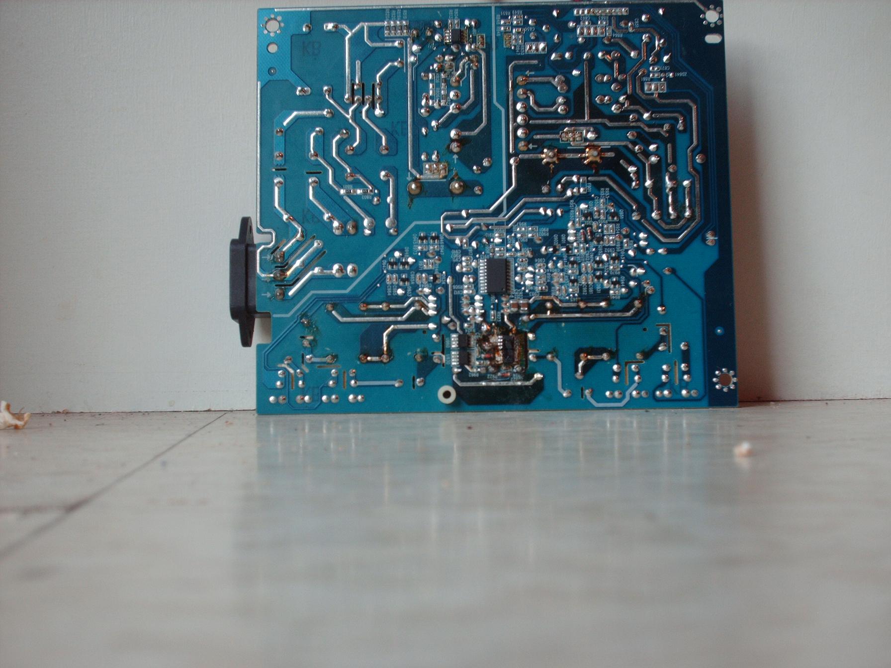

After you fix the link, good pictures of the top and bottom of the board would be a help.

OK, that's a start. I still need a picture of the back side of the board.Originally posted by Mark369Here are the photos of the back.
Sorry cam craped out.[IMG]

Looks like it's going to be a heavy SMD based design from the top pic.
CCFL shutdown is usually a sign of either an inverter fault or a dead CCFL.Elements of the past and the future combining to make something not quite as good as either.Comment

Sorry, but those pictures aren't good enough. I can't even be sure where the transformer leads are.Originally posted by Mark369here are some more photos. i would do all repaires my self with no help if i had to. i think that the transformers are getting too much vots and tuning off ic controler. but dont know how to test.

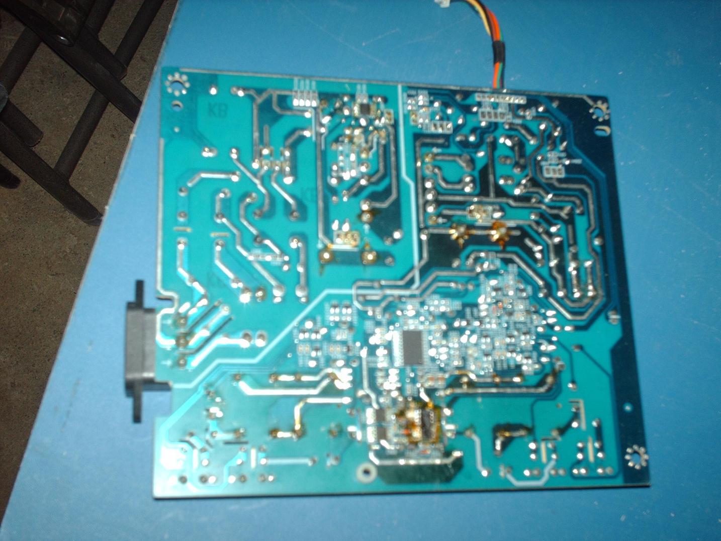

Taking good enough pictures is more a matter of technique than equipment. I use a 4 megapixel camera and can get superb pictures of a circuit board when I take my time. And truly horrible ones when I rush.
1. Turn the flash off
2. Work in a well lit room
3. Steady the camera, preferably use a tripod.
4. Some cameras do not focus until the button is pressed. Then it takes a second to actually focus. Press the button slightly, pause while the camera focuses, then press it all the way so the camera takes the picture; release and wait until the entire image is scanned.
I like to be able to follow the traces on the circuit board. I don't have to be able to read the number on an IC, but being able to count the pins is a big help.

There's alot of heating evident in the area of two driver transistors check those two 4 pin semis.
Grab a datasheet for the pinout.
If it was from ordinary heating then all four of them would have that coloring.
Hopefully when we get some sharp pics I don't eat my words and it's just flux residue.

The easiest way to remove the excess solder is either a commercial product called solder wick (fine copper strands braided together) or just use a piece of very fine stranded wire with a little flux.Originally posted by Mark369i had a guy work on it and replaced the powertrench mofsets but just put a blob of soder over the hole part both sides gate to sorce. trying to desoder
The new picture is much better. I've marked it up, measure the resistance between the following points: A - B; B-C; D-E; E-F.

If those FETs were replaced I'd make sure that no traces were lifted or from the looks of the pics vaporized it looks like the work of a very inexperienced solderer.
Was the monitor working after the replacement of the FETs and then it failed again or the replacement didn't make a difference?
For future reference when using the blob trick (which I use on most 4 pin SMD packages) blob one side put a sewing needle under the first pin melt the blob push the needle through then pull the needle up. If you have fine tweezers they will replace the needle just gently pull one half of the package up. Blob up the other side and remove the IC with pliers or tweezers. Use braid of a solder sucker to clean the residual blobs.
If you're dealing with more than 8 pins Chipquik if the safer option.Last edited by Krankshaft; 02-06-2010, 06:41 PM.Elements of the past and the future combining to make something not quite as good as either.Comment

Thanks Bill the numbers are 21+/-, 15.3, 1.7, 24.7, 15.5 all readings with ohm set to 200k.

I don't know why he did that to my board and charged me $50.00 and 20.00 in mofsets. looks like he didnt replace the other two on the other side. I guss thats good for me after seeing what he did. the photos are after i removed a lot of solder . the photo has sum marks on it showning where i think the cap that he removed. can't realy tell with all the solder milted to the board. i have used the wick and flux maybe to much flux. what's good to remove flux form surface of board.
