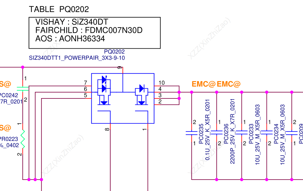

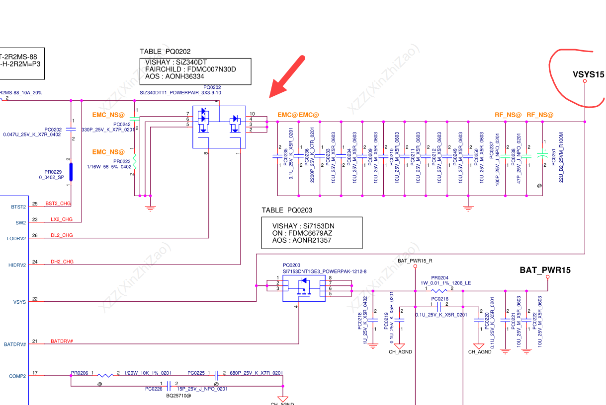

    Remove all power. Meter in resistance mode (not diode mode). Measure the resistance to ground of the main power rail that is used to power this laptop. We are interested in the resistance to confirm there are no shorted parts on this main power rail. If there are, the current sense circuits will detect this fault and power down the laptop.
    Post the measurement of the pin cluster @ pins 2-3-4-10 (any of these will do but pad #10 is underneath so use the others) and ground. One meter probe on any of the requested pins of PQ0202 dual mosfet and other meter probe to ground (metal shield is ok). NO power to the board during these resistance checks.
