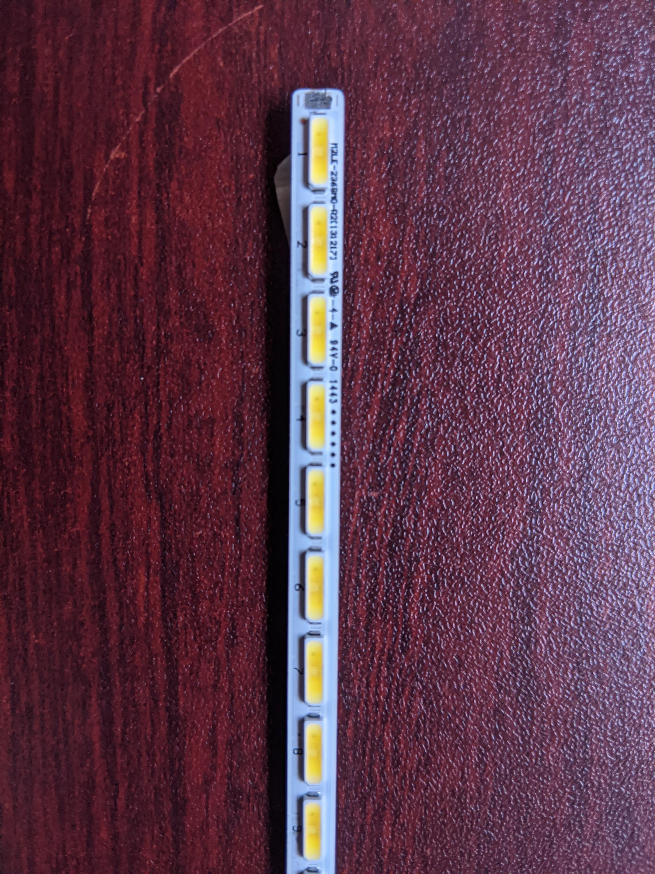

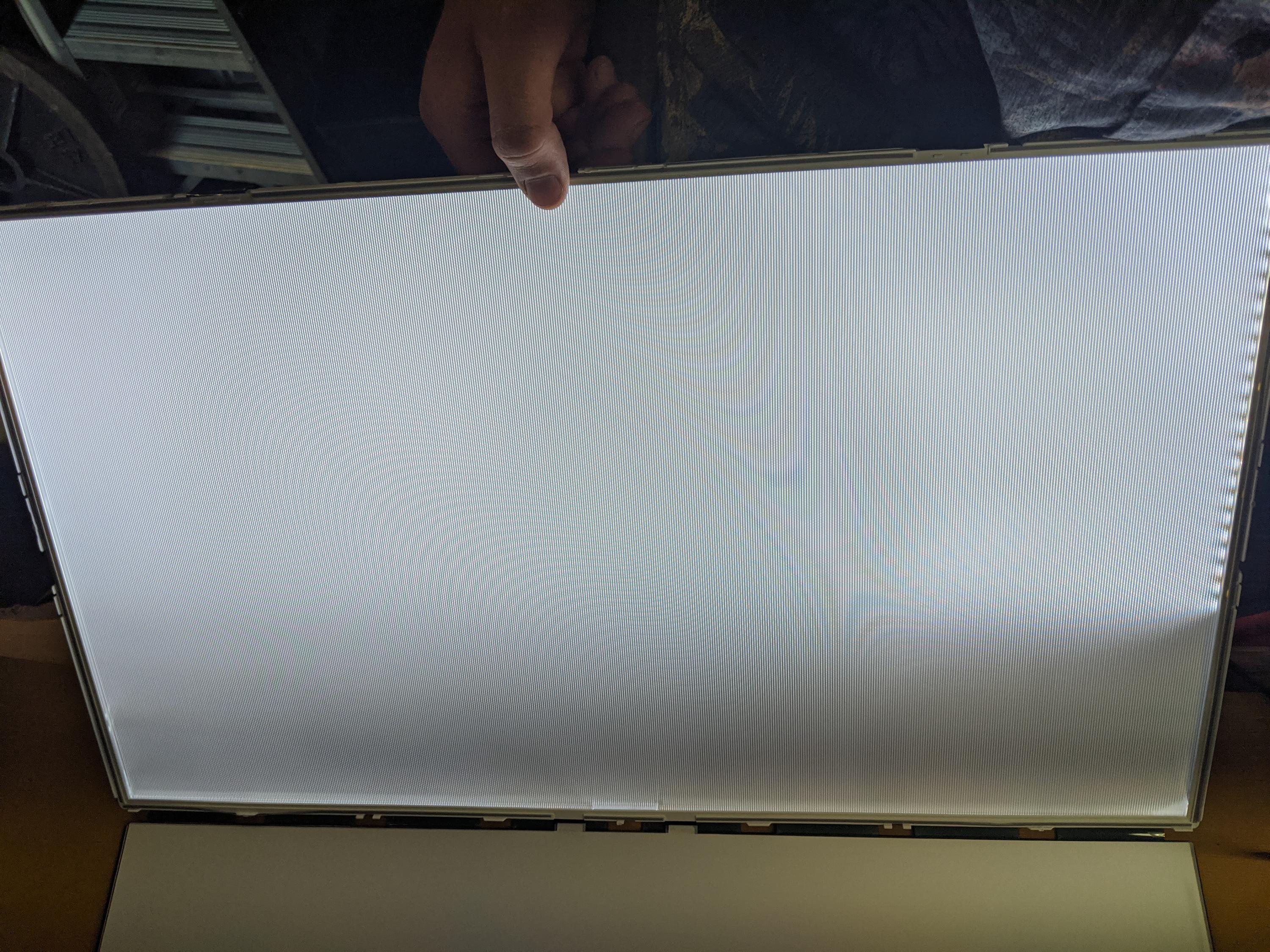

    I cant seem to find this particular one though. I bought this monitor at a thriftstore ($20) and it looked decent when plugged in to power. Once home I noticed the bottom right corner was very dim.
    Upon opening it up I found that not all the LEDs are lit. Sometimes they light when first powered on but only for a moment. It is strange that it seems every other on on the right side is lit.

    strip the panel down ( remember the order on what goes where ) and take the backlight out. Either you have to find replacement LED's and fix the strip or get replacement strip.

      CapLeaker, thanks for the encouragement. I had it mostly stripped down but the backlight was still in it.

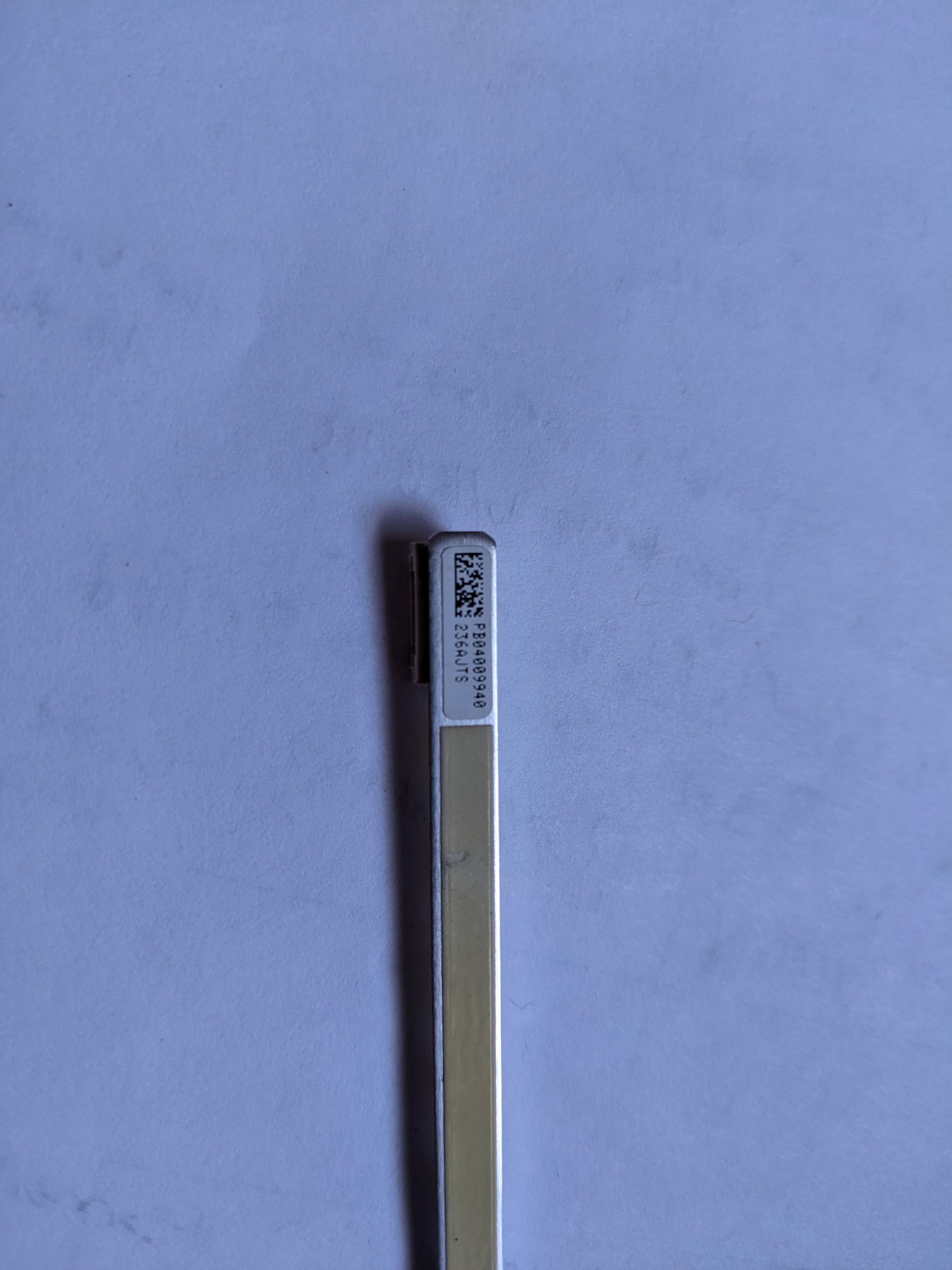

      I have now removed the backlight which I was surprised was only 1 led strip. It looks like 1/3 of the LEDs dont stay on. They will flash, then there will be a tiny tick from the board and then they will turn off. How can I determine if this is a LED issue or a board issue? Is the voltage supplied by one supply and divided or is it three separate transistors (is this the right name) that supply power to the strip?
      I have done some quick googling but have not turned up any replacements, just out of stock inventory from a bulgarian website.
      On the front it reads (I think)
      M2LE-236SMD-R2C132171
      94v-0 1443
      and the sticker on the back reads
      PB4009940
      236AJTS

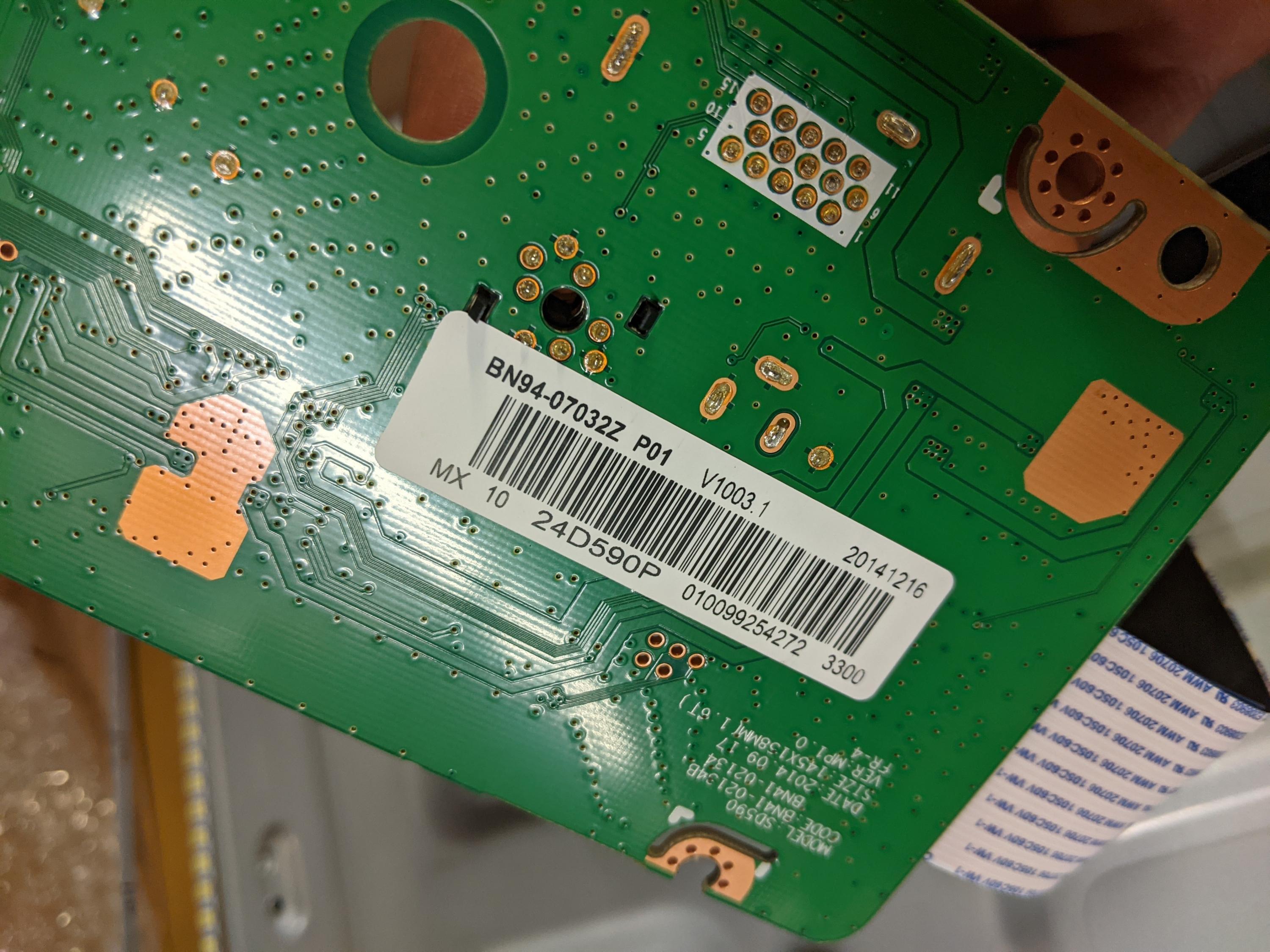

            Re: Samsung S24D590PL LED partial backlight problem
            I am having trouble finding a proper power source for the new LED strips. It looks like they require between 9 and 30v input. The original output on the stock LED seems to be 34v.
            I was testing the original LED strip and noticed that the three sets were reading 33.8, 34, and 35V. When not plugged in to the strip the power seemed to measure about 6.6V. This confuses me, is the board regulating voltage to the strip or is something amis on the board causing the voltage to be slightly different for each set of LEDs?

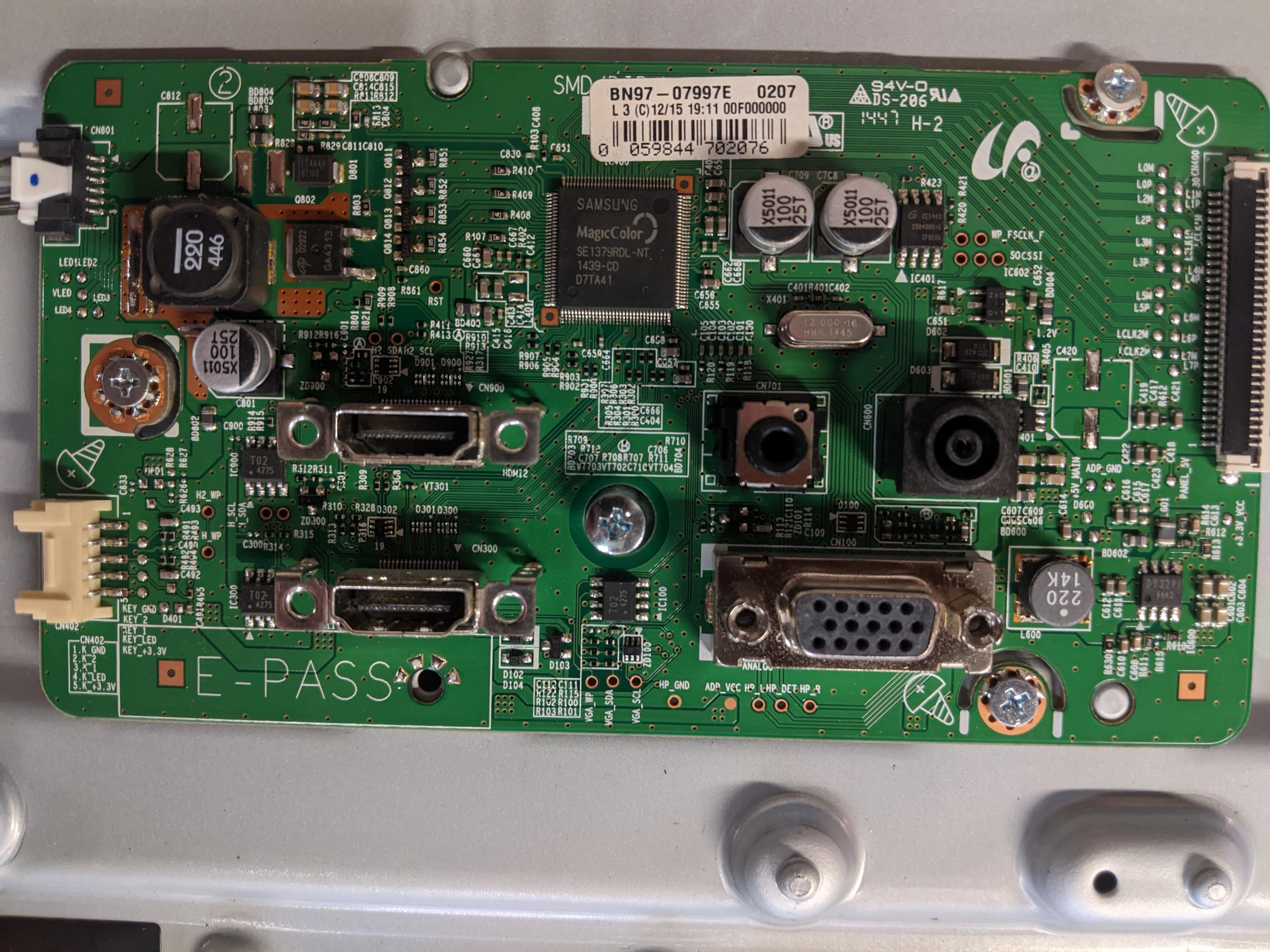

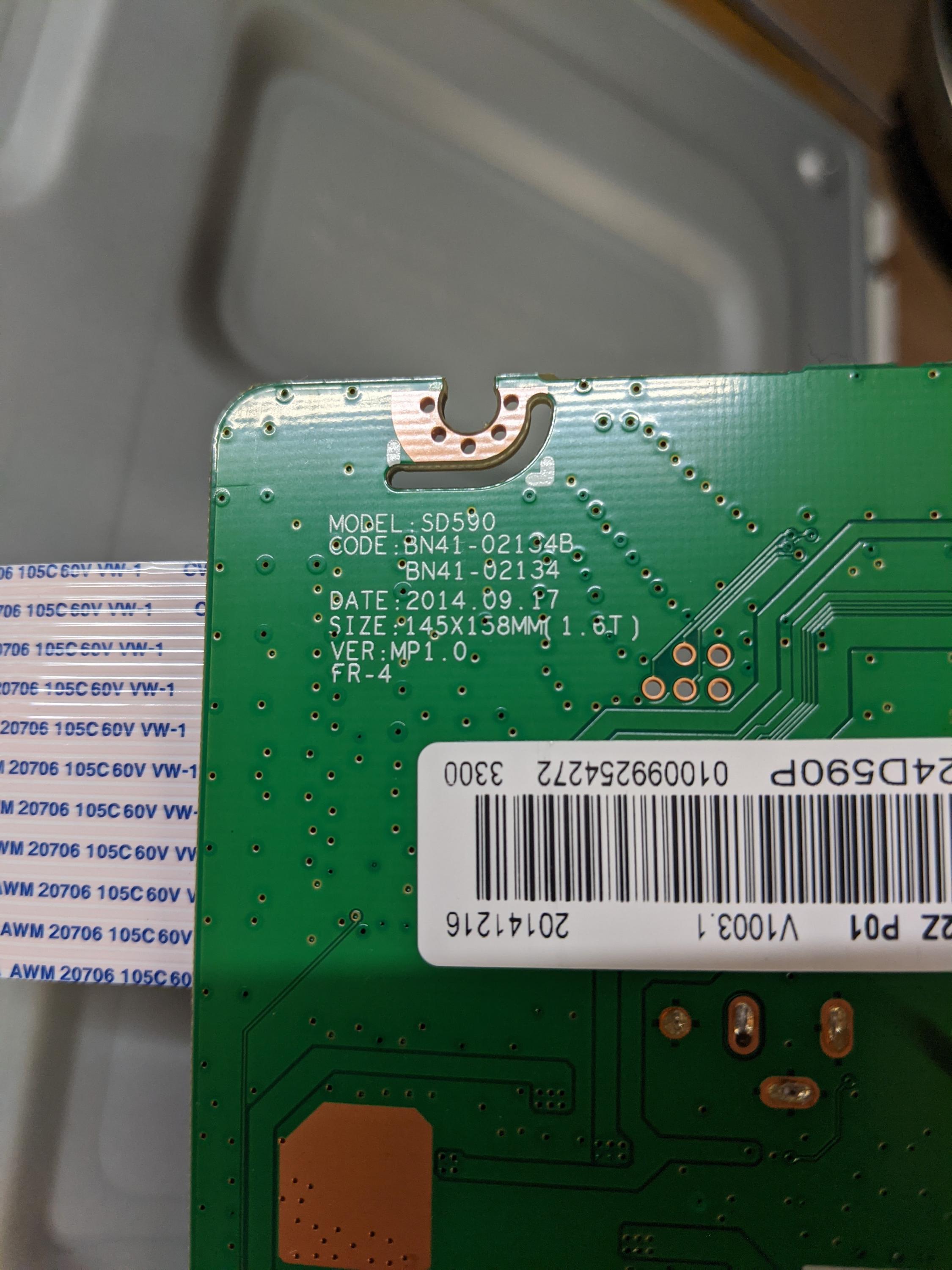

            Pictures of the back and front of the board.
            Thanks all for the help, I am finding electronic repair more difficult than mechanical repair.
              master hoarder
              • May 2008
              • 12175
              • Bulgaria
              The board is not regulating the voltage, but rather the current that goes to each strip. For better efficiency, this is typically achieved with PWM control... so the voltage over each LED strip is NOT a steady DC value. Therefore, you cannot really measure it accurately with a multimeter.
