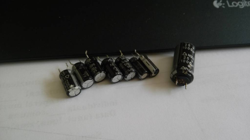

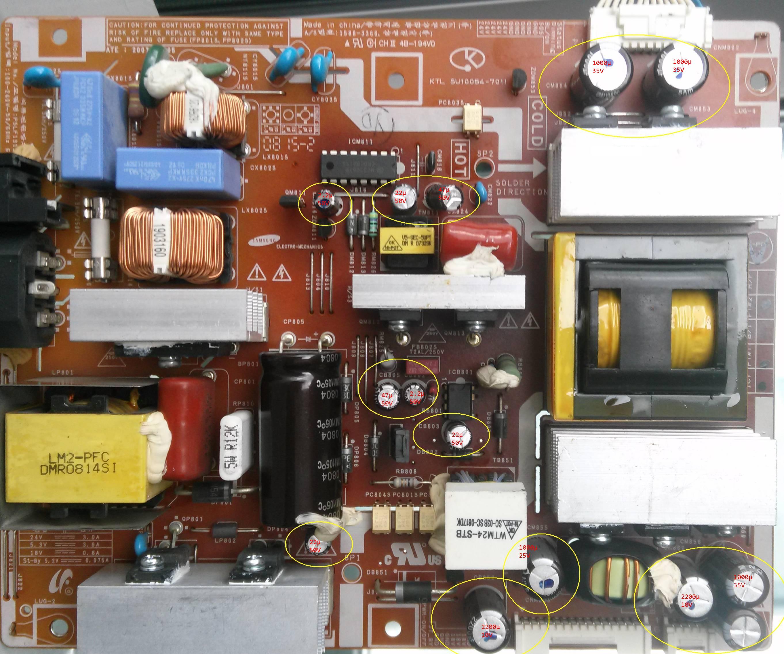

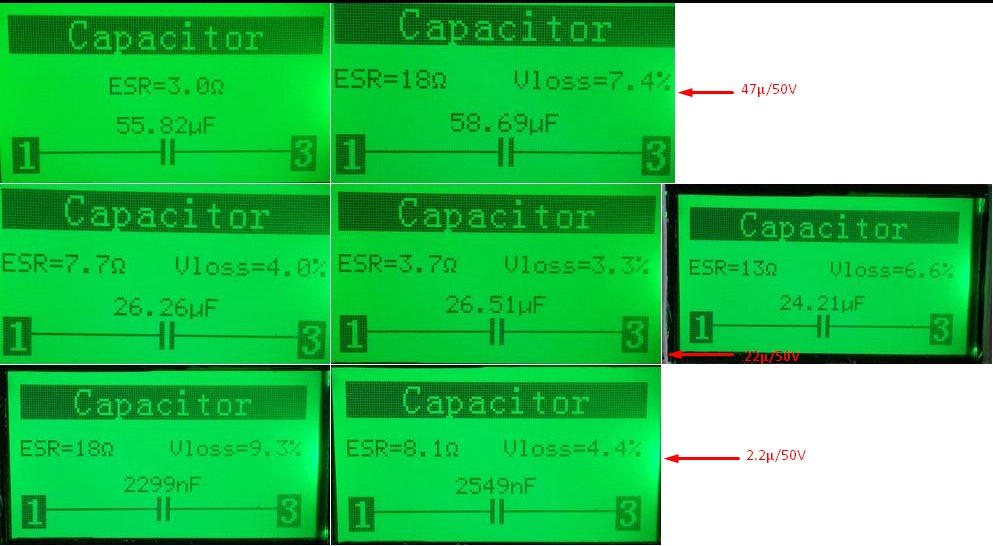

      I took most of the electrolytic caps out and measured them and they all seemed fine on capacity test. Should i test in another way?
      I had some trouble with a Syncmaster 245T - BN44-00181A. I ended by changing all the Samsung caps. So yes, I recommend you an ESR-meter.
