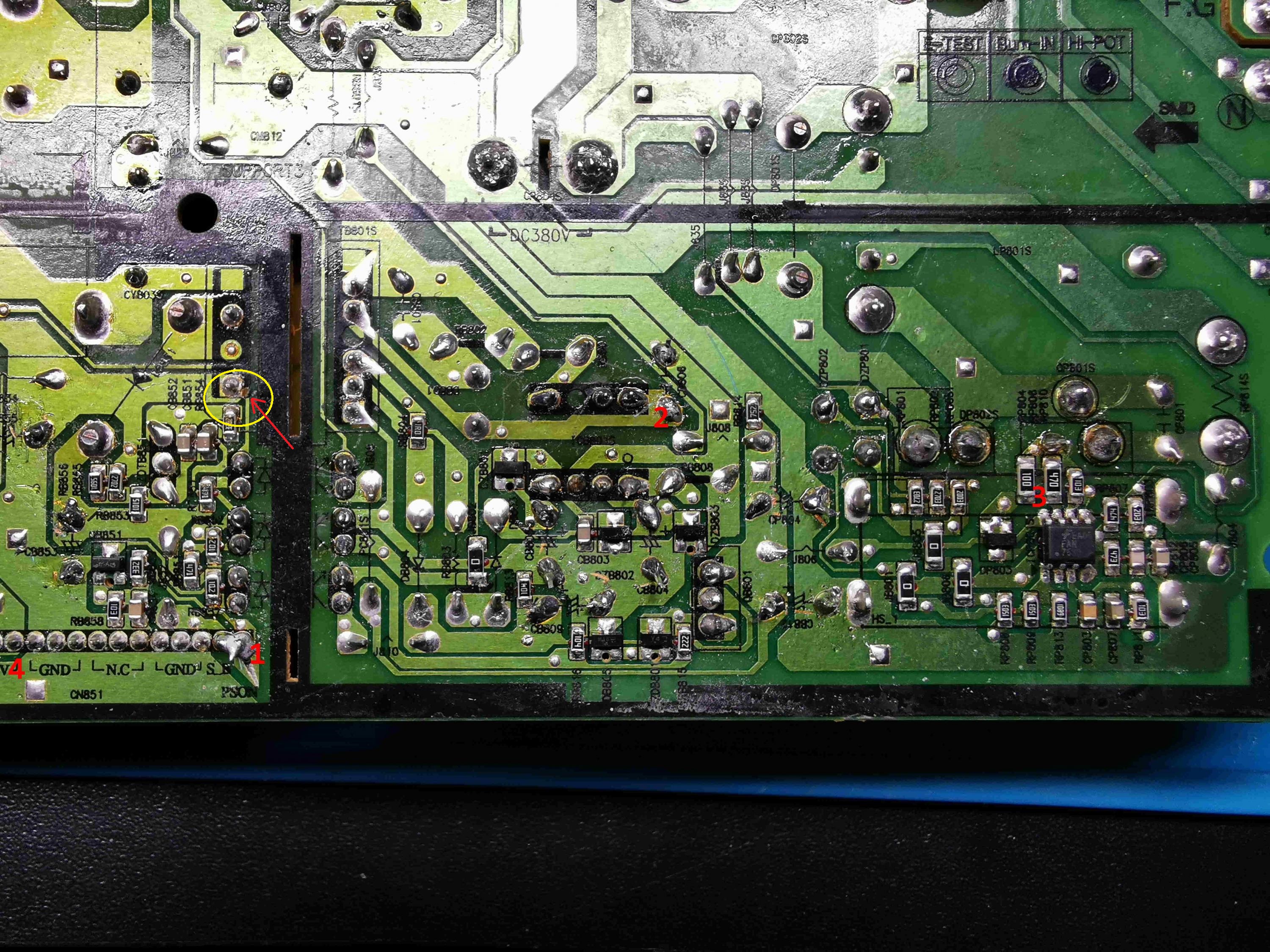

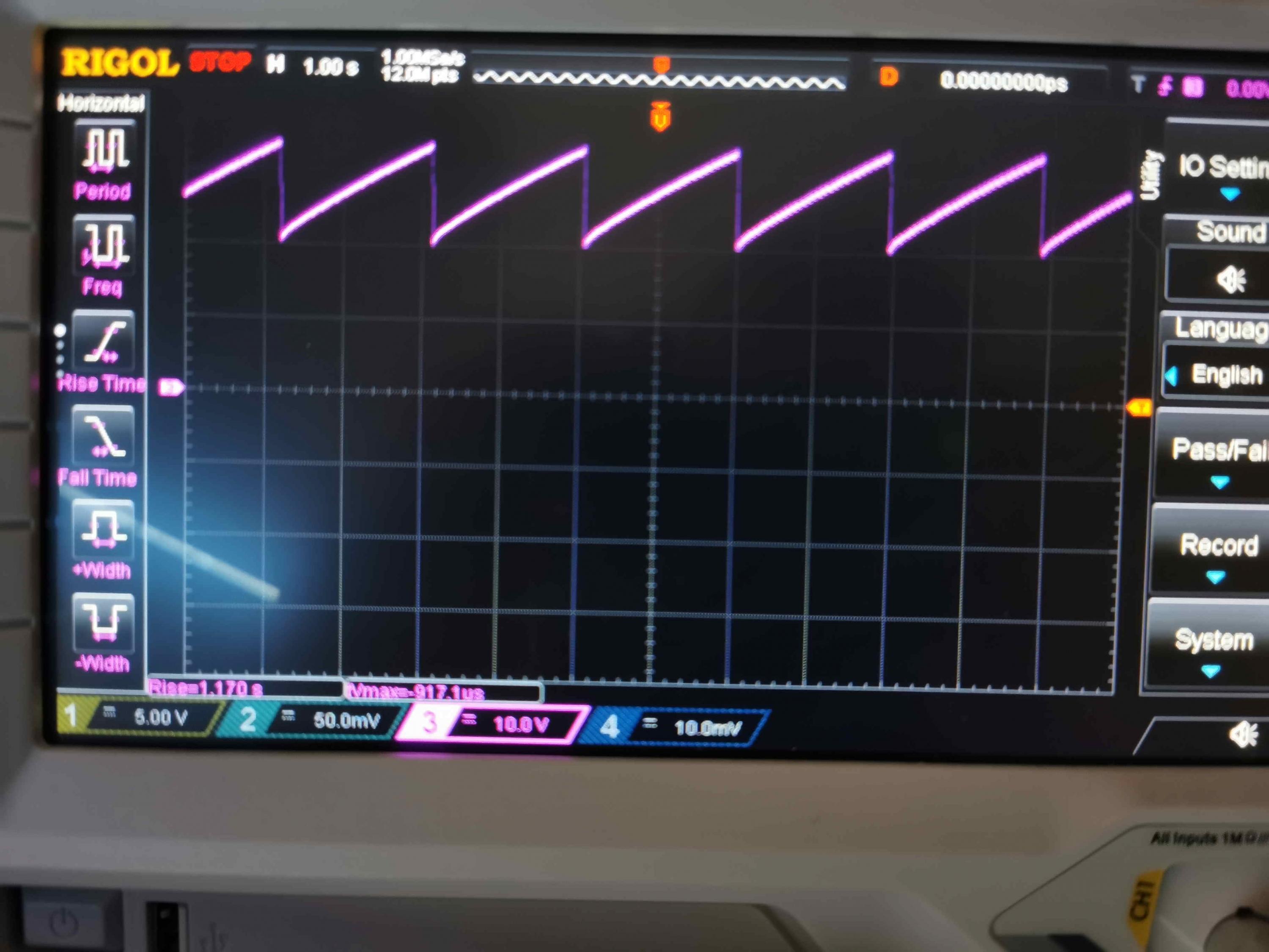

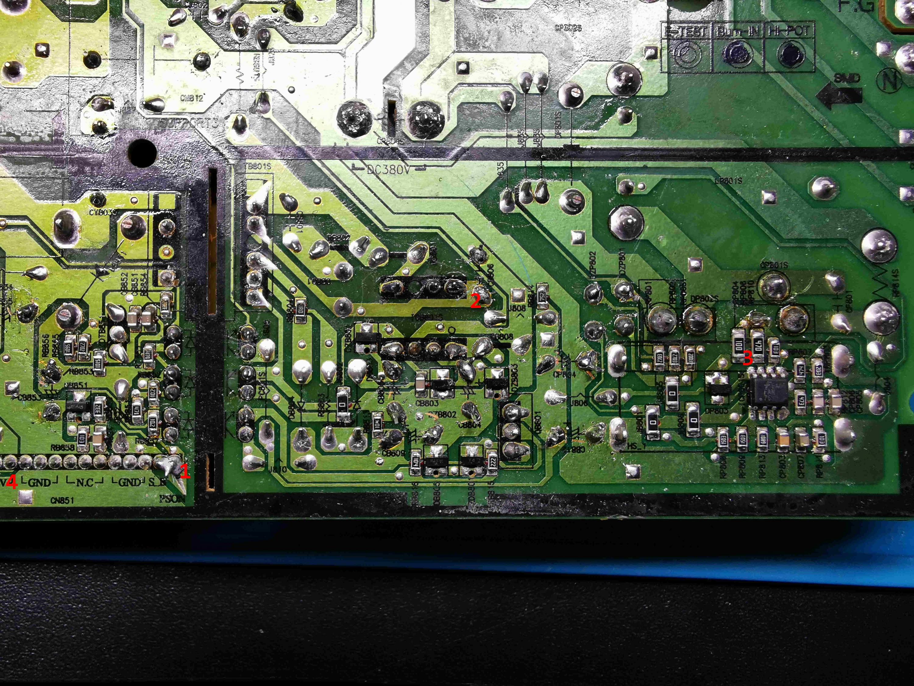

      I hooked up an osciloscope and point 3 on the pic showed slightly oscilating ~10V. You keep mentioning CB806 and it was not populated on my board. I did buy this monitor used but I don't think anyone was opening it. So i put on 47uF/50V at point 2. The osiloscope pic is from point 2 with the cap in. The voltage is oscilating sawtooth slowly. 2 second period. Looked a bit strange to me, so i took a pic.
      Point 3 has nothing now. No voltage.
      Point 1 is 5.2 standby bridged to PS_ON
      Point 4 is +5 to control board, no voltage.
      I'm lost again...

        This board must be slightly different, It was hard to read the numbers on your board. If cb806 was not populated then it must not be needed so remove it (it would not have been an electrolytic in that spot). It looks like the cap I refered to would be cb809? QB801 is the vcc regulator/switch ZDB801 is the zener diode in the base of qb801 that sets the vcc voltage. Check the voltage on e,b,c of qb801 using hot ground

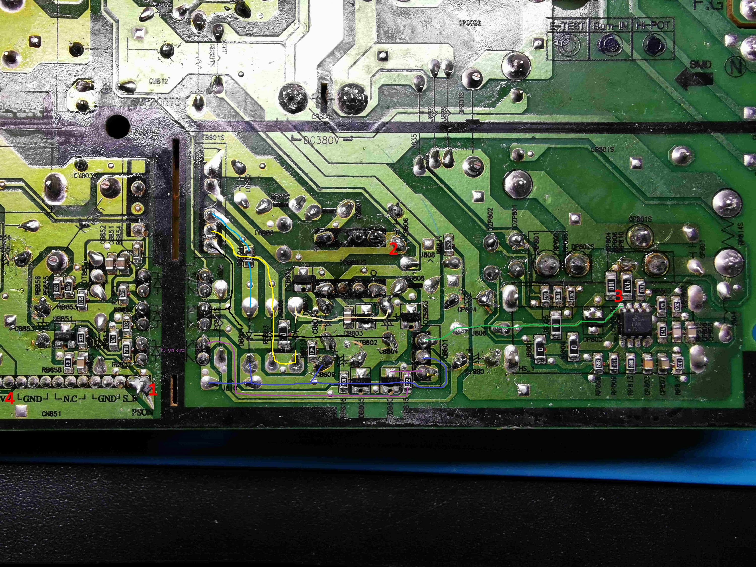

            The S_B is not working. Whole connector is now showing signal on attached picture.
            The board is BN44-00195A.
            Looks like I burned something on the left side.

              Why don't you download the schematic? I have no idea what the "left side" is. Do you mean the primary or HOT side?
              You likely opened either the main fuse or the fuse resistor that supplies the standby transformer. There is a resistor next to J823? it could be open.

                  The schematic itself is close but the location numbers are different. When you installed the 47µf/50v cap, it would have been likely seen as a short and either blew that resistor I referenced, it acts like a fuse for the standby ic.

                      I see what looks like a damaged trace off of one of the optocouplers, can you check this?

                        No, that's just some glow from the lamp. Continuity is good on that transformer pin and the trace from optocoupler going arround it.
