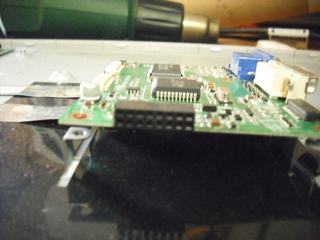

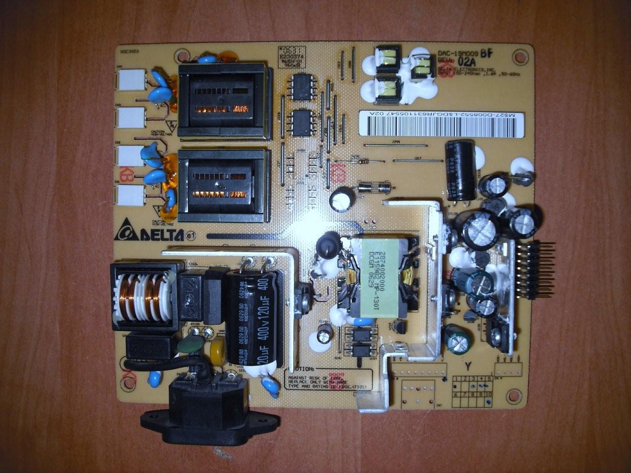

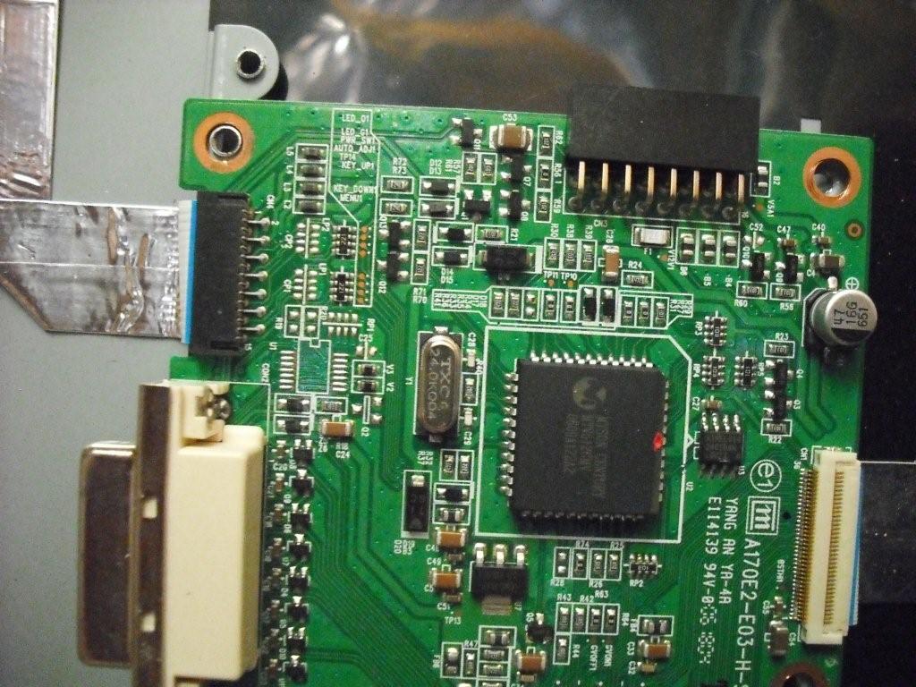

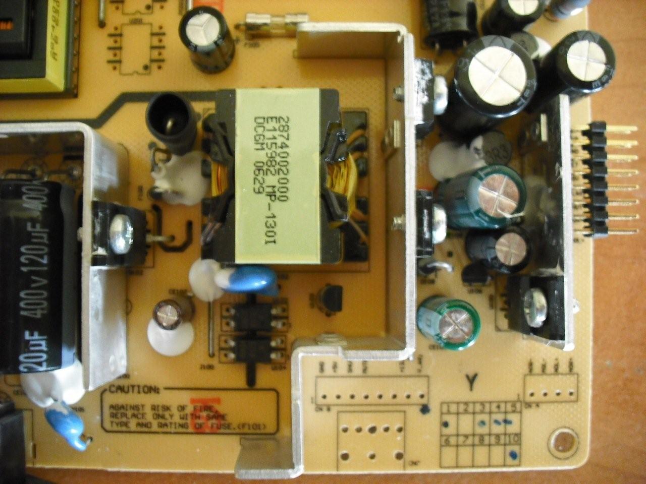

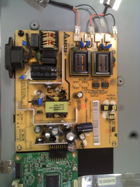

        • mattclanga
          • Nov 2009
          • 4
          Re: Chimei CMV221D black screen ?
          Thanks for the reply's

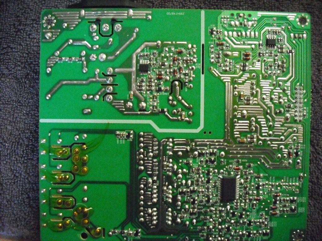

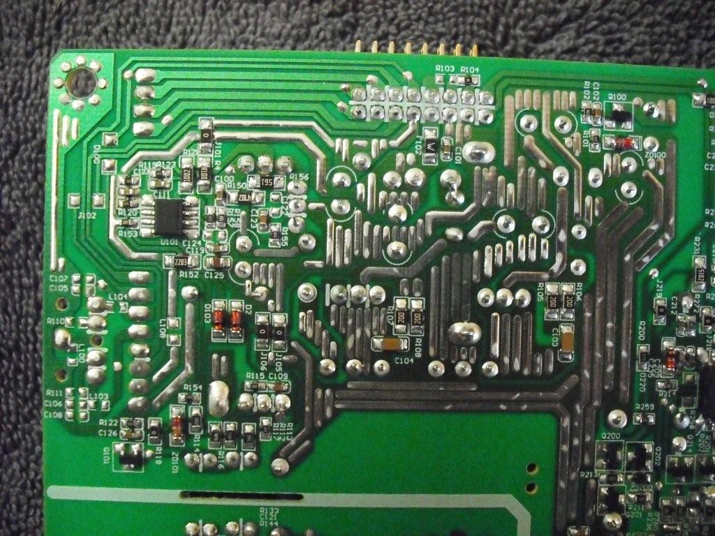

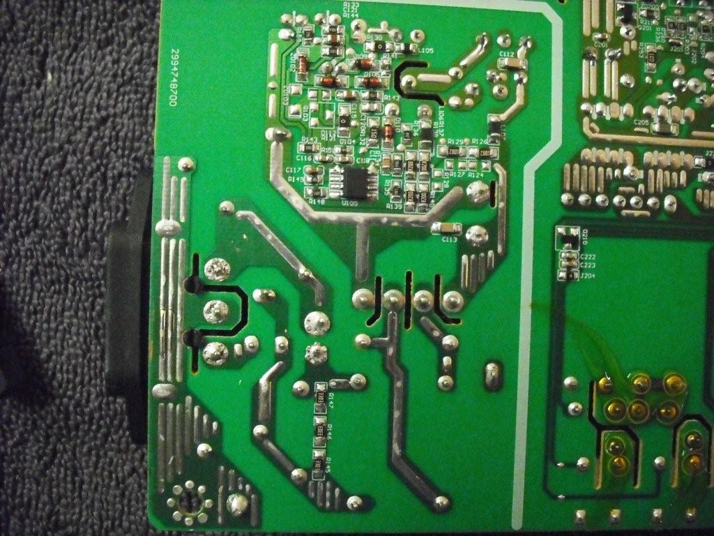

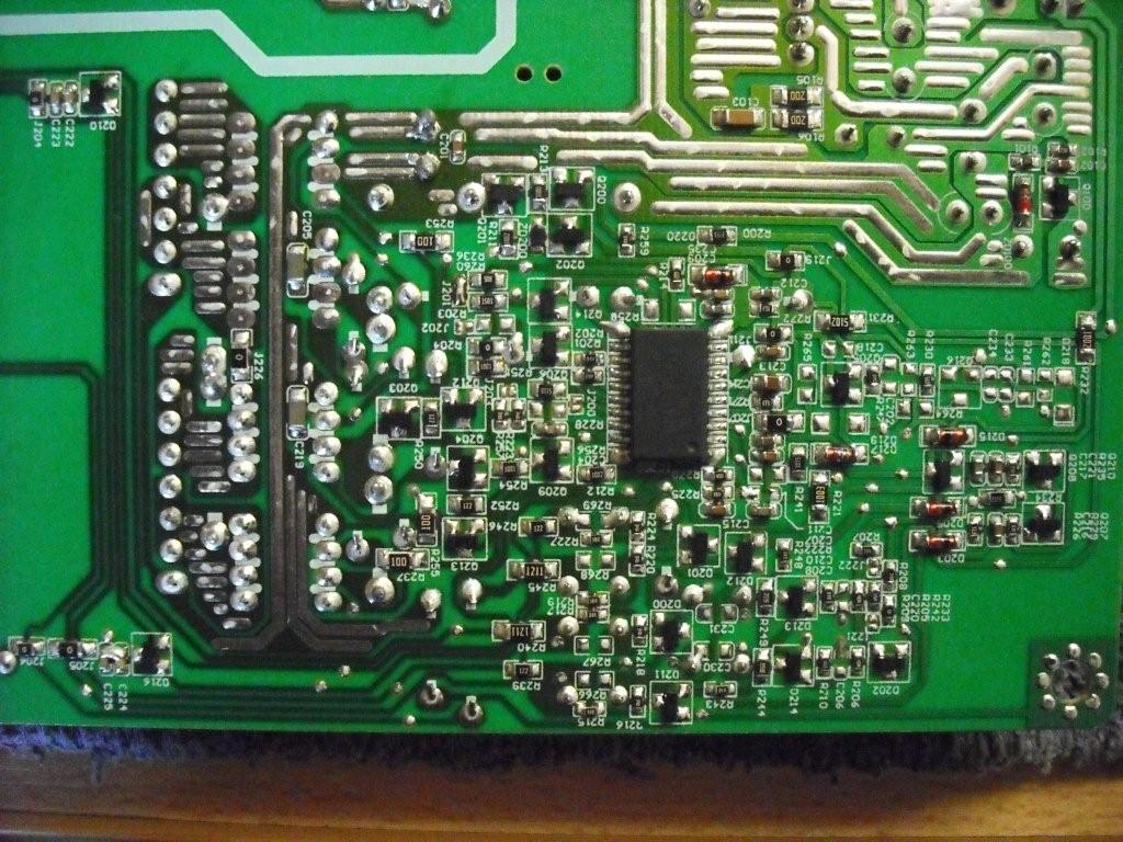

          find attached photo's of board. after reading some posts about changing bulging caps i had a go at changing one that looked a bit dodgy. it was the one next to the fuse. i re-assembled and still the same fault.
          If more photos or info required let me know.

          • Bobdee
            • Jun 2008
            • 461
            That looks the same Power suppy/Inverter as this Thread
            https://www.badcaps.net/forum/showthread.php?t=8265
            Might help with Common faults
            • PCBONEZ
              Grumpy Old Fart
              • Aug 2005
              • 10661
              Thanks Bobdee - That does look like the same board.
              Often different makes/models use the same PCBs. That's another reason these guys the see lots of screens are so handy. They may never have seen your screen but they might have seen the same board in a different screen.

              • PlainBill
                • Feb 2009
                • 7034

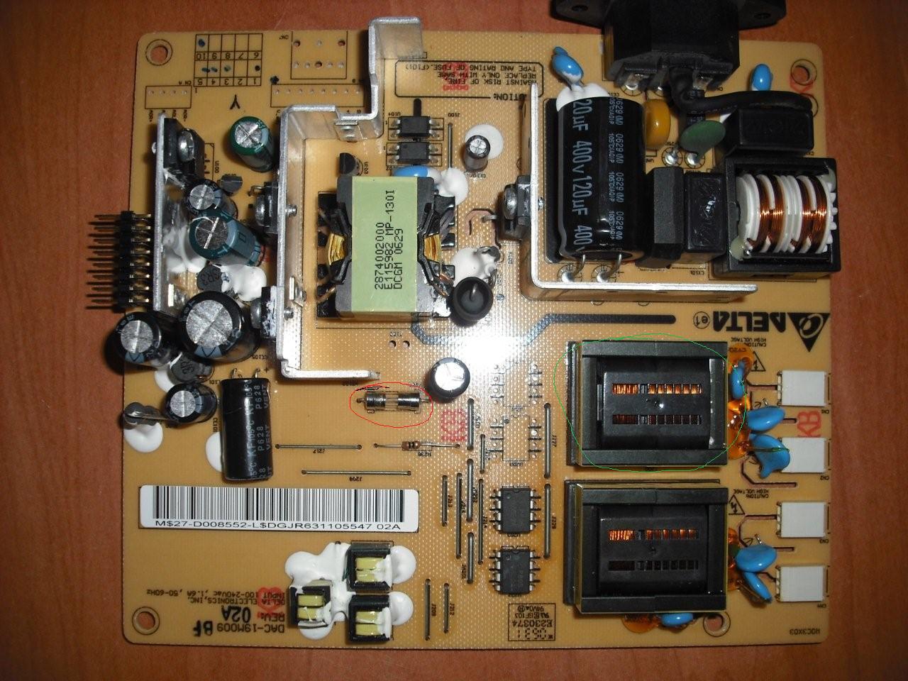

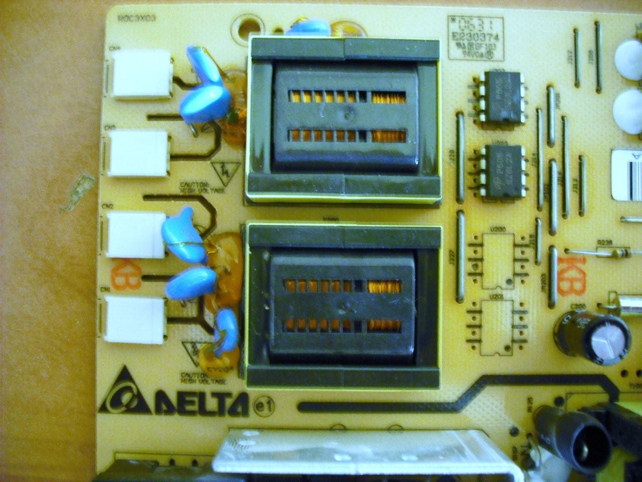

                Nice pictures. The question I have is this a failure of the backlights, or a failure of the logic card / panel? I have two tests to suggest.
                The first is easy. When the screen goes black try viewing it from an angle while shining a bright light on it. If you can see the desktop (or whatever you were viewing when it went black), it's almost certainly a backlight problem.
                The second is a little more demanding. Check the voltage from the small pigtail fuse near the center of the board to the metal fram of the monitor. Does it change when the screen goes black.

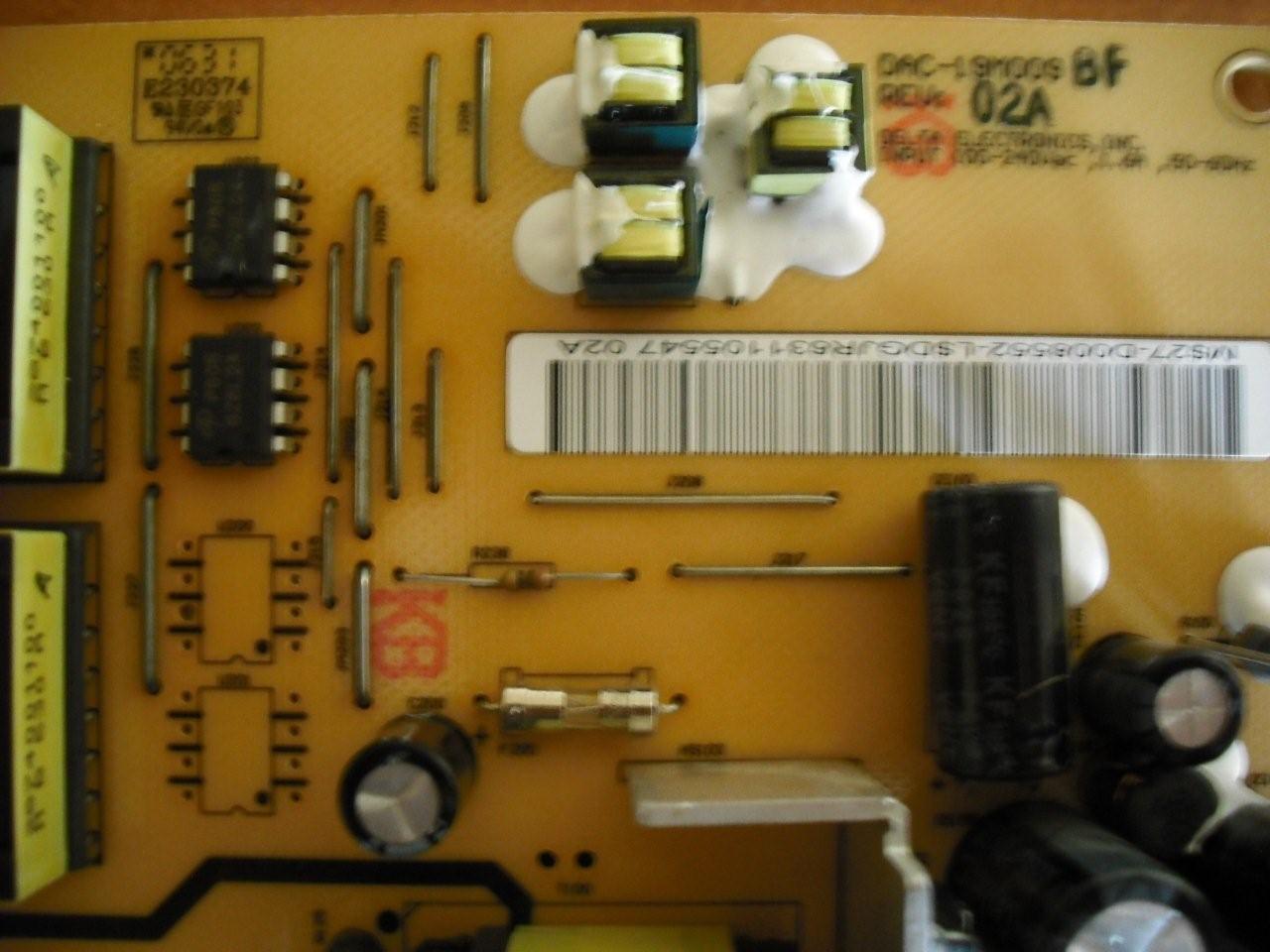

                • mattclanga
                  • Nov 2009
                  • 4
                  Thanks for guidance
                  First test - screen went black 15 minutes after power up shone torch on screen looked from side and nothing
                  Second test - measured voltage from pigtail fuse circled in red to metal body 19.5 volts when screen went black voltage increased to 21.6 volts.
                  When screen working buzzing noise coming from part circled in green.
                  • PlainBill
                    • Feb 2009
                    • 7034
                    Originally posted by mattclanga
                    Thanks for guidance

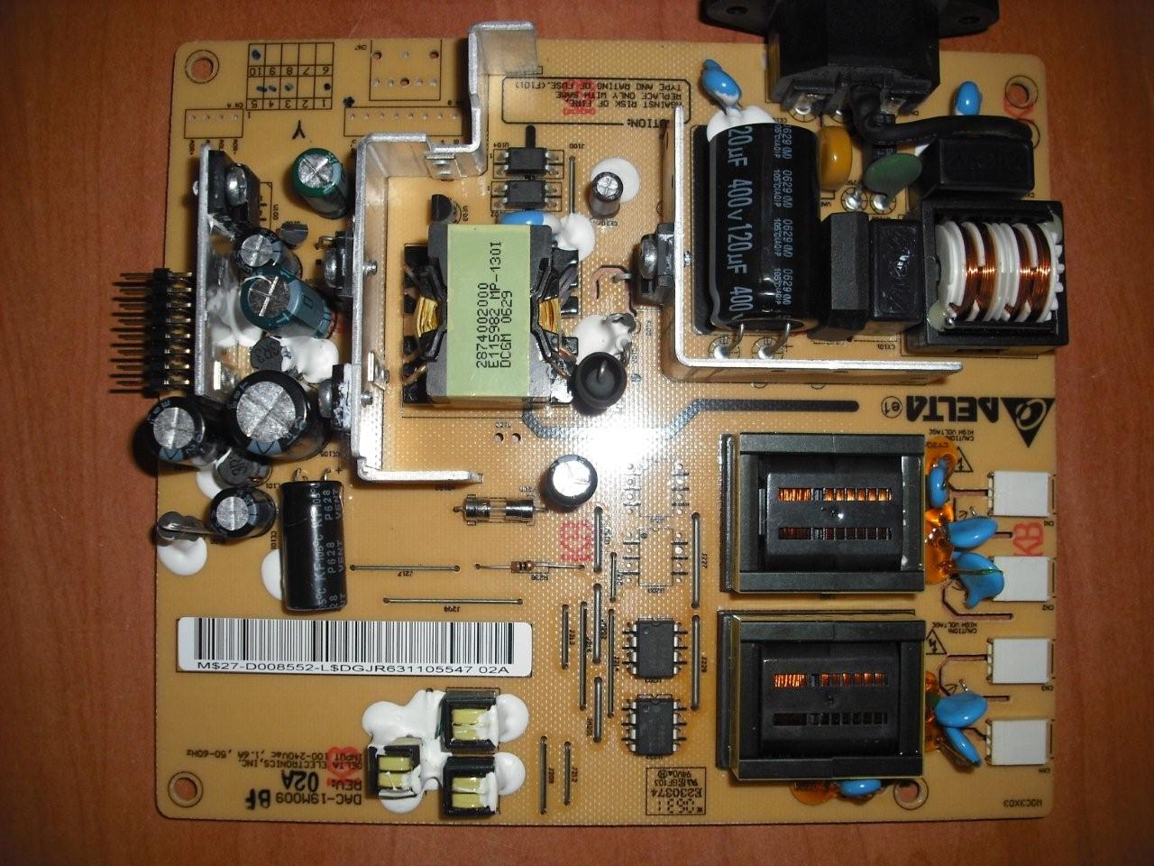

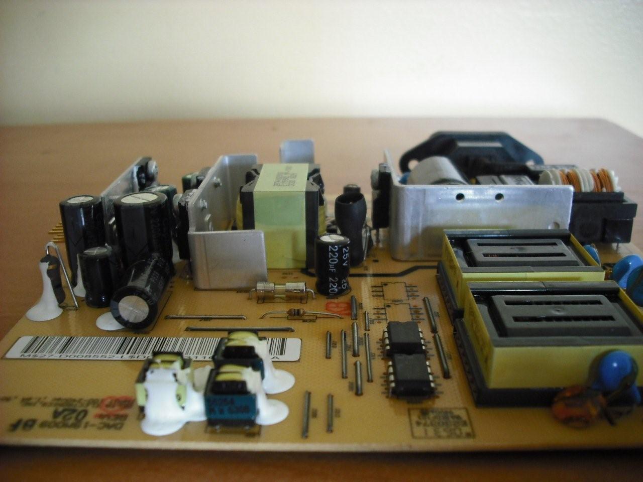

                    It might be a bad transformer, or it might be bad glue. The glue around the capacitors has been blamed for problems with inverters. Scrape it all away and see if that fixes it.
                    If that doesn't do it, I would like top and bottom pictures of the area around the connector that links the power supply / inverter to the logic card.

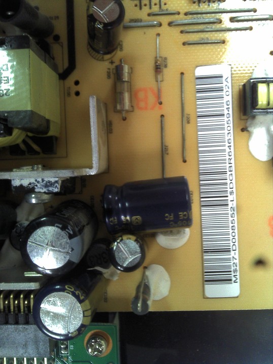

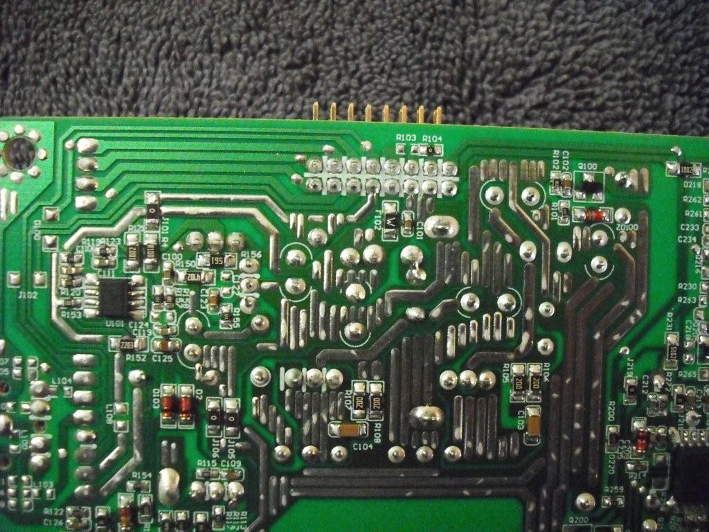

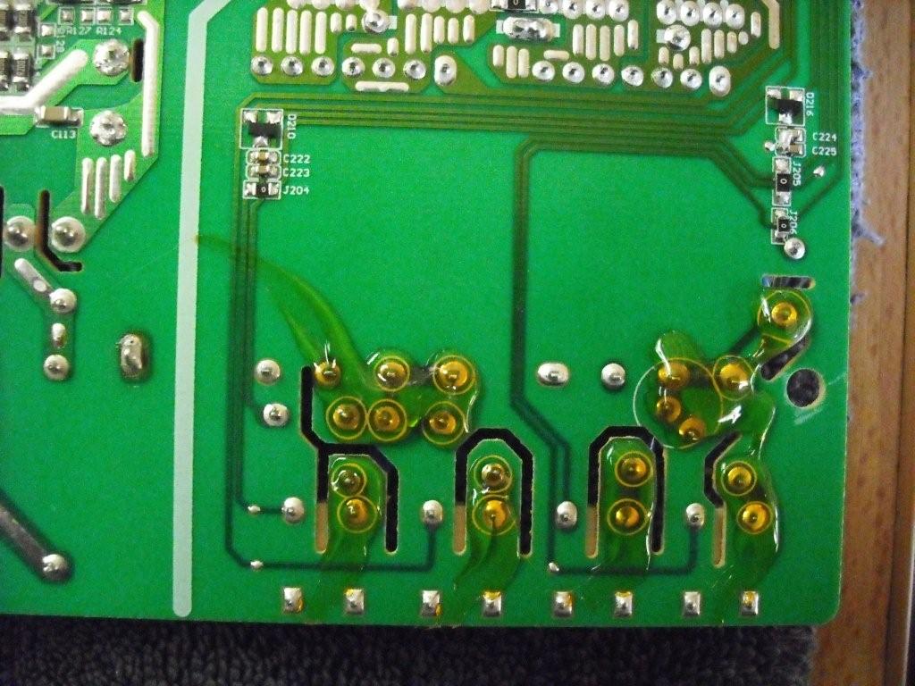

                    • mattclanga
                      • Nov 2009
                      • 4
                      Thanks Plainbill
                      I removed glue from around caps and the fault is still present. Have attached pics of underside of board. Should i be replaceing all of the caps as a matter of course.

                            • cashkennedy
                              • Aug 2011
                              • 666
                              I picked up one of these CMV221D's cheaply on craigslist with just the buzzing noise, after a few weeks it got to be louder and the backlight started flickering a little / not putting out a consistent brightness, so i figured it was time to operate.
                              Caps c200 , ce101, ce102, ce103, ce105 all look bulged and are all CapXon. Crackling noise appears to come from around the backlight transformers though as other people have mentioned.
                              After replacing c200, ce101, ce102, ce103 with Panasonic FM/FC caps the noise is significantly decreased and the backlight no longer flashes or strobes in different intensities. The remaining noise occurs generally only when i turn the screen on / or off or resize the resolution of the screen (probably causes a on / off for the screen as well to adjust) and the noise only lasts less then a second.
                              Gonna see if i can order a replacement for ce105 (the 2200uf cap) that will fit in the space (panasonic FM caps seem to always be bigger then what they replace ). Hoping that the fact that the noise occurs primarily while switching on / off indicates this is a cap issue, and not a bad transformer.
                              Will report back if problem gets worse again (my fear), or if it stays the same / goes away compleatly after replacing the 2200uf cap.
                                You didn't supply a picture or say how many caps there are in total, but 5 bad Capxon caps is enough to replace them ALL due to guilt by association.

                                  There's around 9 electrolytic caps on this board
                                  -1 is the huge ac filter cap that is fine
                                  -2 are from some more reputable brand (i think it might have been nichicon, they are the green ones that are in the lower right of board/ left of picture) one is 1000uf 10v and one is 330uf 25v
                                  -the rest are all CapXon caps that are buldging. (3x 220uf 25v, 2x 1000uf 25v, and 1 x 2200uf 10v)
                                  As you see from the closeup i replaced them all with panasonic caps except the 2200uf one that you can still see is buldging in the pics. You can also see my bad soldering job on the one on the left of board (top of pic) that is slightly unevenly seated on the board

                                    Manufacturers change board revisions or even completely with a new design, but keep the same model number.
                                    Plus Im too much in a rush to start soldering to ever take a picture before i start removing the bad caps, and your lucky i got some pics after i was done.
                                    About once every 2 weeks, we have someone who doesn't take a picture or write down a "cap map" and ask what capacitors go into which holes because they forgot or were in a rush.
                                    If the green ones are Samxon GF series, they are a problematic series. So you have more than a 50% failure rate in caps (5/9), this would suggest that the other 4 can't be far behind in failure. In addition, the cost of an extra 4 caps is probably $2.50?

                                        The capacitors are so cheap why only replace some? It makes more sense to replace them all at once, and save yourself hassle in the future.
                                        Anyway - what's the model number and revision of your PSU? I have one of these monitors and if it has the same PSU I can try to give you a capacitor list.
