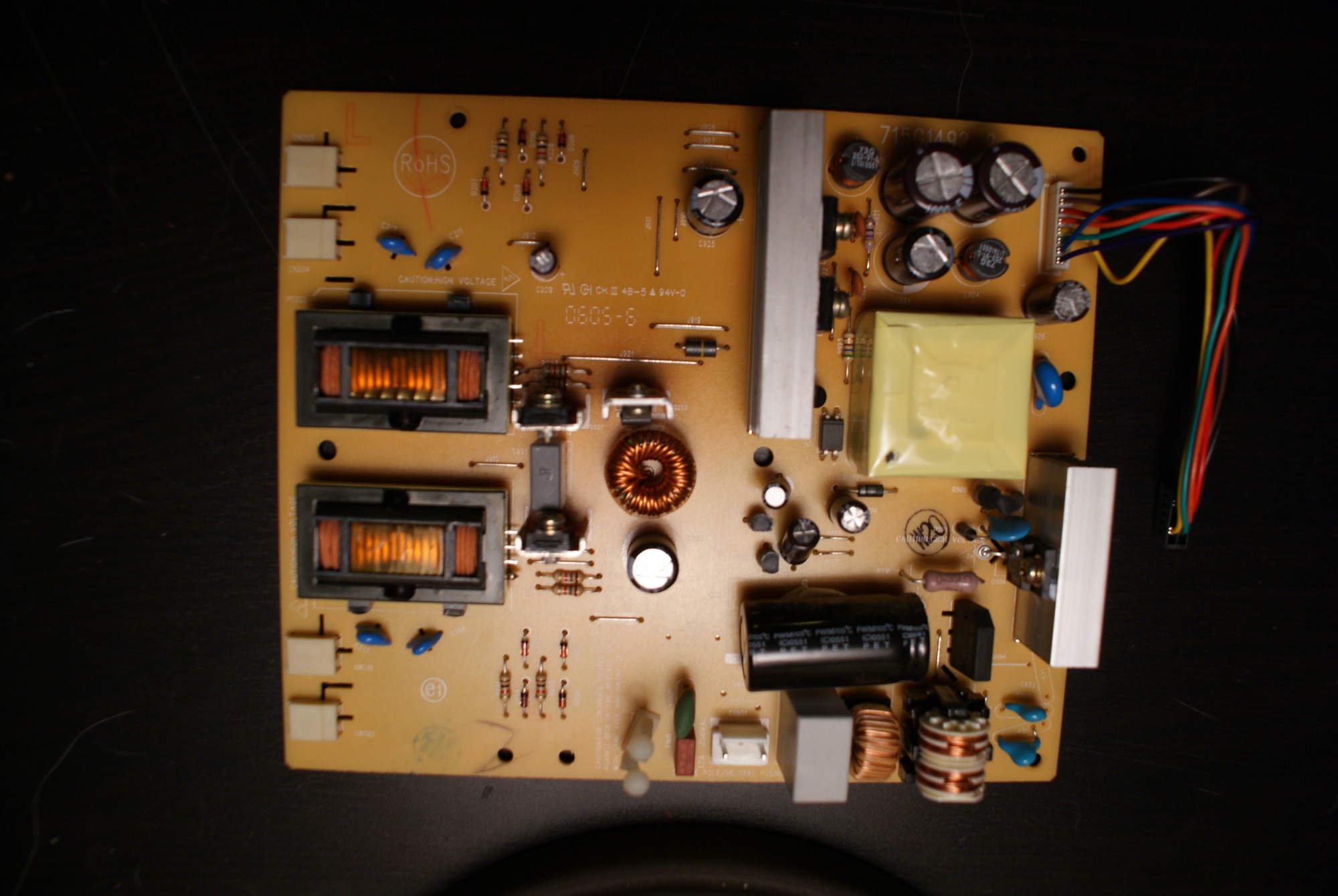

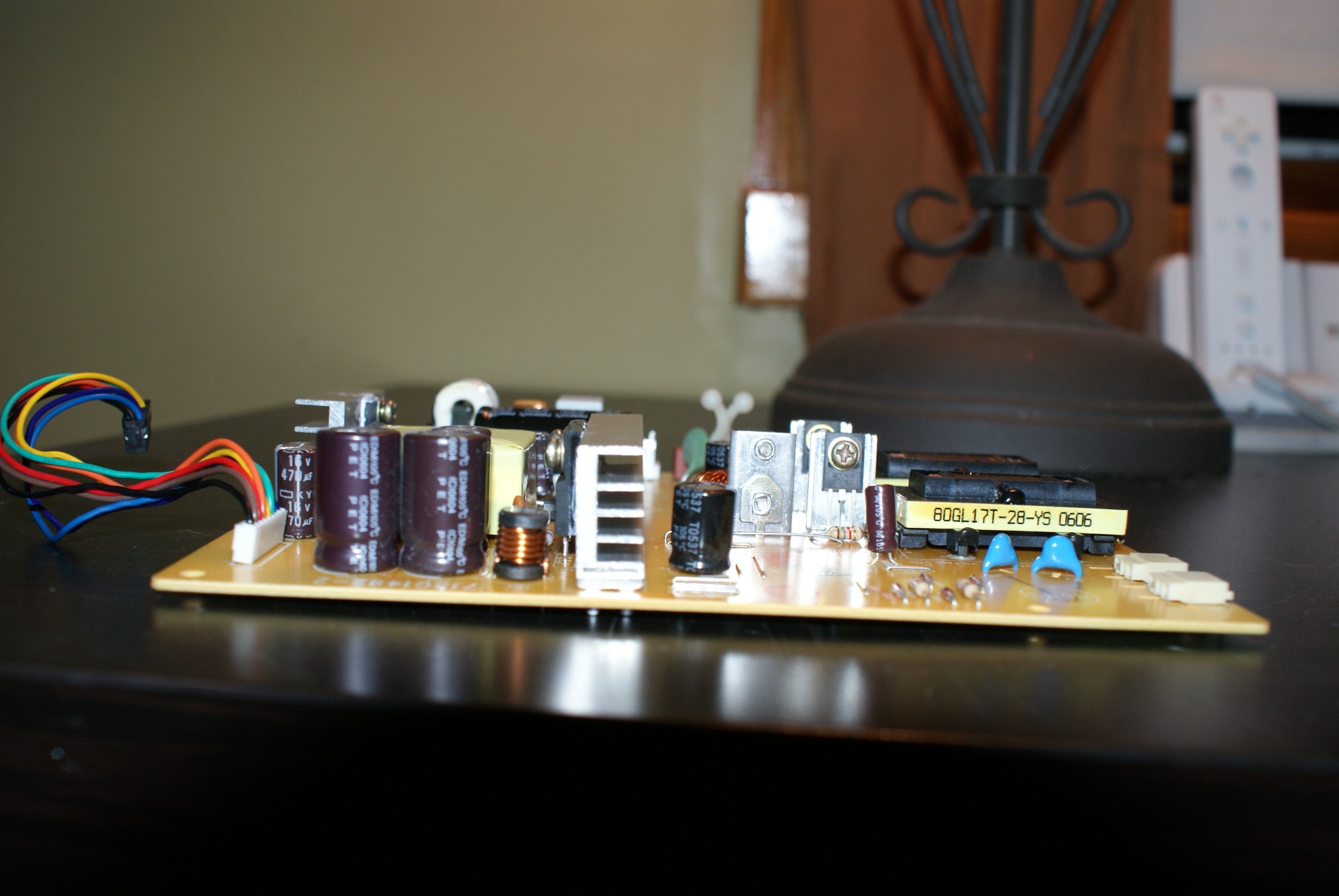

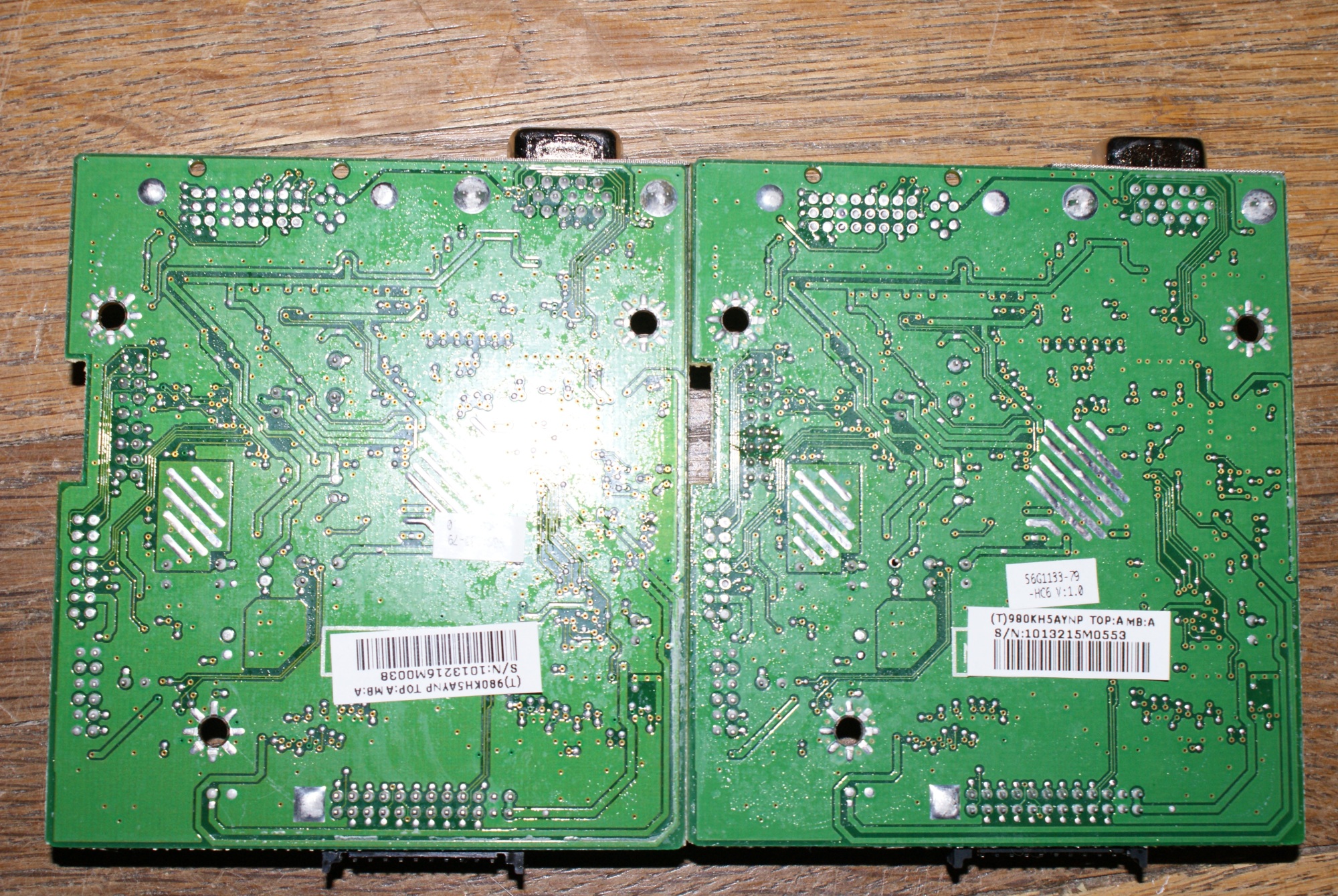

    Hi, I recently found two free non-working LCD monitors on craigslist. Both have the same issue, No power. The LED on the power button does not light up at all and pressing it does nothing. I have tried different cords and different outlets and it doesn't make a difference.
    When I opened up the monitor all of the caps on the power supply look good but there is a brown spot on both boards in the same area. I don't really know where to go from here. I have a multimeter and have replaced components on a board before.
    I would be willing to do a mod like this http://computerguru365.blogspot.com/...l-monitor.html if I could have a little help on where the wires should go.
    Thanks!
    Pictures attached

    Re: No power on a Acer AL1916
    Well, since you get absolutely not response from them, my guess would be the fuses are blown. They're the little red box next to where the AC power comes in. To check them, set your multimeter for the lowest resistance rating and measure across the leads. If the fuse is good, it will read 0 ohms, if the fuse is blown it will read infinity/overload. If the fuse is good then the problem lies elsewhere. If the fuse is bad, that's why nothing is happening, but chances are something else has gone bad too, and caused the fuses to blow. There are many other people here who know way more about monitors than me, but that's a place to start at least.
    Good luck
    • RobertoIsRad
      • Nov 2009
      • 42
      Unfortunately, both boards read 0 ohms so I'm going to assume that the fuses are ok. Could the problem be in the mainboard? I just assumed because of the lack of power that it was the power supply

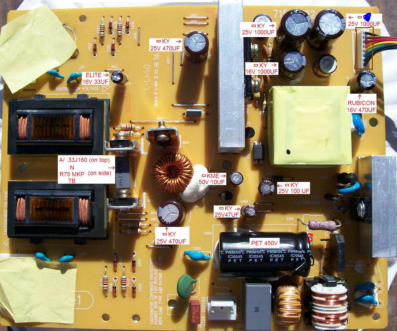

        Thanks!
        Pictures attached
        That isn't a mod, that's an abomination. I'm a technician, not an axe murderer. Would you be proud driving a car like the one in the picture?
        Nice pictures. Take a look at this thread. Look familiar? Between the two of you there are three identical power supply boards.
        I've marked up a picture from the other thread. Put one of the boards back into the monitor and fasten it in place with at least two screws, one of which should be to one closest to the connector that leads to the logic board. Hook up all the wires, but don't put on any shields. Be careful not to touch any point on the board while it is hooked up to AC power.
        Near the AC power connector is a large capacitor. Note that there are red and black circles at the leads. Set your DMM to the highest DC scale, plug the monitor in and touch the red lead of the DMM to the lead circled in red, and the black lead to the lead circled in black. The meter should show a voltage that is 1.4 times your AC voltage. In the US it would display about 165 volts. If that is what you see, the AC input components are good.
        Now let's see if the DC output of the power supply is good. Reset your DMM to the 20 volt DC scale. Hold the black lead of the DMM to the screw in the upper right corner (blue dot). Now probe each pin of the connector, starting at the top one and record the voltages. List them in your next post.
          Knowing the caps on this board, it seems likely that they will require a replacement of all caps. That's going to cost less than $10 for each monitor. But let's not jump to conclusions just yet.
            Thanks for your help! Here's what I found:
            Board #1 Large Capacitor - 165 volts
            Black - 0.01
            Brown - 4.54
            Red - 14.62
            Orange -0.00
            Yellow - 5.00
            Green - 5.00
            Blue - 0.00
            Black - 0.00
            Board #2 Large Capacitor - 162 volts
            Black - 0.01
            Brown - 4.53
            Red - 14.68
            Orange - 0.00
            Yellow - 4.98
            Green - 4.99
            Blue - 0.00
            Black - 0.00
              Black - 0.01
              Brown - 4.54
              Red - 14.62
              Orange -0.00
              Yellow - 5.00
              Green - 5.00
              Blue - 0.00
              Black - 0.00
              Black - 0.01
              Brown - 4.53
              Red - 14.68
              Orange - 0.00
              Yellow - 4.98
              Green - 4.99
              Blue - 0.00
              Black - 0.00
              Good work! Now the bad news. Those voltages are approximately what I would expect from a good board. Even if the inverter were bad, the led in the power button should light up.
              The next thing to do would be to post top and bottom pictures of the logic board.

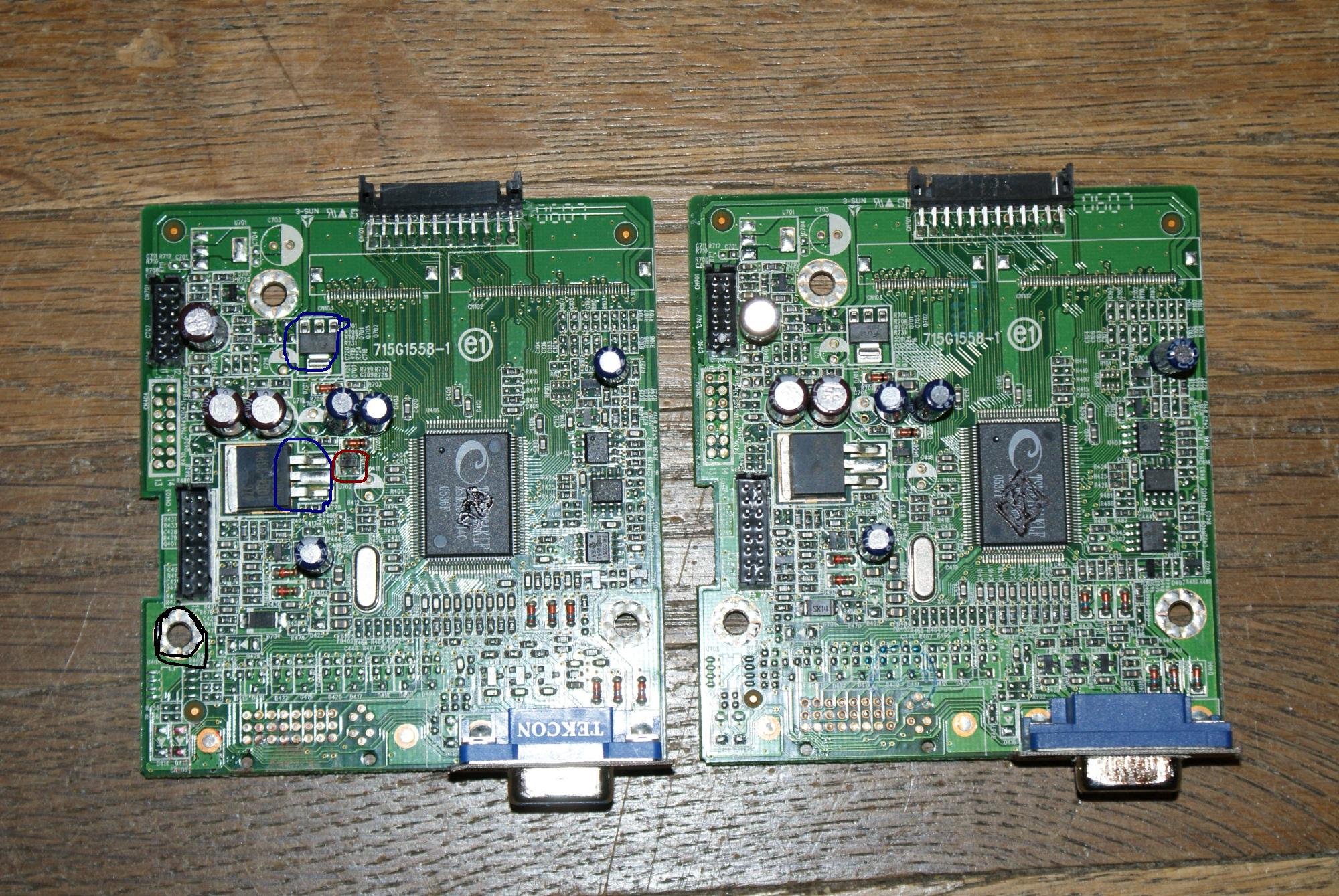

              • RobertoIsRad
                • Nov 2009
                • 42

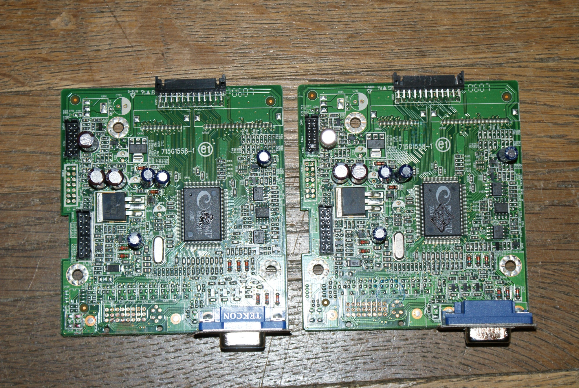

                That's kinda good news at least. Here are the pictures. The flash kind of ruins the pictures but it's too dim right now. I'll take more pics tomorrow morning if I have to.
                • PlainBill
                  • Feb 2009
                  • 7034
                  They are fine. As usual, I've been busy drawing circles. This is the usual drill; put the logic card into the monitor, hook the monitor up to power. The black lead would go to the screw in the hole circled in black (or directly to the solder area). Measure the voltages at all three pins of each of the two voltage regulators circled in blue.

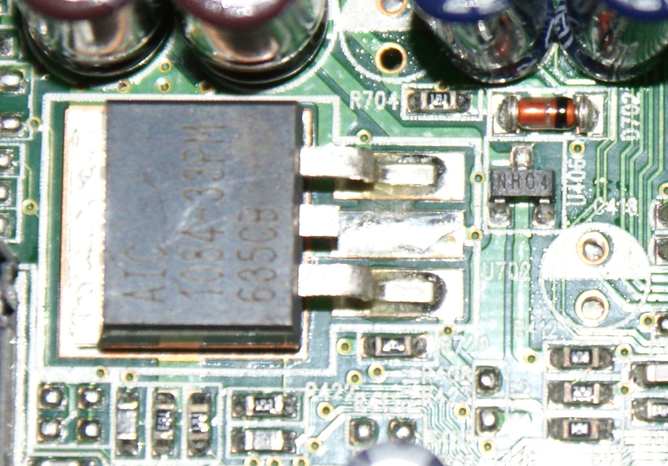

                  Now for something exotic. Note that I have circled a transistor in red. That looks like it might be discolored.
                  NOW, a lot of this has been based on the assumption that the monitor has a power led. I've never seen an LCD monitor without one, but there always is a first time. Would you please check that out.

                  • RobertoIsRad
                    • Nov 2009
                    • 42
                    Board #1 Starting from the top:
                    Left - 3.34
                    Middle - 2.50
                    Right - 2.66
                    Top - 4.72
                    Middle - 3.34
                    Bottom - 0.00
                    Board #2 Starting from the top:
                    Left - 3.34
                    Middle - 2.50
                    Right - 2.66
                    Top - 4.71
                    Middle - 3.35
                    Bottom - 0.00
                    I've attached bigger pictures of the transistor. I would agree that something definitely looks wrong in pic #2.
                    Also this monitor does have a LED on the power button, but currently does not light up
                    • PlainBill
                      • Feb 2009
                      • 7034
                      Left - 3.34
                      Middle - 2.50
                      Right - 2.66
                      Top - 4.72
                      Middle - 3.34
                      Bottom - 0.00
                      Left - 3.34
                      Middle - 2.50
                      Right - 2.66
                      Top - 4.71
                      Middle - 3.35
                      Bottom - 0.00
                      I'm afraid I would have to compare the results to a known good board to make any sense of them. They aren't what I was expecting, but it was a tenuous hope at best.
                      That first picture is amazing. Great photography. And it's good to know that we haven't been trying to get an LED to work that doesn't really exist.
                      As far as the discolored transistor, try using the diode test range on your DMM. Do this with the power disconnected. Put the black probe on one lead of the transistor and note the reading when you touch the red probe to each of the other leads. Now move the black probe to the second lead and repeat; and finally move the black probe to the third lead. Then do the same thing on the same transistor on the second board.

                      • RobertoIsRad
                        • Nov 2009
                        • 42
                        Board #1
                        Black on left pin:
                        Middle - .914
                        Right - The numbers rise until 1.0 and then stop
                        Black on middle pin:
                        Left - .153
                        Right - 1.858
                        Black on right pin:
                        Left - .743
                        Middle - .726
                        Board #2 The one that looks fried
                        Black on left pin:
                        Middle - .548
                        Right - 1.103
                        Left - .147
                        Right - .750
                        Black on right pin:
                        Left - .719
                        Middle - .658
                        I found a service manual for a AL1916v I think my model is an A (I can't find that one though...). At the end of the manual there are diagrams. I wonder if this would help with finding correct readings, unfortunately I don't really know what any of it means...

                                EDIT: Before doing that, check the voltages at all three pins of U406 - the discolored component I circled.

                                    Hold the phone!!! I'm going to have to do some research, but you may have identified the problem.
                                    Awww, crap. This is a knock-of of a Maxim IC, the MAX810. Unfortunately, the letters after the digits seem to be significant, and I can't find the datasheet for this vendor.
                                    The quick explanation: This IC holds the TSUM16AK-LF in reset until the power supply is stable. Then it switches, allowing the TSUM16AK-LF to begin processing. But the information is contradictory. The schematic shows the output is low to reset the processor, but the Maxim data sheet says it is high to reset. If it IS 'high to reset', the TSUM16AK-LF is still waiting for 'permission' to start. And since it's got a push-pull output, I don't dare have you force it, do I?

                                        Not exactly, but close. The reset controller holds the controller in a reset condition until 140 msec after the 5 volt supply rises to 4.38 volts. With a variable 5 volt supply you could monitor the output of the controller. You should see a sudden transition on the output as the input voltage crosses through 4.4 volts.
                                        After some cogitation, I see two ways you can test this. One requires a bit more work, but is unlikely to result in damage to any component or to you. The second could fry the reset controller, but is unlikely to damage you if you are very careful.
                                        First way: This will require two D cells (flashlight batteries), lengths of wires of two different colors and either a holder or some method of holding the batteries in series AND one wire on each end. The result is a 3 volt DC power supply. Connect the positive wire to the top lead of U702 (that's the large 'transistor' just to the left of U406, the reset controller). Connect the negative wire to the bottom lead of U702. Now check the voltage at the upper pin of U406, then the lower right pin of U406. Then disconnect the battery. The upper pin should have been at about 3 volts.
                                        If the voltage on the lower pin of U406 was less than .5 volt, it was holding the reset line low, and the reset controller is working properly. If it was slightly lower that the upper pin, the reset controller is not working properly. If I read the datasheet properly, it should follow the input voltage until it exceeds 4.4 volts, then dropped to less than .5 volts.
                                        The other method of testing requires you reassemble the boards to the LCD panel and hook up all the leads. It also involves working on the monitor with AC power hooked up, so be careful. Locate a screwdriver just wide enough to span the two bottom leads of U406. Position the monitor so you can reach the power button. (This may be easier if you have a helper). Now plug in the AC power, short the two bottom leads of U406 together, then push the power button several times at 1-2 second intervals. If the monitor comes on (or even if the power button lights up), the reset controller is bad. If you smell something like burning plastic, the magic smoke got let out of something. If you smell something like burning flesh, well I warned you to be careful.
                                        The part you are looking for is an ASM810MEURF-T. Equivalent parts should be a MAX810M. Make sure you get the right size part. One is 1.15 mm wide, the other is 1.5 mm.
