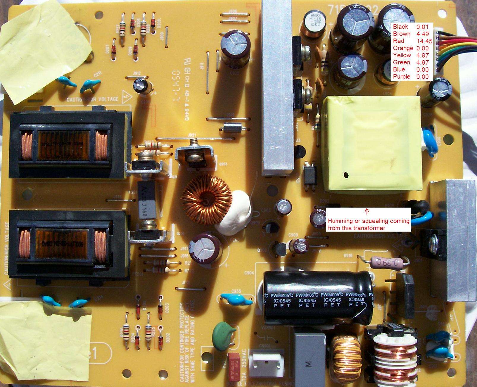

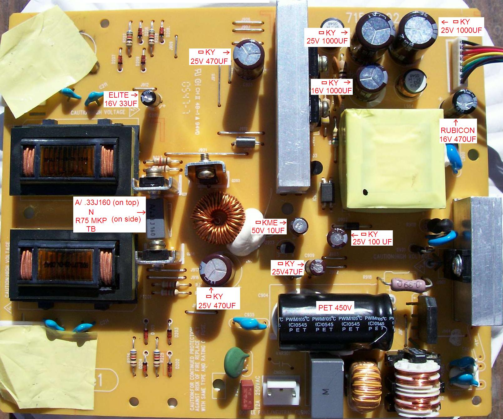

    Found this site and hope someone can help, I have a Viewsonic VG920 lcd monitor and it won't power up at all. I have taken apart the monitor and looked at the PSU (part# 715G1492-1) and it all looks good, no bad caps that I can see. Is there a fuse that could have blown, I don't find anything that looks bad. I have been reading/searching the forum but have not found any problem with this particular monitor on here so I decided to post and see if someone had an idea of what is going on.
    Picture of the PSU is below.
    Bigger PSU Picture
    If you would like to se any other part of the PSU or any pictures please let me know and thanks for any help with this.
    PD

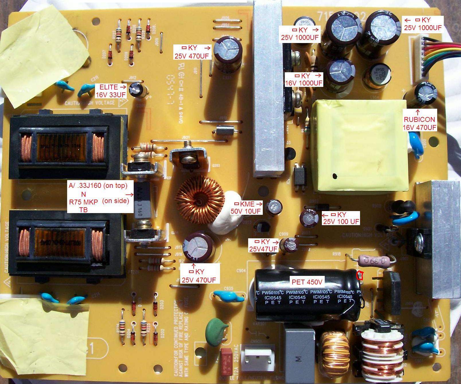

    For some reason my picture didn't come through and I can't seem to edit my post to fix it. So I will put it here.

      The fuse is the brown rectangular block next to the power plug. You can use a small "pigtail" type fuse (one with leads on it) of the same voltage & ampere rating there.
      Check the solder connections of those transformers. Cold joints are a common problem. They will look gray and rough, not shiny like they should.
      If a bad tube is causing an overload, it -could- be the reason the fuse failed. There are a multitude of other reasons.

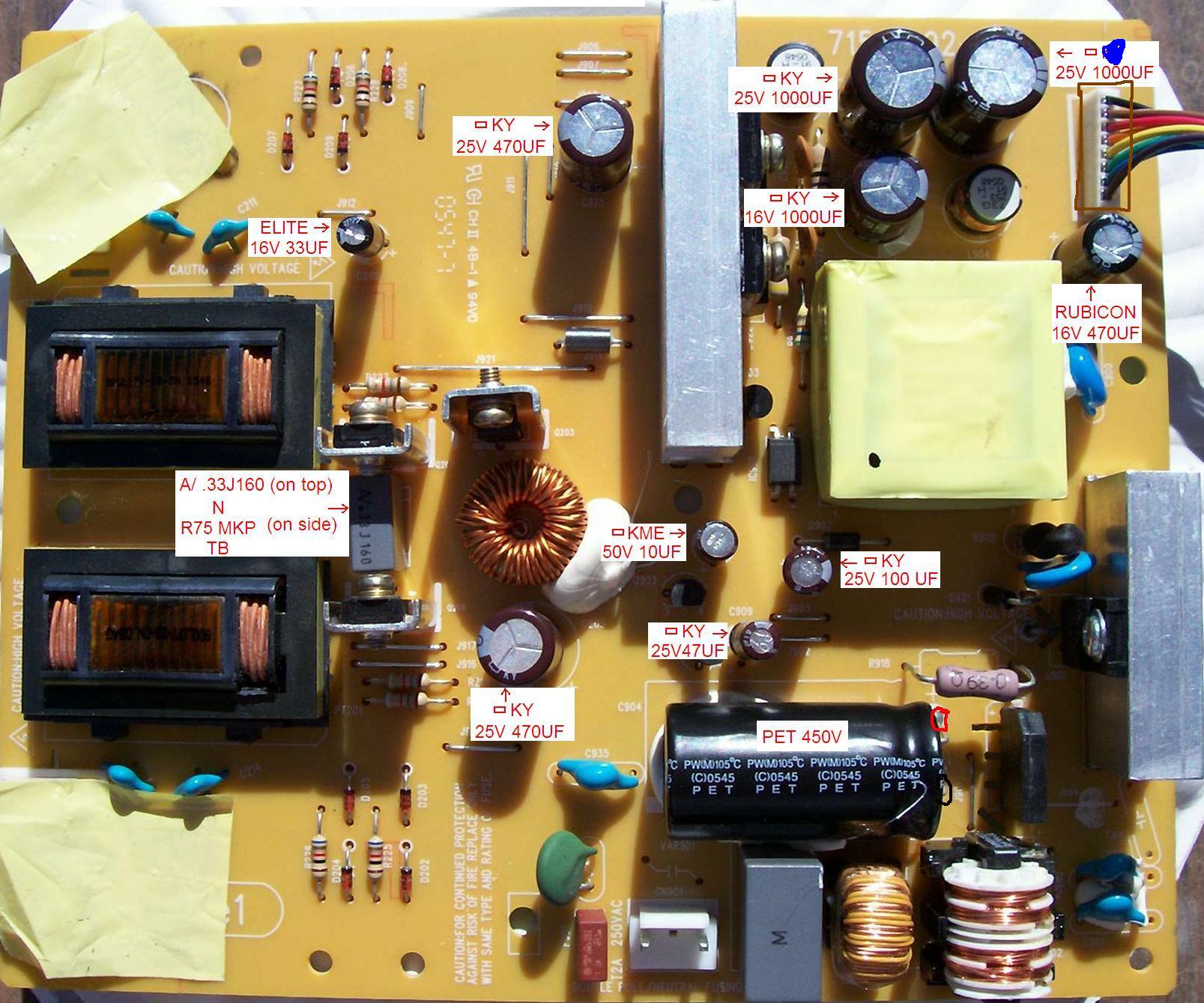

      For starters, report back with the manufacturer(s) of the caps on there.
      Be very careful when working on this "live" as several components will present with household current on exposed surfaces. "One hand in your back pocket rule" applies if measuring voltages. The large cap can have near 400 volts across its leads. Measure that caps voltage and make sure its zero before working on anything.
      DO NOT run it without the lamps connected.

        In the case of a totally dead power supply, one quick test is to measure the DC voltage across the large capacitor. Note Toasty's comments on safety; those are minimum precautions. The voltage across the cap should be roughly 1.4 times line voltage. For the US you should read about 165 volts DC.
        You appear to be having a problem attaching the pictures. Below the 'Submit Reply' and 'Preview Post' buttons is a box with Additional Options. Use the 'Manage Attachments' button there.
        If the proper DC voltage is present, check the output voltages from the supply. The board is often labeled on either the top or bottom near the multi-colored cable in the upper right corner.

          I am just checking but would the transformers be the 2 rectangular black items on the left of the board or the one covered in yellow, or both?

            [EDIT # 2: is that cap actually spelled "Rubicon" ?? ]

              I've slightly edited the topside picture you uploaded and attached it. The pins of the large cap have been circled. Put the board back in the monitor and fasten it in place with at least two screws. Hook up all of the internal leads, but don't hook up to AC power yet. Set your DMM to the highest DC scale (probably 1000 VDC) and turn it on. If you have test leads with J hooks or alligator clips, hook them to the legs of the large cap (red to the leg circled in red, black to black). If you don't, practice touching the probes to the leads without the probes slipping. Now plug the monitor in (touch the probes to the leads of the large cap if necessary), and note the reading. Unplug the monitor. If you measured a voltage approximately 1.4 times your AC voltage (US is 120 VAC), the fuse is good. If you used alligator clips or J-hooks wait a few minutes before disconnecting them.

                Yes that is my bad spelling the "rubicon" cap is actually spelled rubycon. Sorry about that. I did go ahead and do what you suggested. I checked and just to make sure everything was good I resolder the connections for the transformers, mosfets, fuse, and the large cap. I attached some picks to show the results and see if I missed anything. Also when hooking the CCFL wires back, does it matter which one goes in what socket? On the top set of sockets the white & pink wires are in the top socket and the blue & white is below them but in the bottom set of sockets the blue & white wires are in the top socket and the pink & white are below. I don't think the wires are long enough to change them around, but I just thought I would ask.

                    It doesn't really matter. Notice that you have two transformers, but 4 pairs of wires. The output from each transformer drives two CCFLs.
                    EDIT: You can only edit a post within 10 minutes of posting it.
                    Sometimes a board will be labeled with the function of each pin. 5V 5V 5V GND GND GND BL_ON BRI is an example.
                    In this case, starting from the black wire the pins would be GND GND 5V 5V GND 12V and either BRI BL_ON or BL_ON BRI

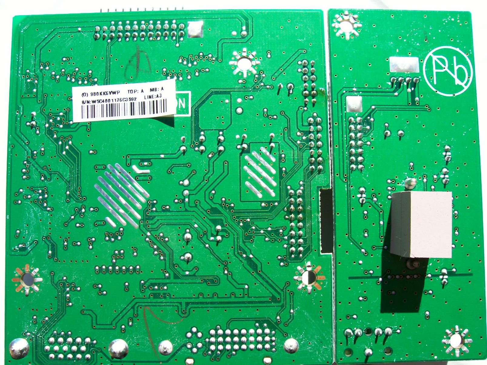

                            Probably not. The results are the same in both cases. The voltages you are getting are what I would expect from a good power supply. It is possible replacing all the capacitors would help, but I really doubt it. If the 5 Volt lines were lower or if the power led on the monitor were flashing it would be worth trying.

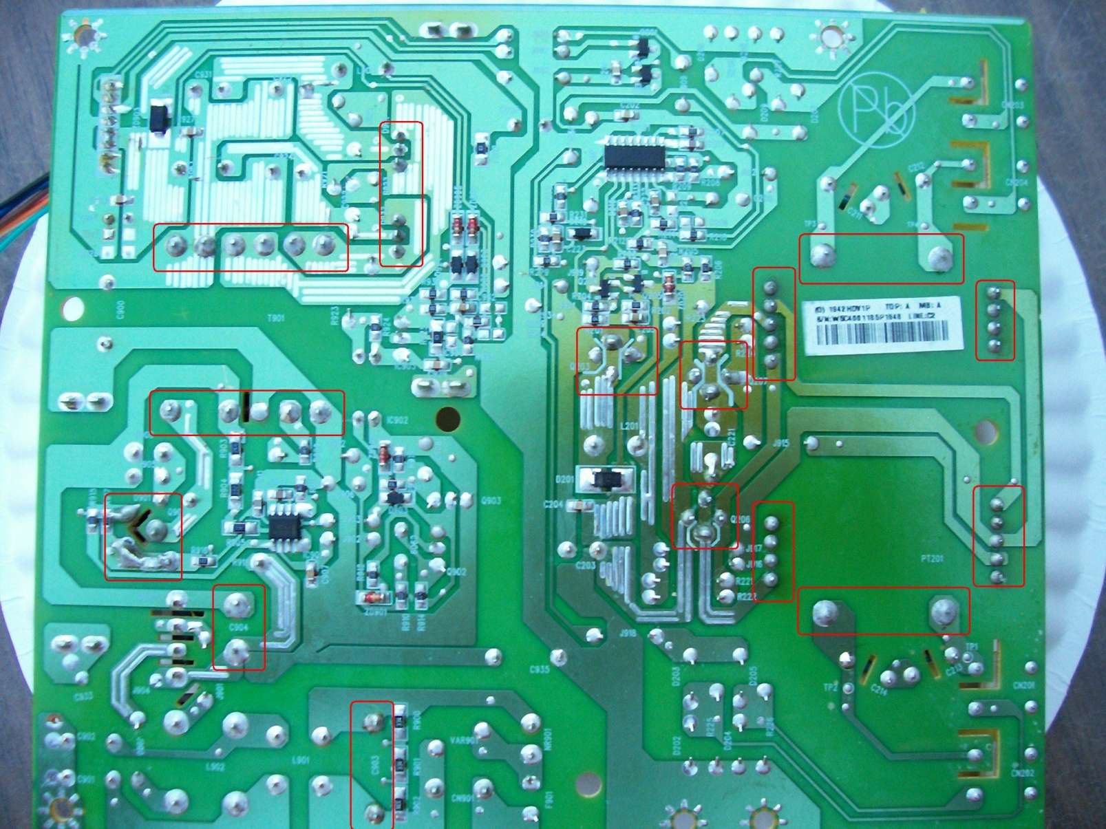

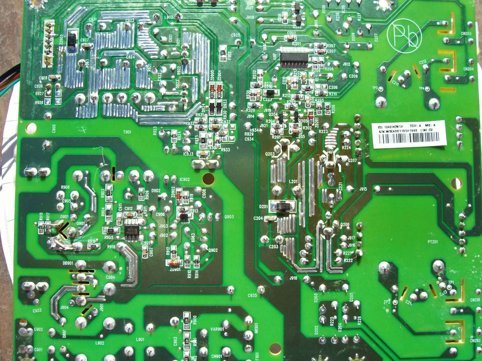

                            As I requested from the other person, post good pictures of the top and bottom of the logic card.
                            PlainBill

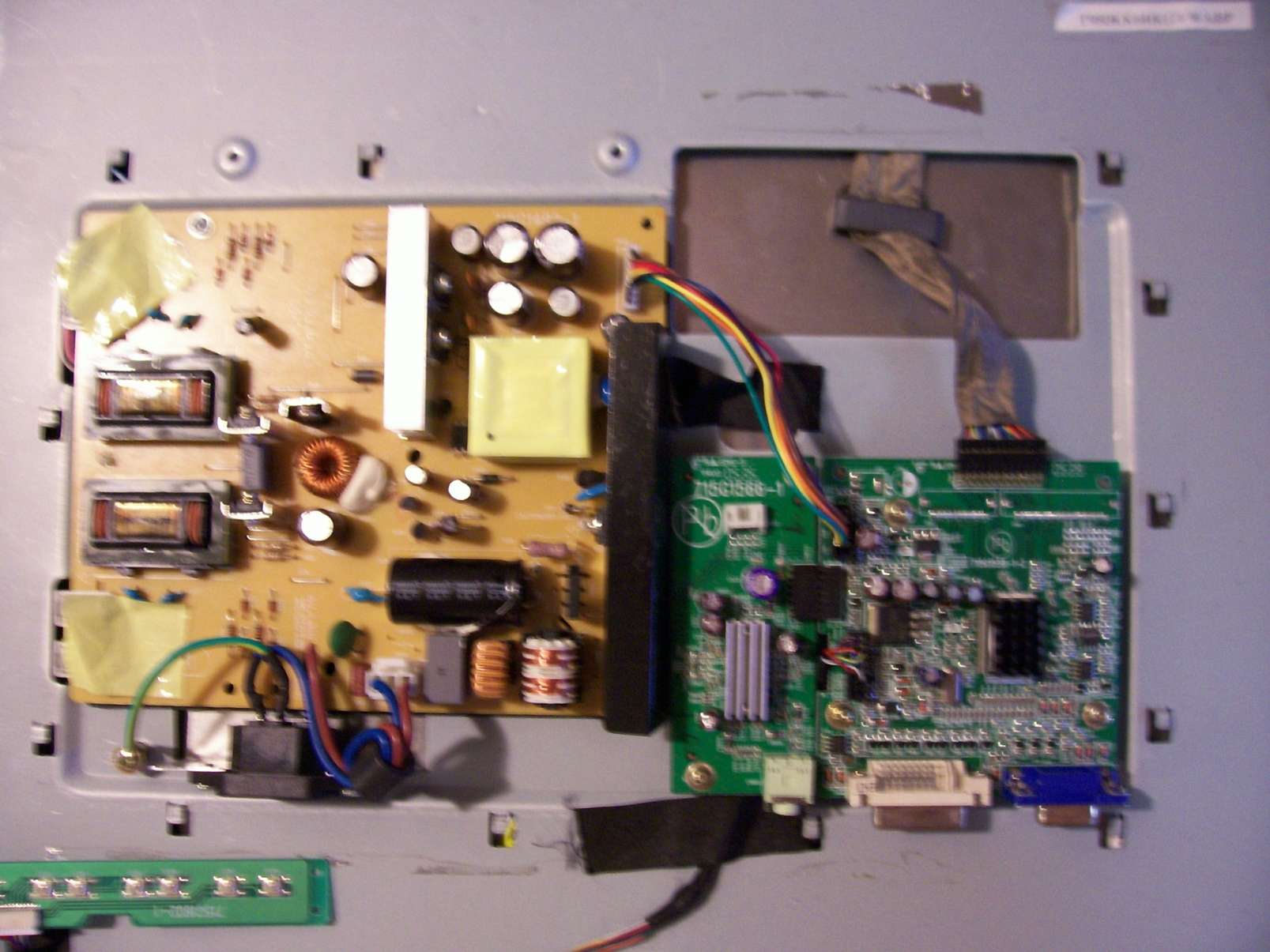

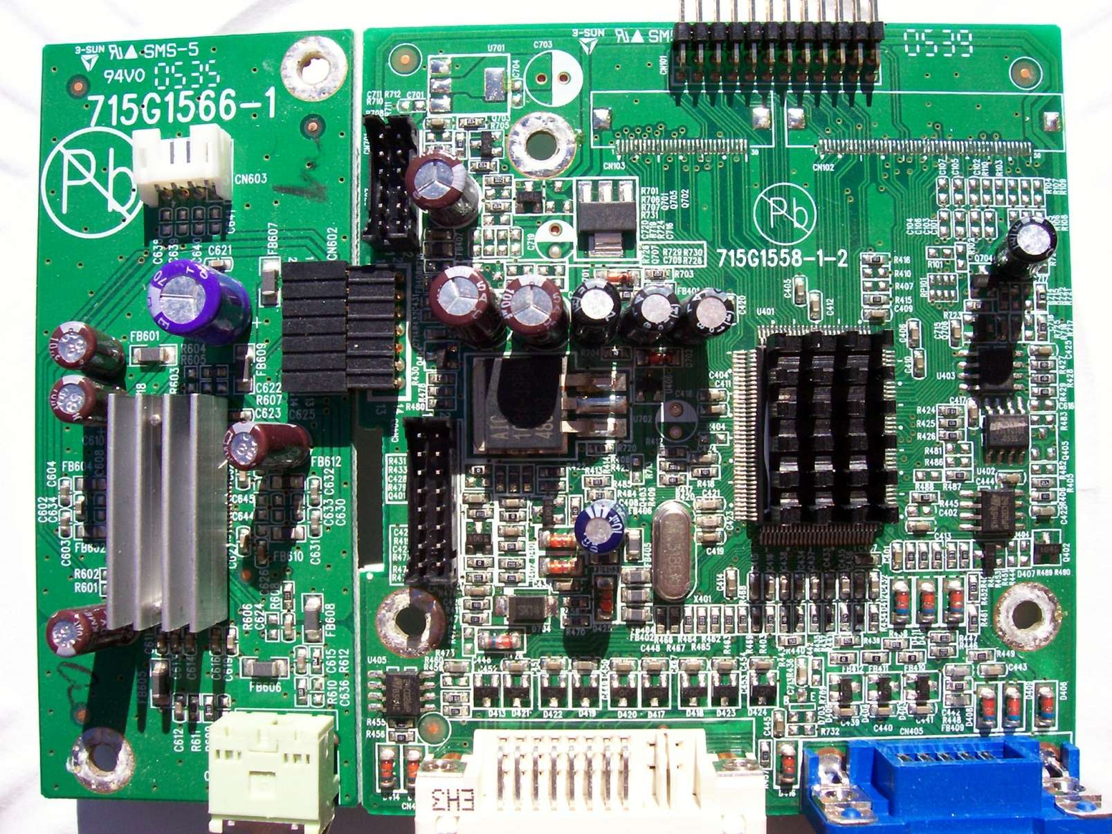

                                  Yes I found the other thread and was looking at the posts. I went ahead and did the same diagnoses on the voltage regulators
                                  This is the usual drill; put the logic card into the monitor, hook the monitor up to power. The black lead would go to the screw in the hole circled in black (or directly to the solder area). Measure the voltages at all three pins of each of the two voltage regulators circled in blue.
                                  My reading are almost the same as his
                                  Starting from the top voltage regulator :
                                  Left - 3.30
                                  Middle - 2.47
                                  Right - 2.63
                                  Top - 4.66
                                  Middle - 3.30
                                  Bottom - 0.00
                                  The difference I see in the logic boards is mine has DVI and the sound board and that is about it (to me atleast)

                                    I discovered there are only so many hours a day that one can sleep. At some point the mind starts running around in circles and I have to do SOMETHING. (Emptying a box of Kleenex every two hours does not qualify as something). As far as recovery, I have COPD. If I can prevent this from settling into my lungs, I will be fine. Unfortunately, somewhere in the design process of the human body a decision was made that the sinuses (sini?) should drain into the lungs. Perhaps the fact that sitting hunched over a keyboard transfers the drainage to the nose IS a sign of intelligent design.
                                    I'm basing these comments on the manual for the Acer AL1916v manual. Chapter 4 is a series of troubleshooting trees. Page 31 covers 'No Power'. Notice the third block down "Measure U701 Pin2=3.3V, U702 Pin2=3.3V". Looking at the excellent picture you provided I note that U701 is not present. The schematic seems to indicate U701 and U702 are alternate components. And your test verifies 3.3 volts is present at U702, pin 2.
                                    Now we have a problem. The next step is "X401 oscillate waveforms are normal". X401 is the crystal oscillator, an oval metal can below and to the right of U702. Checking this requires an oscilloscope.
                                    If that is good, the next step is to replace U401, which provides it's own set of complications. This site indicates they have the part in stock, at a cost of $10. However, replacing this requires advanced reworking skills and some special equipment.
                                    I would suggest you see if you can find a hobbyist or professional in your area who has an oscilloscope and can check the crystal.
                                    PlainBill

                                        There's also one across the 12v & 5v output rated at 9.1v. If the difference between the two goes beyond that it conducts, acting as a crowbar of sorts. If that zener exists in this PSU, then we are past its rating by .38 volts. (14.45 - 4.97)
                                        Isn't there a way, after disconnecting this from the logic circuit, to get the backlights to fire? Applying a few volts to On/Off line which goes to Q201?
                                        Curiosity @ PlainBill - On the logic board & the "side board" - There are a whole slew of tiny little SMD's marked FB###. Are those fuses? I noticed them on my Dell's and everyone of them reads 0 ohms. Just curious if any of them are reading open.
                                        Or, maybe I'm just Nuckin' Futz...
