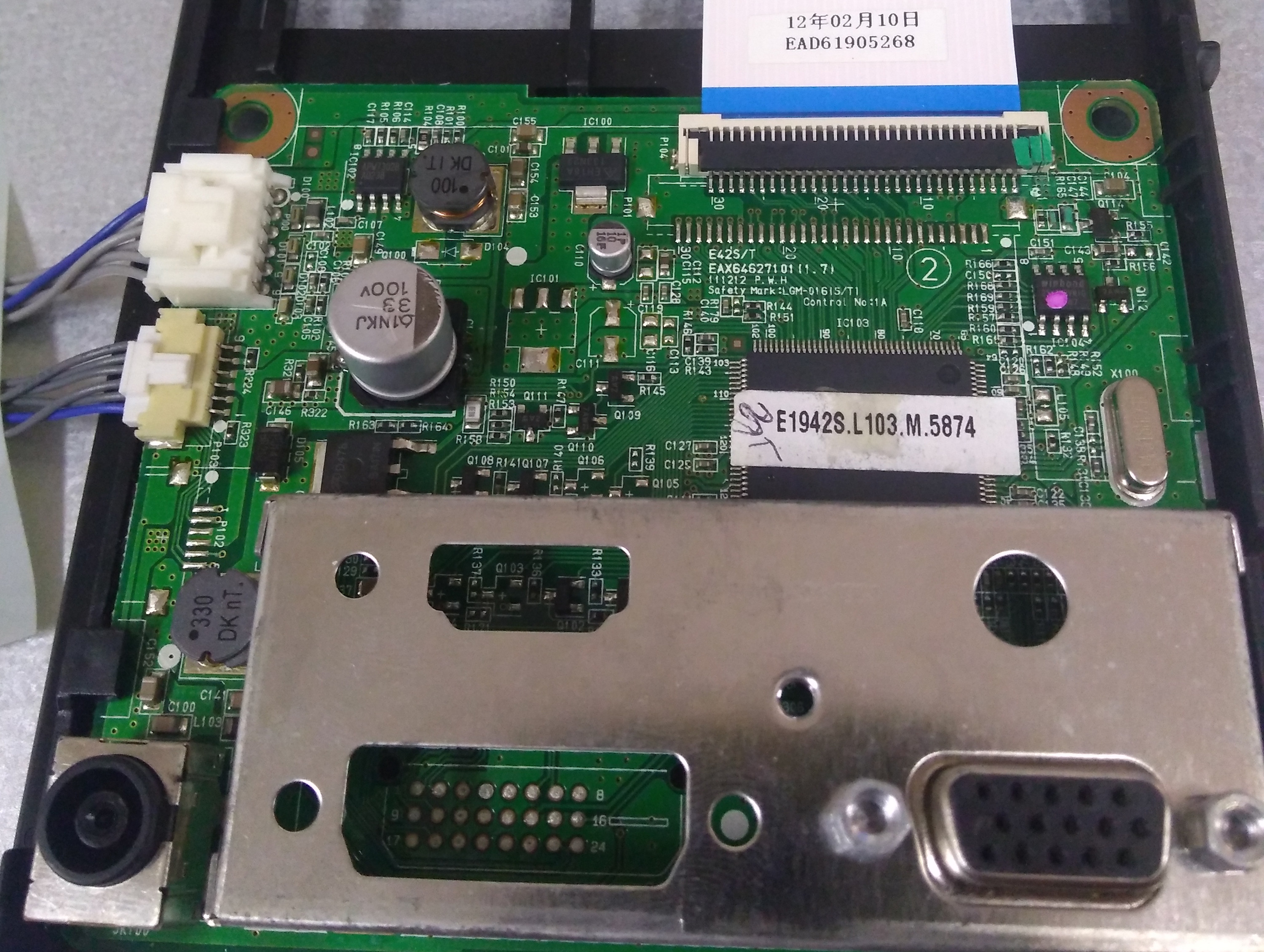

    Hello community,
    This monitor turns on and off very quickly upon connecting the AC adapter (tried two, tested 19v).
    I can see the LG logo on the screen for a split second, then turns off and on constantly in less than 1 second intervals. There's a high pitch noise while the stand by light/screen is on.
    I looked at the capacitors, only removed the big one
    1NBKJ
    33
    100V
    Measured it, it was fine. Anyway replaced it with a new one, and no luck.
    Just to test, unplugged the CCFL. Plugged the AC adapter. It stays on, the high pitched noise remains (some IC? coil?) and I can turn it off manually.
    Any help will be greatly appreacciated!

    Re: FLATRON E1942 blinks on and off
    This monitor uses LED's for the backlight, not CCFL's. How did you "measure" the 33µf/100v cap? Check that D105 is not shorted. There are also a few fet's I believe that are on the rear of the board, Q101~Q108, check that none of them are shorted.
    You can also monitor the return voltage on the plug going to the led's. with the monitor off, monitor the voltage on pin#1 as you turn on the monitor, then do the same for pin 2, 5 & 6.
