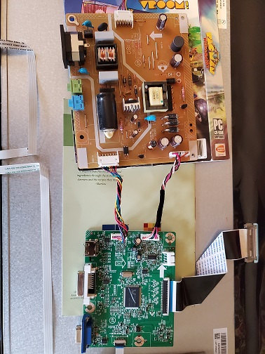

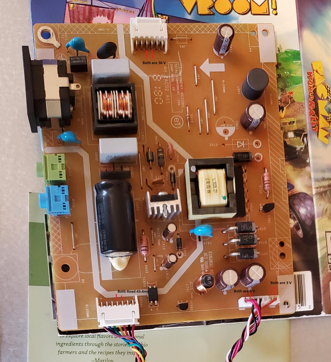

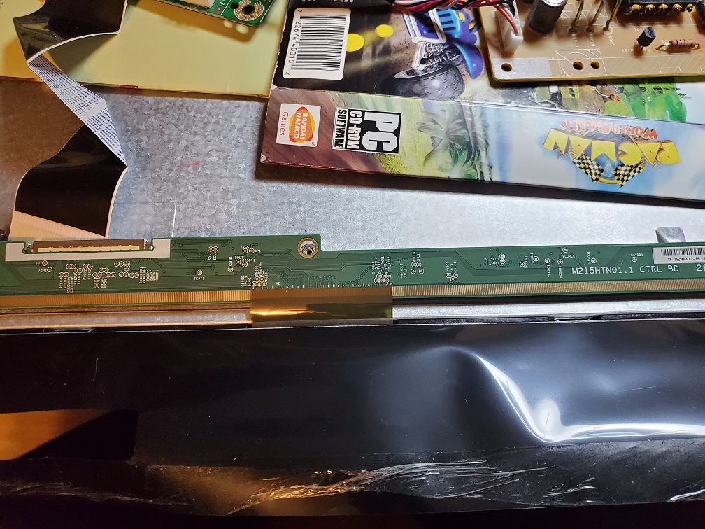

        So I took it all the way down to the boards and rehooked everything so I could get some voltage readings...
        I have included my rough setup and readings in the images;
        Basically 36 volts to the Back Lights (I believe)....
        There are a pair of 5 volts and 3 volts connections (Lower Right)....
        On the Lower Left...I get a pair of 49.4 mv readings.
        All these readings are with the monitor plugged into a computer and power of monitor on...Clear Bezel is blue not orange...
        Any ideas?
        Chris

          CN501 is just the plug for the blue and green audio jacks. CN701 pins 6&7 are +5 volts, pins 4&5 are ground, pin3 no connection, pins 1&2 are likely backlight control.
            R_J,
            Thanks for the response.
            So looking over your response it appears the boards are the correct voltages but still there is no image or coloration on the screen....Any guesses on what is wrong with this monitor?

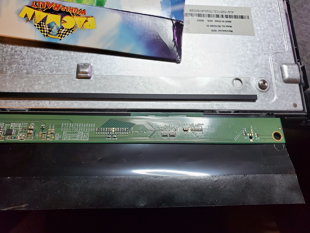

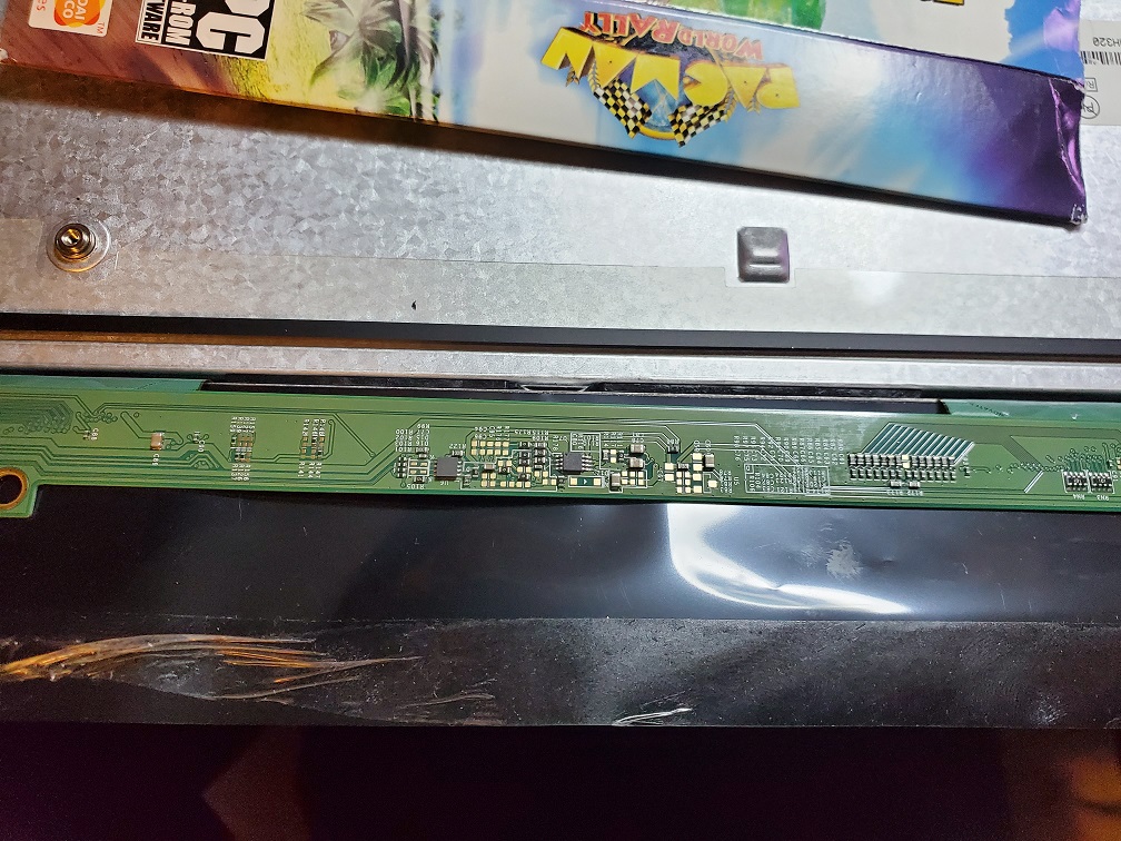

                    It appears there is a fuse (F1). Right above the 30 pin on the lvds connector.
                    Its a SMD and from continuity test it appears not to be continous (blown). Visibly it looks fine...maybe a single very small dot in the middle of the fuse but my magnifier glass does not really bring it out.
                    Also with everything plugged in as it should and power on there is also a 5V1 test point that is showing 5 volts but thats before the fuse.
                    With the fuse being probably bad the voltage readings outside (further right and left of the lvds connector) the fuse point not showing voltage lines up in my mind.
                    So the question is how do I proceed from here?
                    I have SMD\soldering station but have not done it ever...and I have no additional SMD fuses.
                    Is it probable the panel is just bad or is it possible the fuse just let loose?
                    Could I just solder over the fuse to test or do I risk irrepairable damage?
                    As always Open to ideas....
                    Chris

                        Check the resistance between tcon ground and the fuse (the side without 5v) There is a cap,C5 that is not installed so you can use the negative pad for ground. There may be a short elsewere on the tcon that won't show itself right at the fuse, the short might be in the area of the (AUO) ic, sorted ic, shorted smd cap, diode, etc.
                        As for the fuse, there is likely a letter marked on it which is the value. It is possible that it is just the fuse that is bad.
                        I would not just "solder over" the fuse. you can solder a regular pigtail fuse (correct value) across it if you have one.
                        Also be carefull with the flex cables connecting the tcon to the panel, don't flex them or stress them to much. they are bonded and if they get damaged it is not good.

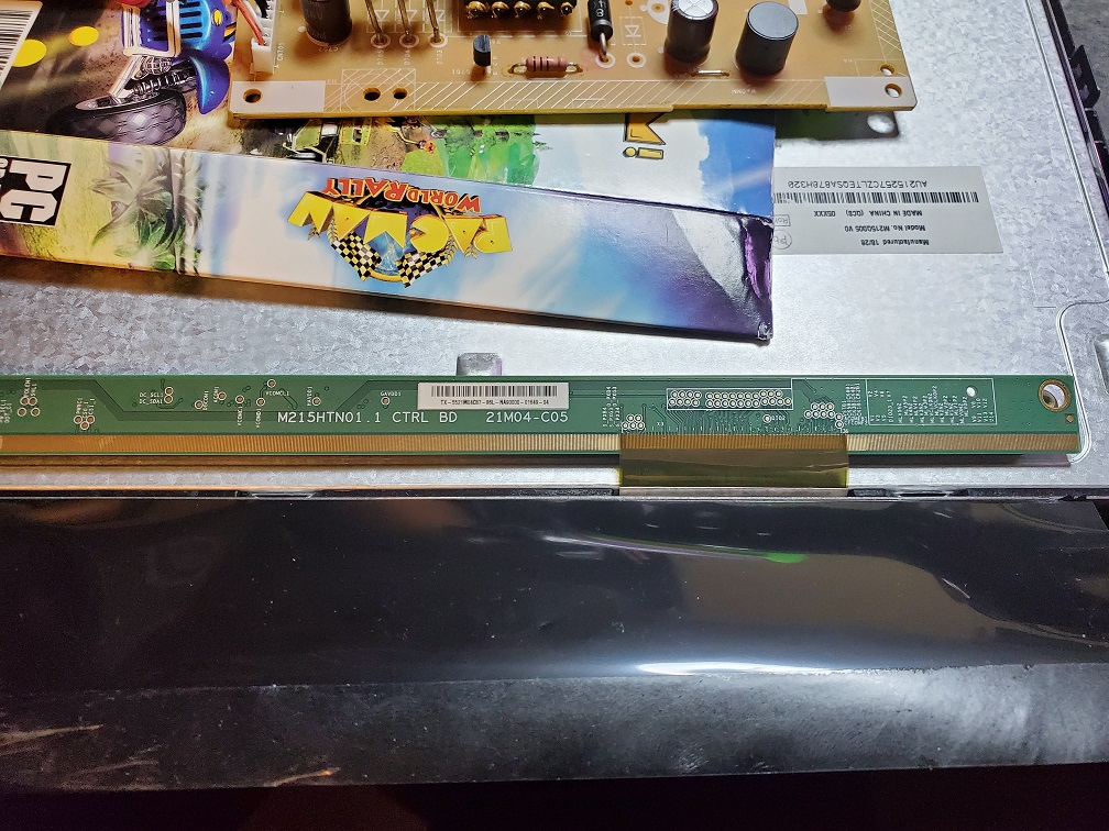

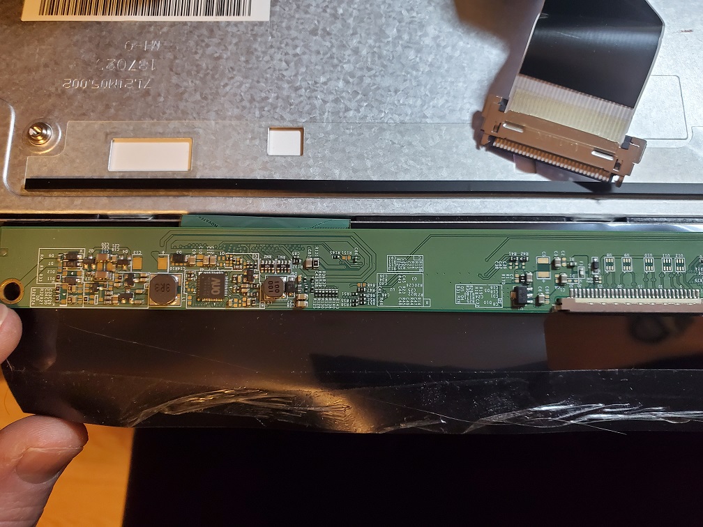

                            Ok, so I set my Klein Tool Voltmeter to Ohm (sound) and put my negative black lead on the C5 Negative pad. I put the positive lead on one side of the fuse I get no sound...I do the same positive lead on the other side of the fuse and still nothing (no sound).
                            I did short tests across the capacitors on the TCON...nothing...
                            I tried enlarging my images of the TCON board, my eyes not as good as they used to be... to see if I see anything unusual...Nothing looks warm or unusual to my unskilled eyes.
                            I could do similar tests on the diodes and mosfets if you think it would be beneficial?
                            It seems like when I do voltage tests (somewhat difficult do to my current arrangement of the boards/cables) it does not get much outside the lvds cable area connnection of the TCON board. Can you tell from my previous scans whats controlling the propagation of voltage outside that area? Any other ideas?
                            Again thanks for the help,

                              You can't do any voltage checks on the t-con with the fuse open, I would replace the fuse and see what happens, buy a few just in case.
                              When checking for shorts with your meter, don't rely on the Ohm (sound) use the low (usually 200Ω) range and note the resistance. If its not a short it should be ok. If you don't have a fuse, do you have something like a 1Ω 1/4 watt resistor? If you do, use it in place of the fuse for now.

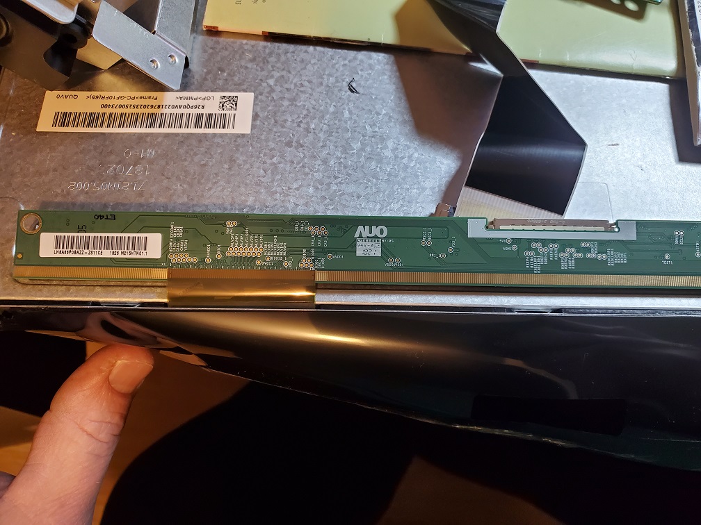

                                Did the 1Ω 1/4 watt resistor route.
                                At first the Monitor just flashed the white screen as it did before.
                                I started using my hand to locate warm area on the TCON. Lower Left felt warm then fuse resistor started to smoke and then everything stopped...resistor toasted out. From quick test seems like things were powering up on the TCON board beyond the fuse then shutting down and then trying again over and over...The white screen did not sit consistently on as did before when plugged in to DB15 video source.
                                Tried again with new fuse resistor. Was able to locate warm area C9,C11,C12 and area around the ONV including possibly the ONV itself. C10 was an area not used just mount pads. The rest of the board never warmed up to the point I could feel anything unusual but did have voltage readings outside the LVDS connector where I did not previously. Upon touching C11 with leads the capacitor shifted off its pads. I shut things down...tried an attempt to put things back the way they were before. Tried things again C9,C11,C12 were again hot enough to shift again...so I shut it down to avoid further damage/future work.
                                Am I right in assuming something originally must have affected the panel on the left side and it just shorted out the TCON to the point it blew the fuse. My "replacing" the fuse shows us basically/roughly the troubled area but this is not a TCON issue but more than likely a Panel now as we are so close to the panel ribbon cable?
                                In either case I probably could clean the C9,C11,C12 up again, if you think its something in the TCON/worthwhile, but I would probably use my surface mount equipment.
                                I appreciate all the help...Please let me know I am really curious on your thoughts.

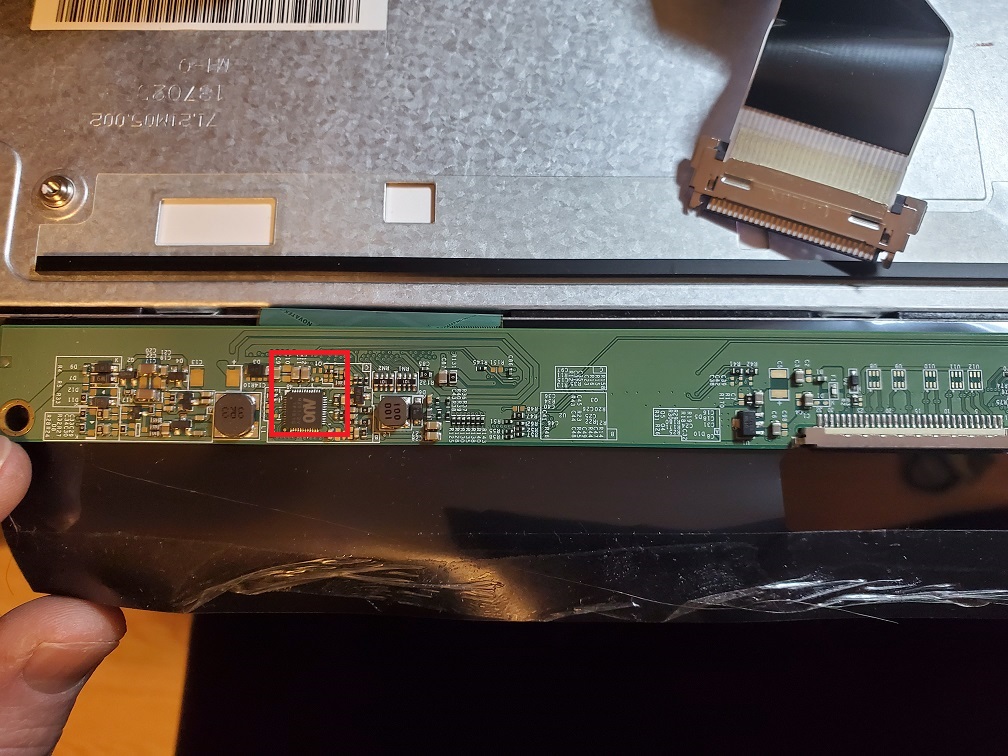

                                  Check C9,11 & 12 with your Ω meter, do they check shorted? it is possible one is shorted, or the ic next to it is shorted.
                                  What is the number on the AUO ic?
                                  If it is the AUO ic, it will likely have a large solder pad in the middle used as a heatsink, so removal would not be easy and require a hot air station.

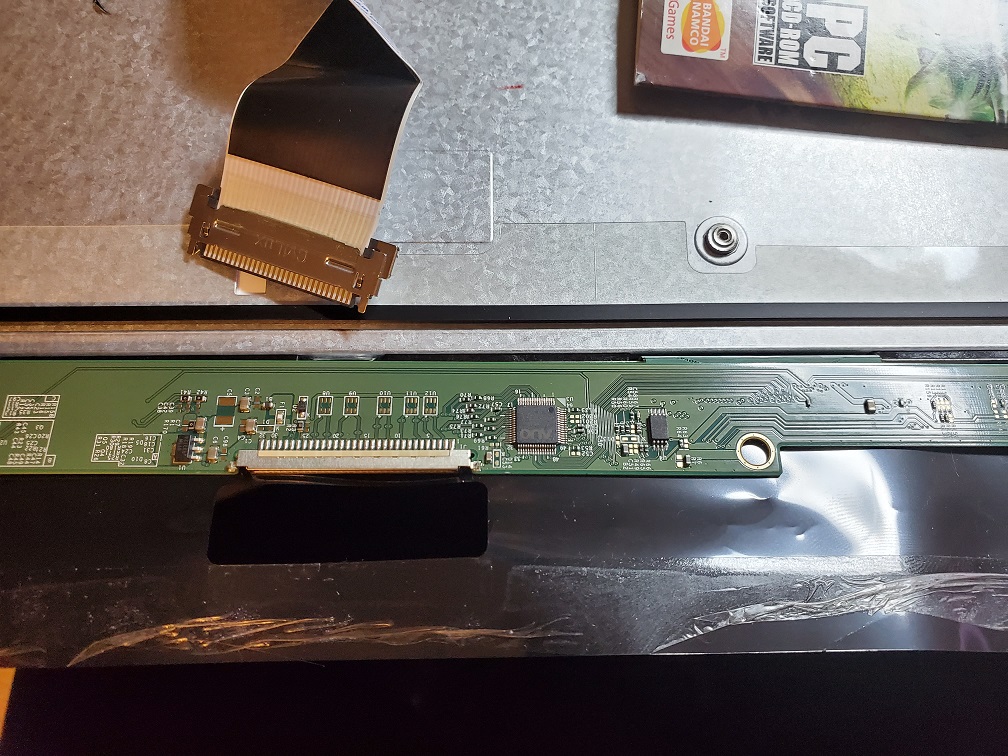

                                    The AUO ic is a M201-2V 18151G.
                                    I do have a inexpensive hot air station....an ebay one...I use it commonly to remove IPad/Android digitizers. I do not have experience with removing and adding SMDs but I do have a few junk boards I could practice on if it came down to it. Not sure what more I would need other then flux, station, and solder.
                                    I tried your suggestion of not using the tone continuity/ohm tester portion of my multimeter to do my short tests but to try low ohm setting (200Ω)
                                    The value of the three capacitors matched at around 54-55 Ohms.
                                    I also did the tone test with the ground lead to ground and testing each capacitor sides. Checking for no two sides of a capacitor should set off the tone...Similar to the youtube video;

                                      Most meters will "beep" checking continuity when the resistance is between 0Ω (or short) and 150Ω so all it tells you is there is a resistance less than 150Ω. In very low voltage circuits (1~3 volts) the dc resistance can be quite low.
                                      The caps are likely ok I suspect the ic is the problem but I don't see a datasheet on it
                                      I do see a few diodes and transistors in the area, I would check them also, They are easy to check and if found defective, easier to replace then the ic.
