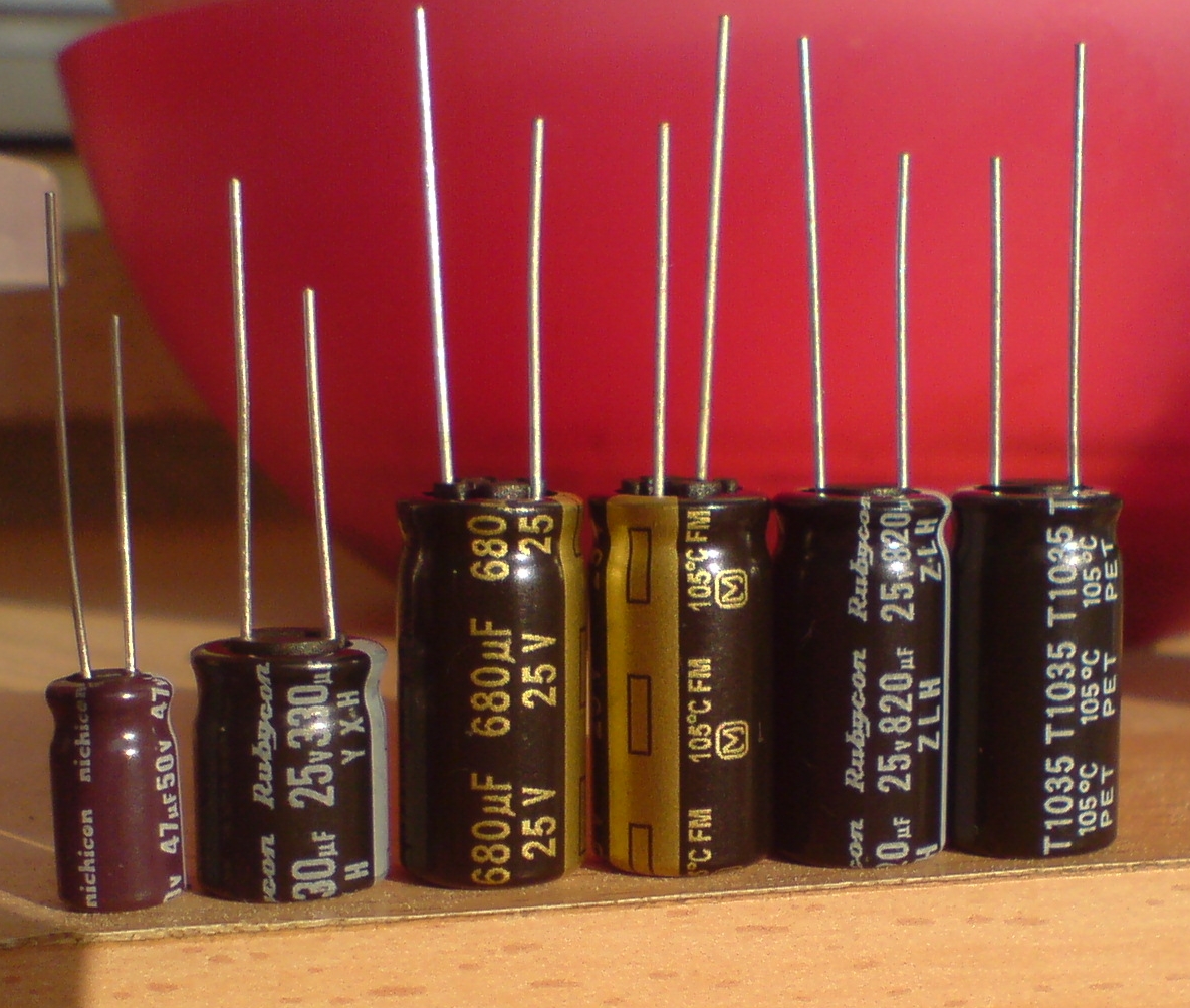

                                      Hello, guys!
                                      I'm happy as a bunny because I just fixed my 4 1/2 years old flickering Samsung 226BW following your advices and replacing the bad Capxon caps from the power board.
                                      I have replaced all the capacitors (my first time with the soldering iron ), except the big one, with the following products I bought from RS Online:
                                      1 X 47μF 50V Nichicon UPW1H470MED
                                      1 X 330μF 25V Rubycon 25YXH330MEFC10X12.5
                                      2 X 680μF 25V Panasonic EEUFM1E681
                                      2 X 820μF 25V Rubycon 25ZLH820MEFC10X20
                                      For the 47μF cap I choose the Nichicon PW over Panasonic FC because the later have slightly lower ripple and higher ESR specs than the Capxon GL counterpart, I hope it's OK and nothing goes (I don't really think that, I just wanted to use the smiley ).
                                      Thank you very much for this great website and keep it alive, you're helping a lot of people!
