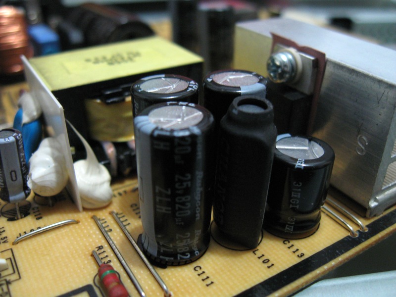

                          It fixed the problem. Left C113 empty. I looked at where the caps were electrically first. The 2 that are populated are on the supply after the inductor and C113 was before the inductor. I just left it alone.
                            If I recall correcrtly, C113 was after the inductor. You are looking at it from a wrong direction. The two populated ones are the main filter capacitors (both 820uF 25VDC), which is then followed by an inductor. Then after the inductor there is a 330uF 25VDC capacitor there. Usually I will also replace this one as sometimes will fail. Here is another 226BW that just came in. Symptom was having difficulty switching on. Has a different power supply board than the usual one (as shown the first image). See that smaller bulging 330uF 25VDC capacitor (as shown in the second image)? Replacing it revives the monitor. Anyway, gonna replace the rest of those awful Samwha XC capacitors (as there is a slight hint of audible hissing from the transformer)...

                              Looks like the little guy gave up his life for the big ones. Brave cap. I think you are right about the sequence. I was viewing that connector as power in. It is not of course. What makes me suspicious that it is an output is that big AC socket at the other end of the board and all that power supply stuff around it. Duhh. Old brain, getting older.
                              I replaced all of the electrolytics. I was not going to save a buck and have to do it over again. I even got the big one. That one cost more than all the others together. But I tend to believe that if is worth doing, it is worth overdoing.
