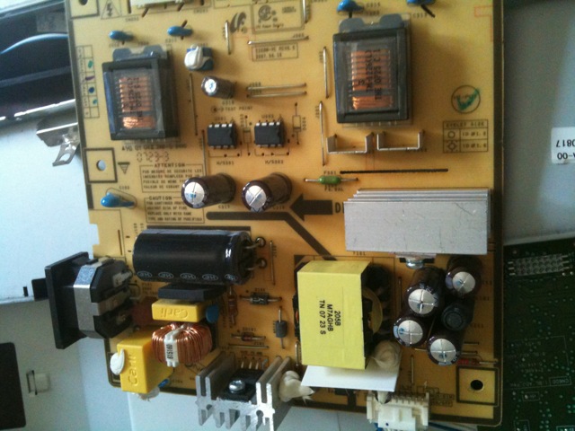

                        Another Samsung 226bw with bad cap problems. It has been ongoing for a few months but I've not had the time until now to try and fix it. Yesterday it took 3 hours for the monitor to finally warm up so that was the last straw. Opened it up, figured out which caps I had and what to replace them with from the info contained in this helpful thread.
                        I just placed an order at mouser.com for the following:
                        Mfr. #: 1 x EEU-FC1H2R2
                        Desc.: Aluminum Electrolytic Capacitors - Leaded 2.2UF 50V ELECT FC
                        Mfr. #: 1 x EEU-FM1H220
                        Desc.: Aluminum Electrolytic Capacitors - Leaded 22UF 50V FM RADIAL
                        Mfr. #: 1 x EEU-FC1H470
                        Desc.: Aluminum Electrolytic Capacitors - Leaded 47uF 50V
                        Mfr. #: 1 x EEU-FM1E331
                        Desc.: Aluminum Electrolytic Capacitors - Leaded 330UF 25V ELECT FM
                        Mfr. #: 5 x EEU-FM1E821L
                        Desc.: Aluminum Electrolytic Capacitors - Leaded 820uF 25V ELECT FM
                        Decided against replacing the big 150uF cap at position C105 as it looks to be in fine shape, and considering only replacing the five 820uF and one 330uF caps as they are the only ones that are bulging at the top... ordered the rest just in case.
                        Picture of my board below.
                        Will post with results when I complete the repairs. This is my first time soldering anything, wish me luck!

                                            My Samsung SyncMaster 215TW makes a buzzing / hissing sound when turned on.
                                            The sound is louder the brighter the monitor is, e.g. in the "Game" preset is is even louder than in a softer preset.
                                            Opening up the monitor and unplugging the small socket cables that run from the power board to the LCD, I can see a small blue...
