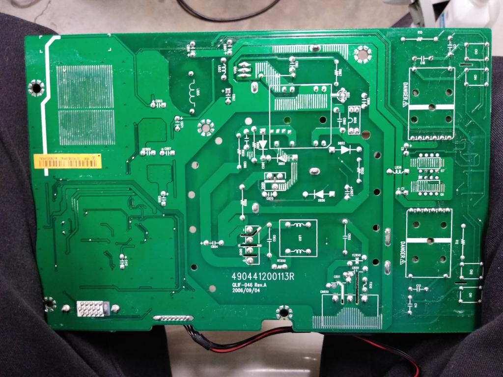

    I've got a Dell F177FPE that went dead, it won't power on.
    There's no power "on" light or anything.

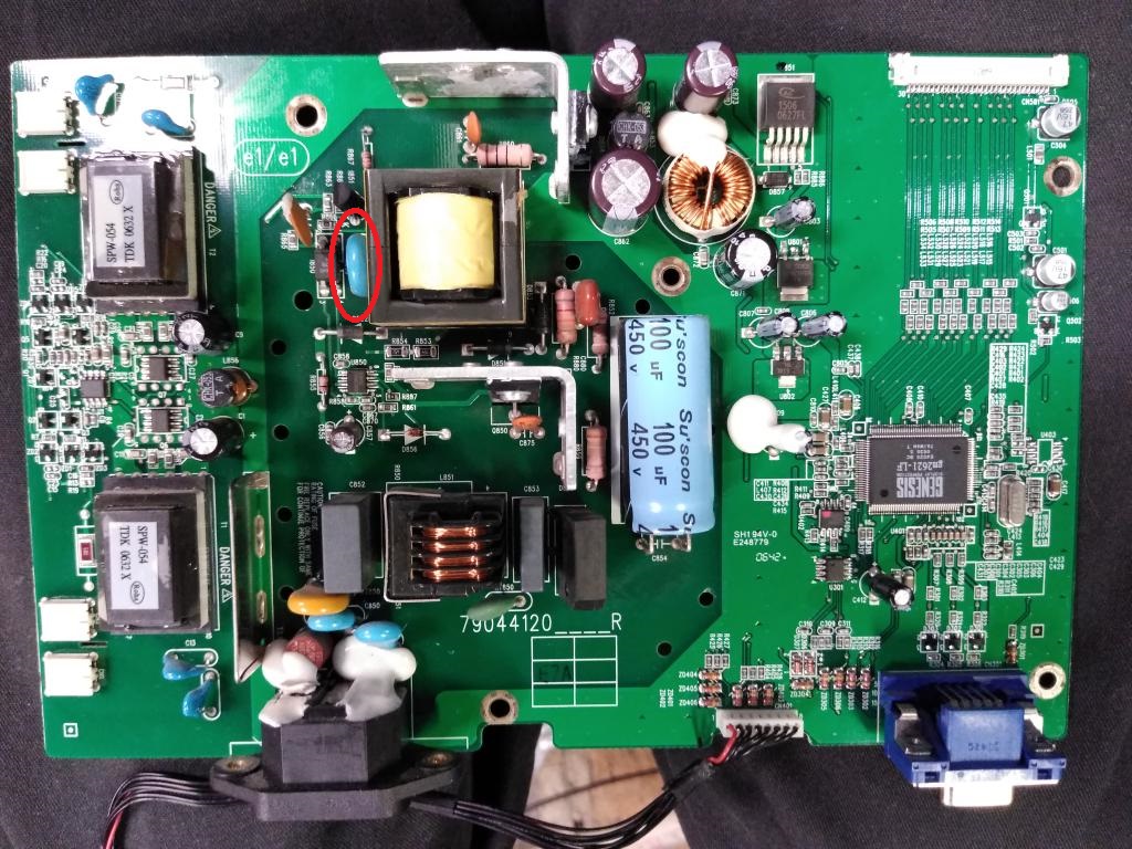

    I took it apart and the caps all 'look' good but they're all cheap Su'scon's or Teapo's.

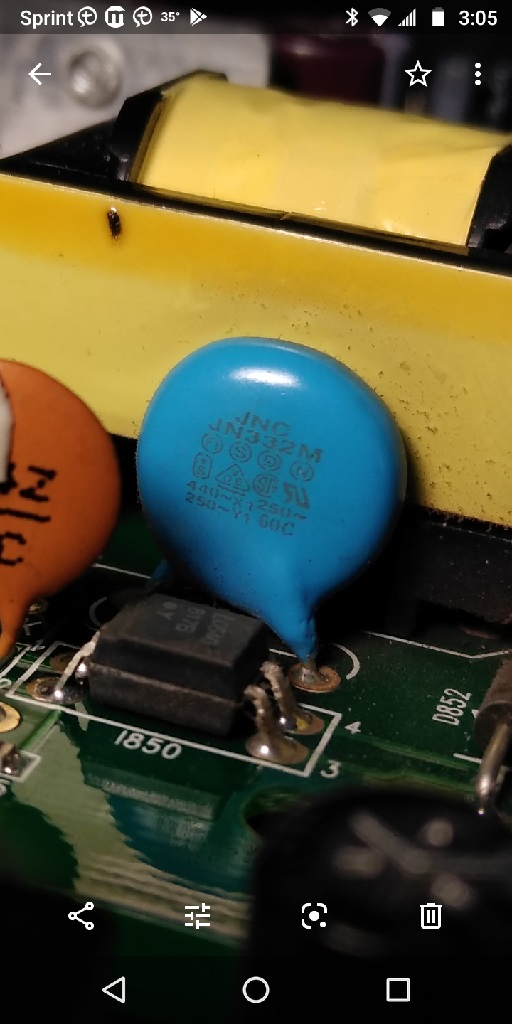

    While doing some basic tests of the board I found a Ceramic capacitor that shows open with the ohm meter, so I'm hoping that's the cause of my no power up problems. I included pics of the failed cap and it's location on the board.
    My question / problem is I've never replaced or dealt with these type of capacitors so I want to know if I'm reading it correctly and my choice of replacement is correct. (based on what I've read)
    The original is a JNC JN332M 250v and I'm not sure what the 440 x1 and 250 x2 means.

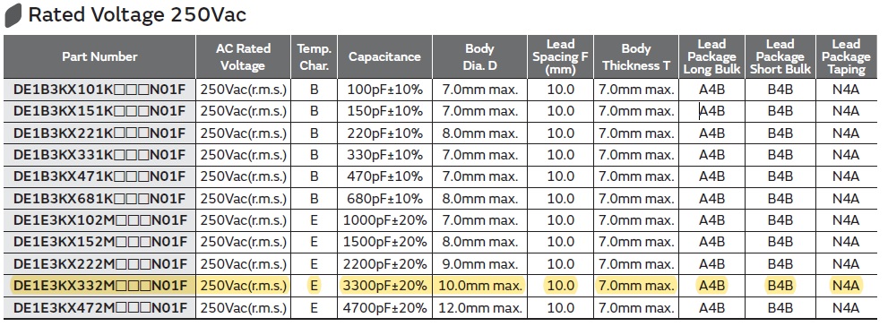

    I've picked out a Murata Electronics DE1E3KX332MA4BN01F replacement.
    I'm also going to replace all the Alum Elect Caps while I'm in there.
    If there is anything else you notice, I'm open to suggestions.

    That is a snubber cap is supposed to read open. If it would have failed, you would see it. Since you don’t even have a stby led, probably the stby power rail that is always on is not working, or there is no AC going to the bridge rectifier. So check if you have about 170VDC on that main filter cap. Also the PFC needs to work (roughly 380VDC on the main filter cap) in order for the backlights to work.

        Why don't you start by checking if the fuse is good or if you have any voltage across the main filter C854 (the blue 100µf/450v) capacitor. If you have 160vdc across the main filter, check the resistance of R852, it should be 0.2Ω
        That cap you have circled has nothing to do with the operation of the power supply, it is a safety cap that connects the hot and cold grounds.

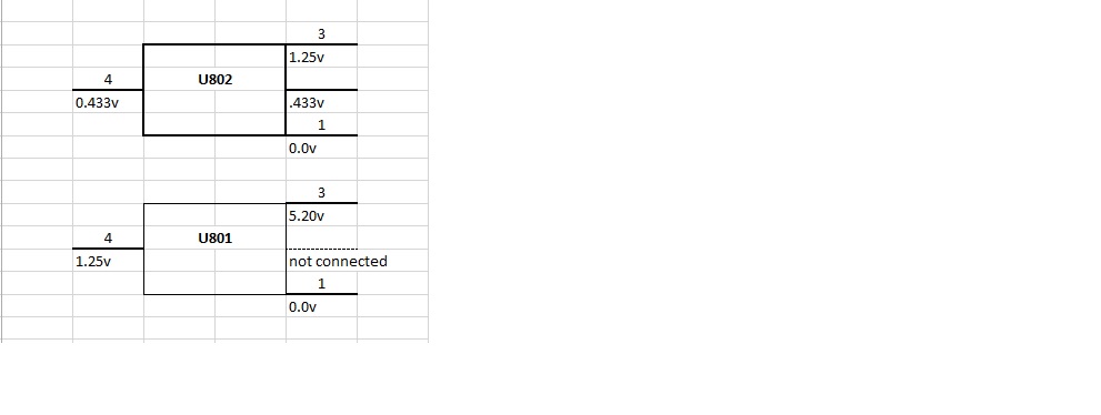

                  U802
                  1 - 0.0v
                  2 - .433v
                  3 - 1.25v
                  4 - .433
                  U801 (no numbers but using same as 802)
                  1 - 0.0v
                  2 - not connected
                  3 - 5.20v
                  4 - 1.25v
                  that's checking voltage at each terminal not across terminals.

                    You can use some alcohol to clean the top of the ic so you can readthe numbers, or try looking at an angle, you may be able to read them, but the voltages don't look good.
                    The microprocessor operates from 3.3 volts, one of those regulators should be a 3.3 volt regulator
                    Without the regulator ic numbers it is hard to tell what the input and ouput voltages should be. I can see numbers on the ic's in your picture, what are the numbers?

                      here's a diagram

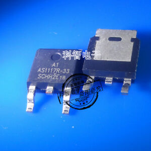

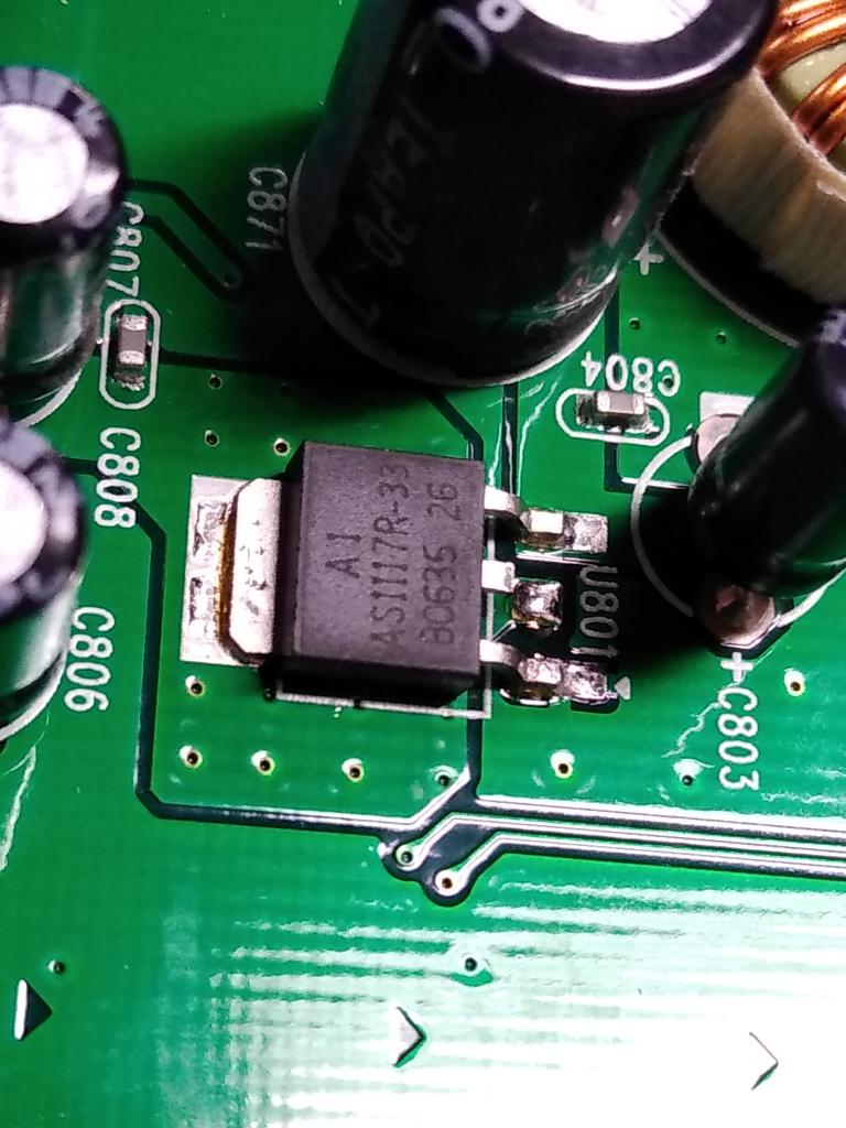

                        U801
                        a1
                        asiii7r-33
                        bo635 26
                        u802
                        ac 6i8l
                        17-18l

                          Those numbers can't be correct, Could it be a AS1117-33 If it is, it will be a 3.3 volt regulator
                          IC801 has +5volts on its input and only 1.25v on its output (it should be 3.3v) so something is loading it down

                            It is AS1117-33 can't tell if they're 1's or I's.

                                It looks like U851 is a 5 volt buck regulator, pin 1 is the input (12v), pin 2 is the output (5v), It feeds U801 3.3 volt regulator, pin 3 is the input (5v) pin 2 is the output which is low.
                                I suspect U802 is a 1.8volt regulator so something could be shorted on its output which is also loading down its input.
                                I suspect the number could be ams1117-18

                                  ah, so there is power to the main filter...
                                  Looks like that U801 is feeding U802 power. So U801 must be bad or getting loaded down.

                                    I included a better pic of U801 for reference.
                                    For U851 here are the actual v readings:
                                    1 - 12.0vdc
                                    2 - 5.2vdc
                                    3 - 0.0vdc
                                    4 - 1.25vdc
                                    5 - 0.0vdc
                                    sorry for the delay, I was away from my computer this weekend.

                                        Re: Dell F177FPE monitor, won't power on
                                        I’d replace that 3.3v regulator and see what happens.
