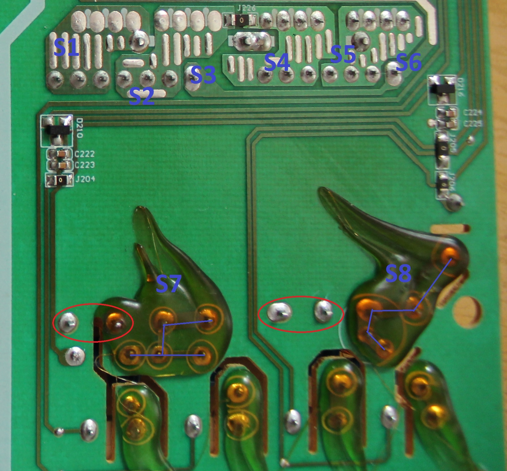

    So I took a picture of it..
    Pins in red are only connected with the transformator. They lead nowhere else.
    S7-S8 725 ohms
    S1-S2 1 ohm
    S4-S5 1 ohm
    S4/S5-S6 546 ohms
    S1/S2-S3 546 ohms
    S7-S3 358 ohms
    S8-S6 366 ohms

      Re: Chimei DAC-19M009 Power Supply problems
      Ok perhaps i see - You still need to look at each transformer as an individual.
      I think the other secondary pin may be the pin at the right hand end of the row of 6 as in your pic - The two are connected so measuring across the two blues will be approx double the value so can you test S1 to pin 6 on one transformer and S3 to pin6 on the other.
        Updated my post with some more accurate information.
          Wheww!!! I think we got there and its good news ( well as far as the transformers are concerned. In your picture the secondaries are S3 to S7 358ohms and S6 to S8 366ohms - They are within 3 % of each other so they are good. I will have to think of something else!! Thanks for helping amraks, hopefully we can get you both fixed.

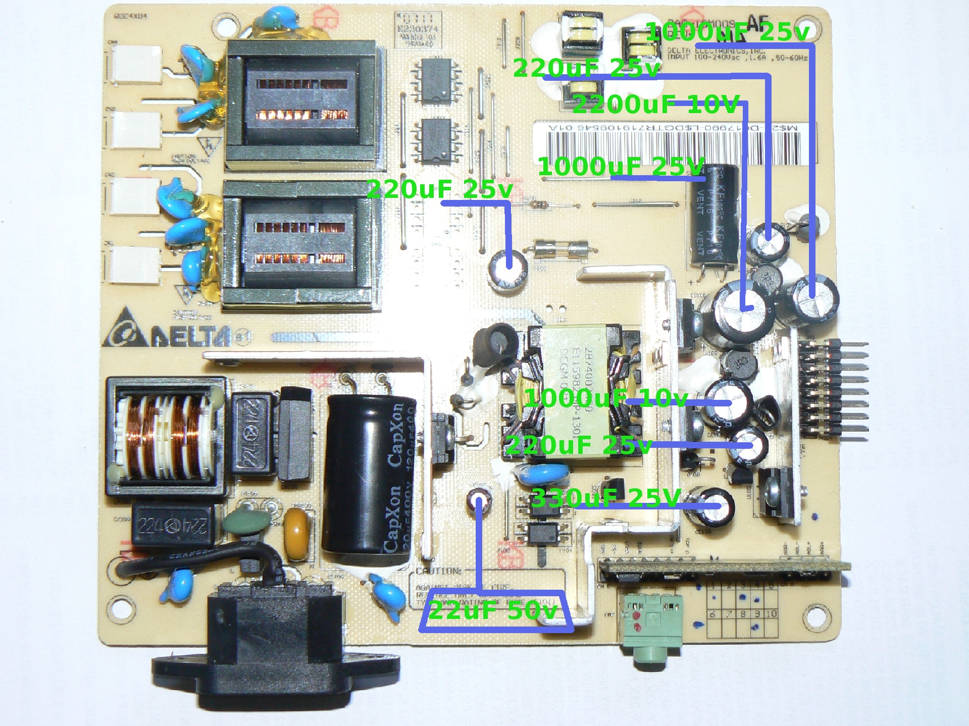

                  hope this helps anyone for later.
                  A guide capacitor map.
                  The_boss wanted to know the values of the capacitors.
                  So I done a diagram.
                  Thanks to all that helped me yet again.
