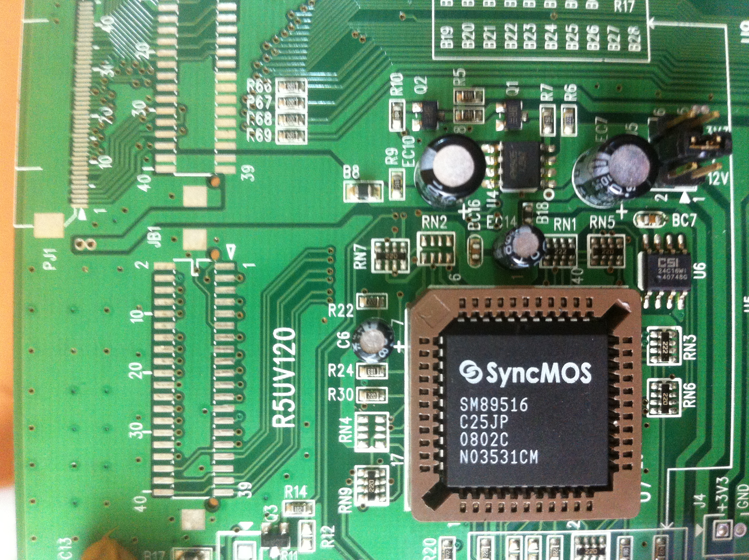

                            Re: Open frame lcd monitors 19" - in gaming machine Novomatic
                            I am Michael, I have a couple of novomatic 19'' touchscreen boards : R5UV120
                            Can anyone fix them fo
                              I mean repair them for me.
                                • 30953
                                post a foto, i'v only seem 3m and Elo boards.

                                • miradzy
                                  • May 2014
                                  • 3
                                  • Ghana
                                    • 30953
                                    is that a touchscreen controller?
                                    i cant see any analog parts?
