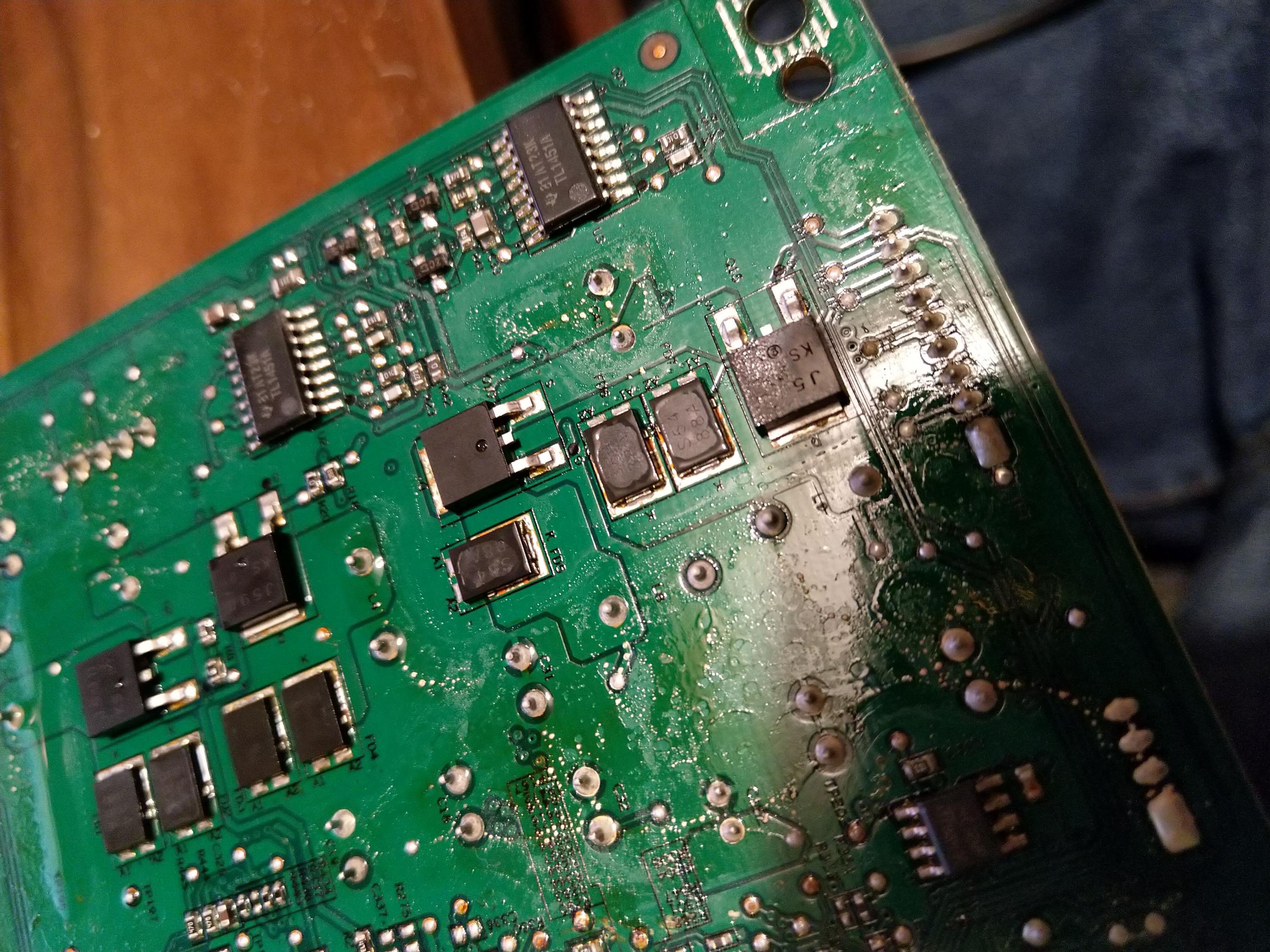

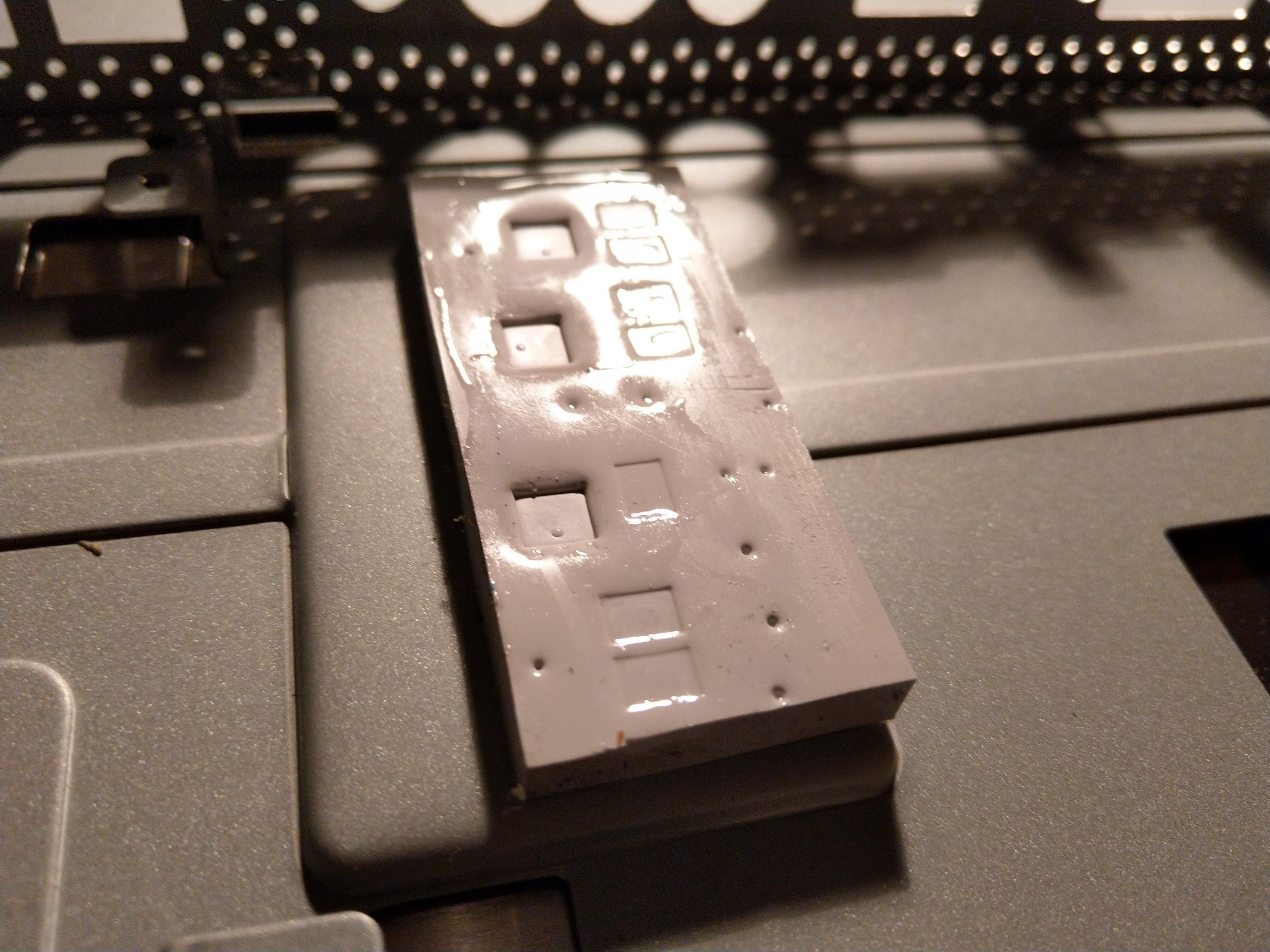

      I removed the main board and I found a strange oily liquid on what I assume is a thermal pad on the bottom. It does not seem to conduct electricity. I am not sure if it is a problem, but it doesn't seem good. Pictures attached.

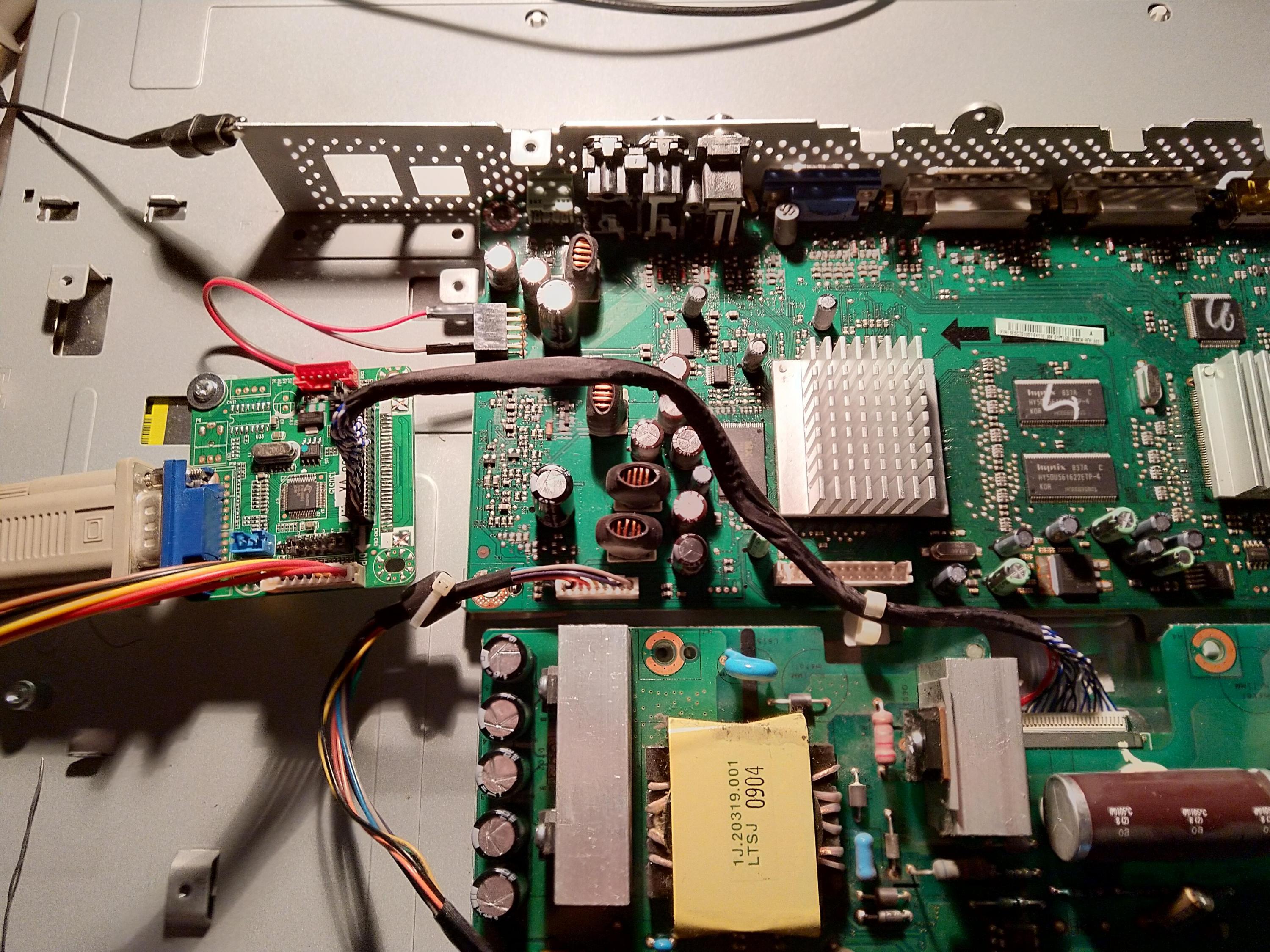

      I bought one of those universal LVDS drivers for £5 from ebay and with some fiddling I was able to get it to work, so it seems the t-con is not faulty.
