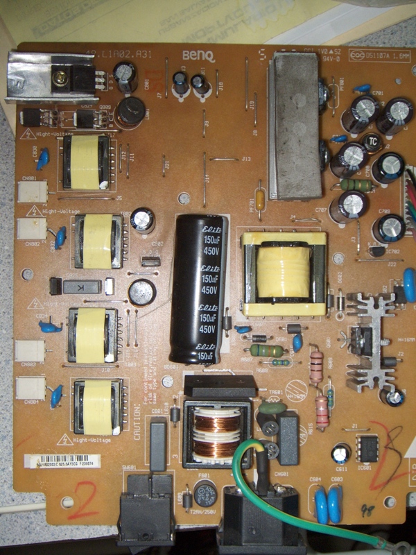

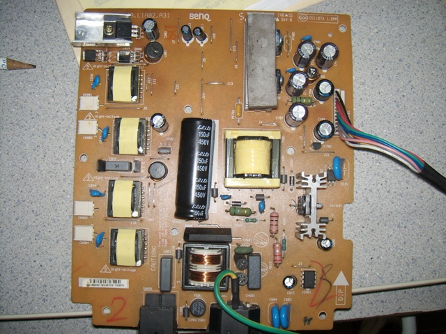

I have a HP 1955L monitor, The Benq 48.L1A02.A31 board ruined, ¿how can I get a new one? where to buy it? Where do I look for it? or Is it needed to repair?

i recently had issues with this board too, but im no expert.
i couldn't just find a straight up replacement
when u say its ruined whats it doing? or failing to do?
do u have indicator lights? -

Re: Bad Benq 48.L1A02.A31 board for Hp1955L monitor
first of all my appreciation for such a good forum which I found just by chance... :-))
I am trying to fix a HP 1955 Monitor. Symptom was a short flashing up of the CCFLs at power up and a strong smell.
One SI4431 was badly overheated (the one more close to the center of the PCB), in fact it burned a hole in the the black foil under the PCB.
One 2SC5707 was shortened.
I replaced the SI4431 and both 2SC5707 in this section.
Now, the inverter works and lights all 4 CCFLs. But there is a sizzling noise coming from the area where the 2SC5707 have been replaced. I changed the 27p/3kV caps, the .22uF/160V cap. I resoldered the whole area but no change.
I started measuring with the scope and I can see a proper PWM on pin 9 of the TL1451 (which is the healthy second path). Pin 7 is somehow havily modulated/disturbed. Measuring on Pin 7 changes the frequency/charcteristic of the noise.
Anyone any idea of what it could be ?
Is there a proper schematic of the 48.L1A02.A31 board available ?
I know, it's close to the various other Benq boards, but matching component numbers would make it much easier.
No, this is not a 'small sizzling noise'. It sounds like an electric discharge (which it isn't..). It changes basic frequency with brightness settings of the monitor.
And the sound is only an indicator for the faulty PWM regulation. The other channel with the proper PWM is almost completely quiet.
Possibly, the reason for this irregular feedback/regulation of the TL1451 was the reason for the damaged SI4431 and 5707s too. I do not know whether the noise was there before the inverter died....
I just wanted to inform you about my solution. The inverter died again and I could not find a reason for the new problem. It might be a pre-damage of the TL1451 from the first fault.
Totally pissed off, I de-soldered all the rubish from the inverter-side of the PCB and glued two small inverters (each 2 ccfl up to 400mm, price 5 USD...) on the free space.
Now it's as good as it was before. The automatic shutdown of the lamps has gone, but this is irrelevant for me anyway.
Congratulations to Benq - they managed to make it as complicated as possible while making severe design faults and giving it the least possible production quality. What a shame that HP uses such poor suppliers.
Hi everybody!
I have the same problem, I checked the transistors and i found that the Q815, Q816 are died and also the Q812 was shorted! I replaced the three parts and I still have the same problem no displaying on screen just a green light of the LED0...!!! I tried to see on the IC : TL1451A at the PWM output I have no signal and I measured on the pin 9 (+Vcc) and I found 0v...!!!??? so please if someone can help me to find out the solution.!
The "standard" procedure for Benq board is to
1) check the c5707s for shorts
2) check the fu9024 for shorts
3) check picofuse to see if it is open
4) resolder all the inverter transformer pins (mandatory)--- begin sig file ---
--- end sig file ---Comment
Thanks a lot to everybody!
Finally I repaired my LCD!
I have changed the two transistors C5705 et the MOSFET J598 and the Picofuse PF701 and I soldred also HT transformers!
