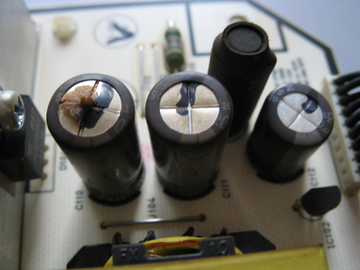

                                          About my 225BW. Manufactured april 2007 in Slowakia. Powerboard rev 2
                                          One day the menu button didn't work anymore. The on/off button didn't work always anymore too.
                                          So I left it on permanently. The monitor did go in stand by and the power button got to blink.
                                          I did get a normal screen when I started up my pc.
                                          The presets/down button worked and I could use the brightness/up button to choose.
                                          Pushing the brightness/up button without te preset menu resulted in this screen:
                                          which then lasted for about 4 seconds before turning to the normal screen.
                                          Detaching the monitor didn't give the no signal warning.
                                          It appeared that only one cap was bulged open:
                                          I did replace all the caps (C 107 - C 110 - C 111 - C 112 - C304 - C305 ) with panasonics rf type exept for C 107 which is another brand 105 c type.
                                          I didn't replace the big one.
                                          The only thing that has changed is that the power button is working again albeit that it takes about 4 seconds until the screen is back.
                                          Disabeling OSD by pushing the menu button for 5 seconds worked and works still.
                                          The laguage in the preset menu and using the auto button has changed to German.
                                          Don't know if that happened after replacing the caps or when the problems first started.
                                          So what can I do further? I do have a multi meter.
                                          Thanks for the help so far.
