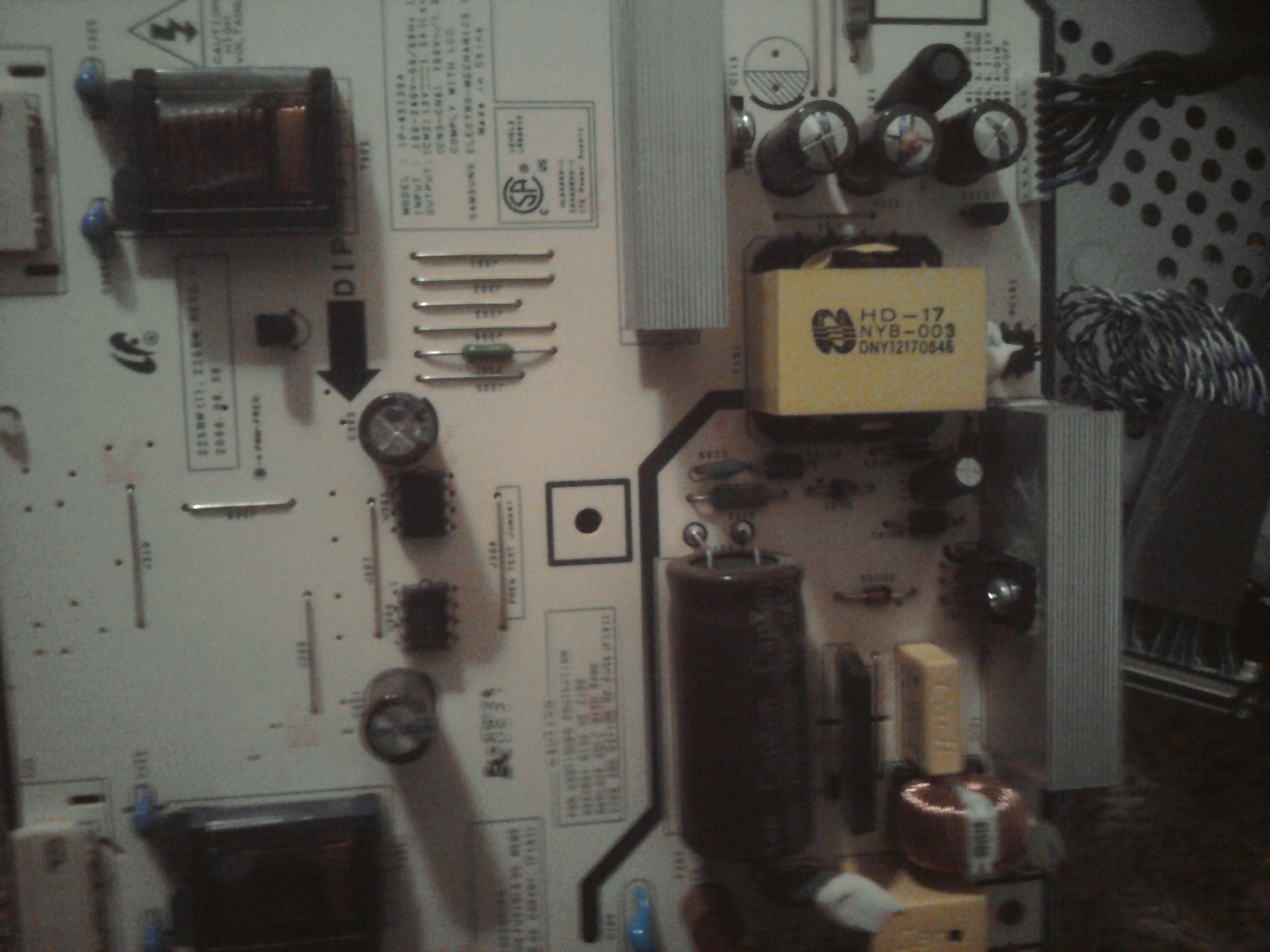

            Hello everyone, this is my first post and I am happy to be a part of the community.
            I have a Samsung SyncMaster 225BW with puffed up capacitors (C304, C305, and C110-12). I went on Digi-Key and ordered new capacitors, three 330uF @25vDC and two 820uF @25vDC. After I soldered in the new caps, I hooked up the monitor and powered it up. Expecting to see my desktop it was only visible for only a few seconds before it shut off...or so I thought. I decided to shine a flashlight at the screen to see if the LCD was displaying, the windows logo was visible. Now my problem is why the backlight is not lighting up. I checked both of the fuses and they are good. Both inverter transformers are okay. C107 looks good, but I remember that someone here said that if that cap failed that all sorts of bad things could happen.
            It looks like it could be the CCFL's controller (MP1038EYS) going into a shutdown mode. I really wish there is a schematic for this board, it would make troubleshooting this a hell of a lot easier...
            Any thoughts on why the backlights are not staying on after soldering on good capacitors will be helpful.

              You are experiencing 2 seconds to black. Possible causes are, in no particular order,
              a) bad secondary inverter transformer winding
              b) bad ccfl
              c) bad ccfl wiring (especially the top return wire)
              d) bad caps
              All explained in detail starting with posts #19 and #20 at
              https://www.badcaps.net/forum/showthread.php?t=10419

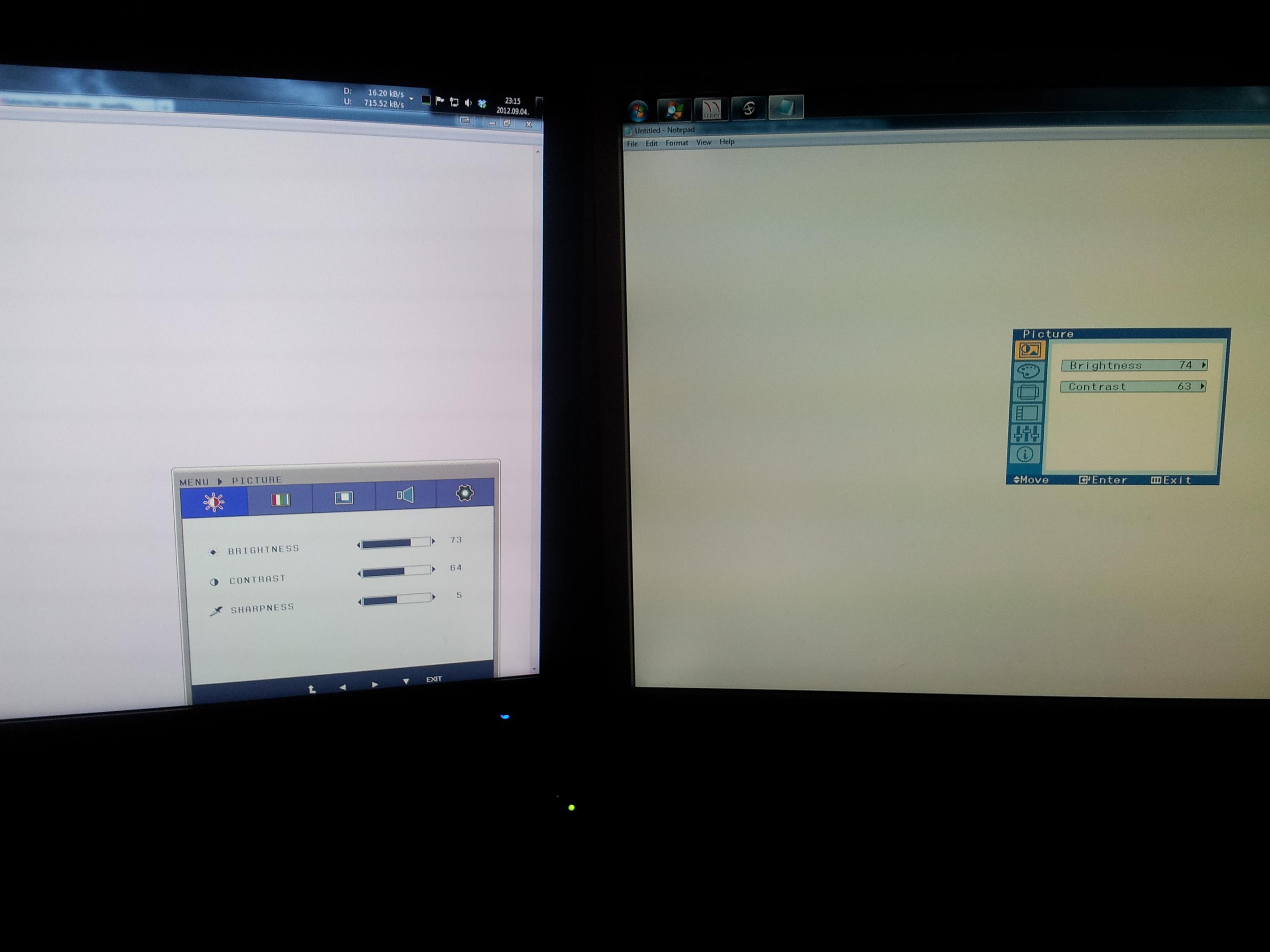

                              Hi!
                              Recently i bought a new monitor for dual-monitor setup. I just realised that my old 225BW has a yellowish tint. I bought it 5 years ago, crewing through the thread someone showed how can i access the service menu, and i realised my monitor is runing like 2 years know. Other then the yellowish tint (white is not white) it's giving an annoying high pich noise. I used the monitor on 30% brightness in the past, and to fix the noise i needed to increase the brightness to eliminate the noise. The thing is, i'm around 60% brightness now, and i'm a bit worried now. I mean, this issue it not gonna solve itself by just increasing the brightness.
                              So, my question is, replacing my caps can fix the yellowish tint issue? or that one is related to the backlight?
                              My new LG (crap IPS) monitor is on the left, 225BW is on the right.
                                This could be a bloated cap making the high pitch noise. You will have to take it apart and see.
