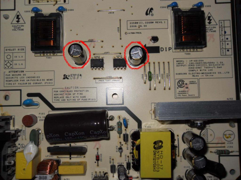

      Re: Samsung Syncmaster 225BW
      Turning up the brightness does not help, its dark enough that photos do not turn out, but yes I can make out the menus and light colored webpages, ect.
      It does not flash white then turn dark. Yes the cable between the inverter and the video driver board is plugged in.
      330 - P12386-ND
      680 - P12390-ND
      820 - P12391-ND
      I am sure that the caps are in the correct way around.
      Perhaps you are correct that the CCFL's need to be replaced, but there have been lots of posts where that wasn't the case, so I was just looking for some advice.

              Are the backlights on? If not, check F301. A good fuse should measure less than 1.0 ohms.
                Also check the mosfets U302 and U303. A procedure for testing is at (under section mosfet)

                  F301 is good 0.1 ohms.
                  Using the datasheet found here:
                  I got:
                  U302
                  a) black on pin S1- red on pin G1 - record ohms => 3.68M ohm
                  b) black on pin S1- red on pin D1 - record ohms => .3M ohm
                  c) black on pin G1- red on pin D1 - record ohms => 3.88M ohm
                  a) black on pin S2- red on pin G2 - record ohms => 4.1M ohm
                  b) black on pin S2- red on pin D2 - record ohms => .3M ohm
                  c) black on pin G2- red on pin D2 - record ohms => 2.95M ohm
                  U301
                  a) black on pin S1- red on pin G1 - record ohms => 3.65M ohm
                  c) black on pin G1- red on pin D1 - record ohms => 3.87M ohm
                  a) black on pin S2- red on pin G2 - record ohms => 4.05M ohm
                  c) black on pin G2- red on pin D2 - record ohms => 2.98M ohm
                    1) Please answer if the backlights come on or not?
                    2) U301 is some sort of transistor. Check it for a short.
                    3) The readings for the mosfets suggest they are good.

                      4) T301 and T302 are your inverter transformers. It looks like the pins that connect to the blue caps (C303/C304 and C305/306) are the secondary winding pins.
                      Measure the resistance between the secondary pins on T301. Report reading. Do the same for T302.
                      They should be within 3% of each other.
                        No I do not believe the backlights are coming on and that is why i can barley make out my desktop.
                        I have not found any shorts on u301.

                            With power on and lcd plugged in ...
                            1) What is the DC voltage on either side of F301? You should have 2 measurements.
                            2) What is the DC voltage across the two Panasonic caps flanking U302 and U303? You should have 2 measurements.
                            --- begin sig file ---
                                  F301 13.1VDC - 13.1VDC => fuse good
                                  C305 and C306 0VDC measurement made on either side of caps to GND
                                  C303 and C304 0VDC measurement made on either side of caps to GND
                                    NO, not the blue caps. Stay away from those caps, they are high voltage.
                                    The Panasonic electrolytic caps (circled in red). Measure the DC voltage across the legs of the caps. Black probe to negative and red probe to positive.
                                      those both measure 13.16VDC
                                        voltage levels don't bother me I deal with 4160V AC on a daily basis.
                                        On this forum, I have no clue about people's background or experience so I always side with caution. We had some people doing scary things with their multimeter. Black probe in Amps jack, measuring the high voltage side with meter set on resistance, measuring resistance with power on, etc.
                                        The last thing to check is on the back of the pcb. There is a 20 pin IC. What is the part number?
                                        This is the inverter pwm chip. It controls whether the backlights come or not.
                                        If the pwm checks out, then I think you can rule out the inverter part of the board as being bad and check the ccfls. With the ccfls, you are looking for stuff like these pictures.
                                        http://s807.photobucket.com/albums/y...klight%20lamp/
                                        PS. What type of multimeter?
                                          that stamping is real hard to read...from what I can make out it is 64GN T005322p.
                                          Meter is just a fluke 87.
