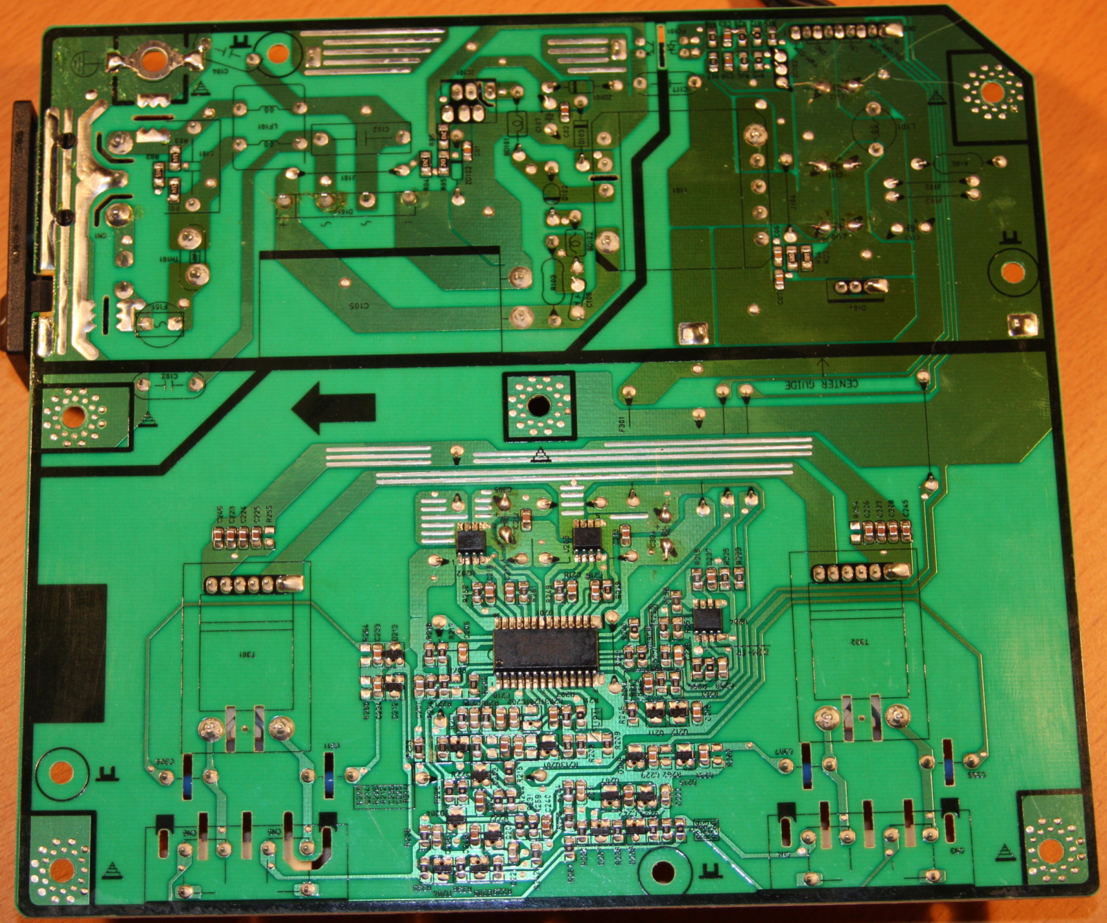

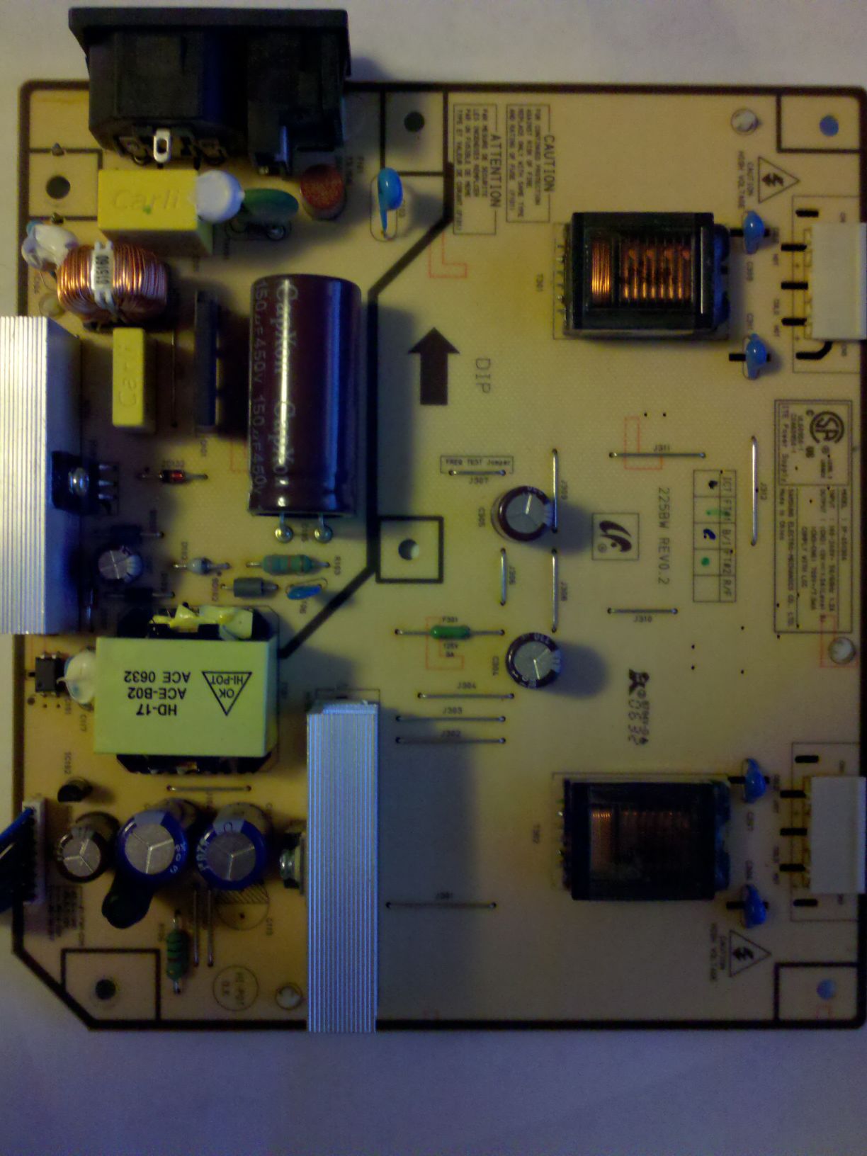

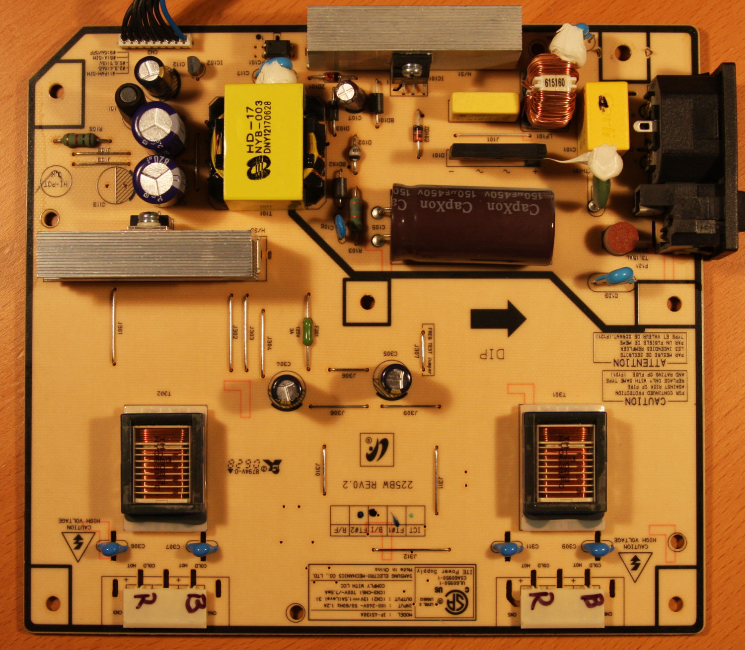

        Here's the photos. I tried the flashlight trick and can see the screen. So other than bad new caps I'd guess CCFL from what I read. There is no buzzing or humming that i can discern.

          With power off and lcd unplugged, measure the resistance of secondary inverter transformer pins (T301 and T302). They are the pins "going into" the blue caps.
          Report both ohms measurement.

            1.098k and 1.097k if I understand your meaning. That's across the "top" two pins of T301 followed by T302. I am also assuming you mean the blue little caps, not the big ones by the transformer that I replaced, correct? 306, 307, 309, 311 are their numbers.

                Those measurements suggest the inverter transformer is okay since they are with 3% of each other.
                That leaves the ccfl and/or its wiring to check next. See

                  Yeah, ccfl's look burned out, very black and corroded on one end. Any idea where I can get them cheap? May be better to just get a new monitor at this point.

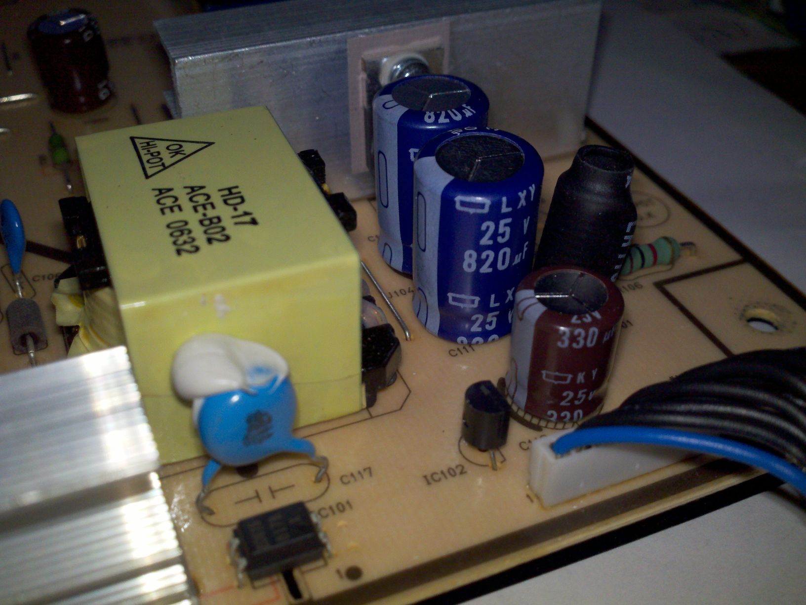

                              Hi, my monitor Samsung 225BW has been having problems turning on after sleep mode. Sometimes screen would be red tinted, sometimes would not turn on until after some button pushing or main power turning on and off couple times. Lately it would not turn on at all.
                              I've found out about the capacitors problem and replaced 2 of the following: CAP 820UF 25V ELECT LXY RAD, and 3 of this: CAP 330UF 25V ELECT FC RADIAL.
                              I did not touch the 47UF or the big 450V yet as they look really good.
                              It still does not work. Now when I turn it on the screen is black, power button blinks once and stays on blue even when I'm pushing it.

                                I would inspect all the soldering you did on the capacitors you replaced, for any looseness.
                                Samsung gives me the most trouble, removing the old solder is difficult.

                                    1) You probably don't need to replace the existing caps except for the 47uf cap, since it's required for starting the power supply. Also, check for bad solder joints like alexanna suggested.
                                    2) The red tint you indicated might be a CCFL tube starting to fail.
                                    3) With the monitor connected to a computer, hold a flashlight against the dark screen. Can you see a faint image?

                                        You did select the correct 47uf cap. However, since you are getting a power light, it would indicate that the power supply is starting up. You need to verify the output voltages of the supply before going any further. Also, please post some good focused photos of the top and bottom of the power board using the "manage attachments" button. Before buying the cap, you'll have to verify other components are good. Therefore, hold off on the purchase.

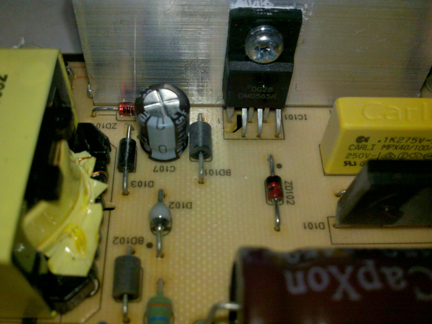

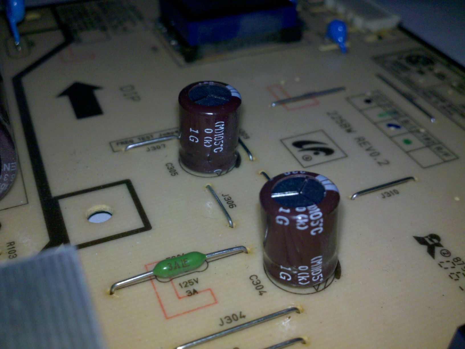

                                          You've said "You need to verify the output voltages of the supply before going any further". I need some hardware for that I'm sure. I hate radioshack, hopefully I can get that elsewhere...
                                          Here are the requested pics:
                                          What do you think? Are any other components toasted?
