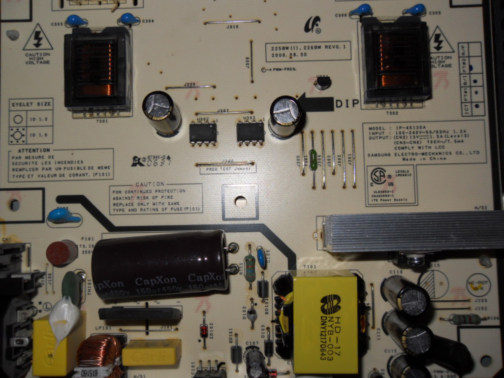

              Are the backlights on? If not, check F301. A good fuse should measure less than 1.0 ohms.

                Also check the mosfets U302 and U303. A procedure for testing is at (under section mosfet)

                            1) What is the DC voltage on either side of F301? You should have 2 measurements.
                            2) What is the DC voltage across the two Panasonic caps flanking U302 and U303? You should have 2 measurements.

                                    NO, not the blue caps. Stay away from those caps, they are high voltage.
                                    The Panasonic electrolytic caps (circled in red). Measure the DC voltage across the legs of the caps. Black probe to negative and red probe to positive.

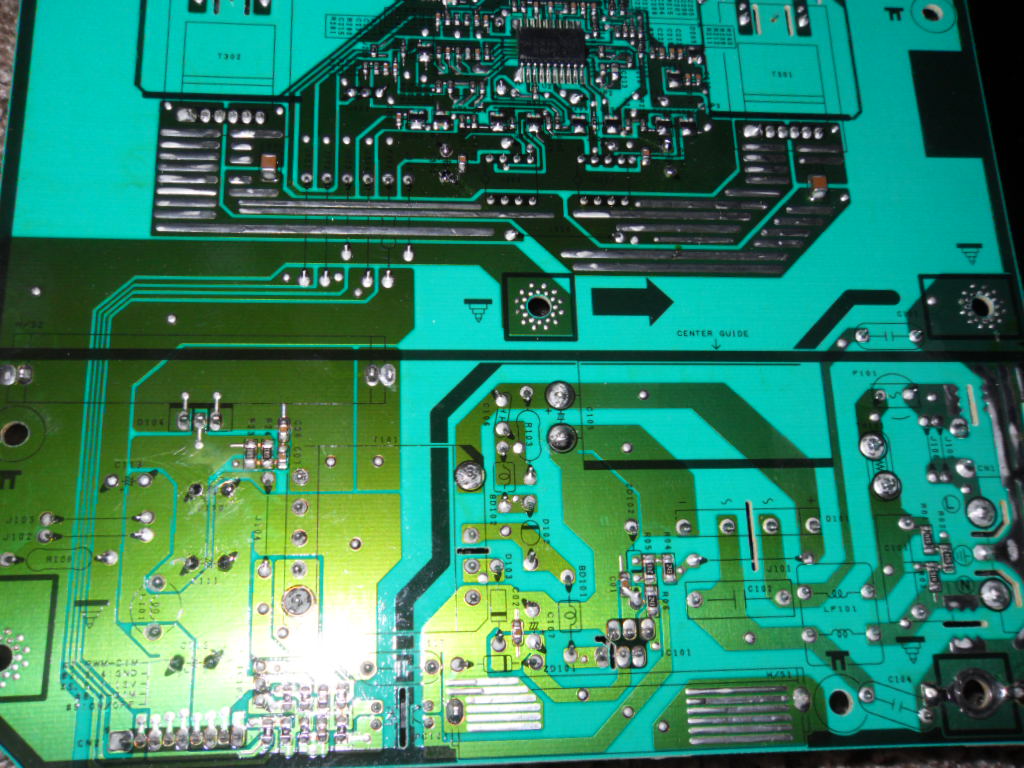

                                        The last thing to check is on the back of the pcb. There is a 20 pin IC. What is the part number?
                                        This is the inverter pwm chip. It controls whether the backlights come or not.
                                        If the pwm checks out, then I think you can rule out the inverter part of the board as being bad and check the ccfls. With the ccfls, you are looking for stuff like these pictures.
                                        http://s807.photobucket.com/albums/y...klight%20lamp/
                                        PS. What type of multimeter?

                                          #520
                                          Re: Samsung Syncmaster 225BW
                                          that stamping is real hard to read...from what I can make out it is 64GN T005322p.
                                          Meter is just a fluke 87.
