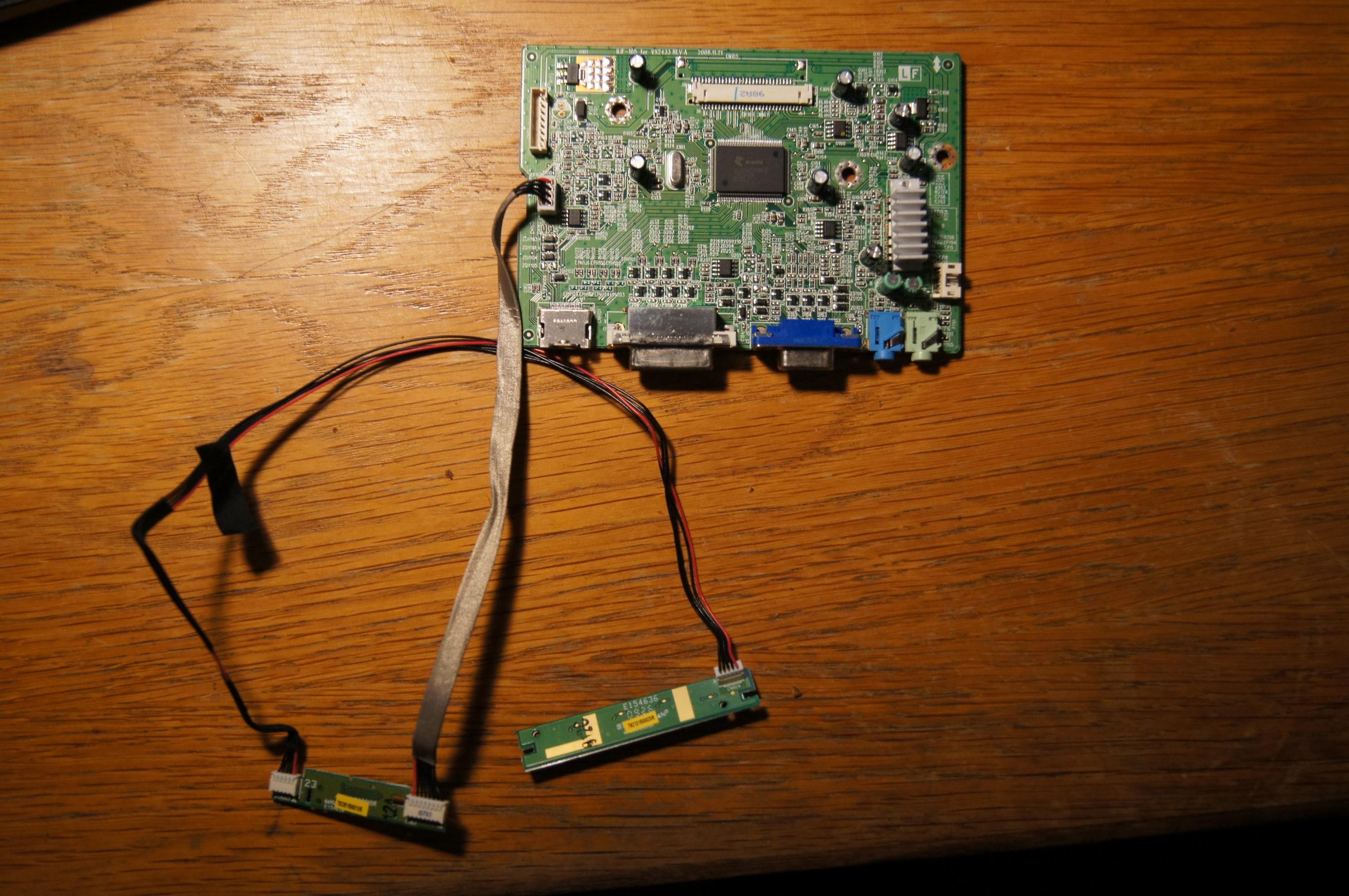

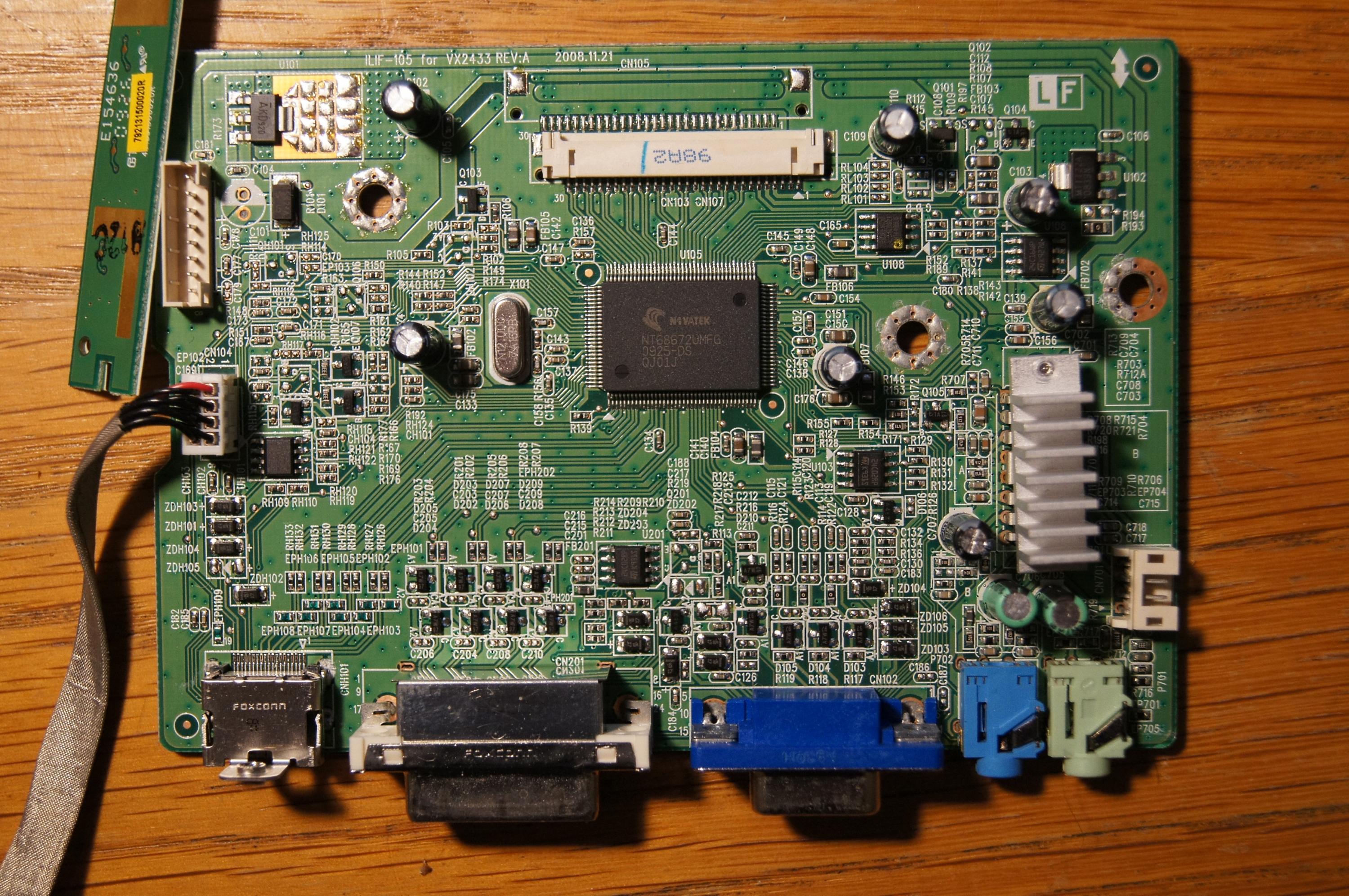

    I have a Viewsonic VX2433WM here with the two seconds to black issue.
    It initially had an issue where the 5V rail turned off if the LED/button PCBs were plugged into the controller board. But after cleaning some corrosion between pins of a connector it now turns on, but shuts off two seconds later (Picture looks good when it's on).

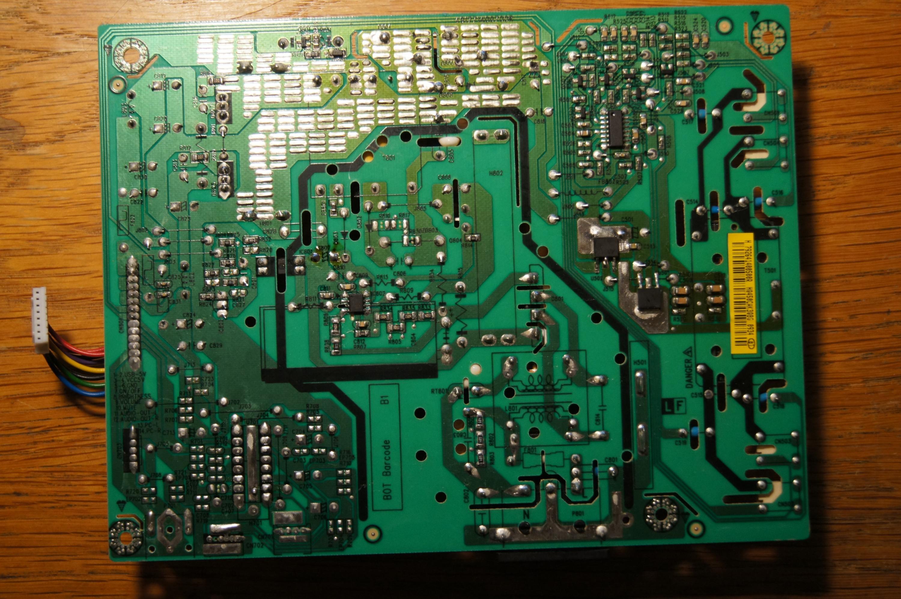

    When I measure the secondary windings of the HV transformer I get 760ohm on one and 805ohm on the other, difference of ~5.6%. This is with the transformer still in circuit, I removed the capacitor across the winding and there was no change. Next I'll try removing the transformer to test.
    Do you guys think the transformer likely has a shorted winding? Anywhere I can buy another one (SPW-139 LSE t10BH)?
    Re: Viewsonic VX2433WM - Two Seconds to Black
    Remove the transformer and look at the bottom side of the transformer to see it i\has any bad sign.
      Thanks budm, I removed the transformer, secondary windings still have the same resistance (760ohm & 805ohm), both primary windings are 0ohm.
      I couldn't see anything wrong with the bottom of the transformer, no burn marks etc.
      I did notice the two ceramic capacitors closest to the transformer were a ddarker shade of blue than the rest, I suspect the transformer runs hot, but maybe that's normal.
      edit: Ops, the darker blue ceramic capacitors are actually a different part number to the light blue ones. That probably explains the difference in colour.

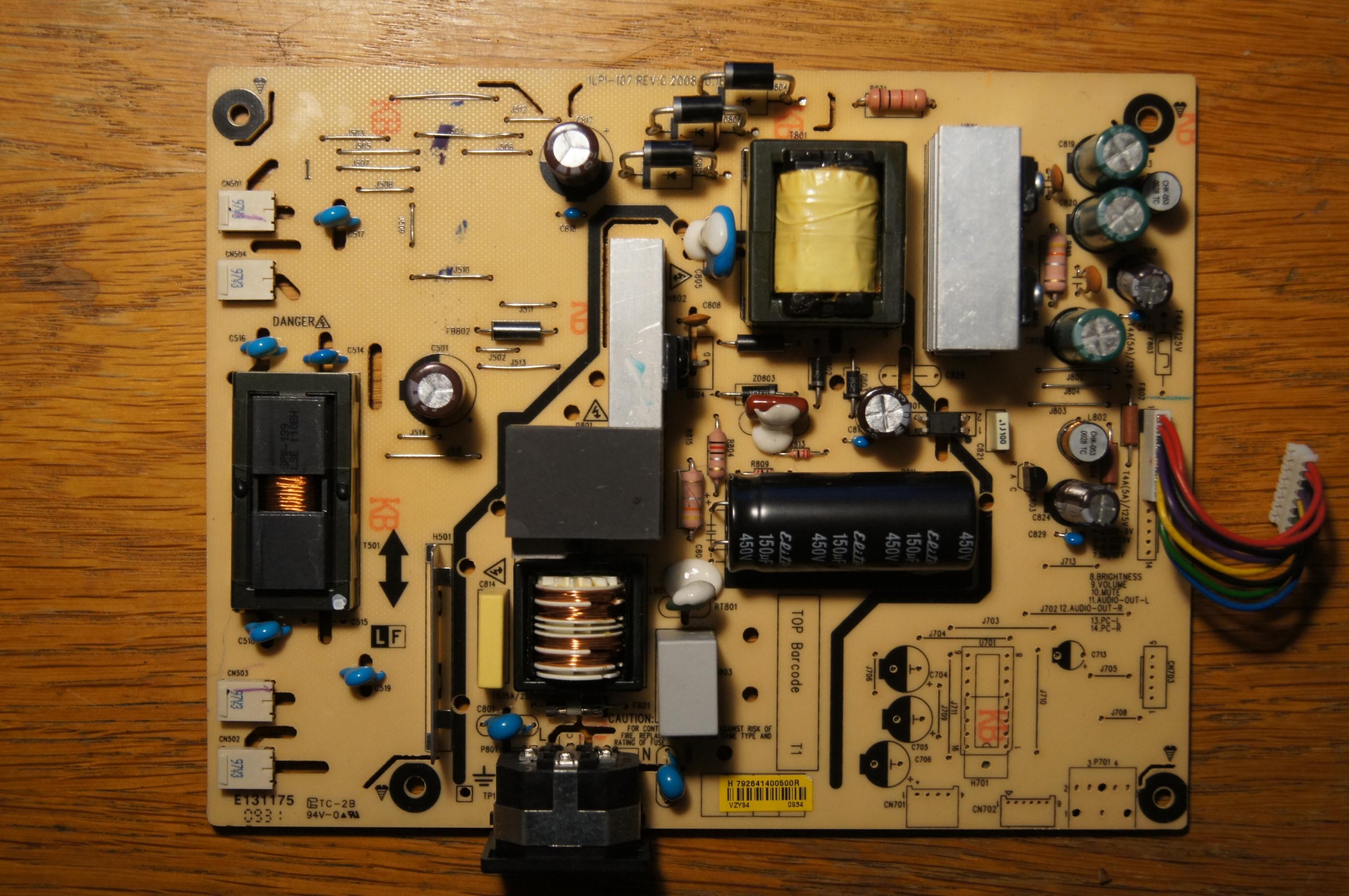

            If you suspect a lamp issue you can plug in only one at a time and see if it lights for a couple seconds. its a way to confirm the transformer also, if one output is not lighting a lamp, plug the lamp into another output, if it lights there, then the previous output and likely the transformer is bad

                Thanks guys that was good advice.
                The two connectors on one of the secondary windings will light any of the four bulbs. But on the other winding, one connector will light a bulb to 25% brightness while the other connector will not light any of the bulbs.
                To test if it was the transformer, I unsoldered it, rotated it 180 degrees and resoldered, the problem then moved to the other two connectors! So transformer related after all...
                  I'm guessing it's not possible to repair these, but is there a replacment part for this transformer? Is there a generic design that would work? (PN is SPW-139 LSE t10BH)

                    The schematic shows the inverter transformer (T501) as EEL-22 but the power supply looks slightly different. Are there any numbers on the yellow band around the transformer?
                      Well spotted, I have the service manual, but I hadn't thought to check it. I checked the transformer and I couldn't find any more numbers on it, yellow band is blank.
                      Which part of the schmatic looked different to you? As far as I can tell it matches my board (apart from transformer part number).
                        I think I might just try replacing it with EEL-22 and see what happens. The overvoltage/current protection circuits should still work, so it should be safe right?
                          I think the eel-22 transformer should work, after a closer look the schematic does seem to match your board, I may have looked at a different schematic and got them mixed up.

                                Update:
                                Replacing the transformer worked, I'm using the monitor atm, works great.
                                The trasformer I used was EEL-22, was $4AU on ebay inc. postage for two transformers.
