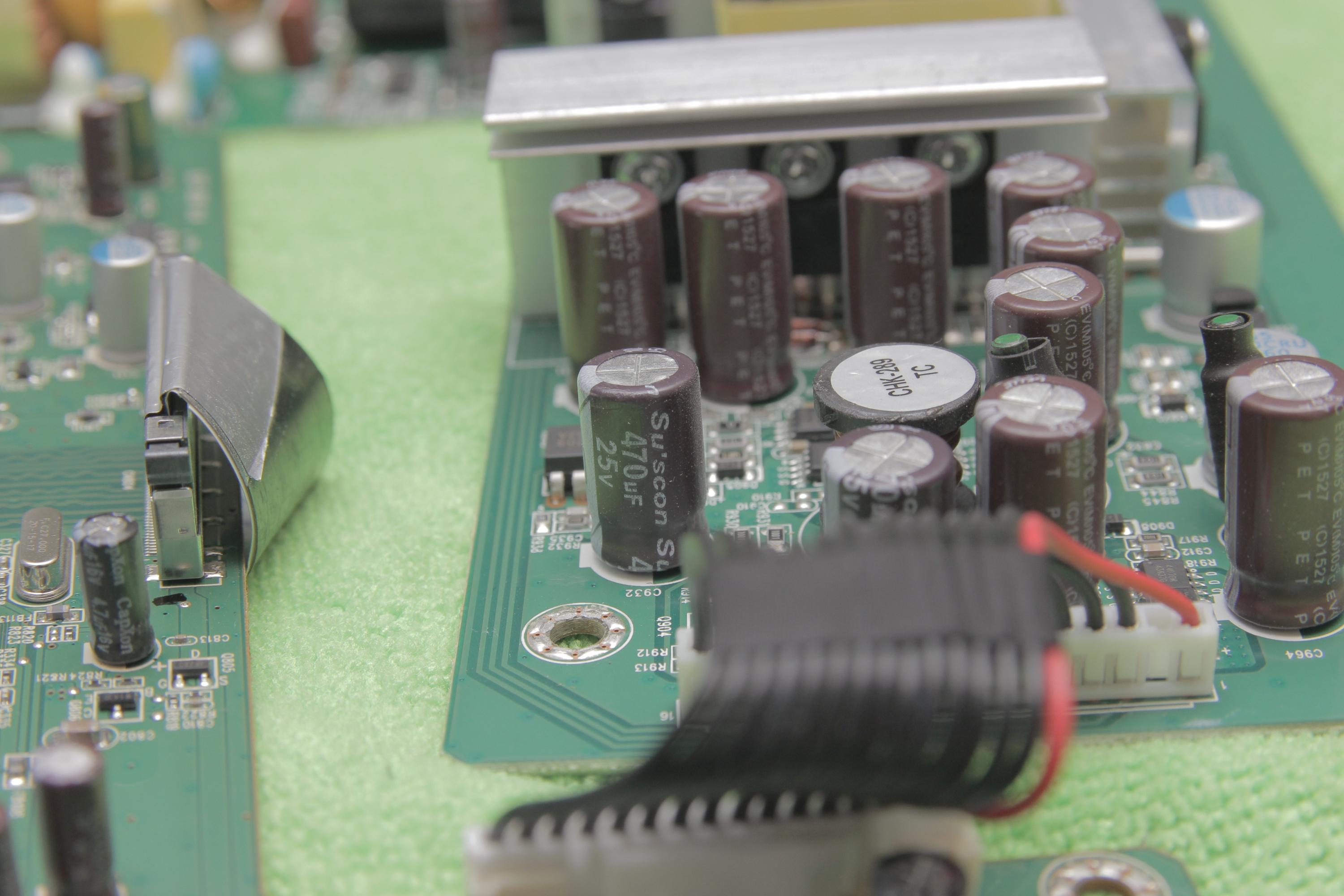

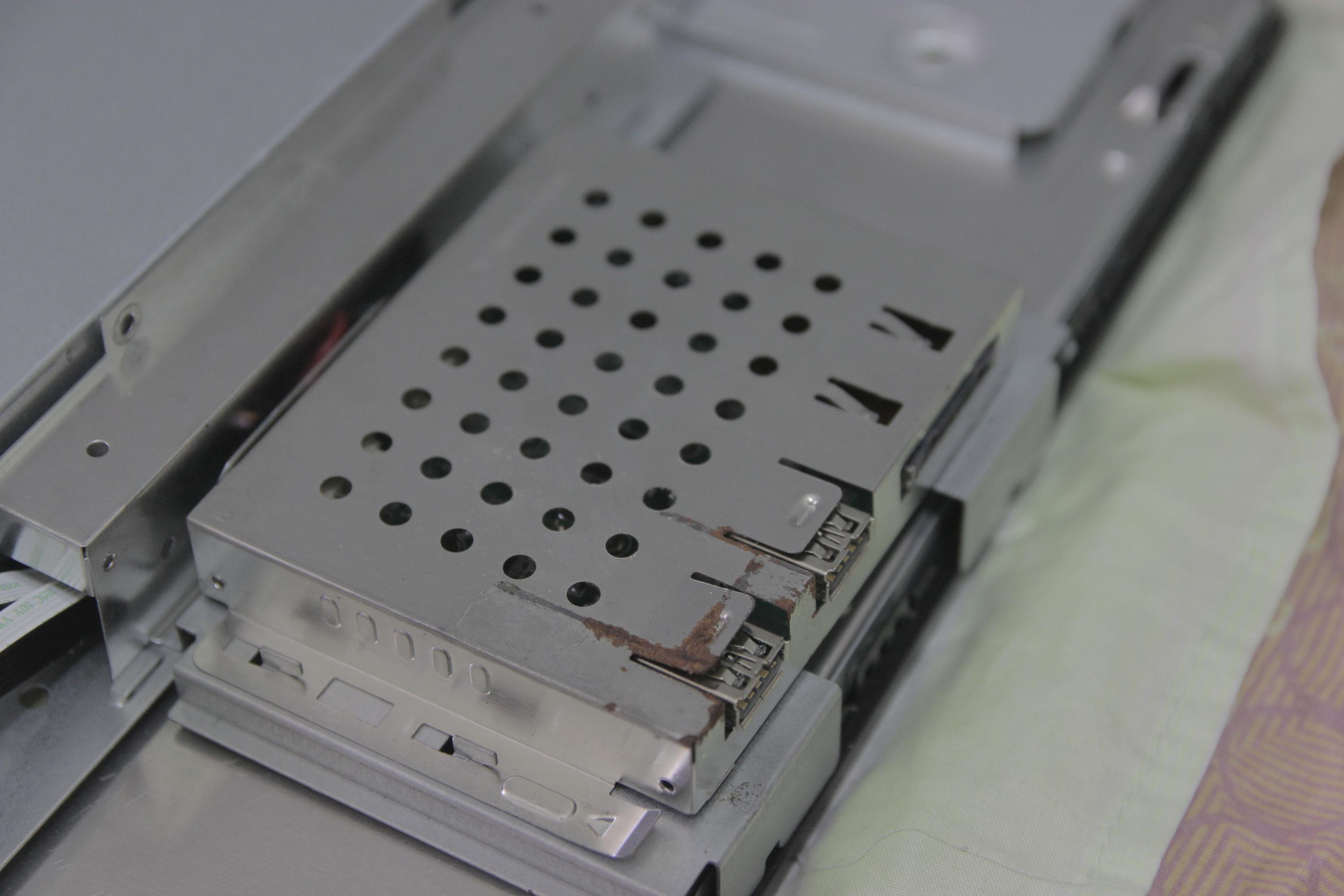

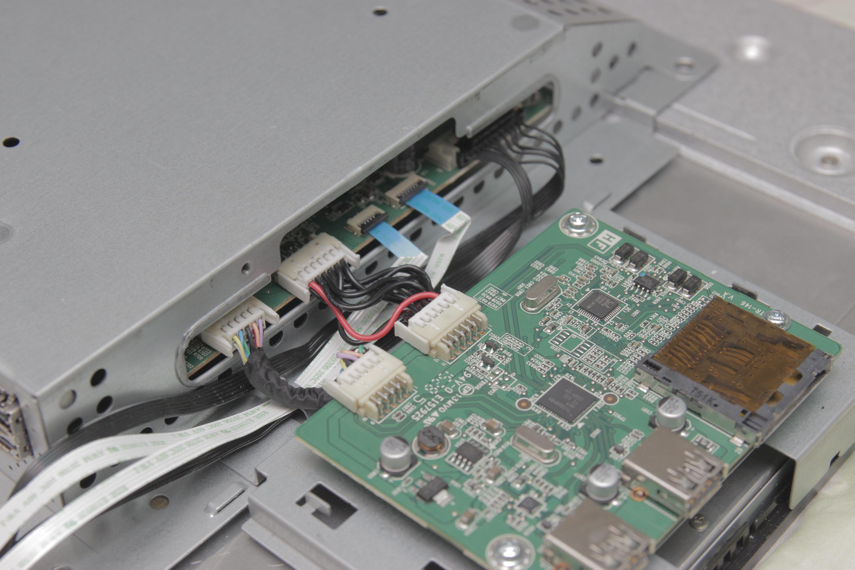

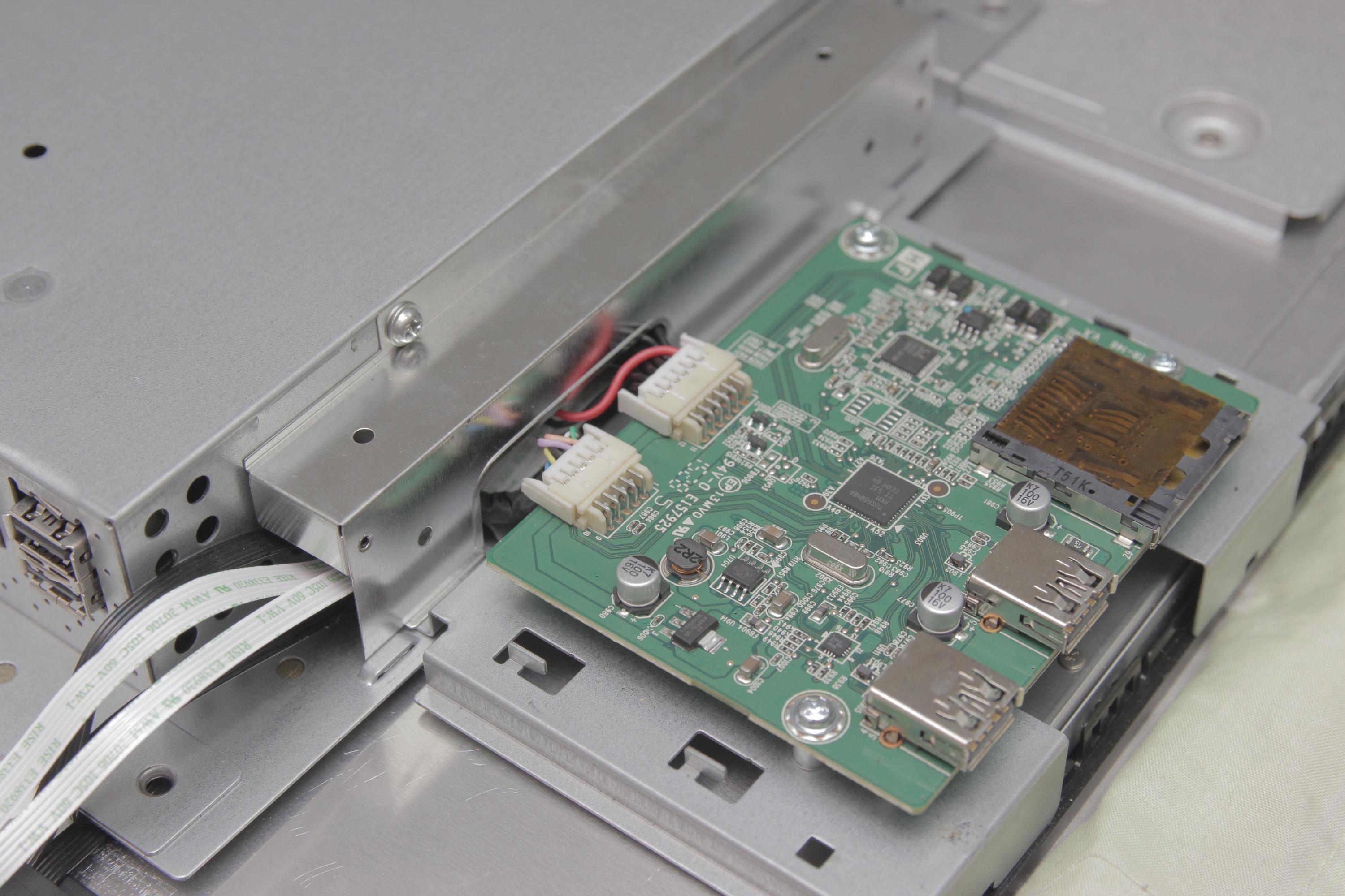

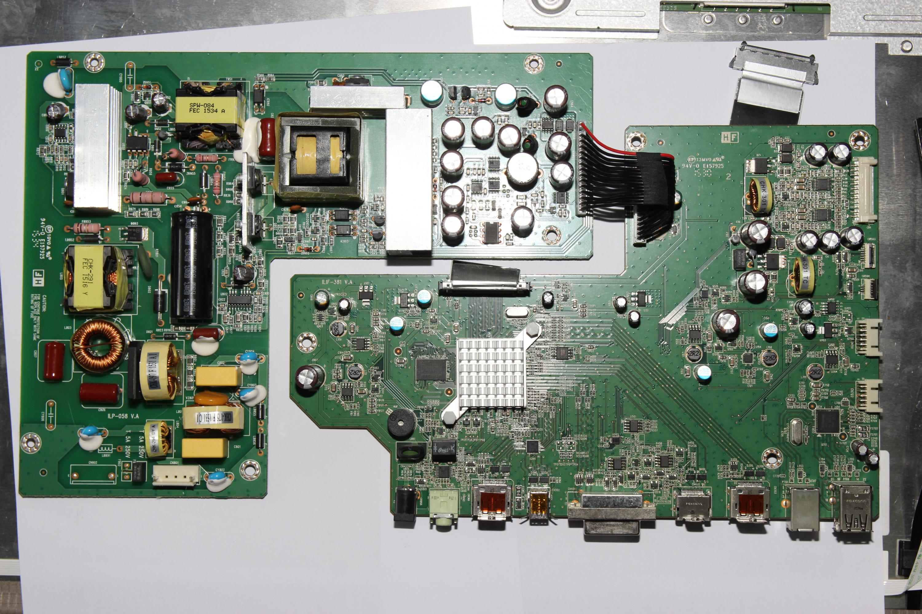

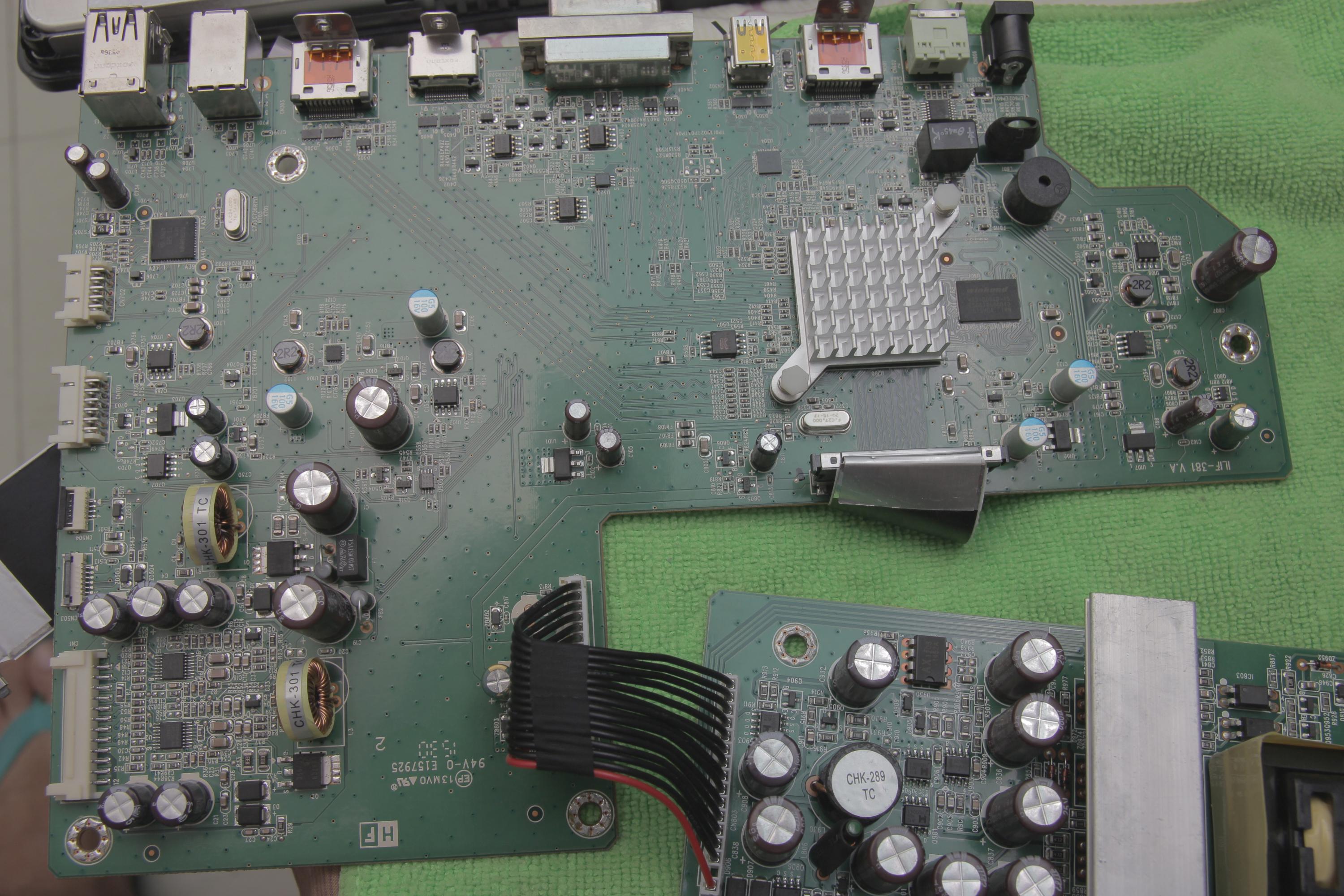

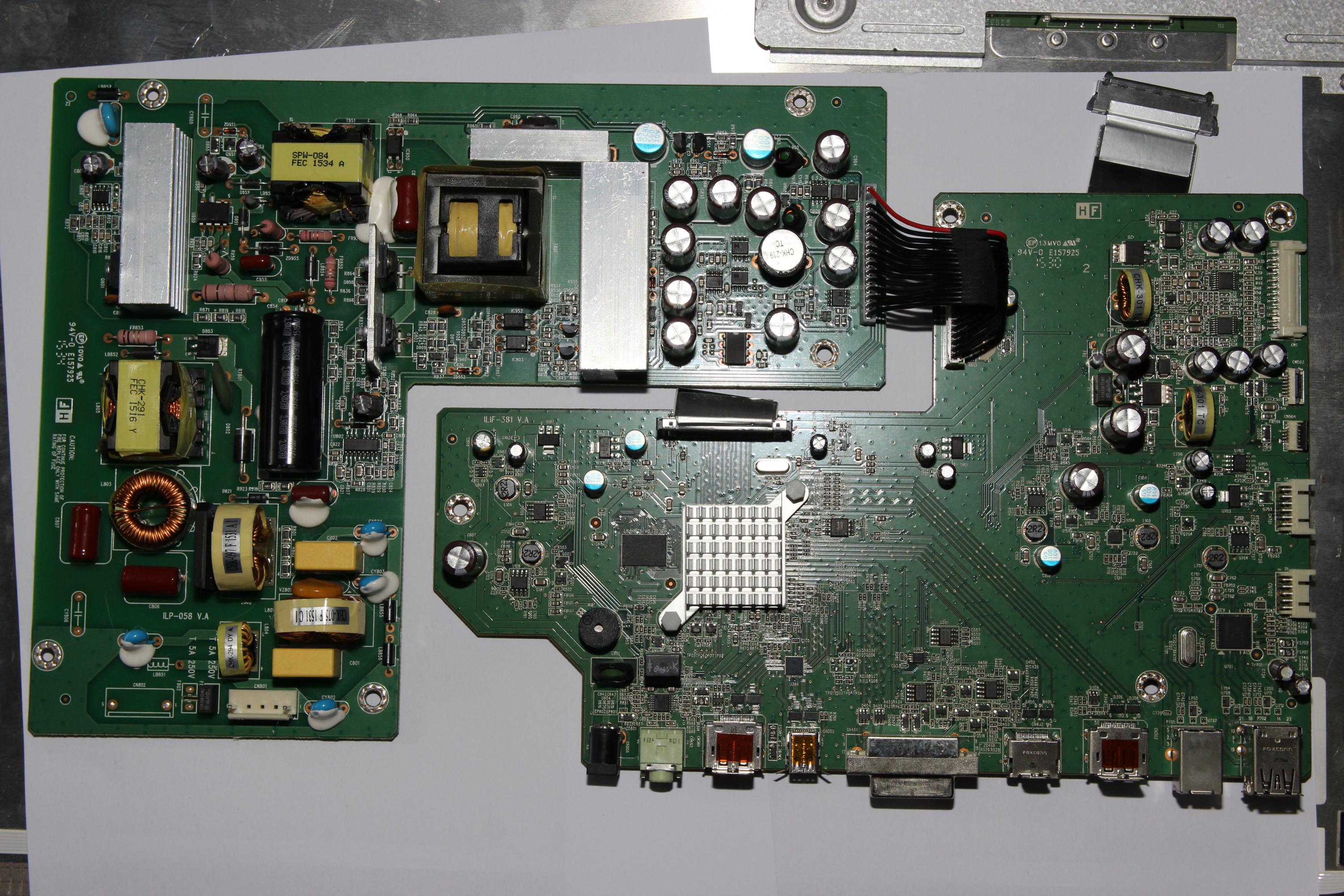

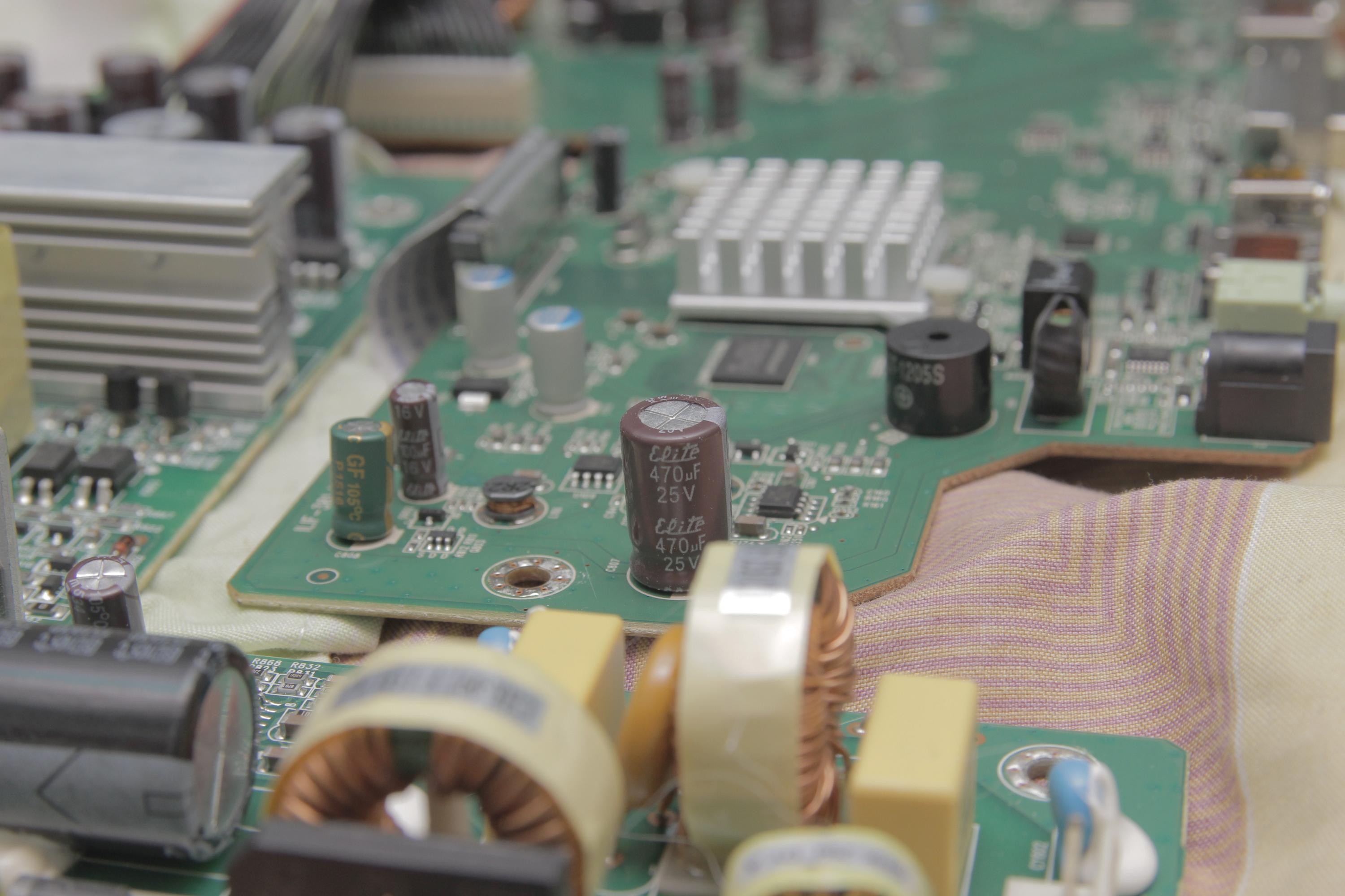

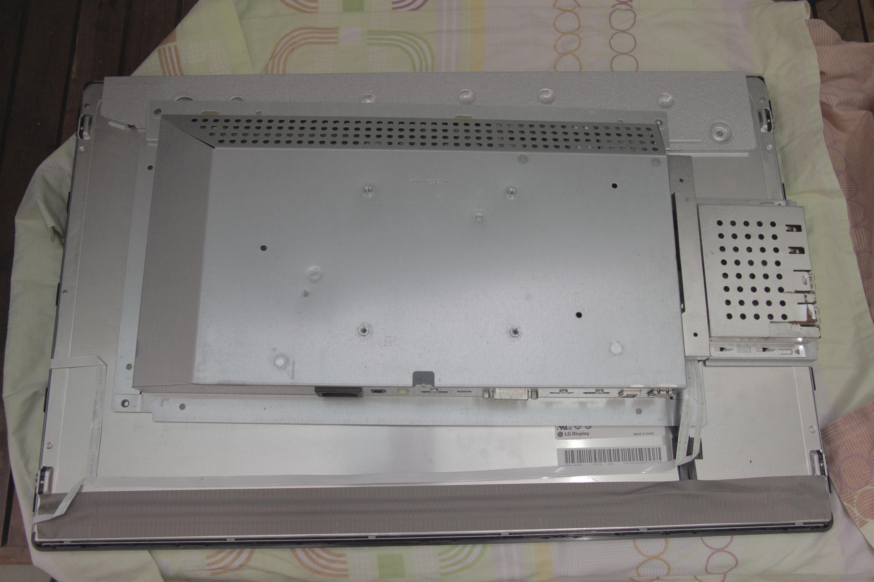

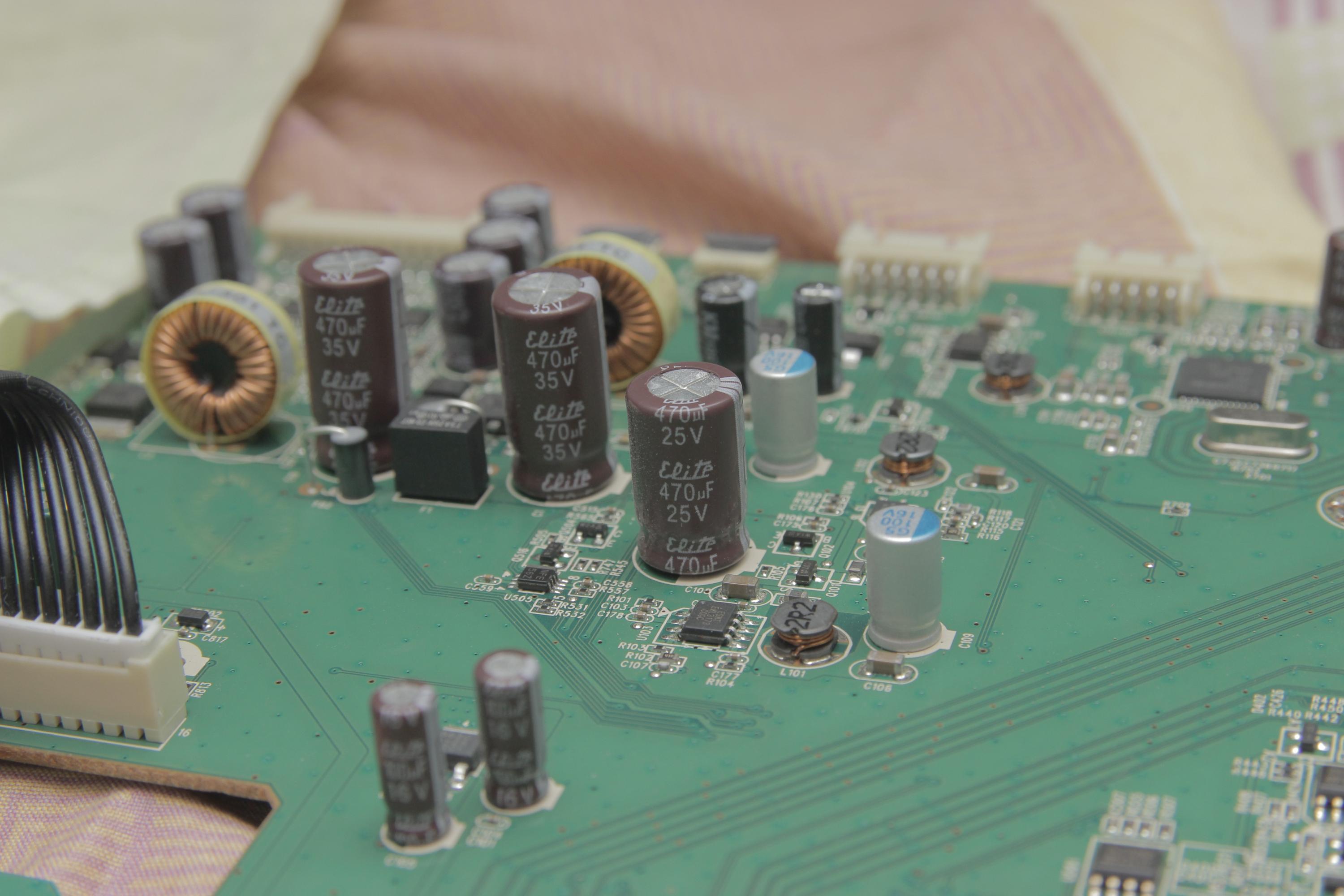

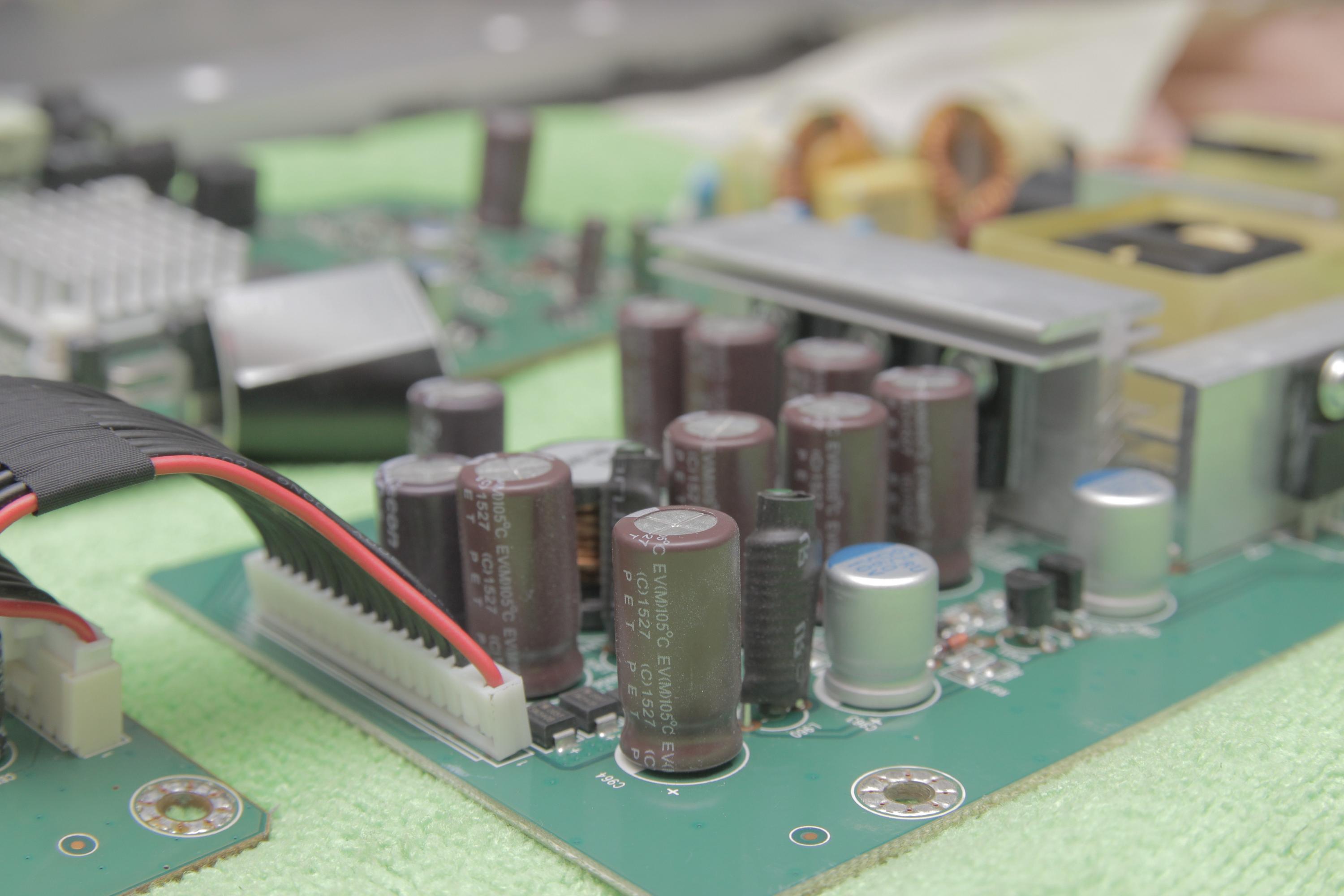

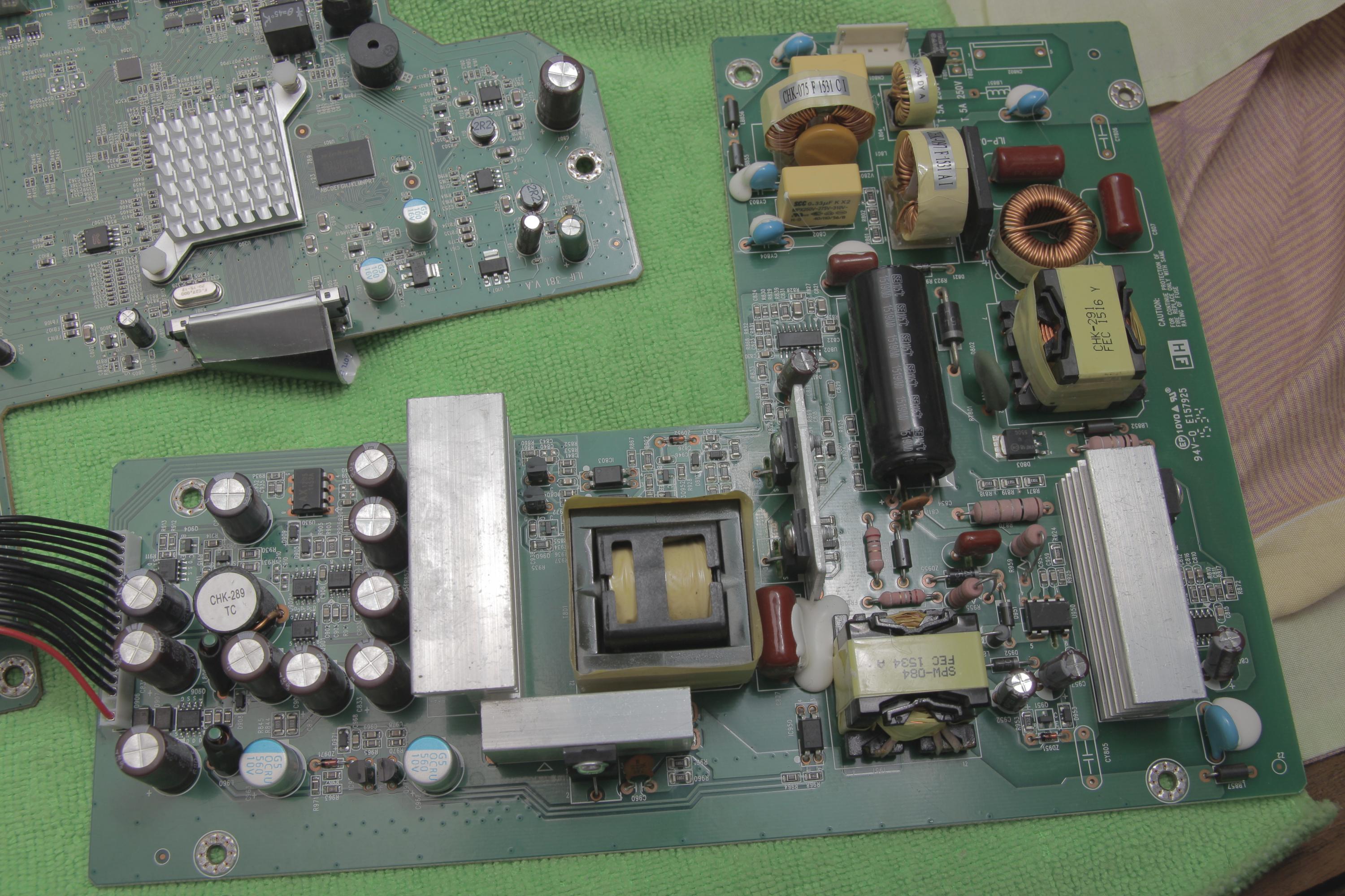

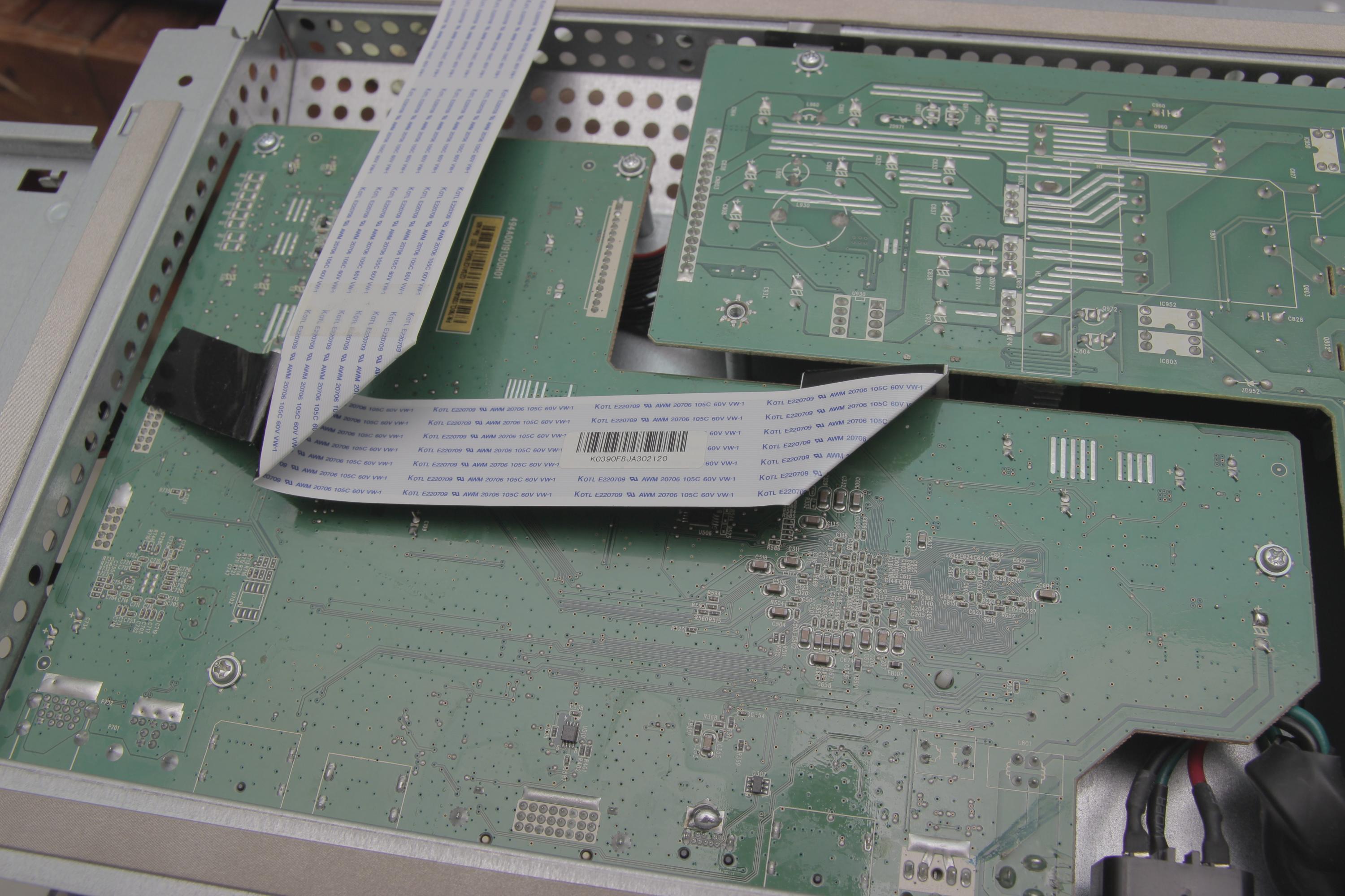

    Took a couple of images of the disassembly and board, for those looking for references, or who might encounter the same issues:
    The caps are a mixture of CapXon, Sus'con, and Elite caps, not sure if they're reliable though.

        Try again after disconnecting the USB daughter board.

          I tried disconnecting the side usb board -- no luck. I've yet to check the power supply pins, though it sucks that there's no labelling on the board.

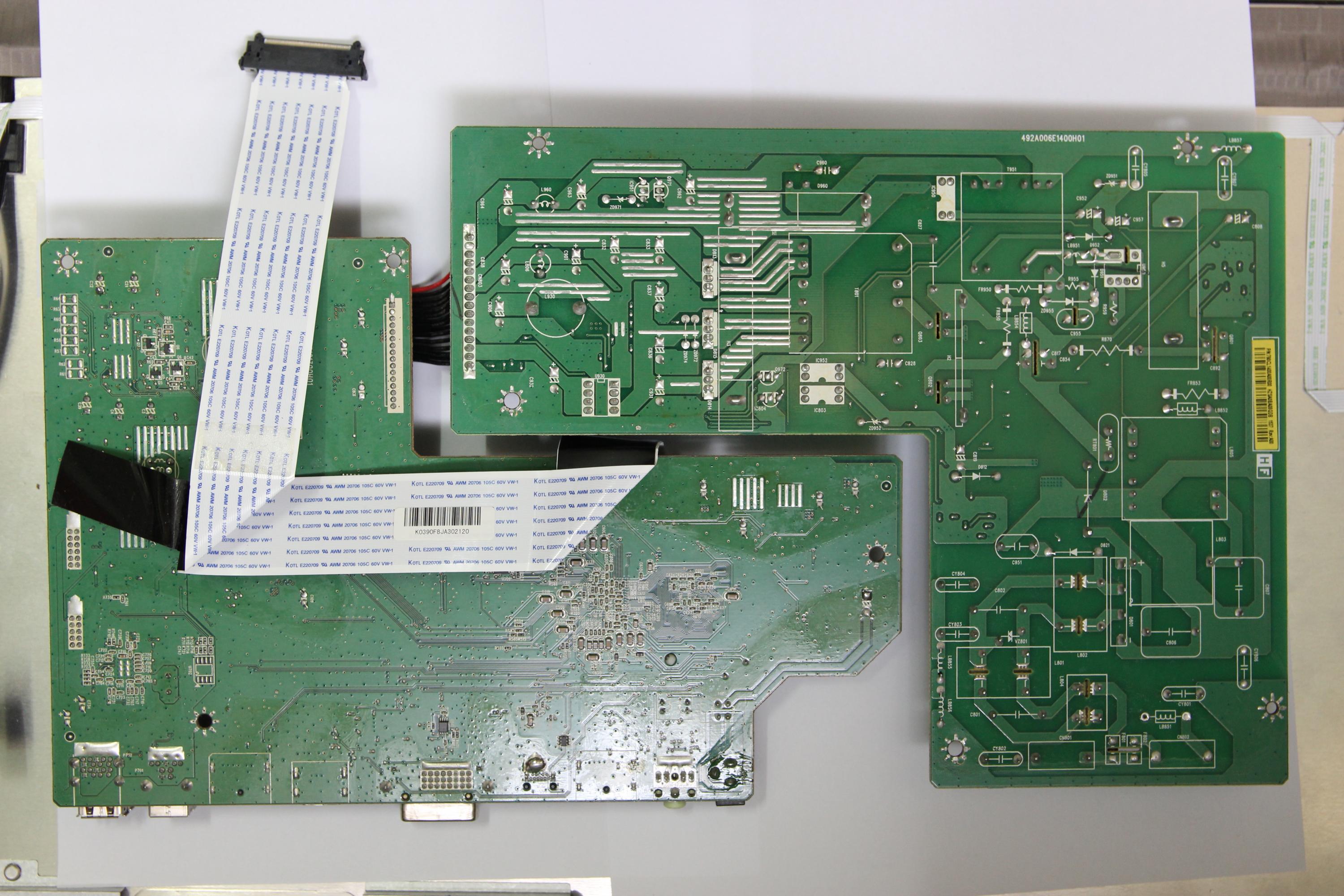

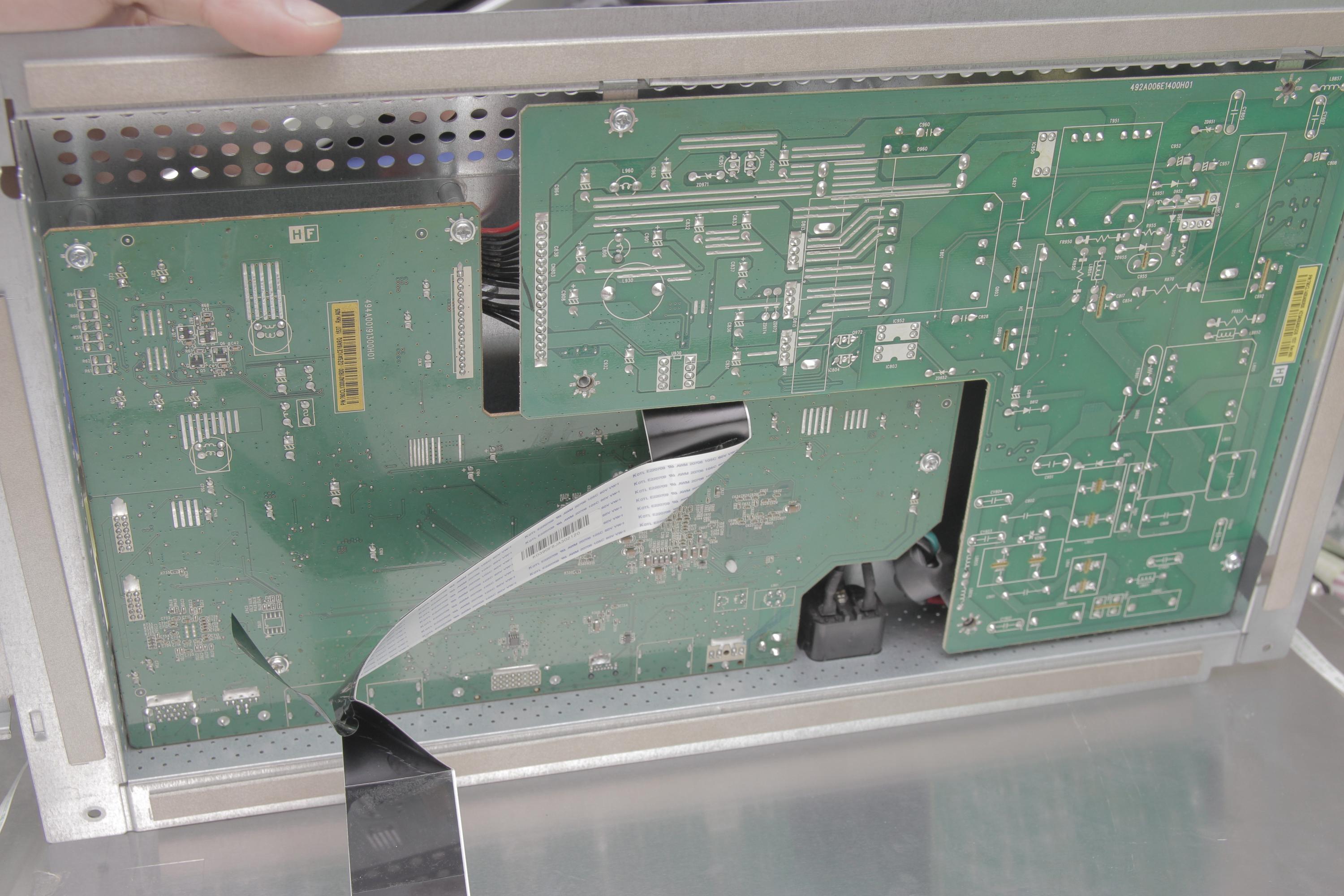

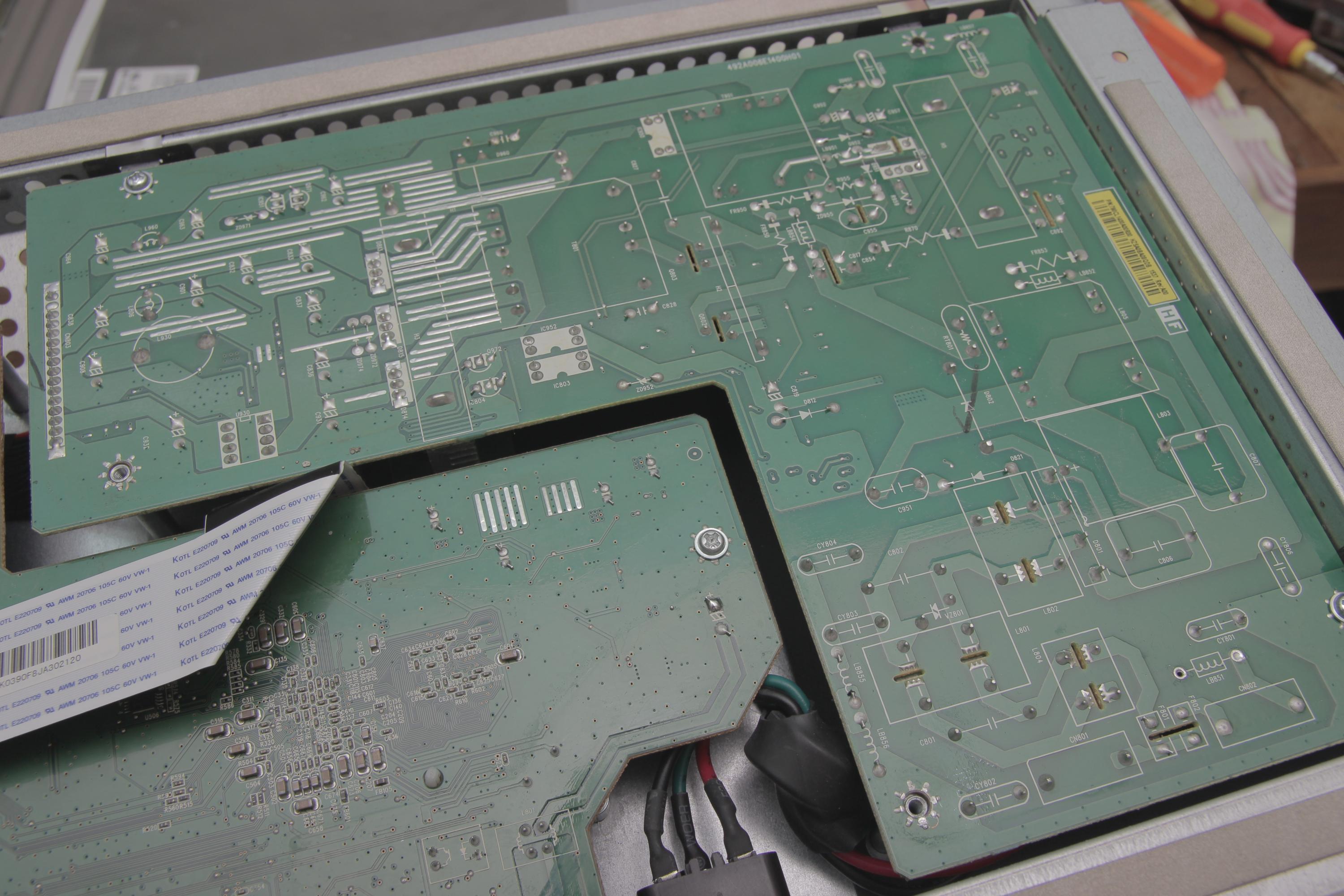

            Can we see good clear straight shot high res pictures of the whole top and bottom side of the power supply board?
            • dcdcc
              • Apr 2018
              • 12
              • Philippines
              Re: Dell U2413 turning off
              You can check the images I've attached below. Hope this helps

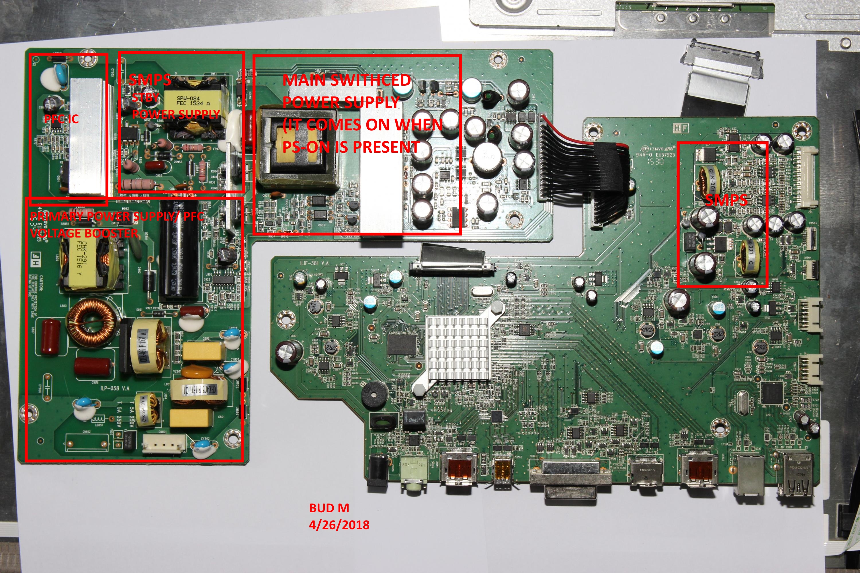

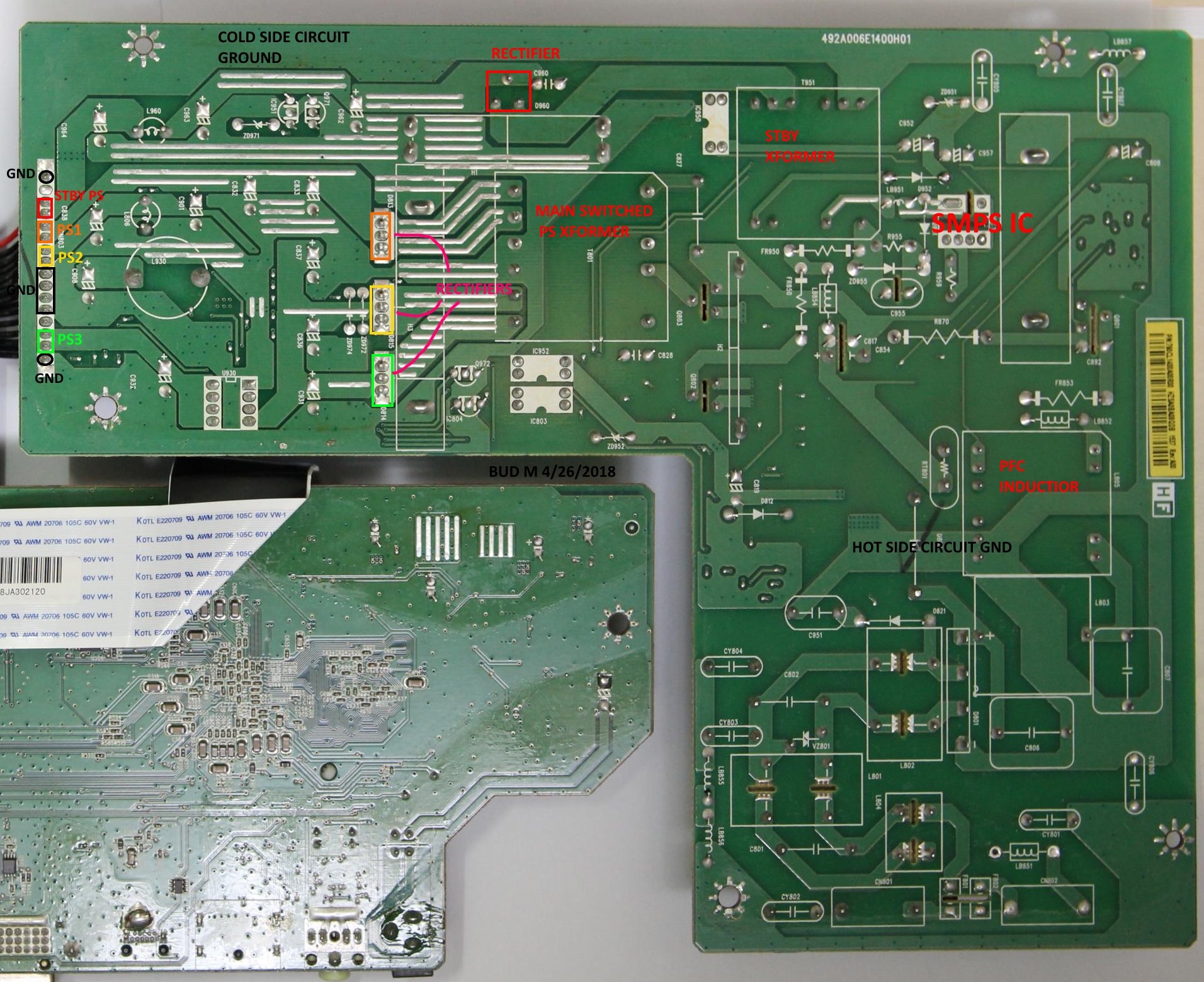

                Check the Voltages when missing and when it does not work, see marked pictures.
                The DC Voltage measured between the two legs of the main filter cap in the host side should be around 380 ~ 400VDC when monitor is turned on.
                        'OVP' = Over Voltage Protection.
                        Most PFC will have Low and High Voltage protection.
                        So at this points you need to test all those Voltages I already marked for you in the pictures. I hope you did take the Voltage readings on those points I made for you when it is working as I suggested.
                              PS1 is the standby power supply, it is working that is why you are getting the button to light up.
                              PS2, PS3 are the main switched power supplies that require the PFC Voltage to run, but since the PFC Boosted Voltage is low so PS2/3 stay in the shutdown mode.
                              At this point we need to verify if the PS-ON is present or not or we can verify to see the PFC Controller IC is getting the switched Vcc to run or not.
                              If you look at the picture of the top side, I marked the PFC IC, we need to the P/N as printed on the top of the IC, report what ALL the prints on top of the IC, so we can look up the spec. sheet for it.
