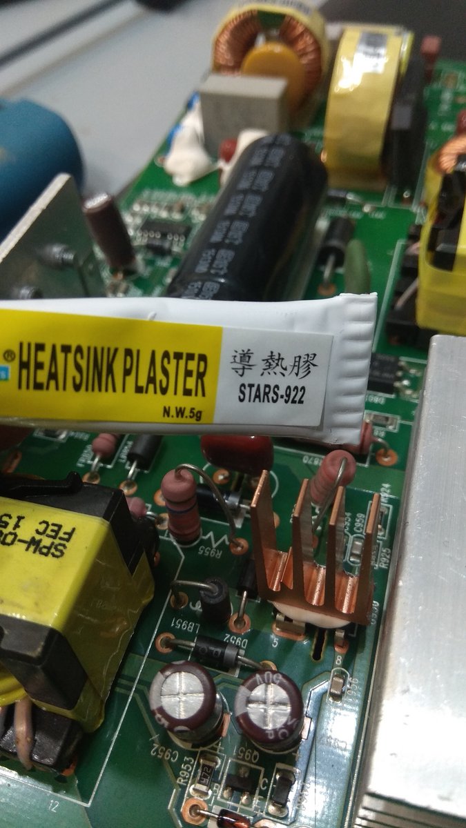

    • djatila666
      • Nov 2018
      • 5
      • Spain
      Re: Dell U2413 turning off
      Hi misteeka
      My monitor is working good. Look the image.
      That is my repair.

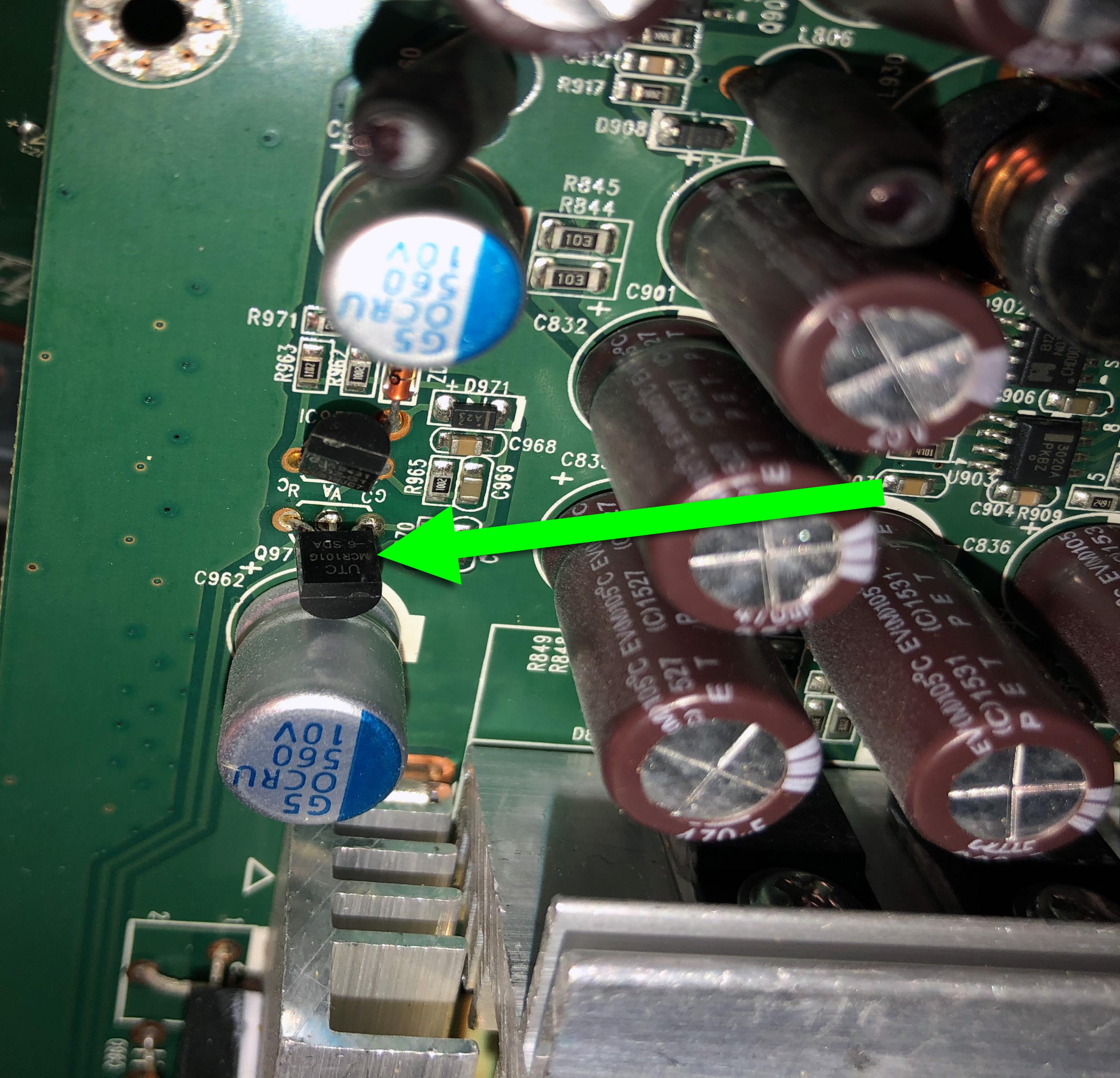

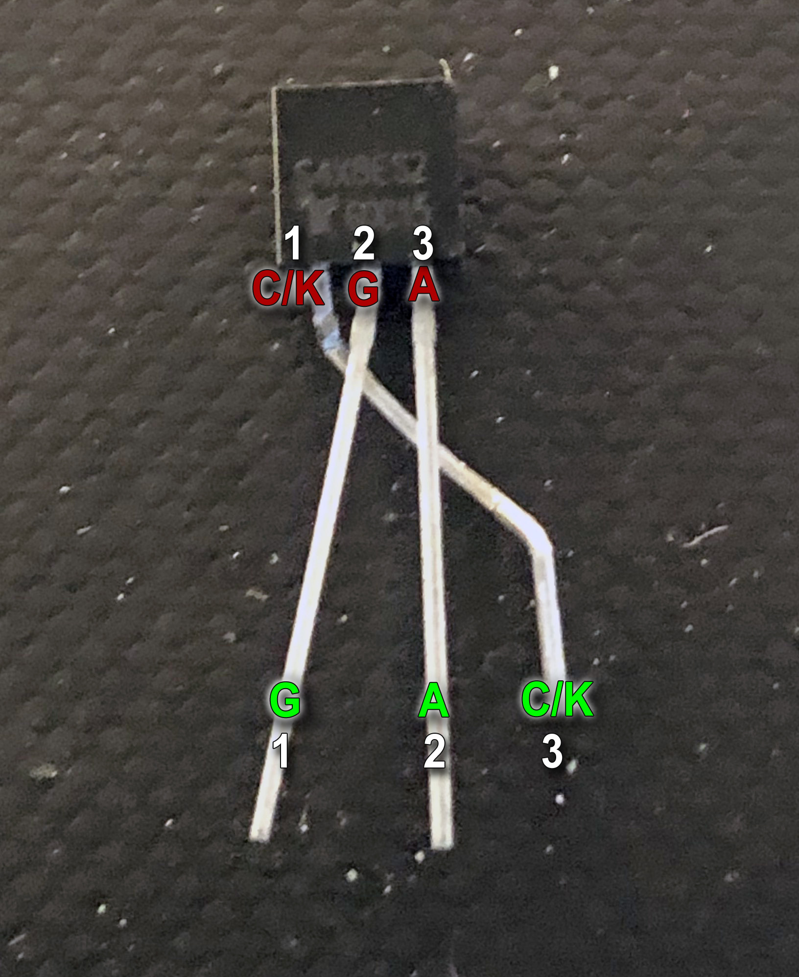

              • gaijin4life
                • Mar 2014
                • 4

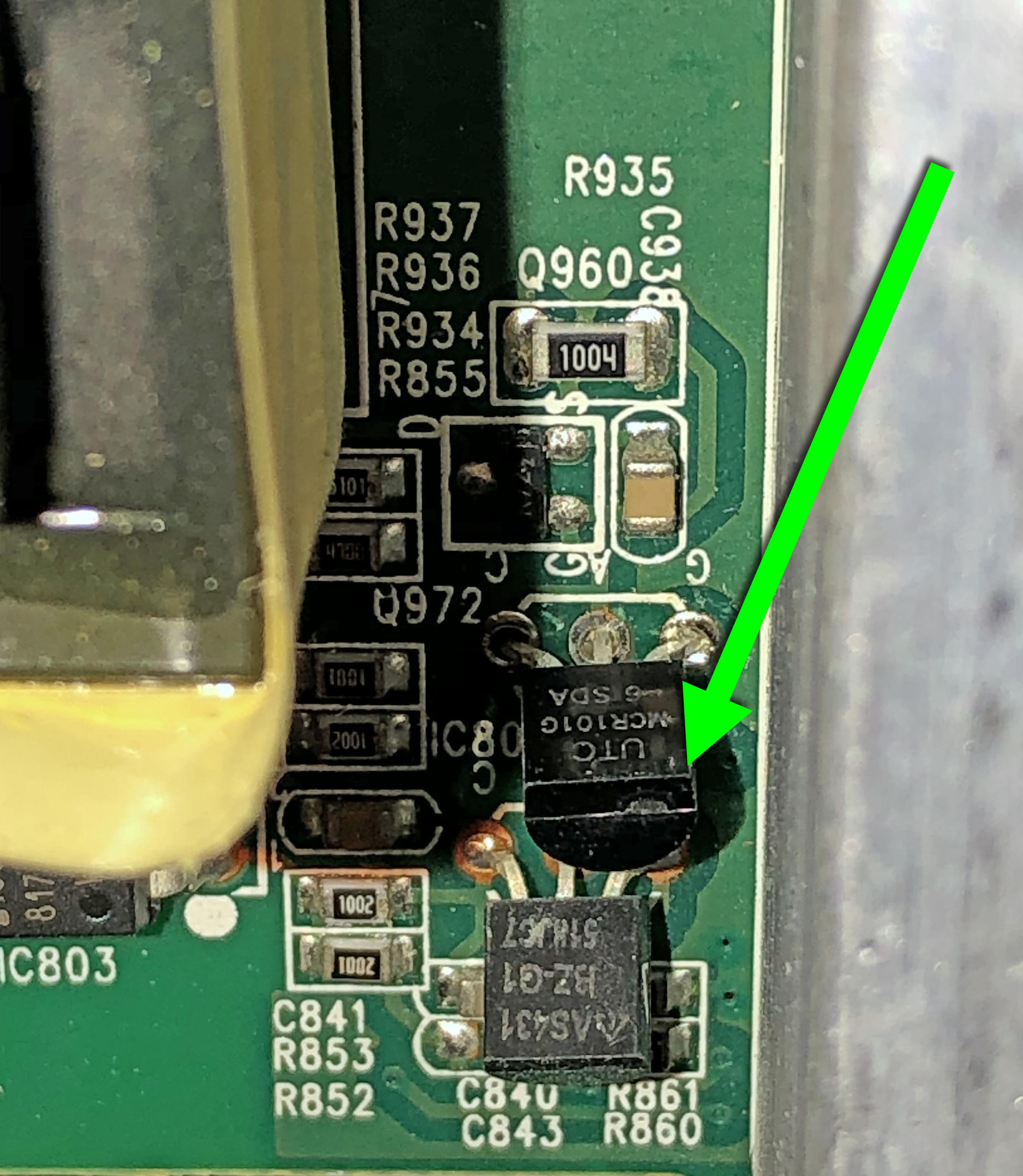

                So replacing the two thyristors are the answer for this problem. Q971 and Q972. Unforunately the original MCR part had a non-standard arrangement of Gate, Anode, Cathode (K) leads, and there are none I could find with the correct order, so you MUST bend the pins to have the right one go to the correct hole on the board, changing the Littlefuse Thyristor from KGA pin order to GAK order to match the original part - you CANNOT use the default arrangement.
                The replacement part you want is Littelfuse S4X8ES2, and mouser.com has them for a 45 cents each - the $7.99 shipping will be the most expensive part of this. I ordered 4 since they were so cheap so I had spares in case I accidentally broke a pin in the bending.
                The data sheet for the part is here: https://cdn.badcaps-static.com/pdfs/...2dfcd1b294.pdf
                To open the case on your Dell U2413, I highly recommend the ifixit kit with the guitar pick things (or actual guitar picks). They get the case open without marring it.
                I've attached a few pictures showing where the parts are on the power supply board in the monitor and also how to bend the pins of the replacement thyristor so it has them in the correct order when you solder it onto the board. This will stick up a lot higher than the original due to the bending (so you don't have any of the legs touch - DO NOT HAVE THEM TOUCHING EACH OTHER AT ANY POINT), but that's no problem.
                Thank you Dell for cheaping out on parts, cutting another corner that your customers have to figure out to avoid throwing a perfectly good monitor away.

                    I had pretty much the same issue. The screen would work for a bit, then power off (with the power led blinking) but not responsive. I'd have to wait between 2 and 10 minutes before I could power it on again and this would just repeat after a while.
                    Replacing Q971 and Q972 fixed it for me. Just remember when disassembling start with taking the bezel off. Using a multi-meter to check for shorted pins before putting everything back together.

                        #31
                        For what it's worth I'll reply to myself to state I eventually used a BT169D, due to its availability, price, and slightly higher junction temperature. Bending its pins from K-G-A to G-A-K required routing the K pin across the other 2, and heat shrink was used to ensure it didn't make contact.
                        So far it appears to have worked, although due to the nature of the circuit I'll only know if the gate isn't opened in the (unlikely) event of overvoltage. Fingers crossed.
                          I have two Dell U2413f (rev A01) working fine. Picked up a 3rd from eBay b/c overkill, why not. Well it powers off after about 5 minutes. Cycle power, shuts down after 90 seconds. Cycle power, shuts down after 15 seconds. So I'm thinking it's the same issue documented here. Something is getting too hot.
                          The eBay seller offered a full refund. I'm tempted to ask if I can keep it if they refund me perhaps all but shipping. If I can keep it for super cheap I'll give the repair/mod a try. If they will only refund with a return, then obviously I won't tinker.
                          If I am reading this correctly, I see two possible solutions documented here?
                          @djatila666 had one solution
                          Originally posted by djatila666
                          It has been running for two days without turning off. I put new thermal paste on the K15A60U and I attached a radiator to the LD7904jgp7
                          @gaijin4life has another solution
                          Originally posted by gaijin4life
                          So replacing the two thyristors are the answer for this problem. Q971 and Q972....
                          Are these both required? Complimentary? Different/unrelated?
                          I'm entirely unfamiliar with soldering so to me the heatsink approach is appealing if it is a fix.

                                Fix confirmed in my case too. Replaced Q971, Q972 with BT169D and it’s running for several hours without problems anymore.

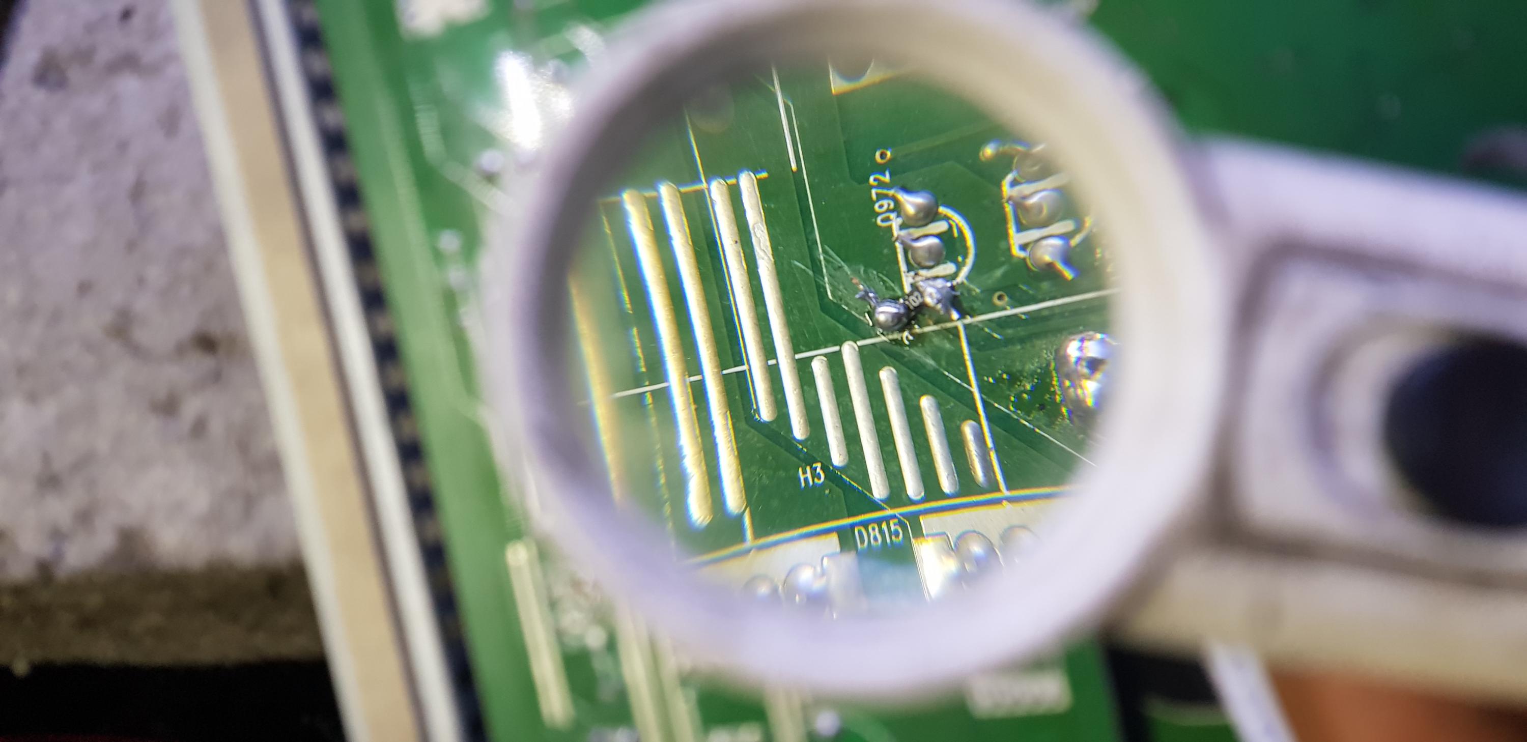

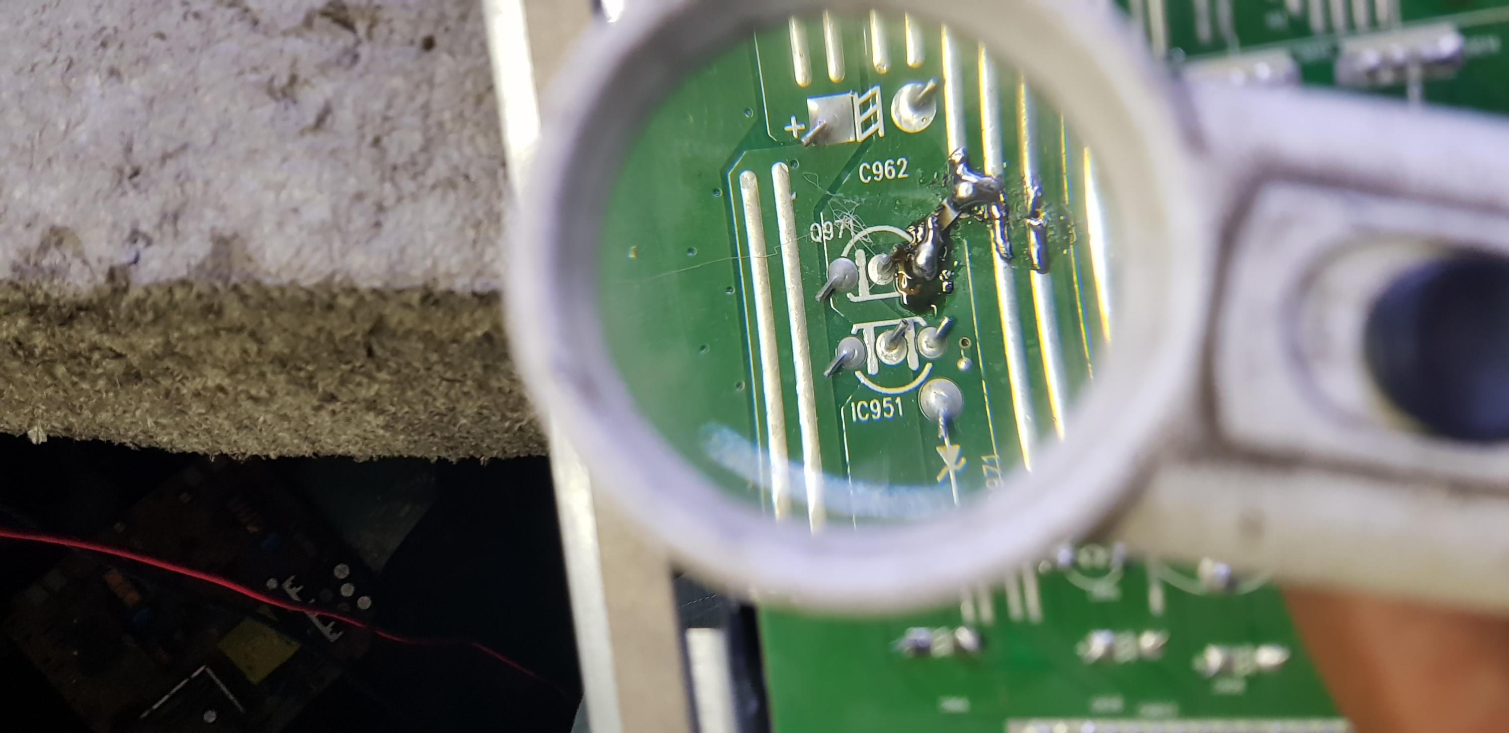

                                • raptor22
                                  • Apr 2019
                                  • 6
                                  • Pakistan
                                  #36
                                  Is there any alternative to this transistor?
                                  • raptor22
                                    • Apr 2019
                                    • 6
                                    • Pakistan
                                    #37
                                    I have tried to fix this by adding 1K Ohm resistor in parallel, is it good enough soldering?
                                    Is it correct ground?
                                    • raptor22
                                      • Apr 2019
                                      • 6
                                      • Pakistan
                                      #38
                                      Thanks this fixed it for me. I tried the other two methods i.e heatsink and adding a resistor in parallel to Q971 and Q972 but both didn't work.
                                      replaced the Q971 and Q972 with B169B and boom it working for 12 hours straight. No heating up and shutting down issue.
                                      Total cost for replacement parts Pkr 25/piece for the B169B. so Pkr 50 for the parts and the rest for the local LCD repairman he learnt a thing and two from this too. Parts bought from https://theicshop.pk/, their store is located in Hall road, Lahore (for any Pakistani reading the forums).

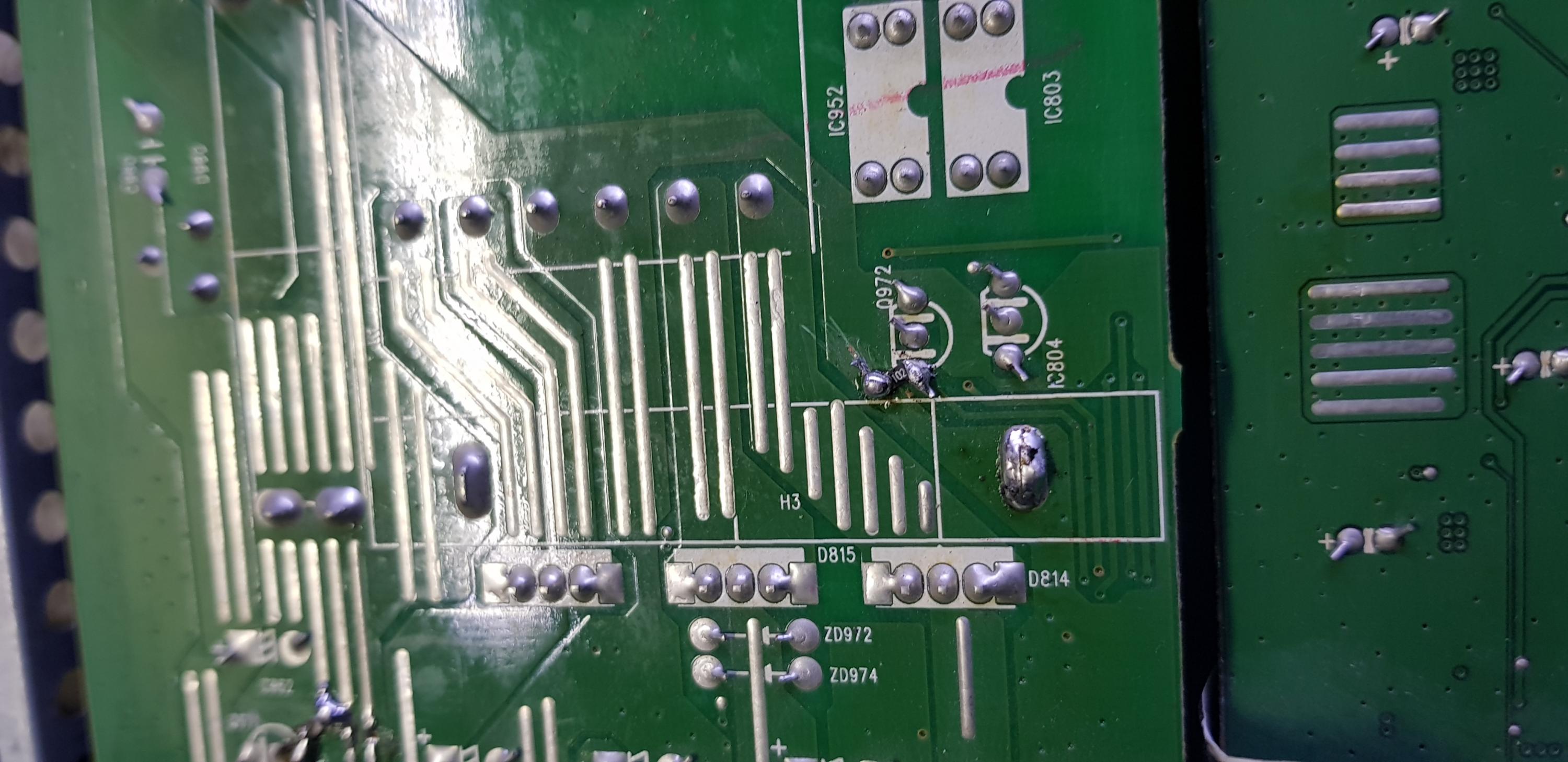

                                      • Sraros
                                        • Jan 2017
                                        • 223
                                        • Greece
                                        #39
                                        2years later one more monitor U2413F with the same issue.
                                        Only this time the monitor only had standby voltage straight from the power on state instead of shutting down after a while.
                                        These spare BT169D came in handy
