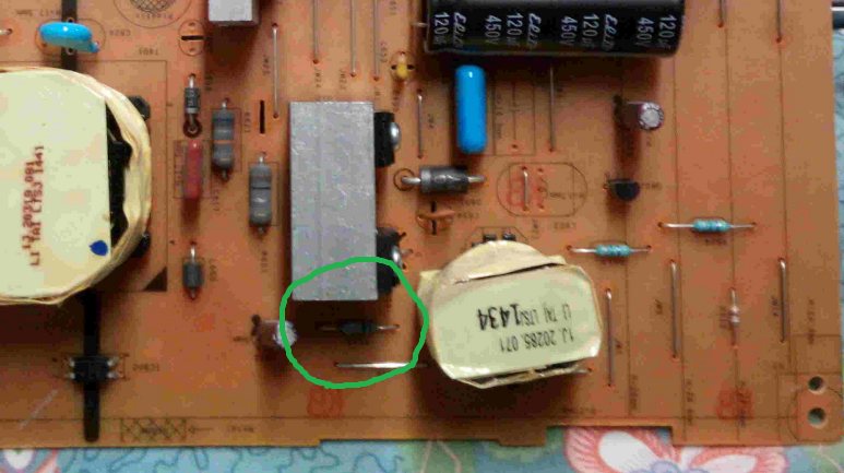

    Display only blinks and than stays dead. Check open the PSU revealed it is dead.
    There are three output rails: winding to feed the TEA1791T synchronnous rectification controller (this thing has no connection with primary side!), the output for the rectification transistor - this rail feeds the signal board, and than backlight rail.
    Seems like the unit only pumps few cycles to the secondary so voltage rises a bit and than falls down as the caps discharge. I have about 15.5 V on a small cap on the primary auxiliary rail just after the diode which slowly falls, pumps again to 15.5 V and that repeats.
    There is however oscillating voltage between like 18 and 19.6 V on the cap directly in front of the primary common PFC/PWM controller. Do not think this is normal condition. Cannot identify the controller right now, it has layer of lackquer, gonna have to try removing it.
    I do see only 320V on the input cap though, there is no spike suggesting the PFC would be turning on, so maybe the problem lays in here?

    It's very difficult to read anything in here but it seems like the PFC/quasi-resonant flyback controller is NXP, possibly TEA1751T. According to the datasheet, the startup voltage is 21-23 V so when it's at 18-19.6 that's too low.
    The path goes from the auxiliary winding on primary side through inductor to an SMD diode, capacitor and than there is "K415 C200" TO-92 bipolar transistor. The 15V feed leads to its collector, the oscillating 18-19.6V output is on its emitter. Collector and base has 1002 SMD resistor in between and base is also connected through an SMD zener to return.
    So it seems like some amplifier with zener feedback? And this is to feed the Vcc of the controller.

                  In your picture #2 on the bottom left, there is an IC (18-PIN?) there, can you read the P/N?
                  • fred41
                    • Feb 2012
                    • 9
                    Re: Acer B326HUL power supply dead
                    Hi, I tried to take pictures and read the part references
                    n°1 : NXP TEA1751T CDX12104 TXD14241
                    n°2 : MPS1431 MP3398 E44H2168A
                    n°3 : unreadable, but seems to be the same as n°2
                    thanks

                      OK, #1 is the one we need to find out if it has DC Voltage between VCC pin and Gnd for it run or not. Please see the spec sheet.
                      NOTES: You will be working in the HOT DEADLY side of the circuit so do not touch ANYTHING with your hands or body, you should at least plug the monitor into GFCI outlet.

                                  That is correct pin out for TEA1751:
                                  Pin 1 = VCC
                                  Pin 2 = GND

                                      I measured 18.5Vdc - 19Vdc
                                      And I didn't blew up the house, nor I burned myself...
                                      Thanks everyone
