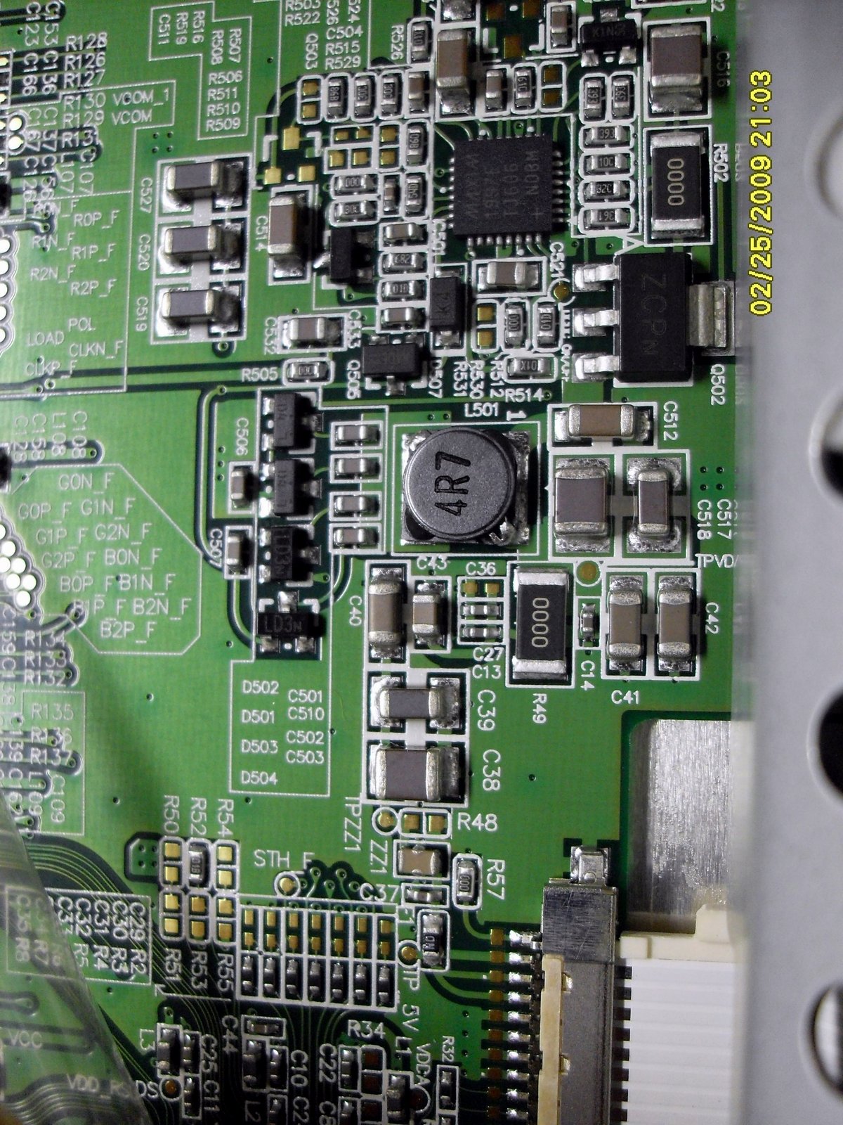

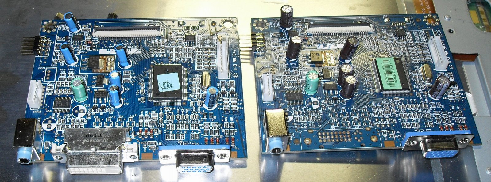

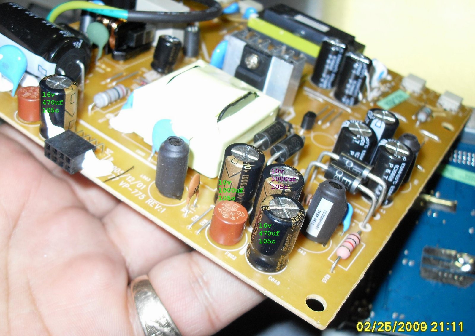

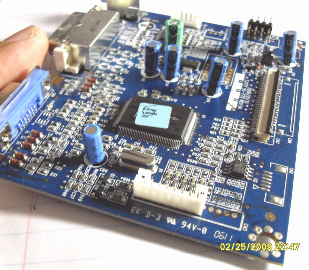

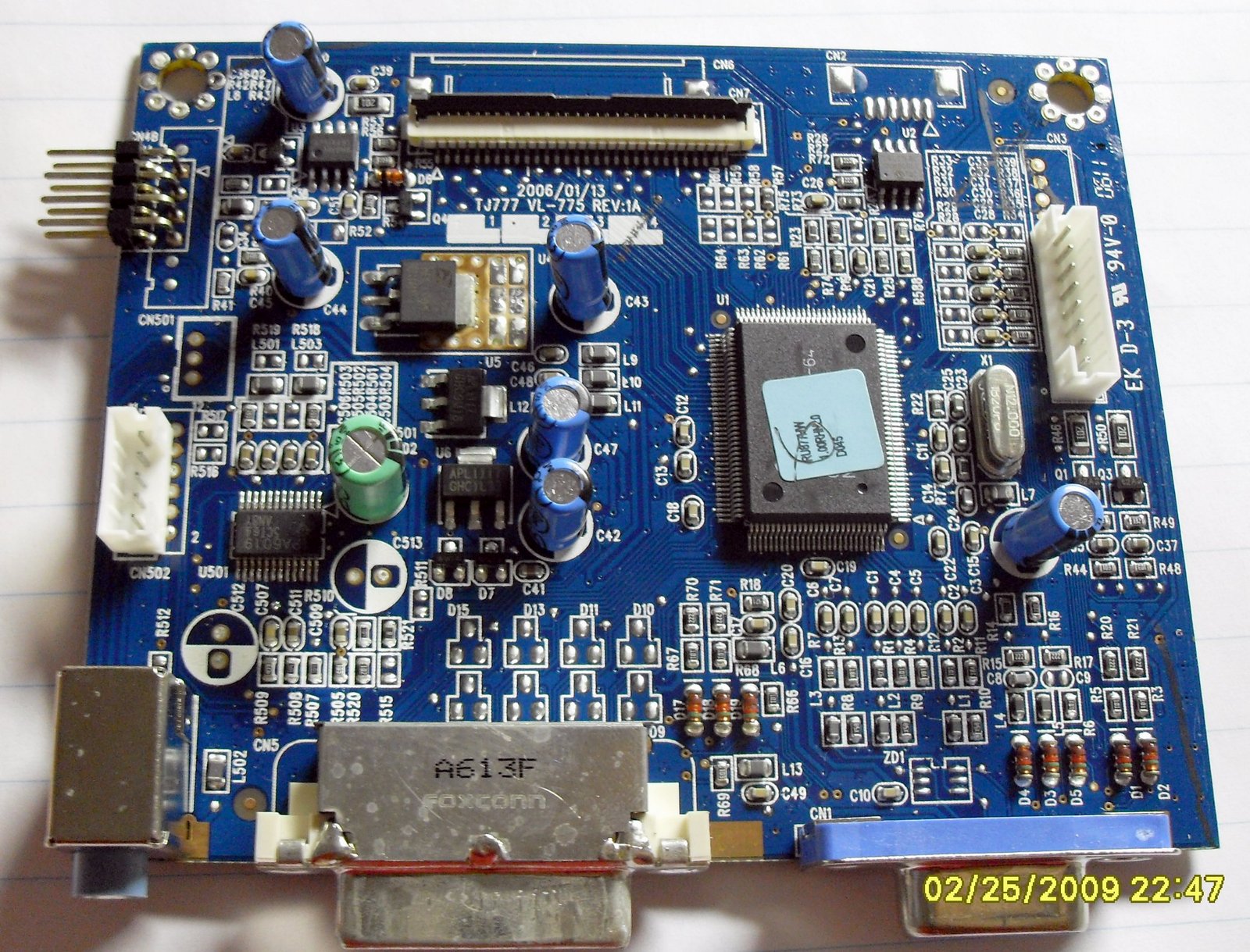

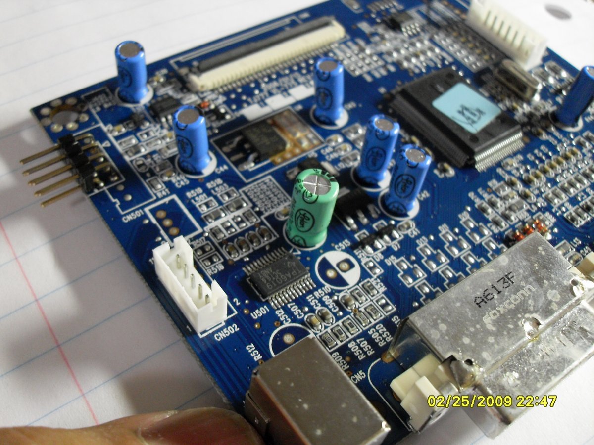

          here are pics of the two boards I have, and the Caps area of the PSU. They have been replaced by Panas.
          Also includes is a picture of the area where the connector from the VBoard is connected in the LCD panel. There is a 5V on all that area, so at least the 5v are reaching the panel. The boards respond to VGA signal (green with signal, amber without it) with both panels. I just used the lamps on one screen to test a 172n I'm working on, so I now have only 1 complete panel.
          All the caps in the board that has Analog & DVI input are Lelons.
          I will check the boards, as I remember seeing a V regulator that outputs 3.3v there (an APL1084-33 IC) I guess I checked it but there's nothing on my notes, so I'll make sure.

            Is the chip with the sticker on top a Genesis GM5621? Looks like one.
            This chip needs 1.8V for the brains. You have that, otherwise your LED would not change color when you give it a signal.
            It needs 3.3V for the LVDS part of the chip. If this is out it could explain why you have no video.
            If it is in fact a gm5621, this is the whole circuit except for the power supplies!

                The boards are live, as they receive 5v from the PSU, and respond to the signal (led goes to green or amber as signal comes and goes).
                I checked and there are two ICs that get 5v and pump out 3.30v. Then, there's another one that gets 5v and outputs 1.8v. The board that has DVI & VGA is full of Lelons, and I will change those one by one to see if they are the cuplrits.
                Also, as for the Genesis chip, it is not a genesis, it is a Novatek. I'll post the ICs info as I change those Lelons.
