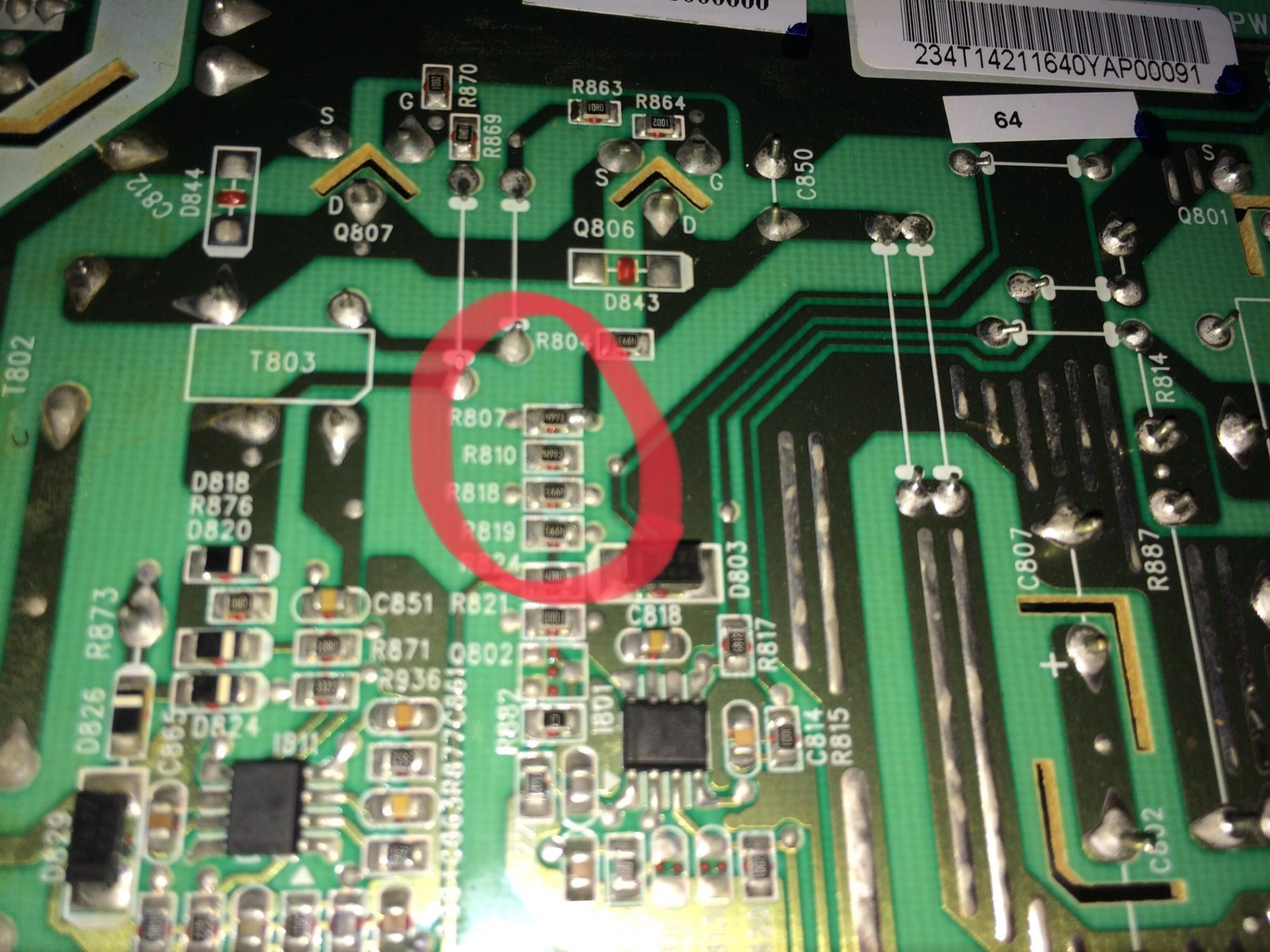

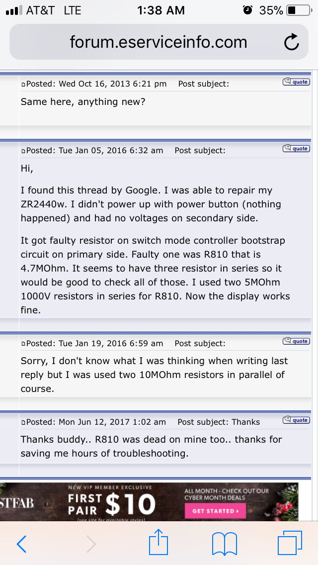

    Hi, I recently got a monitor that goes to a black screen after about two minutes. The backlight will remain on though. After some googling, I think the problem is resistor R810. I tested mine after reading advice of others having the same issue and mine along with 3 others in a line were bad. I'm wondering though, should I try and replace these with the same value resistors or will they go out again? Is there maybe a higher value I could use to help prevent the new ones burning out?
    I don't know anything about circuit design but I can solder okay. I attached images of the problem resistors and a screenshot of the post because I can't find the thread for the life of me. Just looking for some advice, thanks!

    The post said 50Mohm 1000V resistors......What the hell is that? Resistors don't have voltage as a spec, they have power ratings in Watts. Anyway you must replace your bad resistors with the same value resistance. The power rating could be higher NOT lower. Those SMD resistors are 1/16 Watt. So perhaps if you can get it to fit 1/8 Watt will work. The key is 'same' resistance.

          What readings do you get on those 4 resistors ? 400k
          The thread you couldn't find is here http://forum.eserviceinfo.com/viewto...hlight=zr2440w

            No reading (infinite resistance). I even went around the board and tested others to make sure my multimeter was working and got normal readings on the others. All four in series (parallel?) were like this. Sorry, what do you mean BGA issue?

              Resistor R810 is marked 4493 which is 400 kohm, not 4.7 Mohm as described in that thread. Which also mentions no power. You have power.

                        On mine, R810 was fine (showed about 350-400k and it's supposed to be 500k (edit: measuring while they were still on the board, which will skew the readings, but they were not shorted nor open) ) - also caution, those four resistors next to each other are _not_ in series! The first pair has one common pole, then both go separate ways. And the other pair likewise has one common pole, but the other ends don't go the same way, so I wouldn't just solder together the endpoints with one or two resistors.
