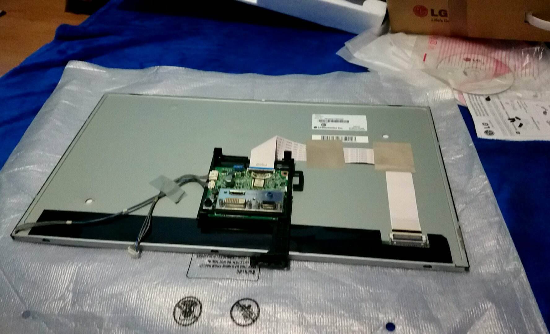

    The monitor is perfectly fine for 5 minutes and after that shows flickering, see the video.
    I checked the powersupply, the voltage is ok.

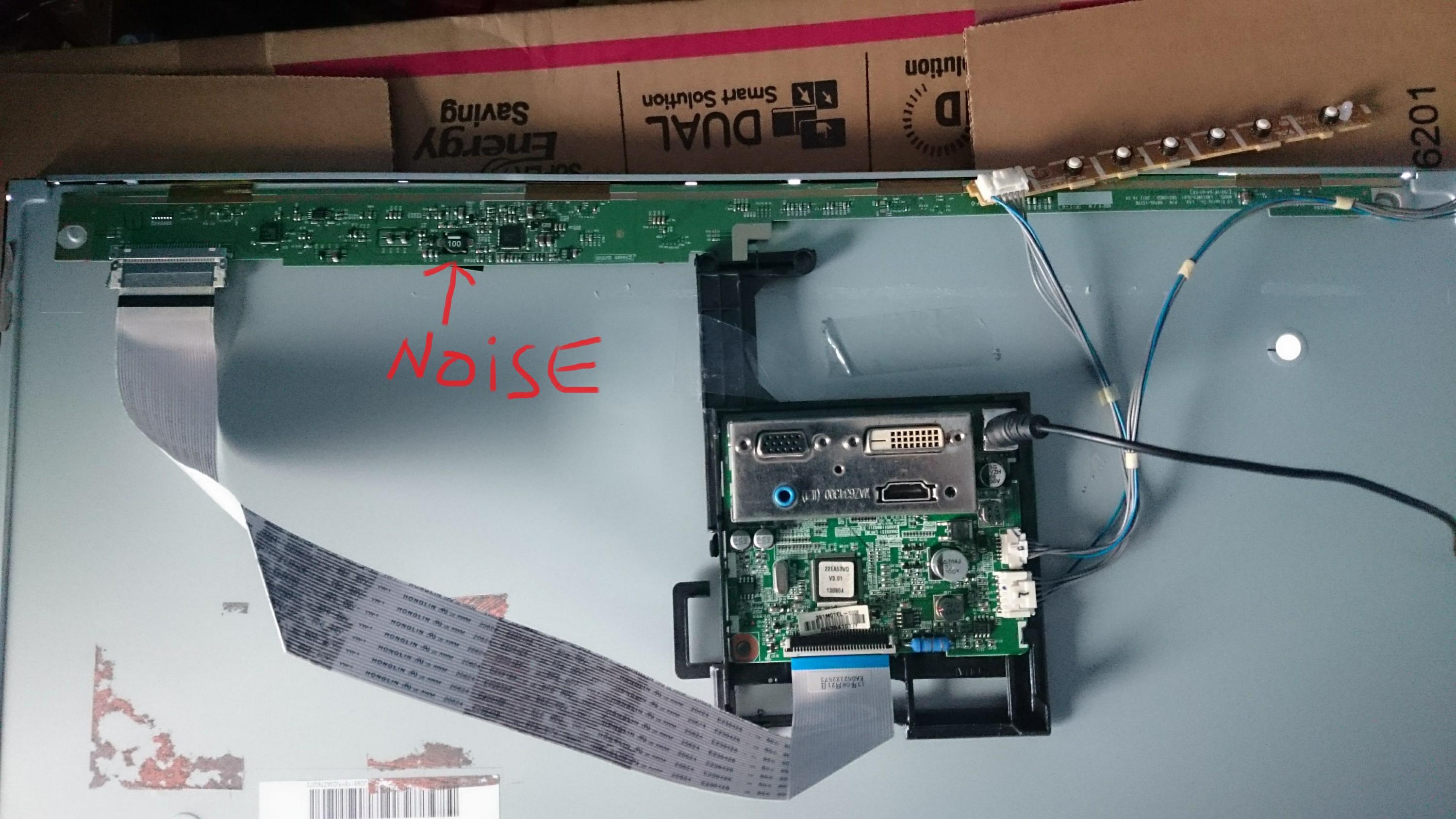

    All i hear is a pitch noise coming from one of the components in the pcb.
    Anyone has ideas?

          Yes with pc and without pc too, its exactly the same and the timing is too.
          But, when turned on after 2-3min it does a little flicker for 1-2 secs, and a pitch noise comes from the monitor then the picture is perfect again, and after 2-3 min again the monitor goes like in the video.
          Seems like one component is failing while in duty but i dont know which one.

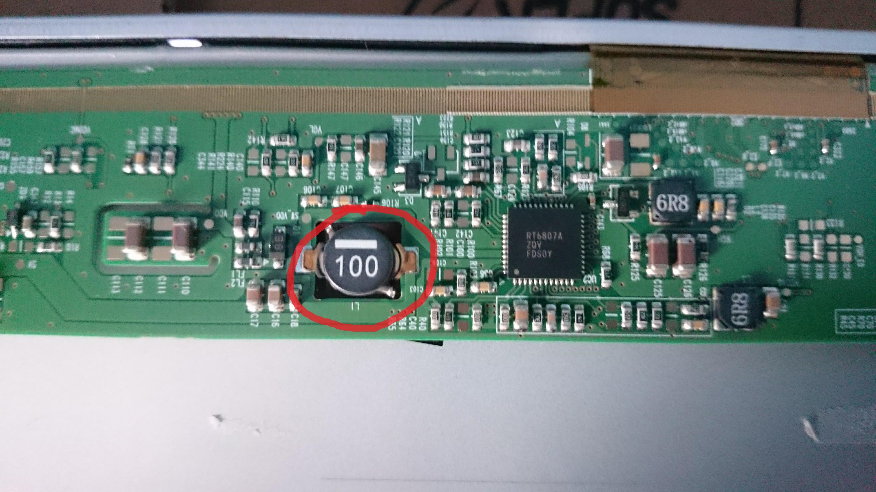

          Edit:
          Maybe the buzzing noise comes from this component only when the monitor goes bad:
            master hoarder
            • May 2008
            • 12175
            • Bulgaria
            Re: LG 22EA53VQ-P "crash" after 5 min.
            Interesting. That appears to be the T-con's AVDD inverter coil/inductor.
            So could be one of the two things: either the T-con board's power is being cycled On and Off, thus causing the noise *or* there is a shorted or partially-shorted ceramic cap on the t-con board that pulls down one of the power rails, and that causes the power to the monitor to cycle continuously.

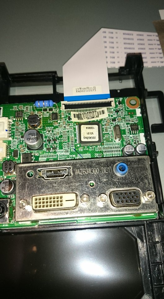

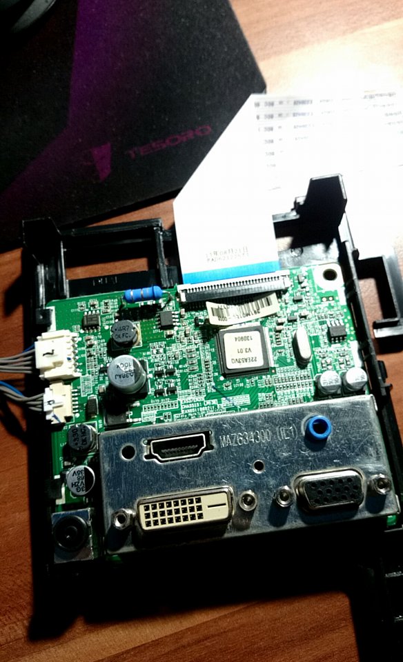

            To narrow it down, let's try the following:
            Disconnect the flat LVDS ribbon cable going to the t-con - the one shown on the left in this picture.
            https://www.badcaps.net/forum/attach...4&d=1513941077
            When you do this, there will be no picture on the monitor (it's OK for the screen to turn fully or partially white... or even black in some rare instances)
            Then, turn On the monitor while connected to a running PC. Make sure the PC is not set to go to sleep or turn Off the monitor so that it can run much longer than 5 minutes (or however long it takes for the monitor to start flickering).
            Now see if the monitor starts flickering again. If it does, then the issue must be somewhere on the logic/video board and/or power supply. If NOT, then the issue is likely on the t-con board. We will pickup from there, once you let us know which one it is.

                  The inductor burned out, smoked so i had to get it out.
                  Now i only get a blank black screen so backlight on, no smoke, no heat.
                  Maybe theres a short somewhere, i dont really know.
