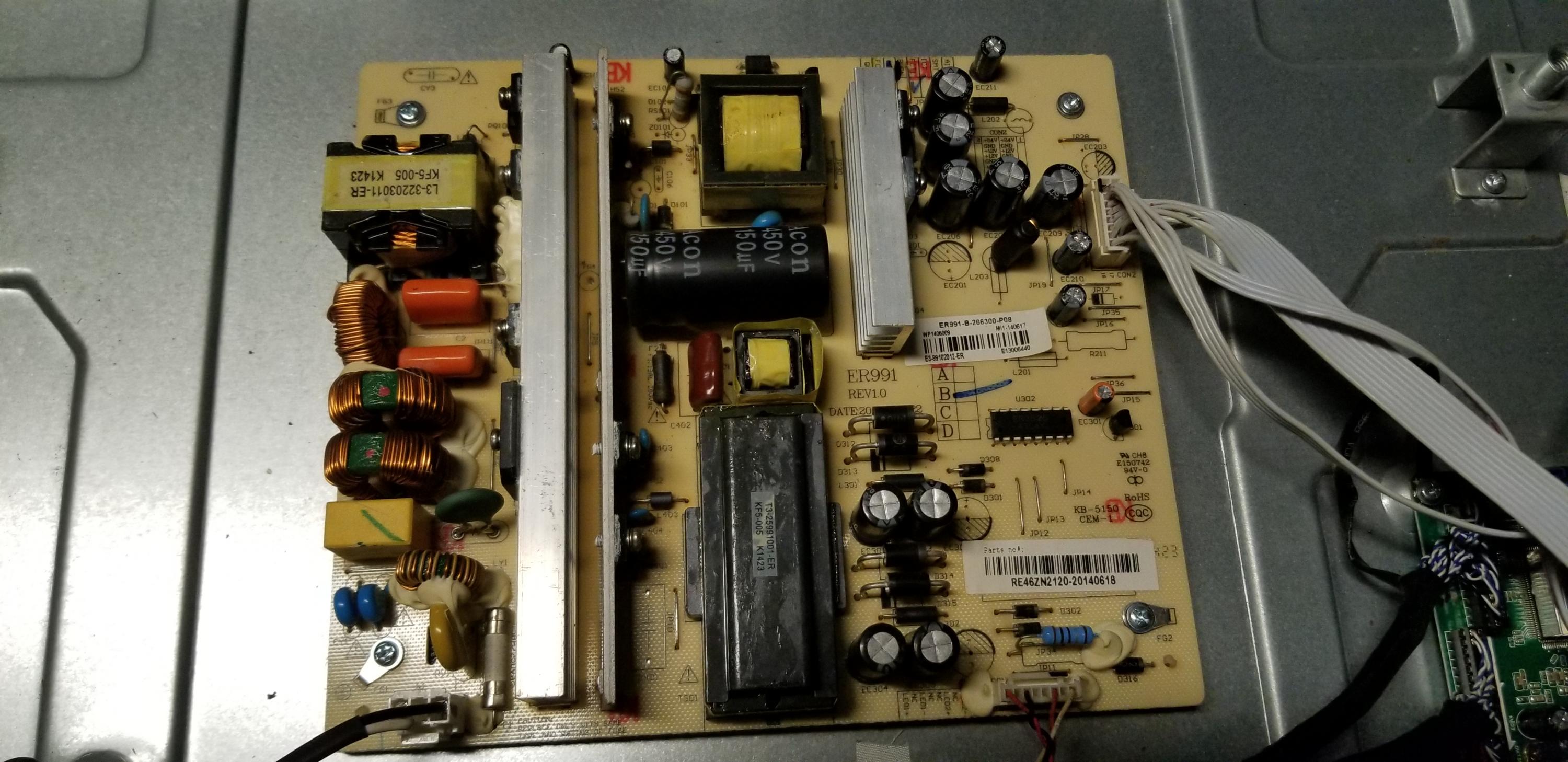

    Hi all. I read through a previous thread regarding this same set, I'm hoping to get some confirmation that I'm on the right track. The set will flash once every 3-5 seconds when powered on. No indicator light, neither standby nor power on. During this 3-5 second cycle the screen only displays 2-3 colored horizontal lines. Will not power on. I've confirmed 120v at the power board, only reading 3-3.5v going out of it. No indications of blown capacitors from what I can see, but I am far from an expert. I read in Mr. Martin's troubleshooting guide I should have 5v standby, etc. With a reading of 3-3.5 do you blame a faulty power board? I really want this set going but I can't throw parts at it blindly Any guidance would be greatly appreciated!

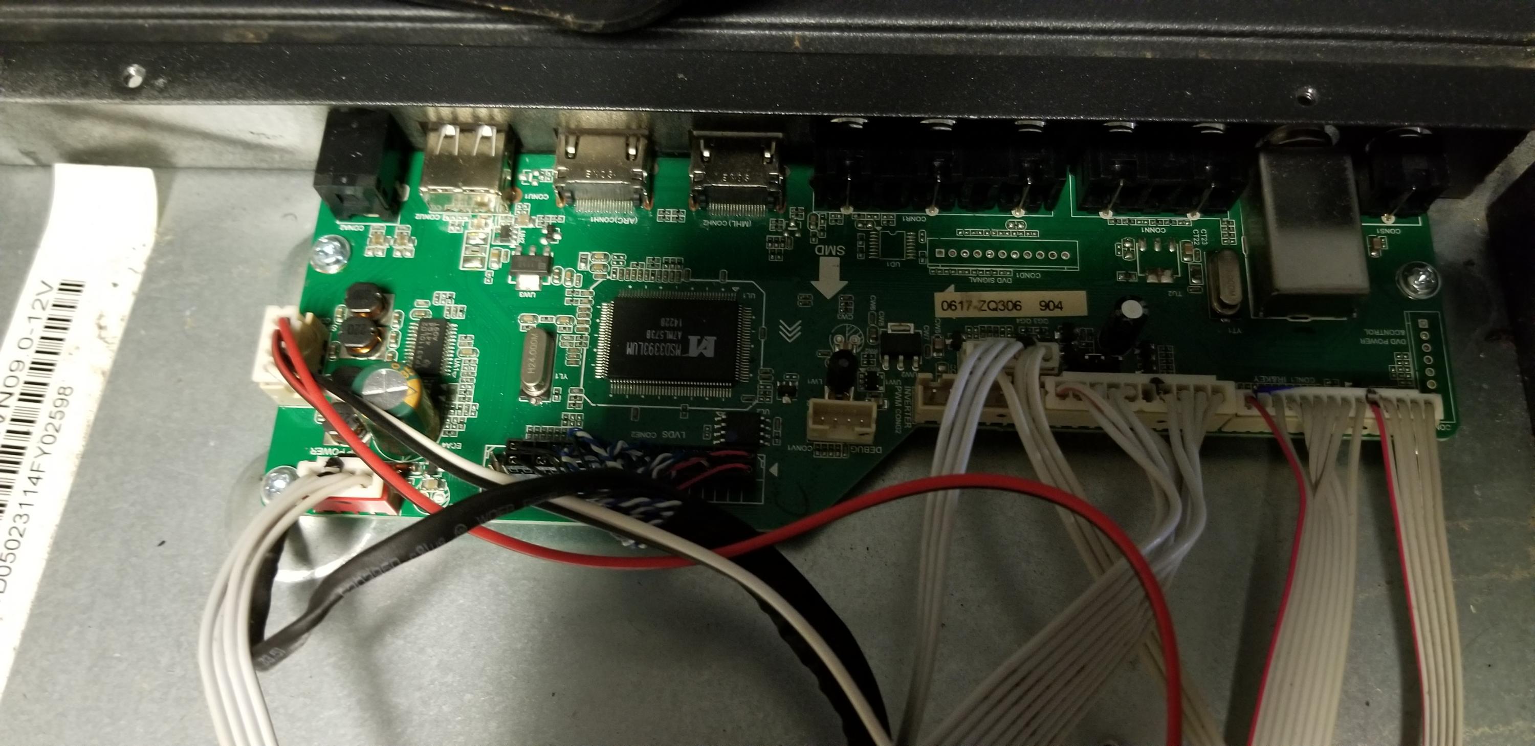

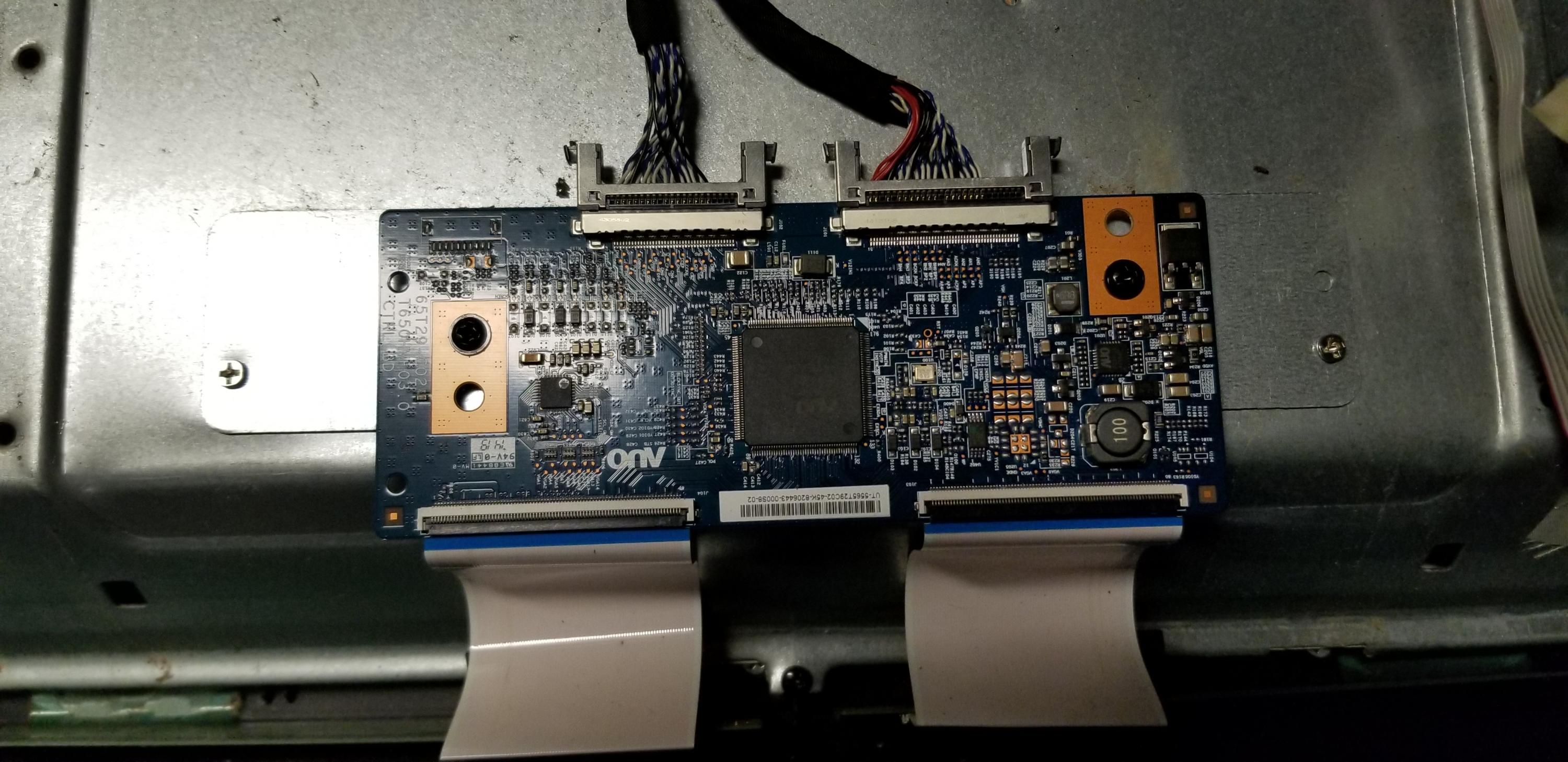

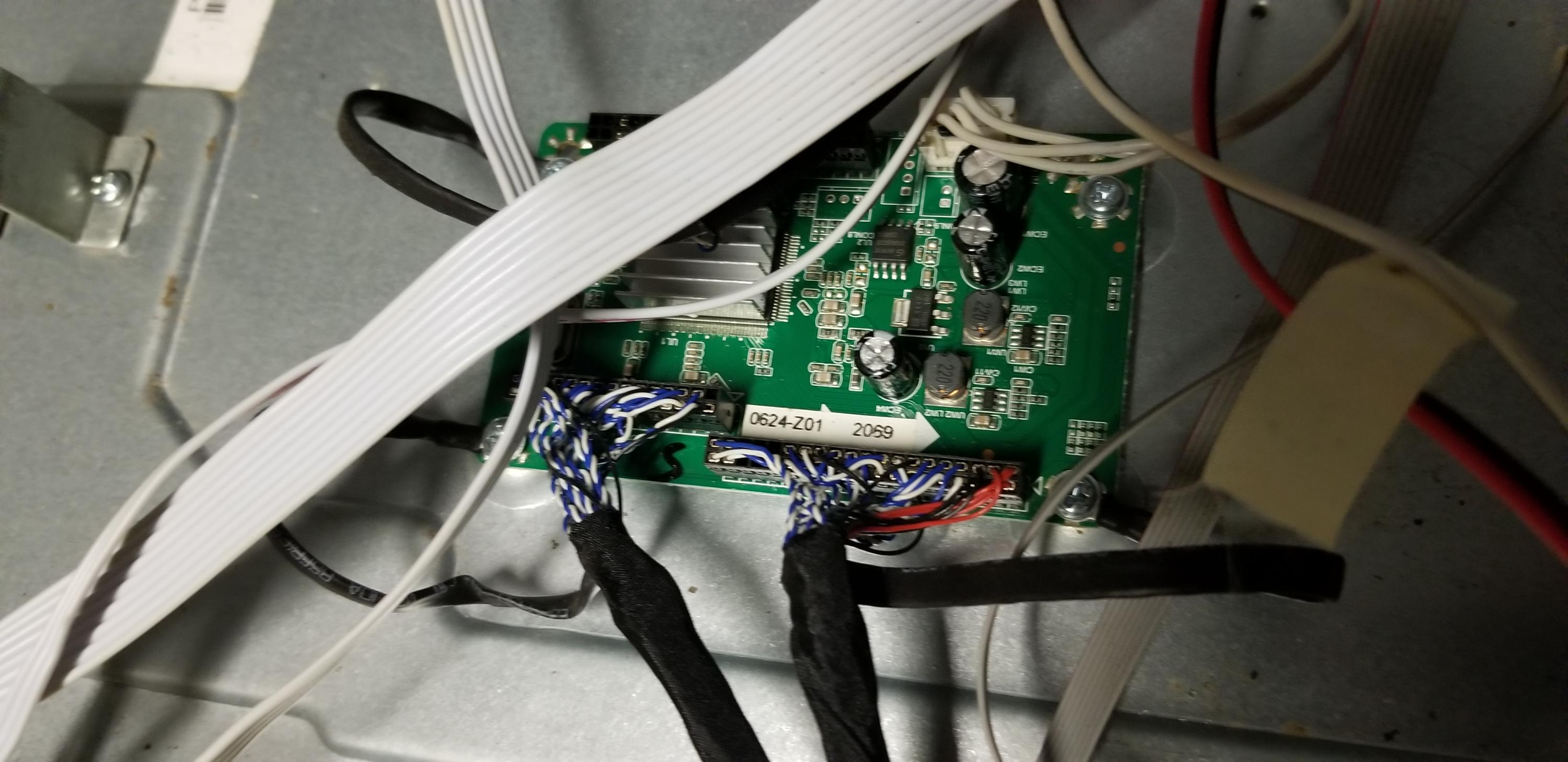

    Need good clear straight on pictures of back of tv with cover off and each board.

      here goes..thank you!!

        Need voltages from connector that goes from power supply board to main board. Will need pin#- PIN DESCRIPTION -Pin voltage in standby-Pin voltage when pushing power button and picture of connector on power supply board.
        Format:
        Pin# - Pin Description - Pin Voltage standby - Pin voltage power on
        1 - XXXXXXX - XXv - XXXv
        2 - XXXXXXX - XXXv - XXXv
        3 - XXXXXXX - XXXv - XXXv
        4 - etc.

                          Still my main cap is only seeing 167.9 vdc

                            When the tv goes into test pattern, check the main filter cap voltage and the 24V rail. It sounds like a bad main board to me, but first verify voltages on the PSU. If push comes to shove, disconnect everything from the PSU and force it on. If that PSU checks out all right, then it is a main board problem.

                                PS-ON is present but you still have only 160Vdc on the filter cap, it shoould be 380~400VDC because the board has PFC Voltage booster circuit, you need to get the PFC circuit working first.
                                How much experience do you have troubleshooting down to component level and SMD reworks?
