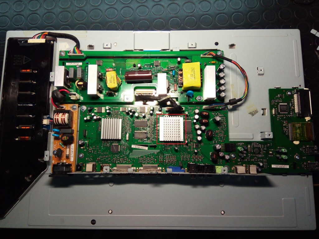

    the monitor did not power up.
    This repair was different from all the others. Not the caps this time!

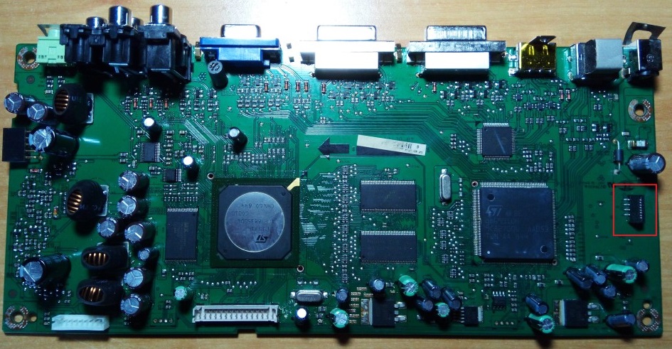

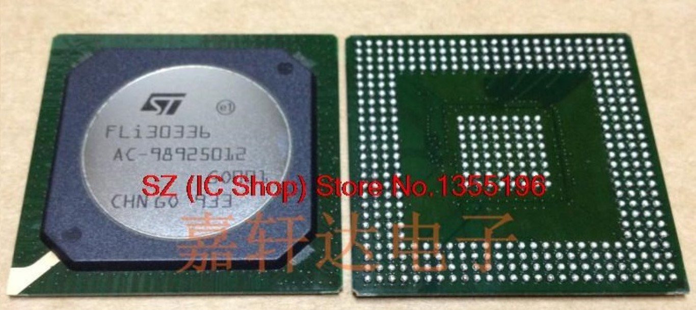

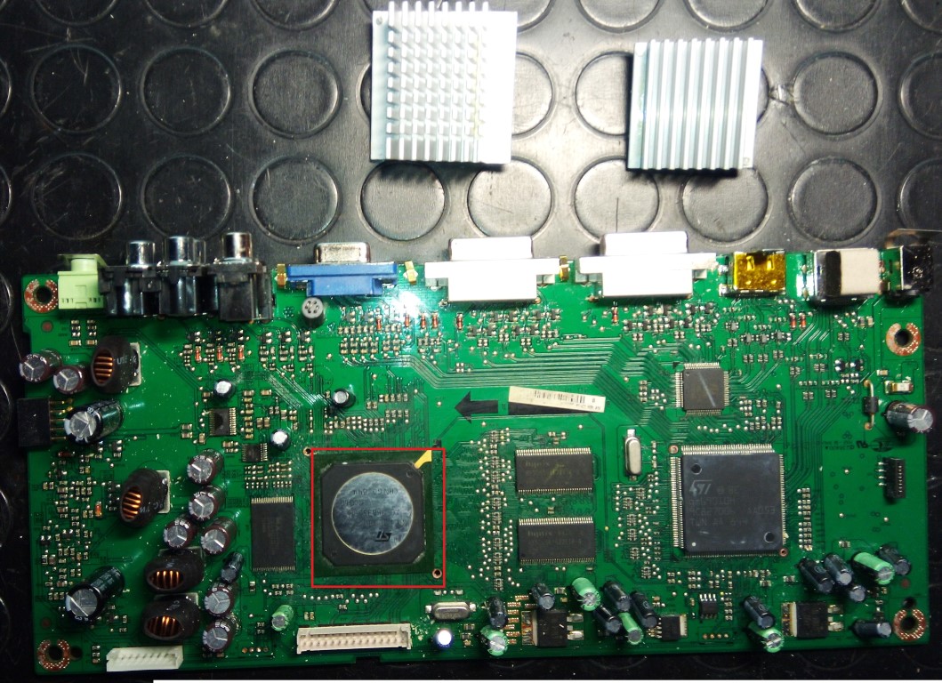

    Power supply was good. I had a clue that the problem was a bad solder joints in the logic board. So, I made the reflow of the logic board mainly of FLI30336 chip.
    I had to remove the heat-sinks that were solder to the PCB.
    This reflow worked and the monitor was working again.
    But, this repair is not reliable. Some weeks later the monitor failed again.

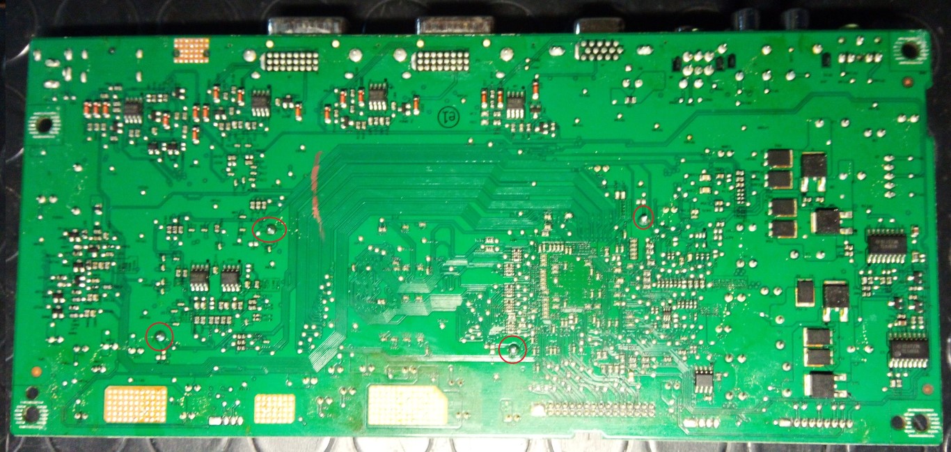

    I try to make the same repair but in this second attempt I damage the front panel flat cable connector in the logic board!
    Now I have to manage to make a patch.

    Re: Repairing a DELL 2408WFPb
    in attach a picture with the connector damaged.
    Does anyone have the schematic for this logic board?
