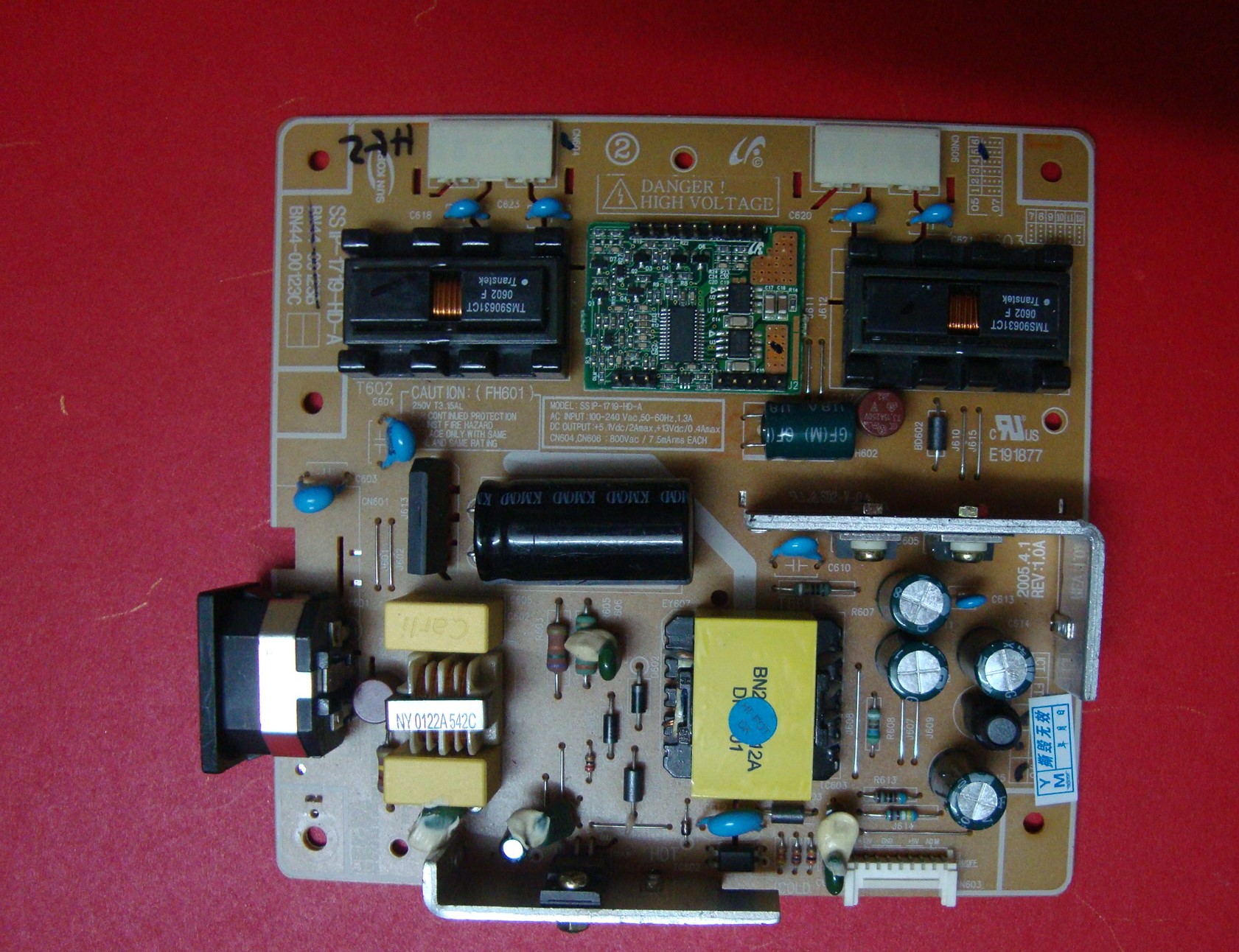

    I opened Samsung 940N Monitor today. The power bord BN44-00123C have a blown component and nothing can be read from it. Blown component is the one at the bottom at the heat sink (image is from web, so on the image component is not blown). I checked service manual. Component in question is marked IC601 on the board. But in manuals I found it only at one schematics and there is no PN anywhere. It's on page 52/63 (chapter 13-7).
    My knowledge is too limited to figure out what that component is and even less to get to the right part number. Except if I would buy another board for 25$, which I will not since that is old 19" monitor.
    So I hope someone will help me.

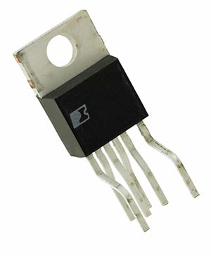

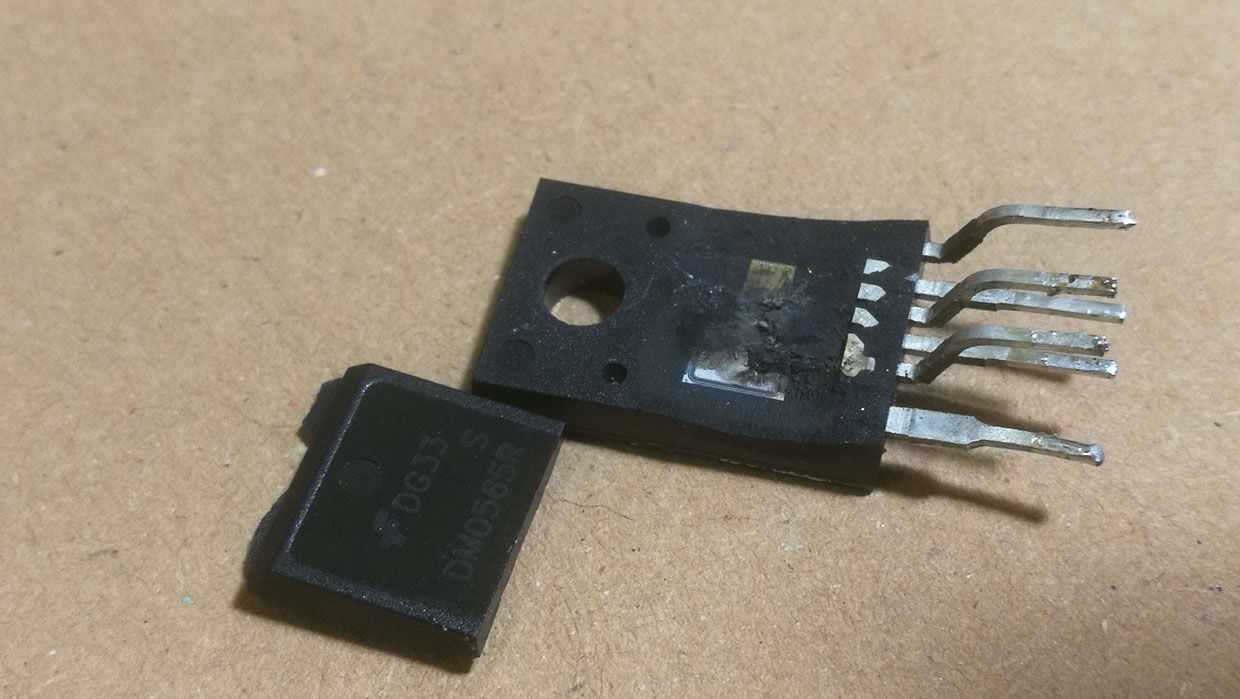

    Can we actually see good pictures of that blown up IC even though you said nothing can be read from it?
    More likly to be FSDM0565R.

      After you asked me to post images I realized, that I should look for missing piece of IC. I found it. I don't understand why I didn't think about that ASAP.
      How ever you told me exact PN.
      May I ask how did you find out what IC it is? How were you able to tell me exact part number? As beginner I often have problems finding datashets even tho I have text on IC.

          I received the part today. + I replaced one cap. And it works! Thanks again!
