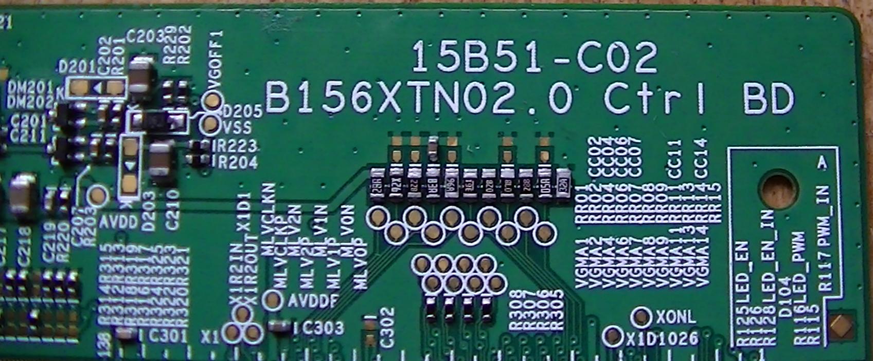

    Dear Technicians,
    I have got a Dell inspiron 5520 laptop with B156XTN02.0 internal screen.
    The laptop displays normally on external monitor.
    When I turn the laptop on, I see blank on the internal screen, but the screen backlight turns on and works normally.
    The screen is not white. it is just on but there is no text/image on the screen.
    I measured voltage on the LVDS connector on the laptop motherboard.
    It seems all the power and signal pins have proper voltages.
    Then, I measured probe points on the screen's tcon board.
    I discovered that there are proper voltages present on most the probe points including Vin, Vcom, V_25, VGH, AVDD, IVPP, LED_En, VGMA1.
    but the following probe points seem suspicious:
    IMG_En = 0 v
    Reset = 3.1 v
    POL_En = 0 v
    DCR_En = 0 v
    now please explain what is faulty that led to the blank screen and how to fix it.

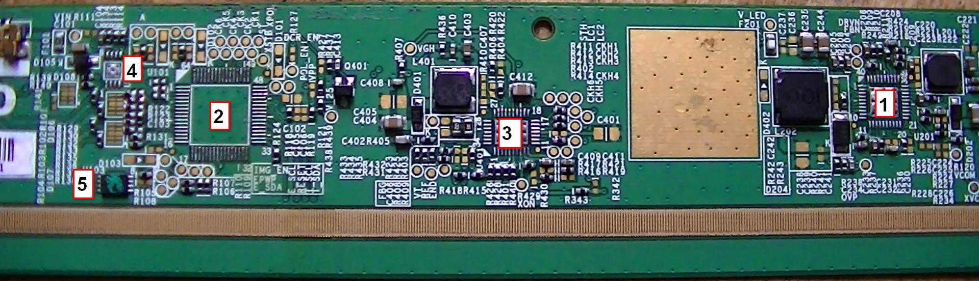

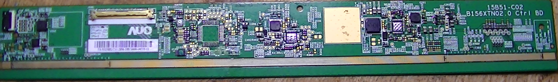

    I attached internet images of the tcon board.
    The tcon IC is AUO-11307 which is missing in the images at place(2) but it exists on my tcon board.
    notes:
    I do not have another screen to replace.
    I do not have another laptop to test the screen.
    The fuse on the tcon board is OK.
    I did not measure AUO-11307 because I have not found its datasheet and its pinout.
    thanks

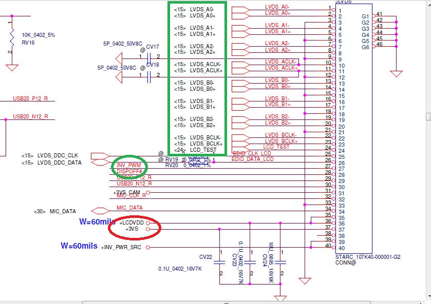

              if MB can be display on monitor so power squence it's ok, no need check to power on strukturu MB.
              the problem is on display LVDS.
              see my attach picture.
              if the RED selected by me and Green selected its ok, so u must be check to ur LCD, not ur MB.

                are the following voltages ok on the screen connector on the laptop mainboard:
                pin1: LVDS_A0- = 1.7v
                pin2: LVDS_A0+ = 0.05v
                pin4: LVDS_A1- = 1.7v
                pin5: LVDS_A1+ = 0.05v
                pin7: LVDS_A2- = 1.7v
                pin8: LVDS_A2+ = 0.05v
                pin10: LVDS_ACLK- = 1.5v
                pin11: LVDS_ACLK+ = 1.5v
                pin27: INV_PWM = 1v
                pin28: DISSOFF = 3.3v
                pin36: LCDVDD = 3.3v
                pin37: 3.3v
                pin40: 19v

                  Pin27 very low correct is 3.3v or 19v new project

                    Pin 27 "INV_PWM" is a PWM signal for backlight brightness, doesn't matter here and should be OK.
                    If you have 3.3V after the fuse on the T-Con board, then yes most likely one of the T-Con board's IC is bad. This still does not rule out a bad motherboard though.
                    On some of those board there will be a voltage regulator (LDO, 1117-like), but I don't see any on this board. However there are some inductors, there must be a voltage there.
                    You can check for short to ground on capacitors (it can be either the cap itself or an IC).
                    Anyway, it's probably not repairable.

                      is this normal that there is 0.05v on LVDS_A0+?
                      should it have a higher voltage?
                      • caspian
                        • Oct 2015
                        • 1589
                        • Laptop
                        Re: blank laptop screen B156XTN02.0
                        the problem is solved.
                        it was the video cable that was not properly plugged into the LVDS connector on the motherboard.
                        thanks for the responses.
