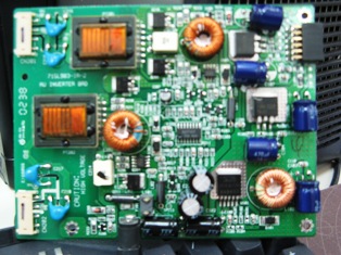

                      • cyberbro
                        • Jul 2008
                        • 5
                        Re: Help me fixing my Fujitsu LCD Monitor
                        Here are the details of the Monitor:
                        Fujitsu Color Monitor 3816 FA-M
                        Model TFT1560A+
                        Power: 12V / 2.5A
                        715L983-1A-2 AU INVERTER BRD (Written on board)
                        Done: Replaced 9 capacitor with exact value
                        Any help will be appreciated, thanks
                        • EGuevarae
                          • Nov 2008
                          • 1336
                          Maybe it's just me, but I can't figure out anything from the picture (too small). In the meantime while you manage to upload a bigger/better one, why don't you put the known good inverter in the failing monitor (with your old top lamp and your replaced bottom one) and test it? I've just finished fixing a Proview LT716s with a similar problem, and ended up swapping both upper and lower lamps. It it fails, maybe the problem resides in your lamps rather that in the inverter itself (caps changed already, you said)
