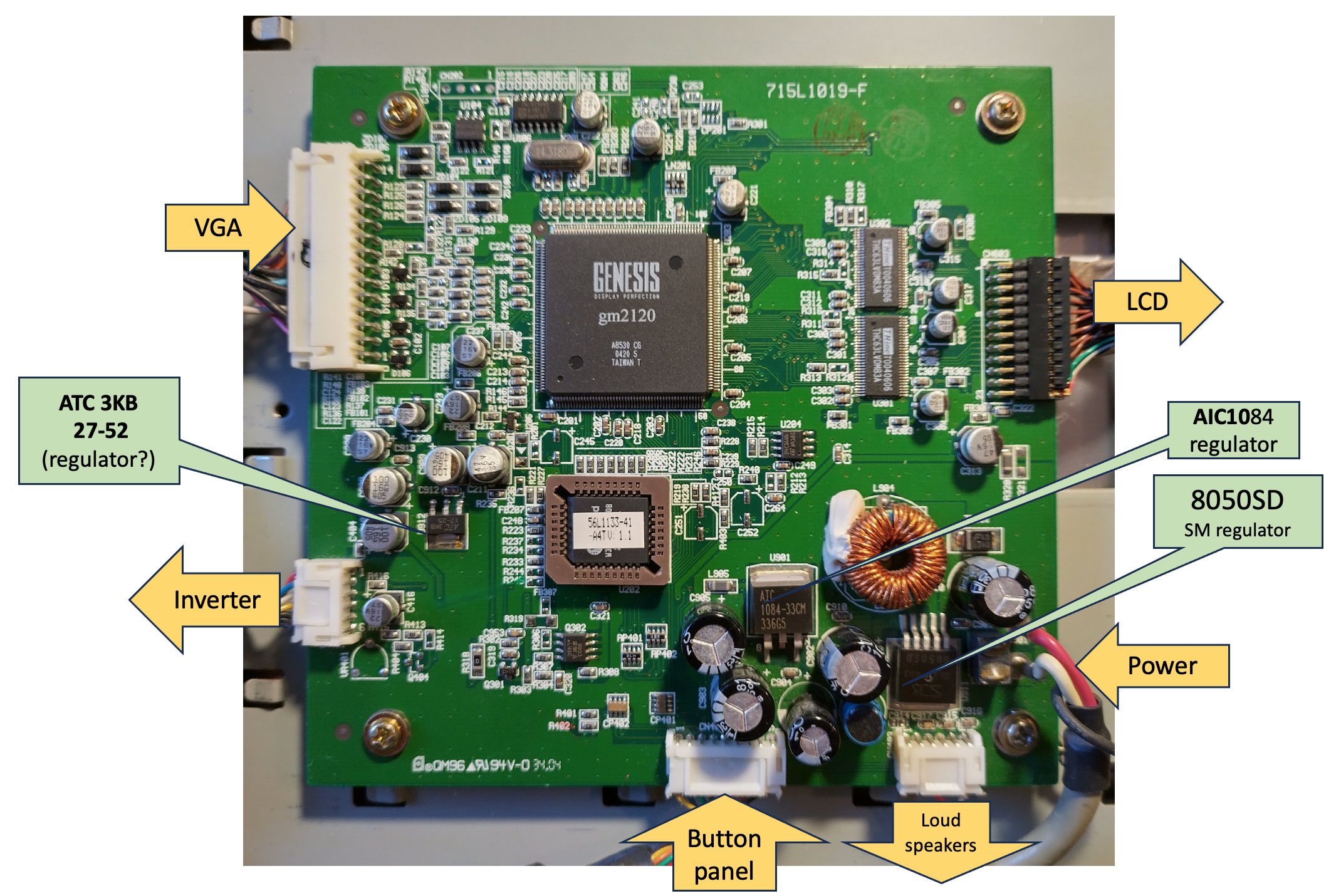

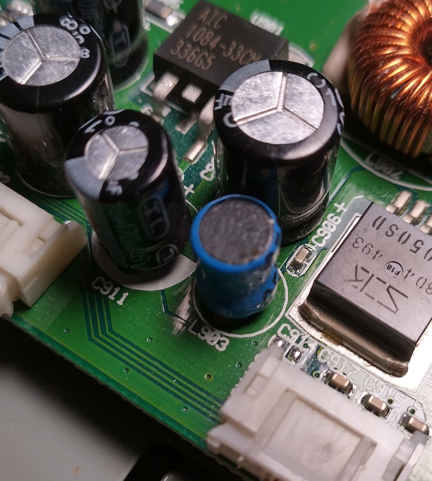

    Hi, seeking for guidance on the following:
    I have a Fujitsu Siemens monitor T19-1 (base model is C19-1) that stopped showing any picture, besides the FS logo when it boots.
    I'm attaching a picture of the system board with some additional info.
    - The monitor recognizes the presence of the VGA signal: the power button switches from amber to blue, and vice-versa when the computer goes sleeping.
    - The inverter + CCFL seems to be working fine: the Fujitsu-Siemens logo appears when the monitor is switched on.
    - I measured the values in the power regulators:
    8050: 1)Vin = 12V 2) SWout 0 = 5V 3)GND = 0 4) Vos = 5V 5)S.start = 2.4V
    AIC 1084: 1) 0V 2) 3.25V 3) 5V
    Any guidance highly appreciated: I cannot find a Service Manual for this monitor, and my experience with displays is basic.
    Thank you in advance,
    José

    Re: Fujitsu monitor: power is there, but no image from PC
    The problem may also be in the W39F010 firmware.
      First I would take that square IC in that brown square socket out and reseat it.
          Hi, Thank you for the hints!
          - I took out and reinstalled the PROM(?) brown socket -> no changes.
          - I also checked with the DMM all the FBxxx SMD components, I guess they are fuses ... all seem ok.
          Same behavior:
          ->I see the logo in the screen for one second or so (as it has always done).
          --> after that, nothing: neither image from the PC nor menu/OSM when I push the respective buttons...
          I will now try to check for the Vcc in all ICs...

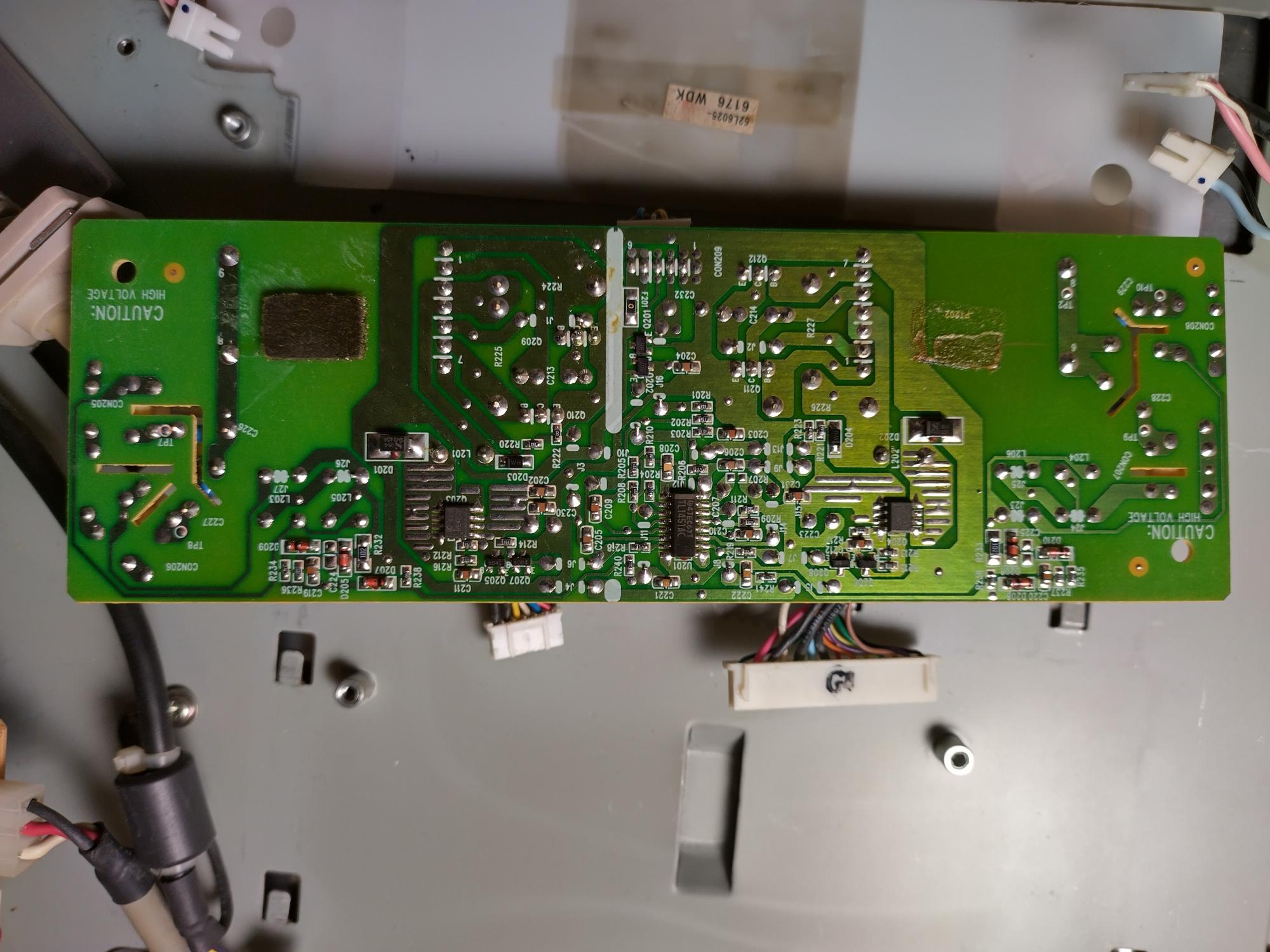

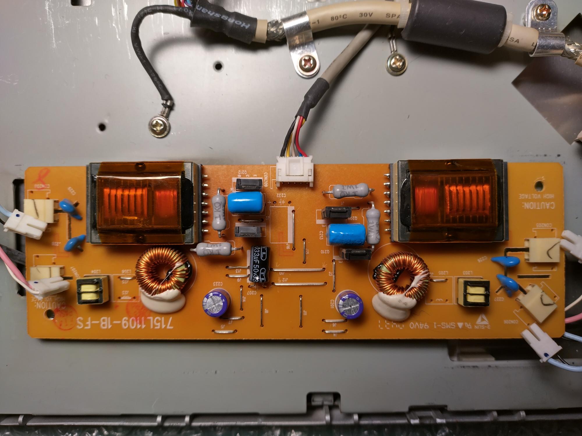

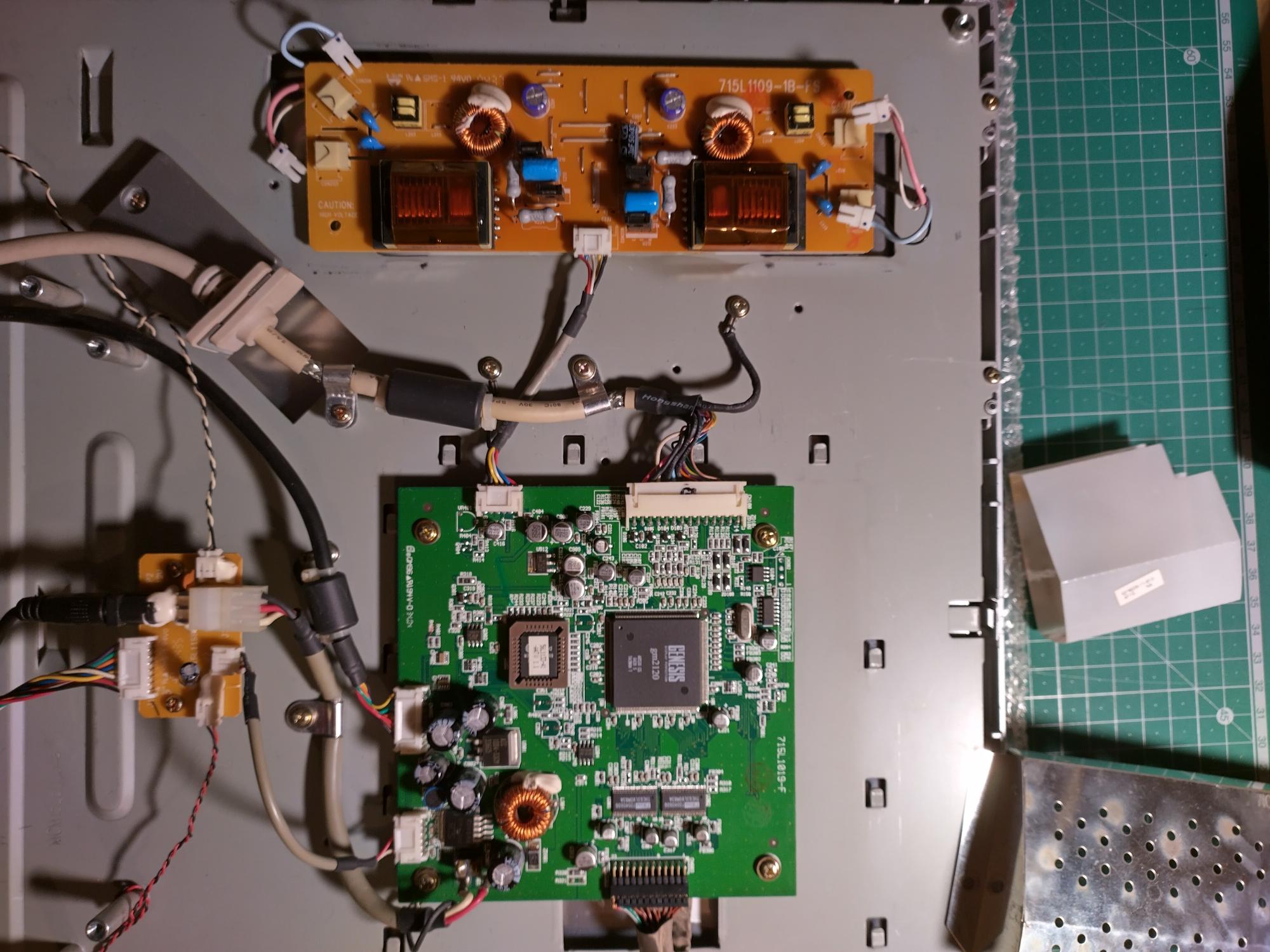

            Show us a picture of the inverter.
            • jvelez
              • Nov 2023
              • 11
              • Portugal

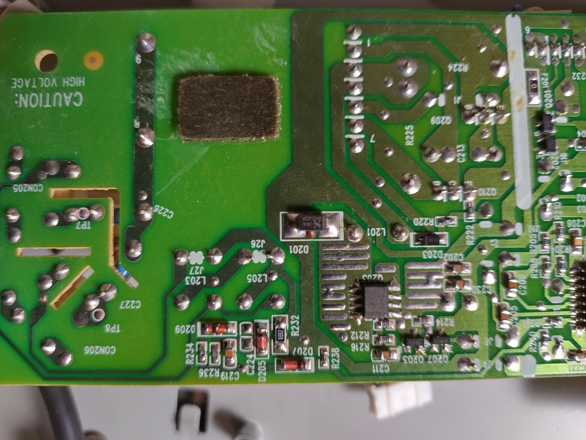

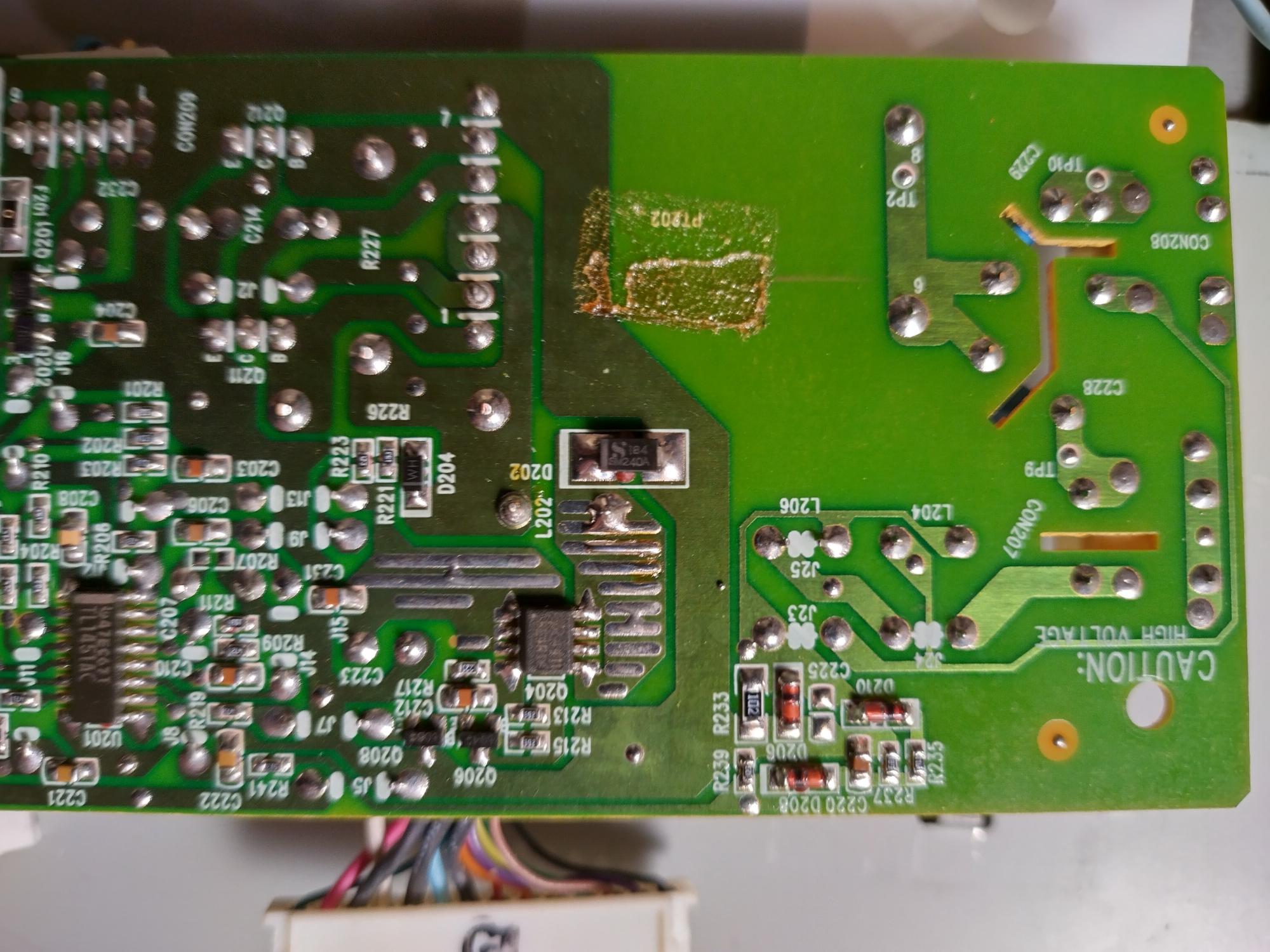

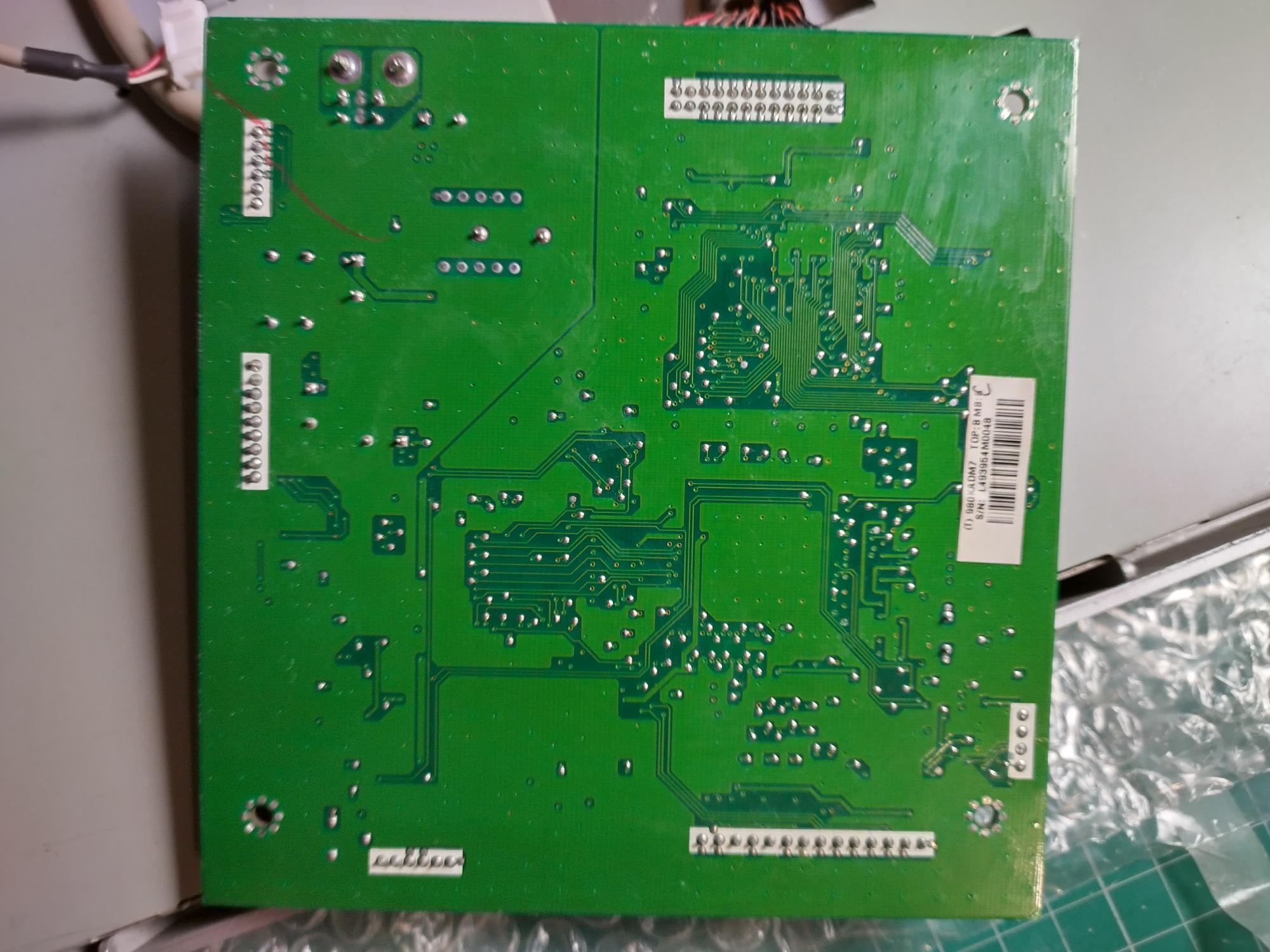

              Some pictures of the inverter (both sides) plus the back of the main (square) board...
              Visually, I cannot spot any particular signs of damaged capacitors or similar.

              • harp
                • Jun 2022
                • 622
                • Planet Earth
                Maybe cold solder near R227 on HV transformer pins
                • CapLeaker
                  Leaking Member
                  • Dec 2014
                  • 8327
                  Unplug the inverter from everything. Now measure with your DMM in Ohms setting both of the transformers primary and secondary windings and compare them to each other.
                  The HV windings got to be within 3% of each other.
                    I agree with harp, re-solder those transformer connections. Those connections are bad so look for similar bad solder connections on the board
                    • CapLeaker
                      Leaking Member
                      • Dec 2014
                      • 8327
                      Yes there are cold solders on the transformer, good eye! 4th picture.
                      • jvelez
                        • Nov 2023
                        • 11
                        • Portugal
                        Thank you again for the advices!
                        - I checked both transformers in the inverter, and I have a max of 0.2 ohm in the longest primary coil (0.1 or even zero in the intermediate derivations), and resp. 194 and 199 ohm in both secondaries --> seems ok with the 3% ballpark rule.
                        - I re-soldered all transformer terminations --> indeed they seemed bad in one of the transformers.
                        - I checked Vdd/Vss in all ICs in the main board, getting 4.8 or 3.2 volt in all of them...
                        One thing I noticed: inductor L903 (blue component, please see photo) in the power switching section is extremely hot. Is this normal for an inductor?
                        Without wanting to be pushy, one more question: what are components CPxxx (e. g. CP401) in the main board?...

                          The inductor can get quite hot under normal operation, CPxxx are likely capacitor arrays (4 capacitors in one case) similar to the RPxxx which are resistor arrays. Did resoldering the transformers etc. change anything?

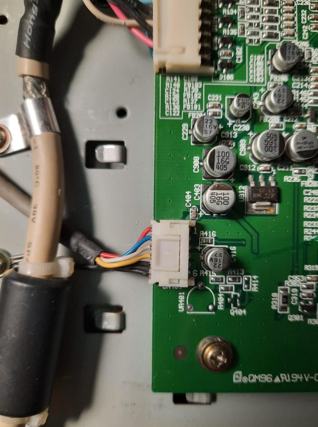

                                        Thank you Iotas and Harp!
                                        - After the question posed by Jotas I did exactly that test, and I'm pretty sure there is absolutely no hissing or visible sparkling I could notice.
                                        - I also checked the tensions in the pins of the connector that goes from the main board to the inverter (photo), and I although I don't have the schematic I got reasonable values:
                                        red wire = 12volt
                                        blue " =12volt
                                        white " = 0 without VGA signal, 3.2 with VGA signal
                                        yellow " = 4.8 volt
                                        black " = 0
                                        black # = 0
                                        The repeated questions about the inverter from all more experienced persons than me in this Forum is leading me to conclude that the problem is somewhere in the inverter (something I was ruling out in the beginning...).
                                        As such, I will verify next the elec. capacitors and the 4 MOSFETS in the inverter. There are also a couple of zeners there, maybe it is worthwhile to check them as well... (The transformers are apparently OK)
